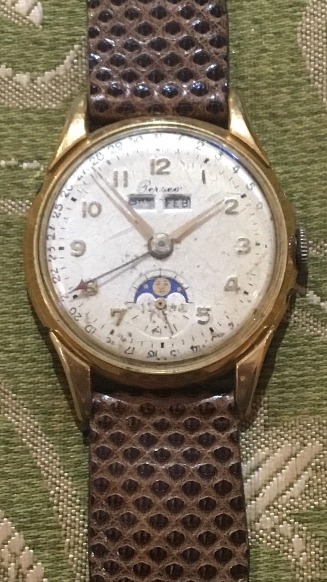

    It looks unique for a Perseo 1950s.

    I don't know the brand, but the styling and hands seem to be in keeping with the watch....looks like the day wheel needs fixed. I would say it's an interesting piece but don't pay crazy money for it!!!

    The dial is trashed.

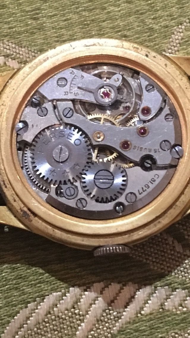

    Lot of these watch companies bought from the same supplier and just added their name on the ratchet wheel and dial
    It's cleaner, but one hand is not correct. Doesn't matter as there's no luminous on the dial, so watchmaker can just add a new pair of anything that matches the dial

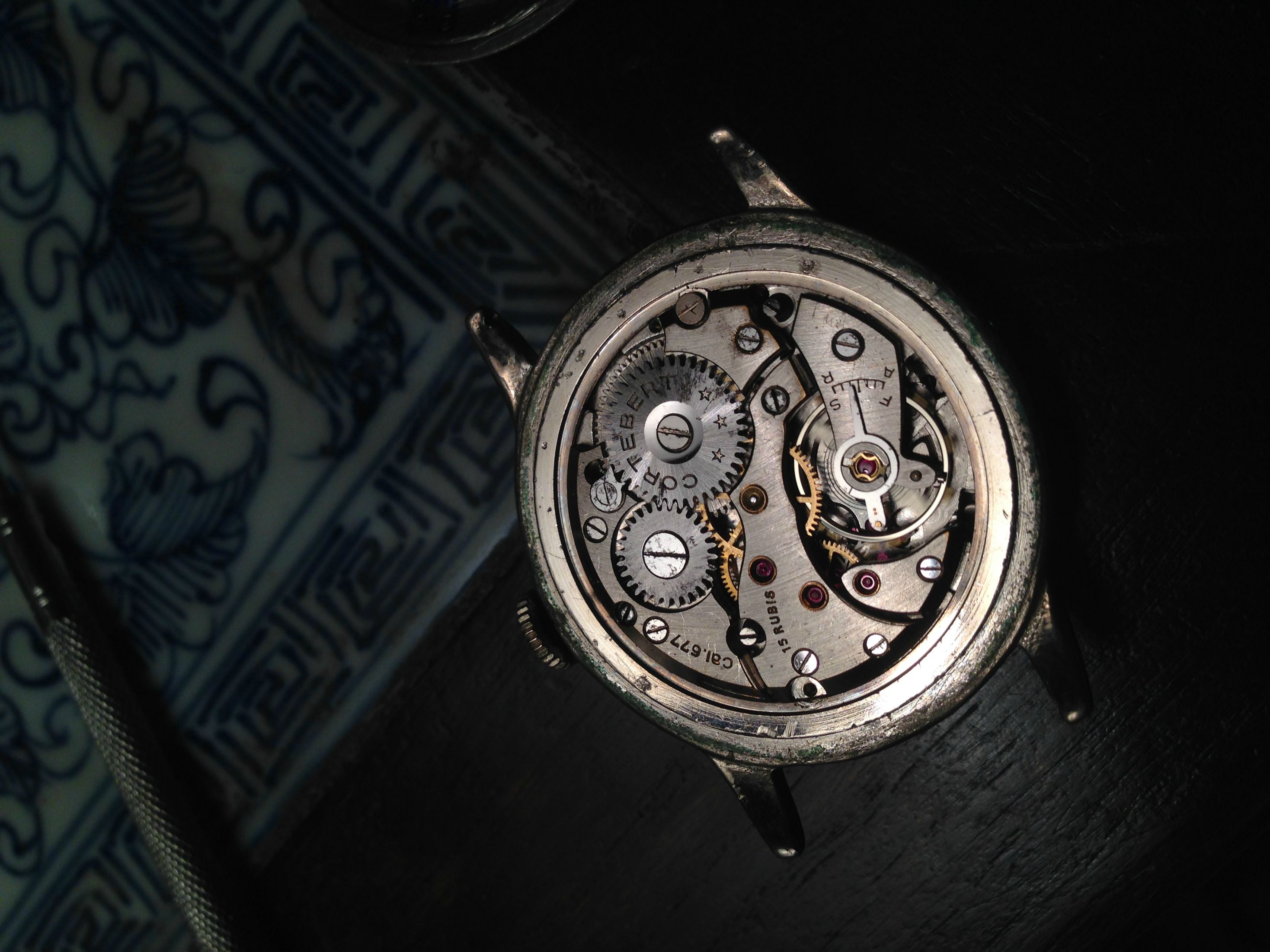

    I think is not in this case. The Perseo in that time (1940s) belonged to Cortébert. The Cortébert could not sell their watches to Italy with the foreigner name because of the Fascist. The movement 677 used to an in-house caliber of Cortébert, and it should be made in Switzerland, but may be assembled in Italy.

    NO....That was the style back then ::rimshot::

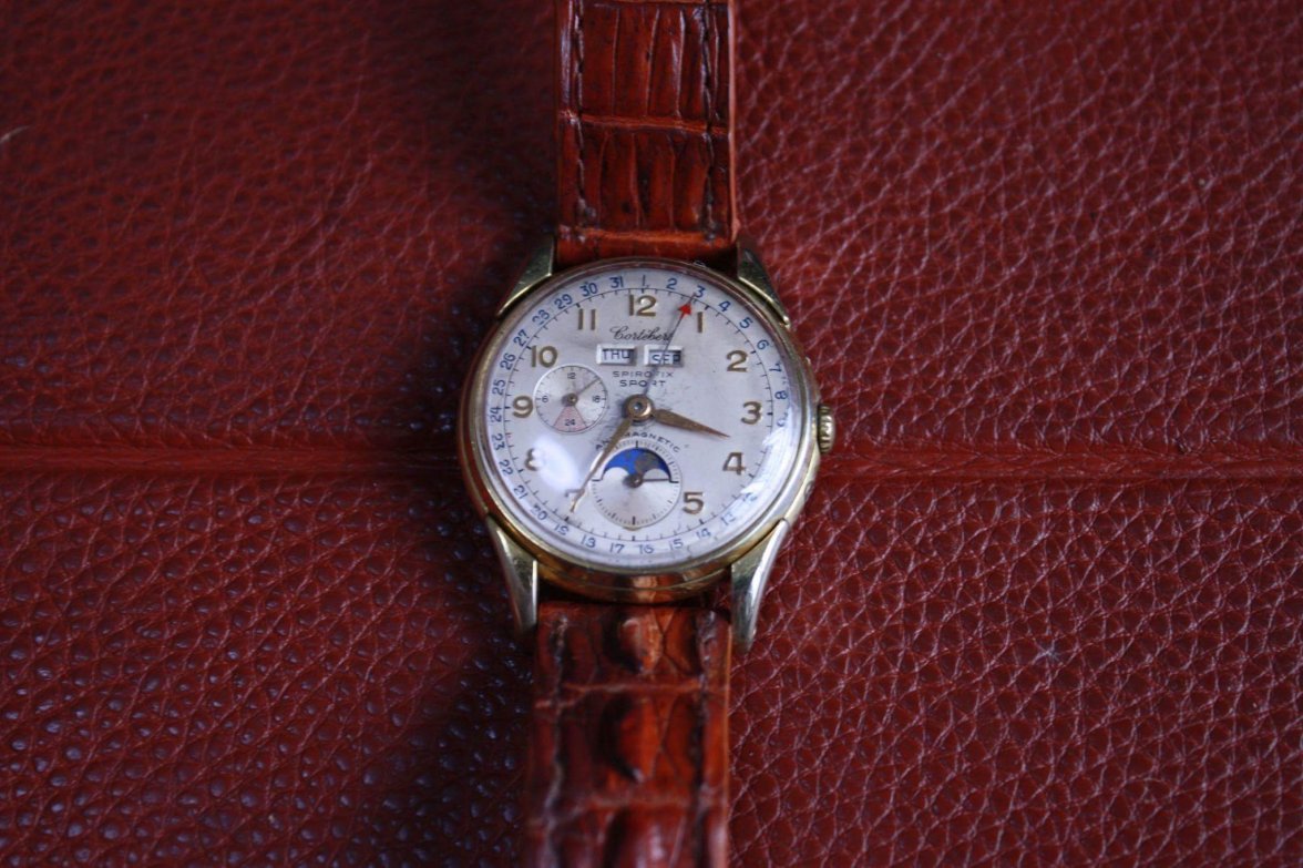

    haha, I wanna to get it for parts to repair my Cortebert 24 hour moonphase ,by judging the price I give up!

    it is mine
