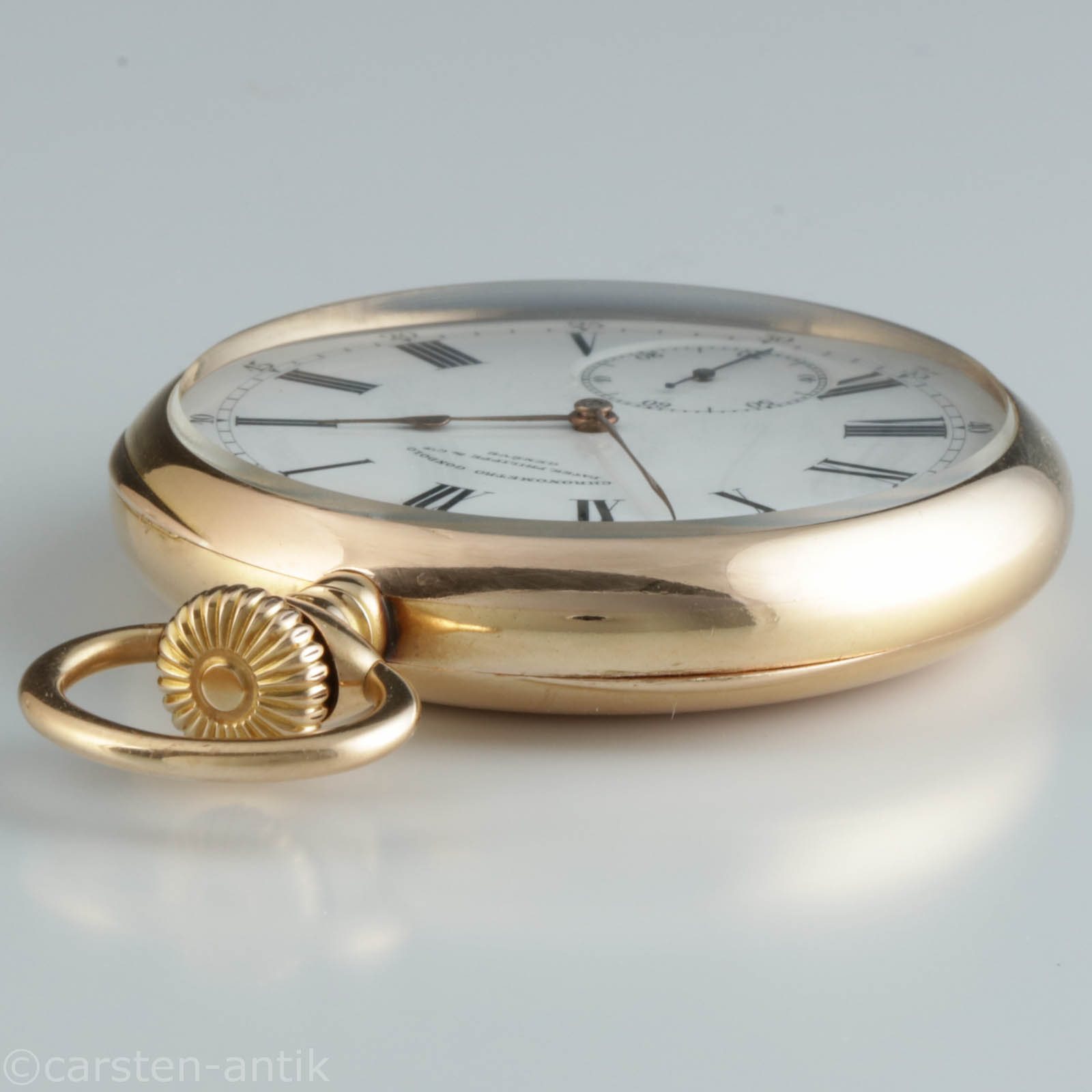

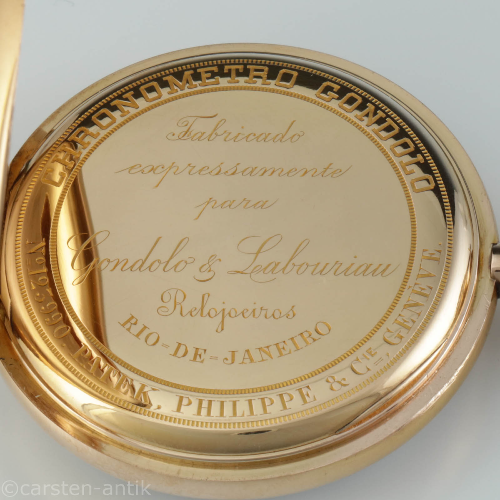

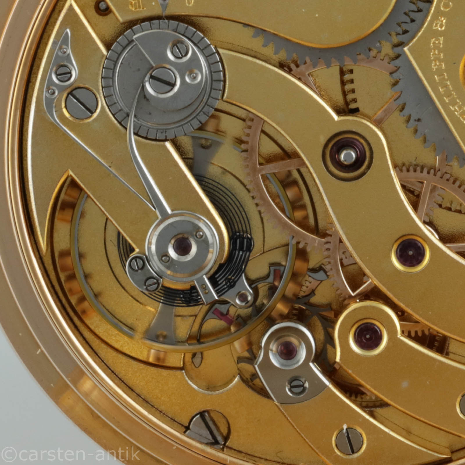

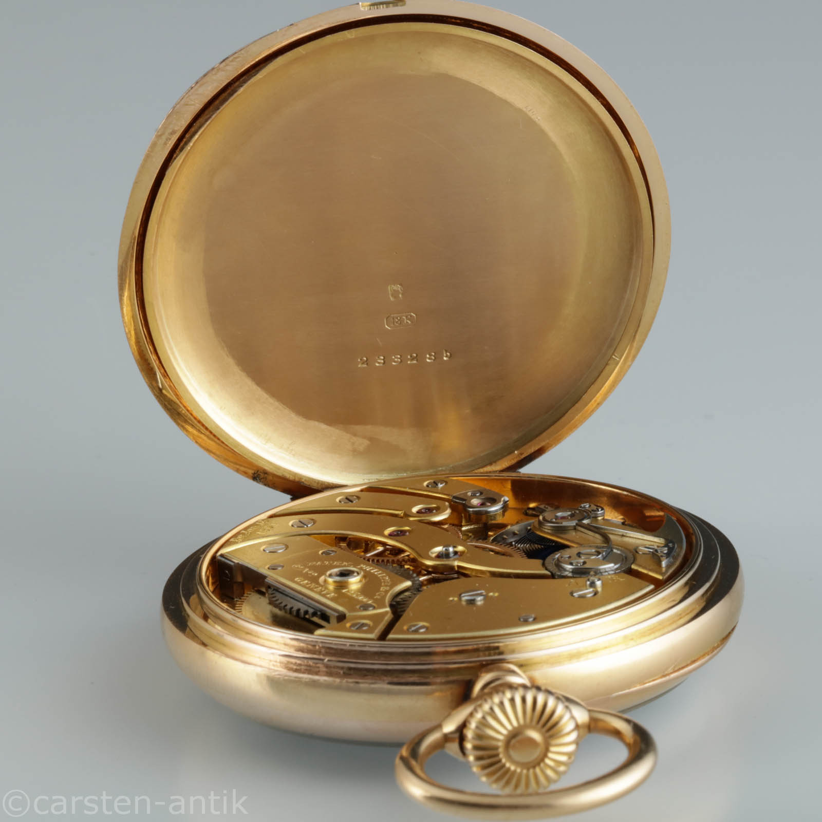

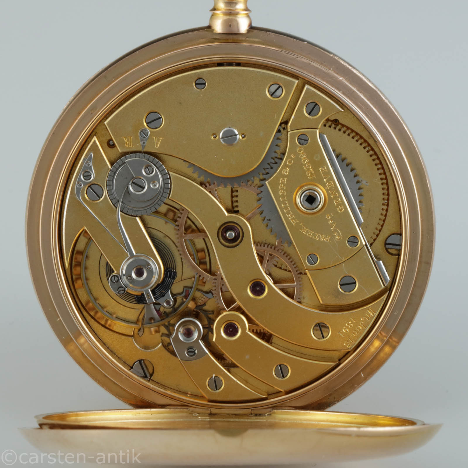

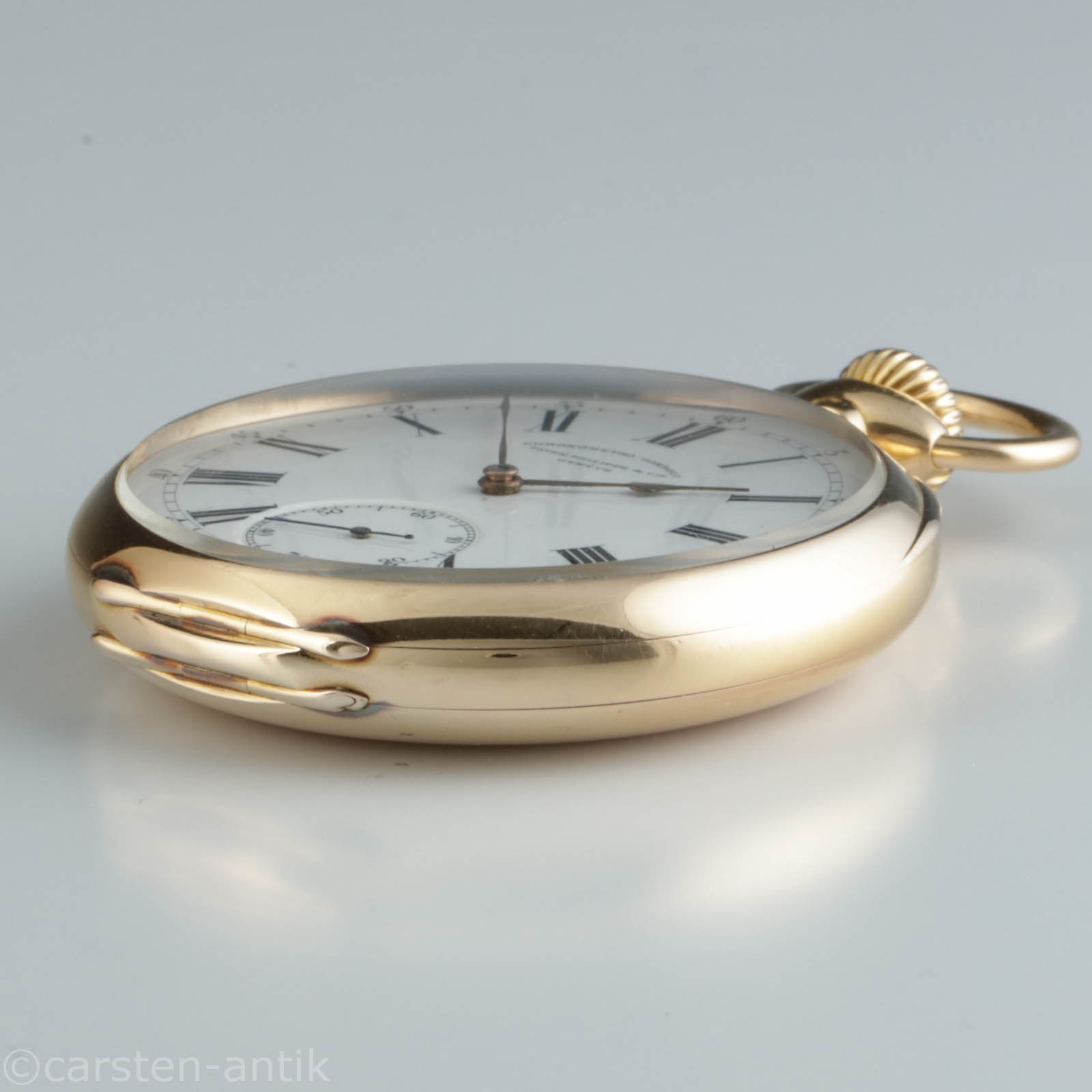

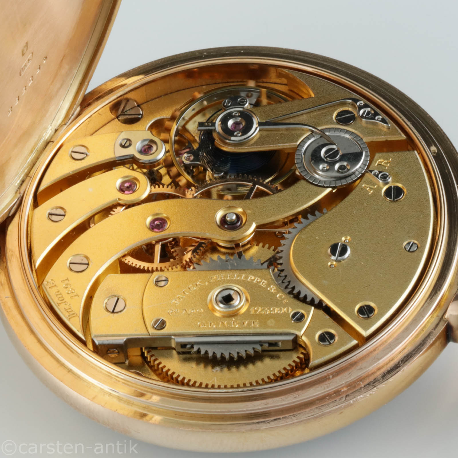

A few photos of the watch can be found here: https://imgur.com/gallery/cyC7Wbh
In my non-watchmaker eyes, it doesn't seem like a ruined movement requiring 17K dollars of custom parts manufacturing.
I see no rust, no broken jewels, cogs/wheels in good state, no apparently missing parts, even screw heads look fine.
8,292
29,363
Patently absurd. The rationalization would likely be along the lines of them wanting the watch to "appear as it did when it left the factory".
For a few hundred dollars and a competent independent watchmaker, that watch would live up well to anyone's reasonable standards.
I my non-watchmaker eyes, it doesn't seem like a ruined movement requiring 17K dollars of custom parts manufacturing.
The only way that the condition of the parts can be determined, is to completely disassemble the watch, clean all the parts, and inspect them individually under a microscope. It's not a matter of having "watchmaker eyes" or not, no one can tell what is required just looking at these photos.

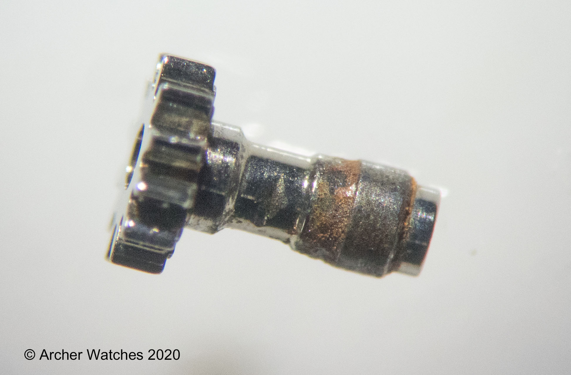

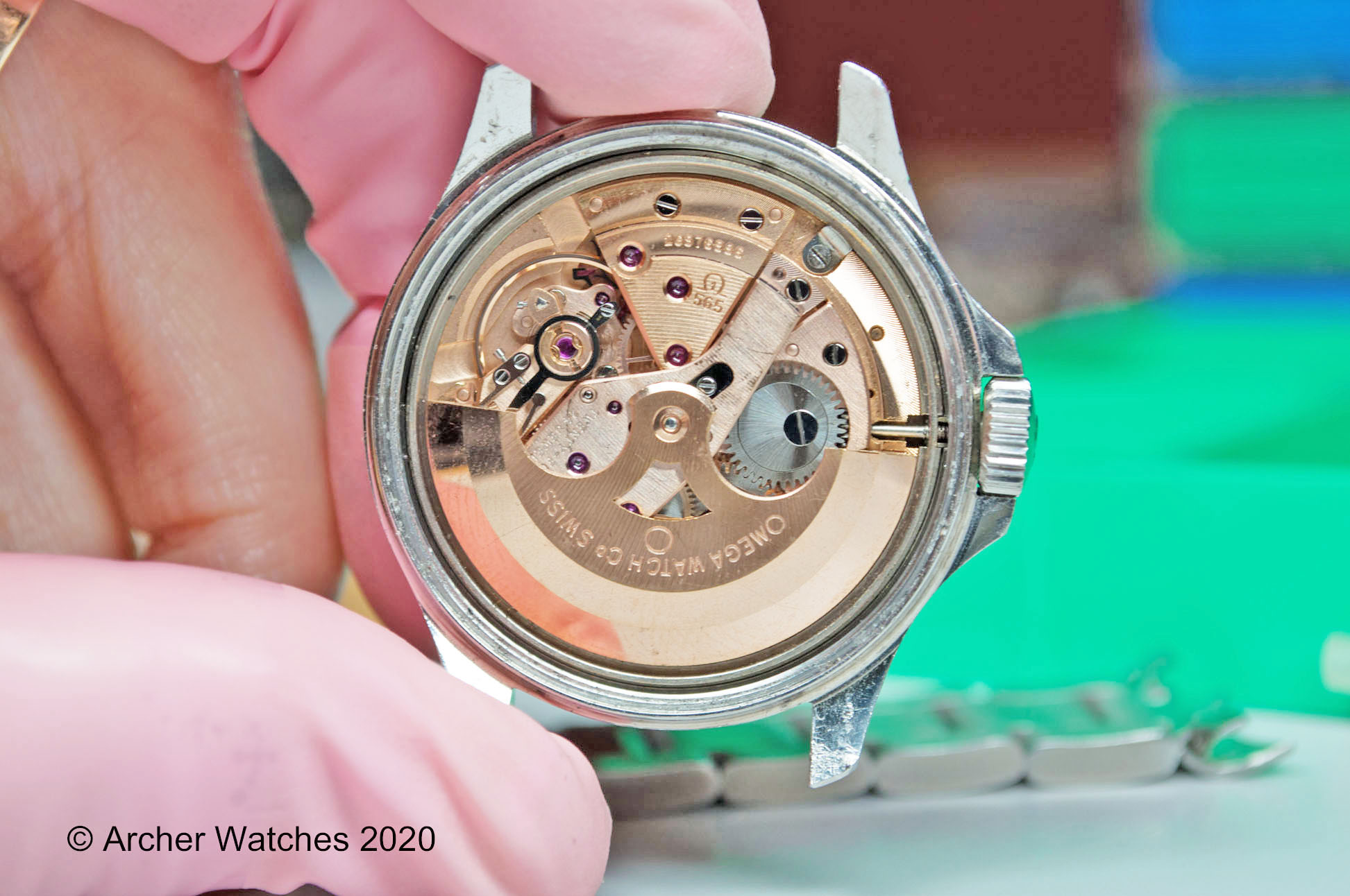

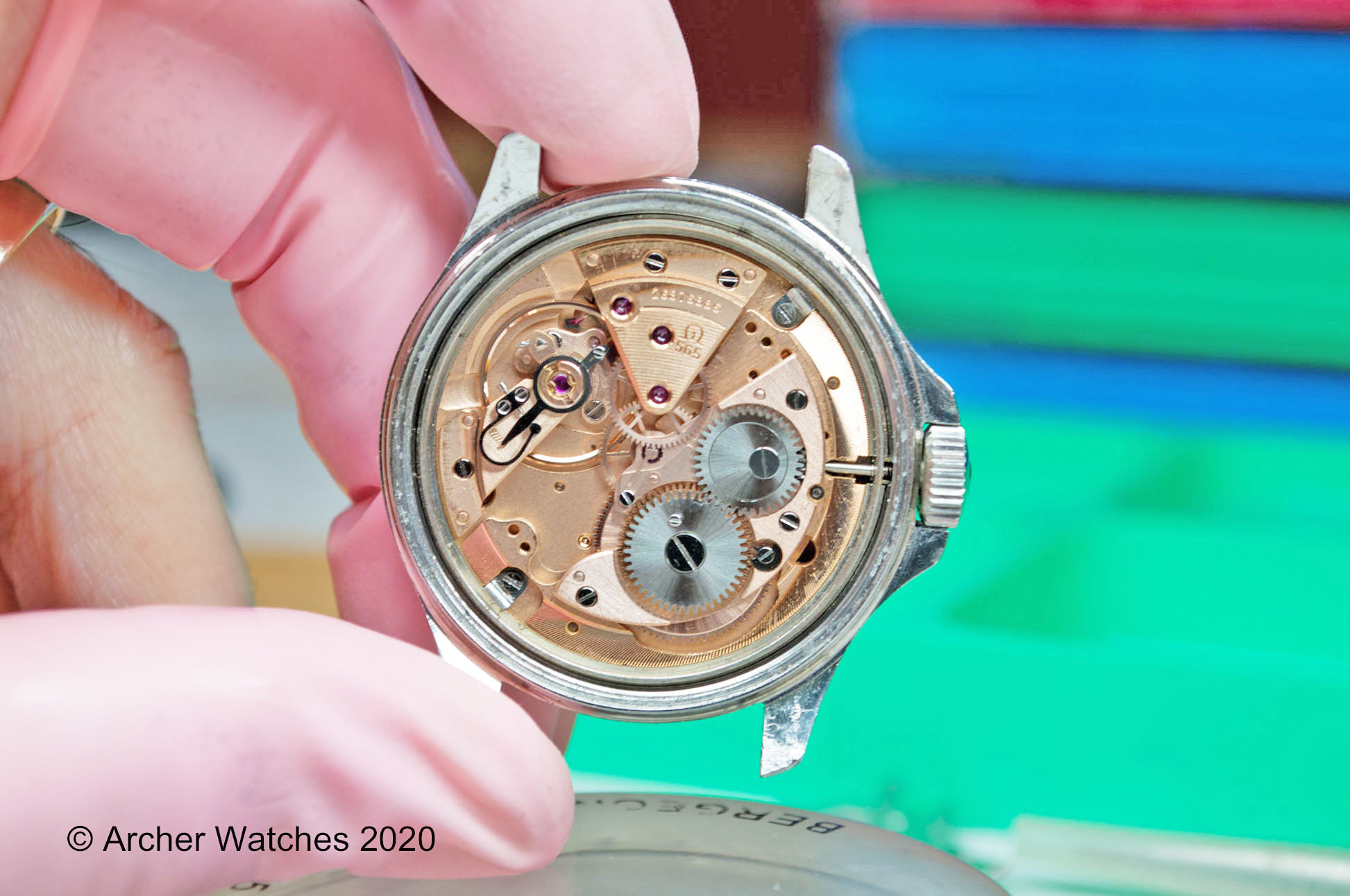

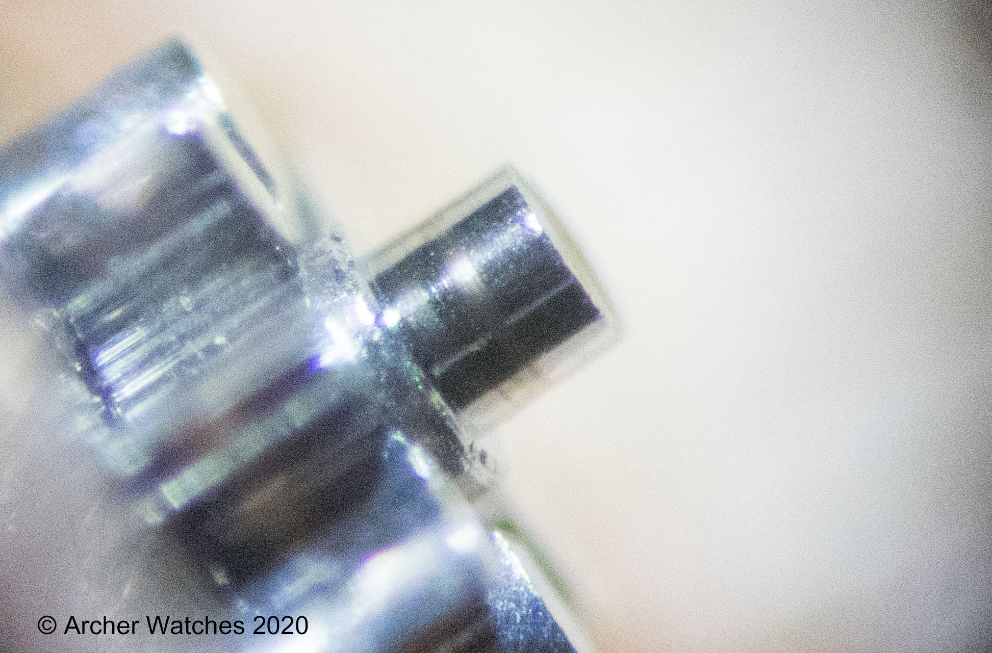

To give you an example, here's a couple of movement photos of a watch I'm working on right now:

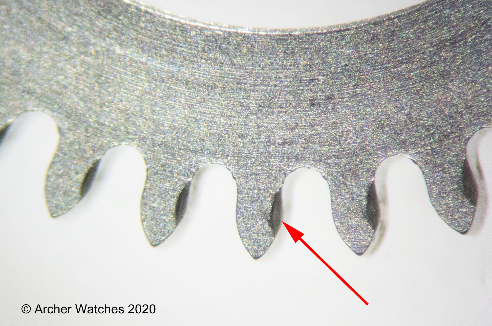

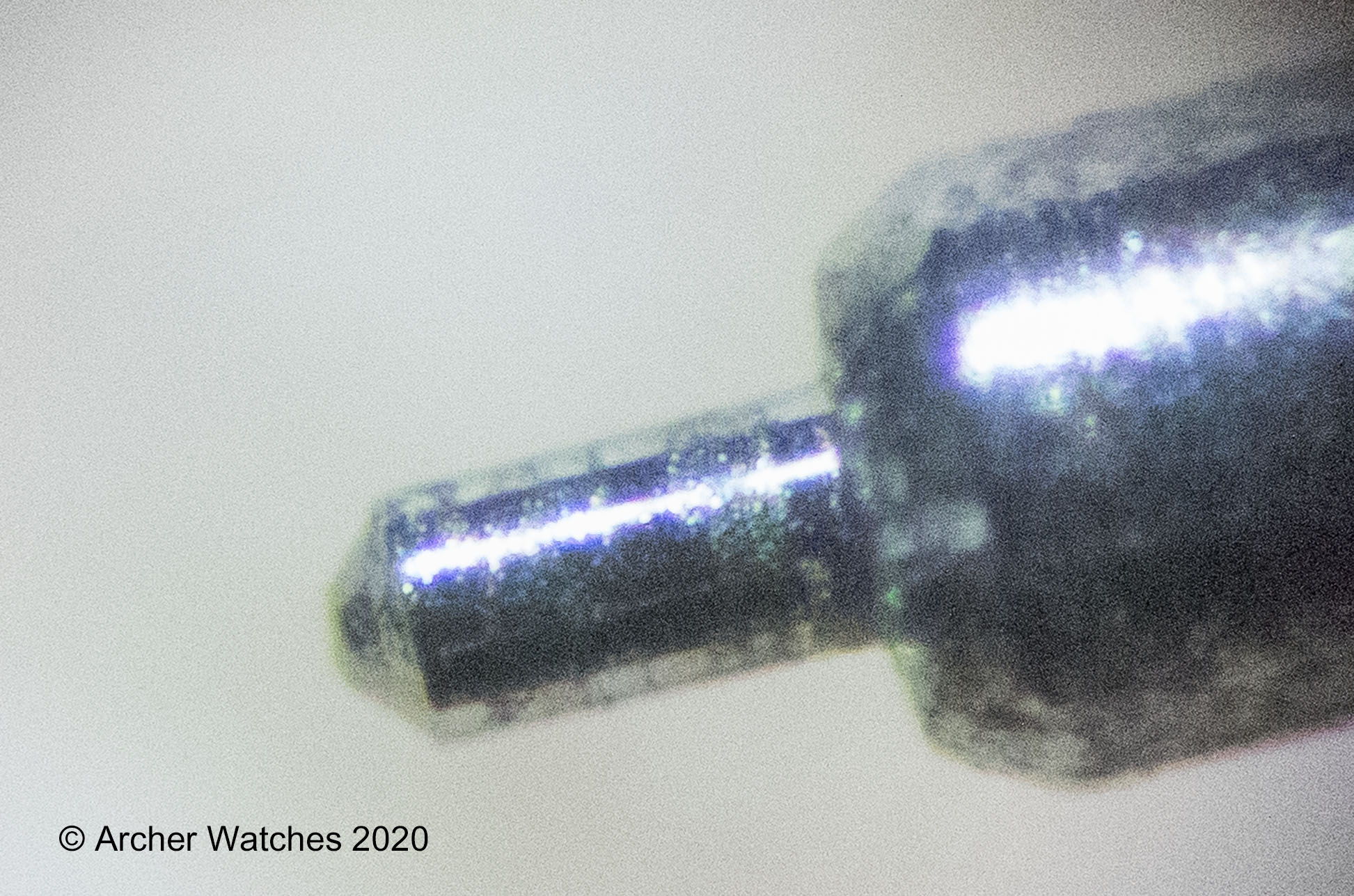

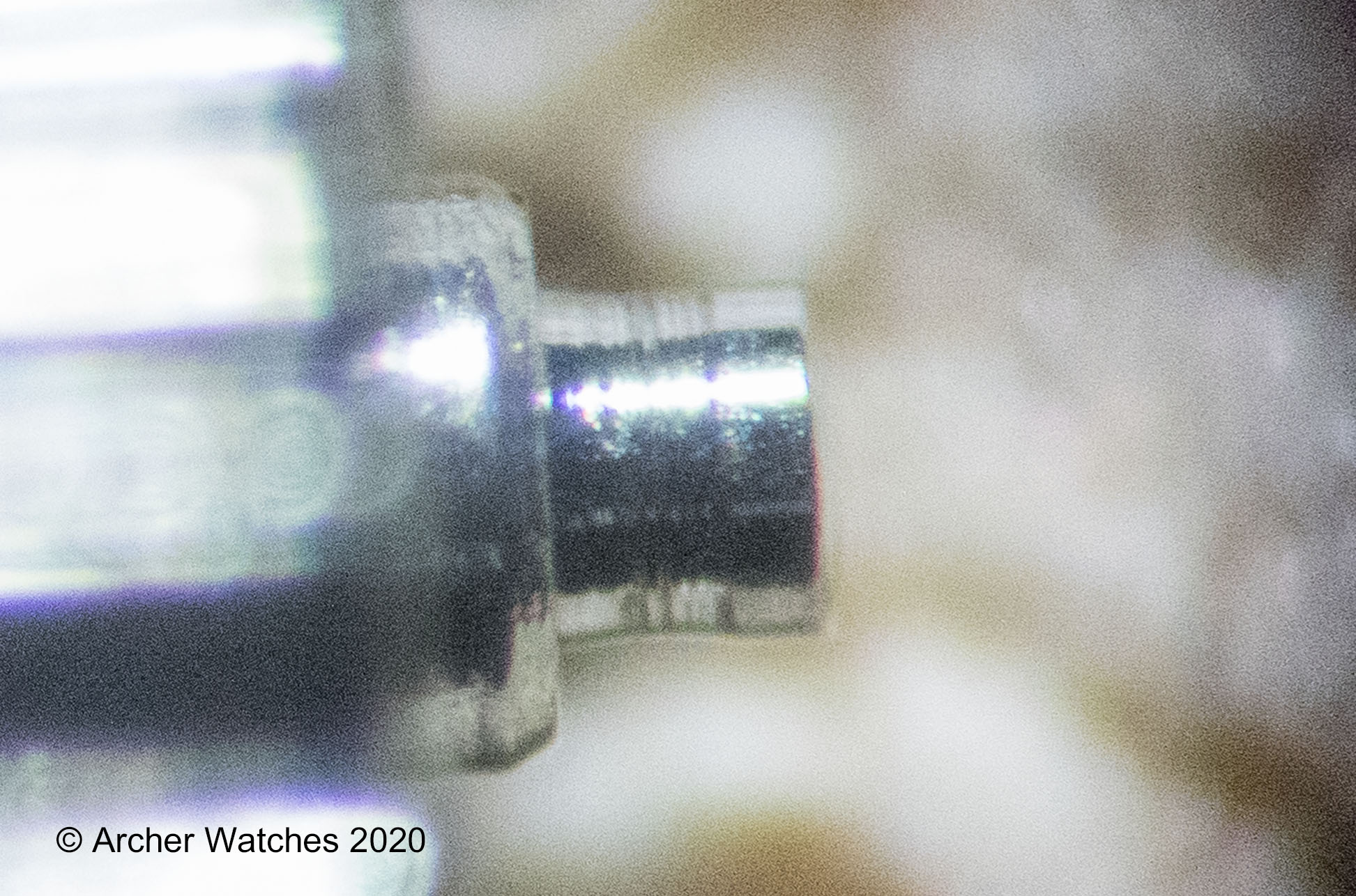

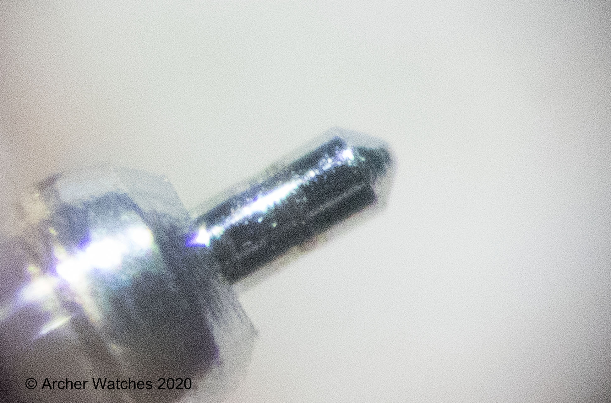

Like the PP above, nothing seems obviously wrong...yet here are some of the parts:
Of all the wheels in this watch, only two were not replaced - the balance wheel and the escape wheel (balance wheel pivot on one end was burnished however). Everything else needed replacing, along with a few other parts. Even having this watch in front of me and using a microscope to look at the movement prior to disassembly, did not tell me that any of these parts needed replacing.
I'm not arguing that the price is reasonable, because I don't have the information regarding what needs replacing, and what is required to actually replace it. In this case there were several hundred dollars of readily available parts that were replaced, but if each of these had to be made from scratch, it's certainly going to get expensive very quickly. The fact is, none of us know what is in need of replacing or what that entails as far as costs go...
I could give you many similar examples where the movement looks "just fine" but when you get it apart, there are worn parts everywhere. It's just not as simple as looking at the movement.
