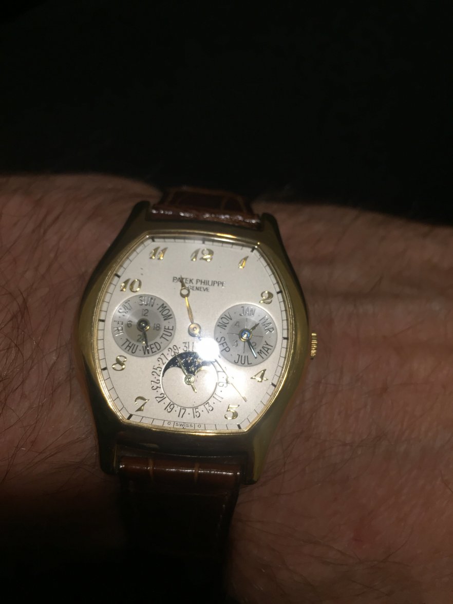

The other day I was hand winding my 5040, something I usually do about once a month as it is far from a regular wear, and the crown, after about 3 clockwise rotations refused to budge. I could rotate the crown counter clockwise freely, but, I could no longer wind the movement. I checked the back and could see the movement working. Yes, I know, it will have to be serviced and it's been a long time since it's last service.
Anyone have an idea what the issue might be... I'm just curious as something like this has never happened on any watch I have ever owned.

PP 5040 uses the 240Q micro-rotor movement, correct? Not certain about the implementation of this particular movement, but many auto-wind mechanisms will use a floating gear or wig-wag system to alternate between auto-winding & manual winding (prevent the manual crown action from trying to spin the auto-wind mechanism, & vice versa). Could be that the wig-wag is stuck in the auto-wind position & can't release to allow for the manual wind action (as one possible explanation).
One way or the other, sounds like the watch needs service.

Thank you for your informative reply. I believe I spoke to you yesterday if you are indeed west coast watch service center.
Yes, I’ll bring it in for service in a few weeks.

I am in the Seattle area, but it was someone else you were speaking with before. I do watch restoration for fun & relaxation, but I am just a hobbyist. Hope you can get the watch taken care of without too much trouble.
