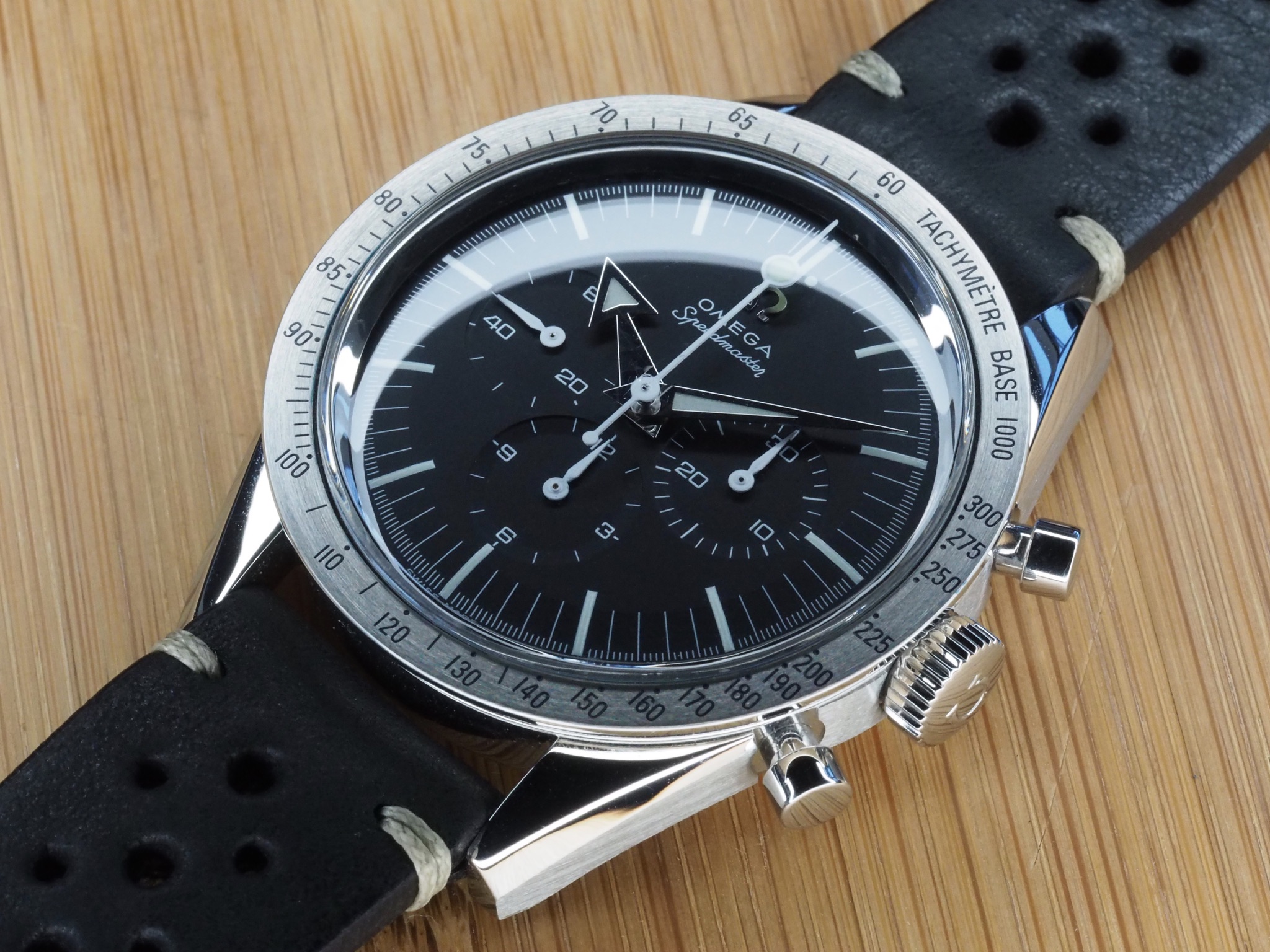

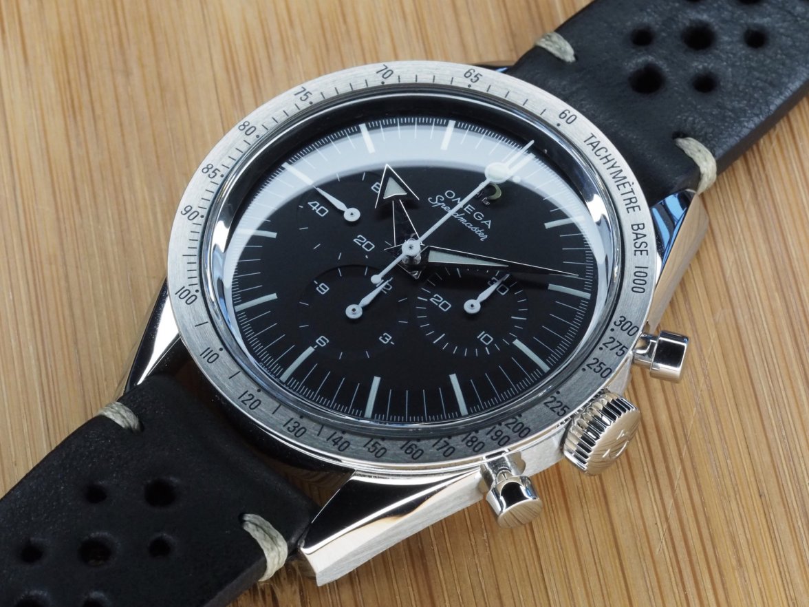

This is the first time I've ever seen anyone state the two types of crystals are interchangeable - have you tried this before?
Indeed yes, the watch in the photo at the beginning of the thread has a hesalite crystal conversion. That was done in November last year and it passed the 50m factory rating pressure test then and it still passes that test now as expected. There’s a little video of it on my Instagram page, @lewiswatchco.
I’m not going to offer it as a service but may do it again on further builds. That FOIS had all of the listed available mods done.

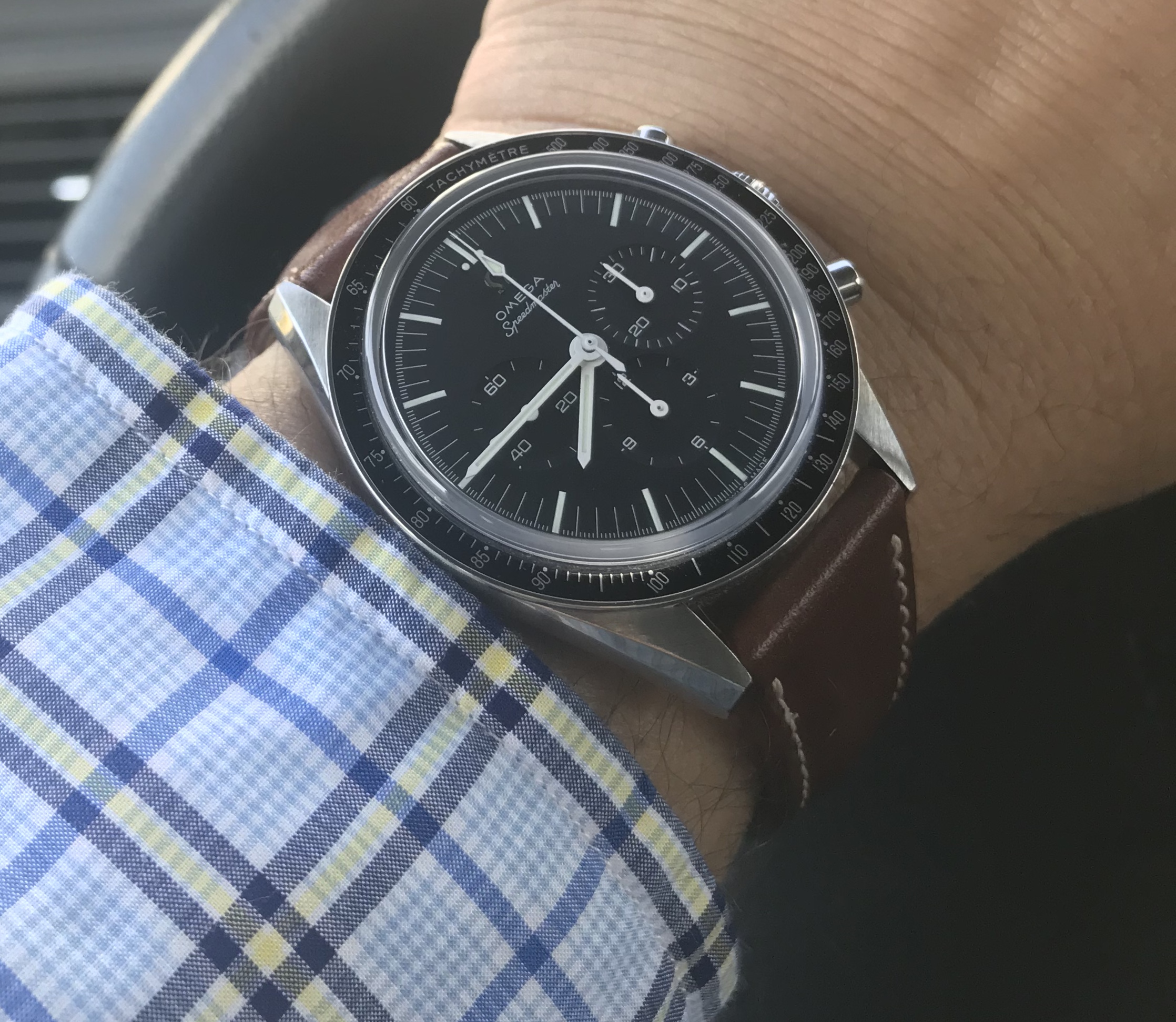

Have you got any more pictures of the watch in the OP? Keen to see the crown and any wrist shots you may have!
Here’s a couple...after changing the dial and hands

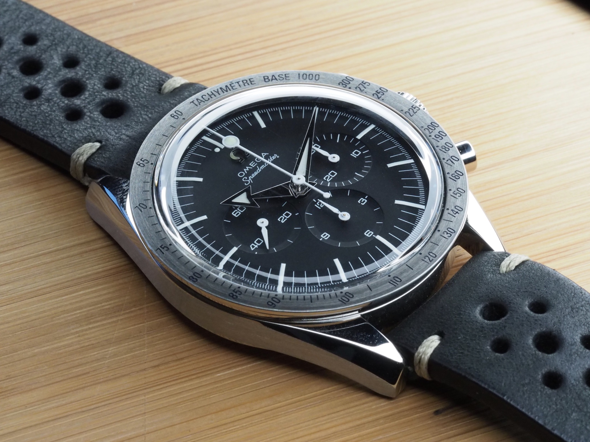

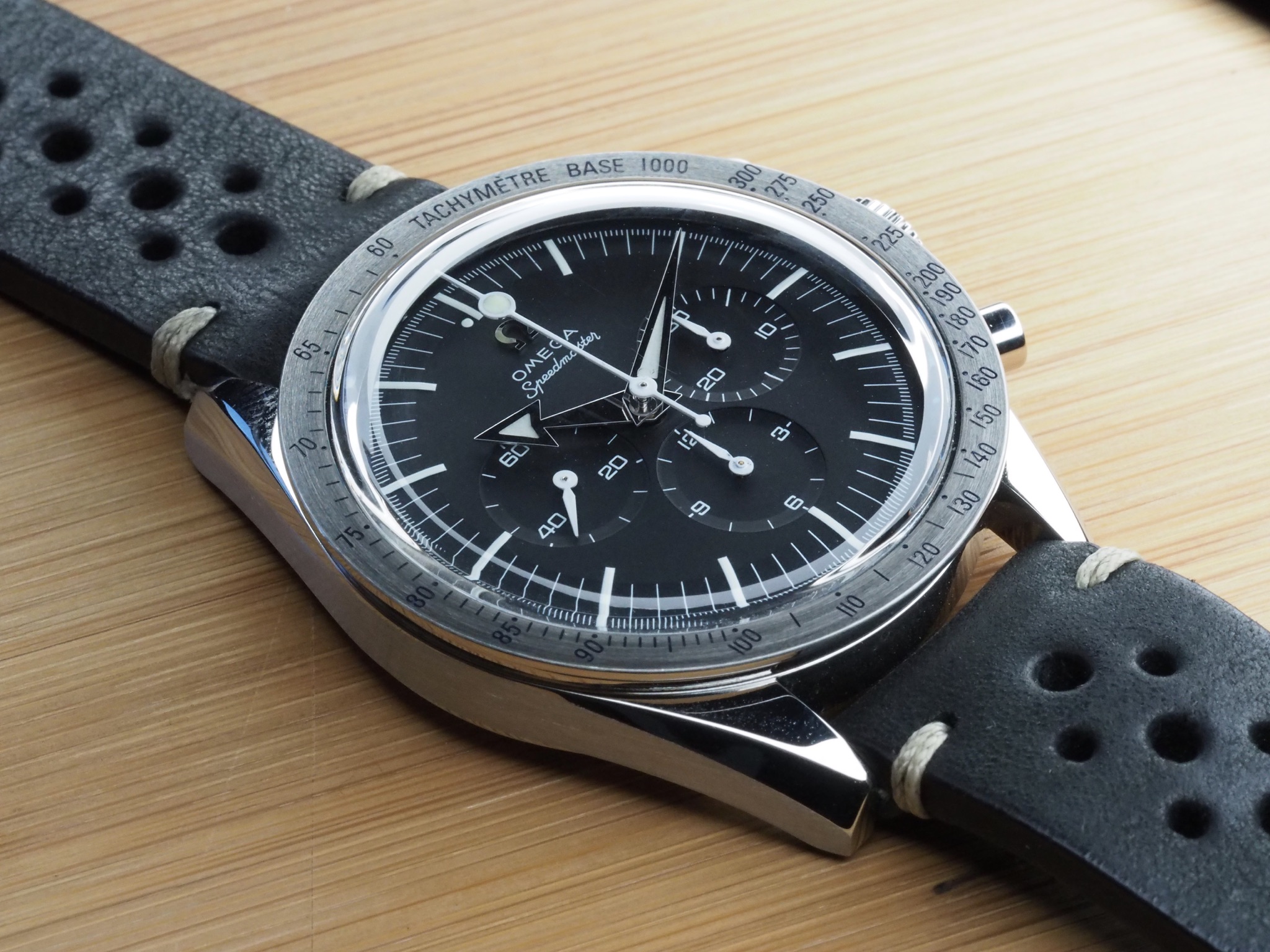

Checking back in here with a very fresh FOIS modded with 105.003 service hands. I always liked the alpha hands but you had to twist them just right against the light to read them, and that always bothered me.
This watch is fantastic, loving it - great size, love the straight lugs, applied logo, and personally much prefer this over the alpha hands.
