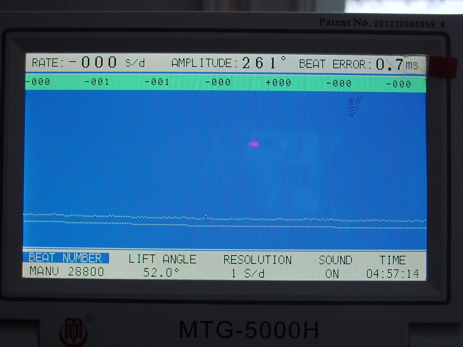

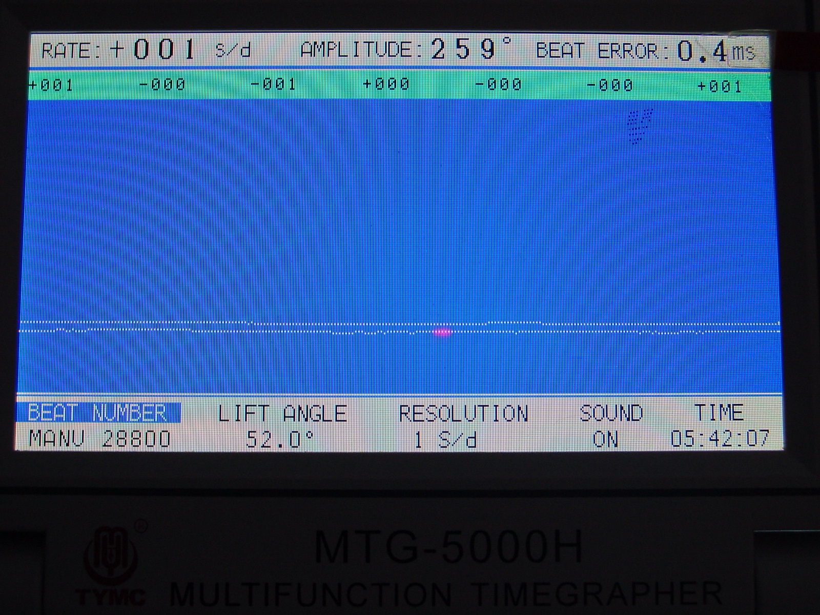

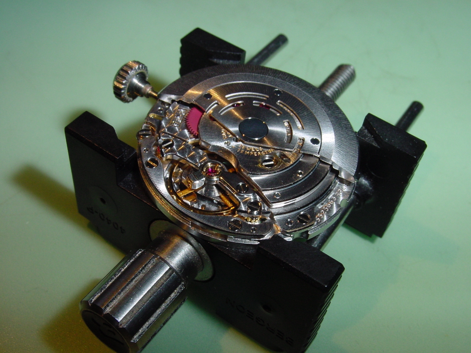

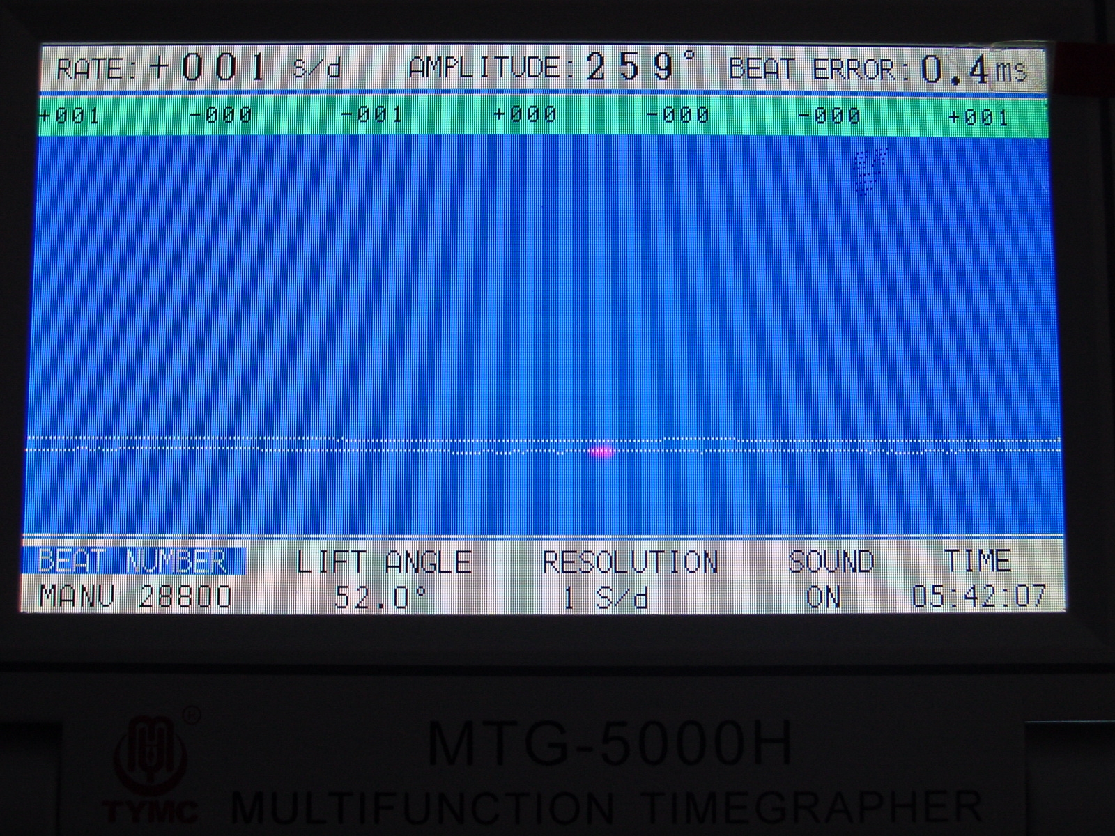

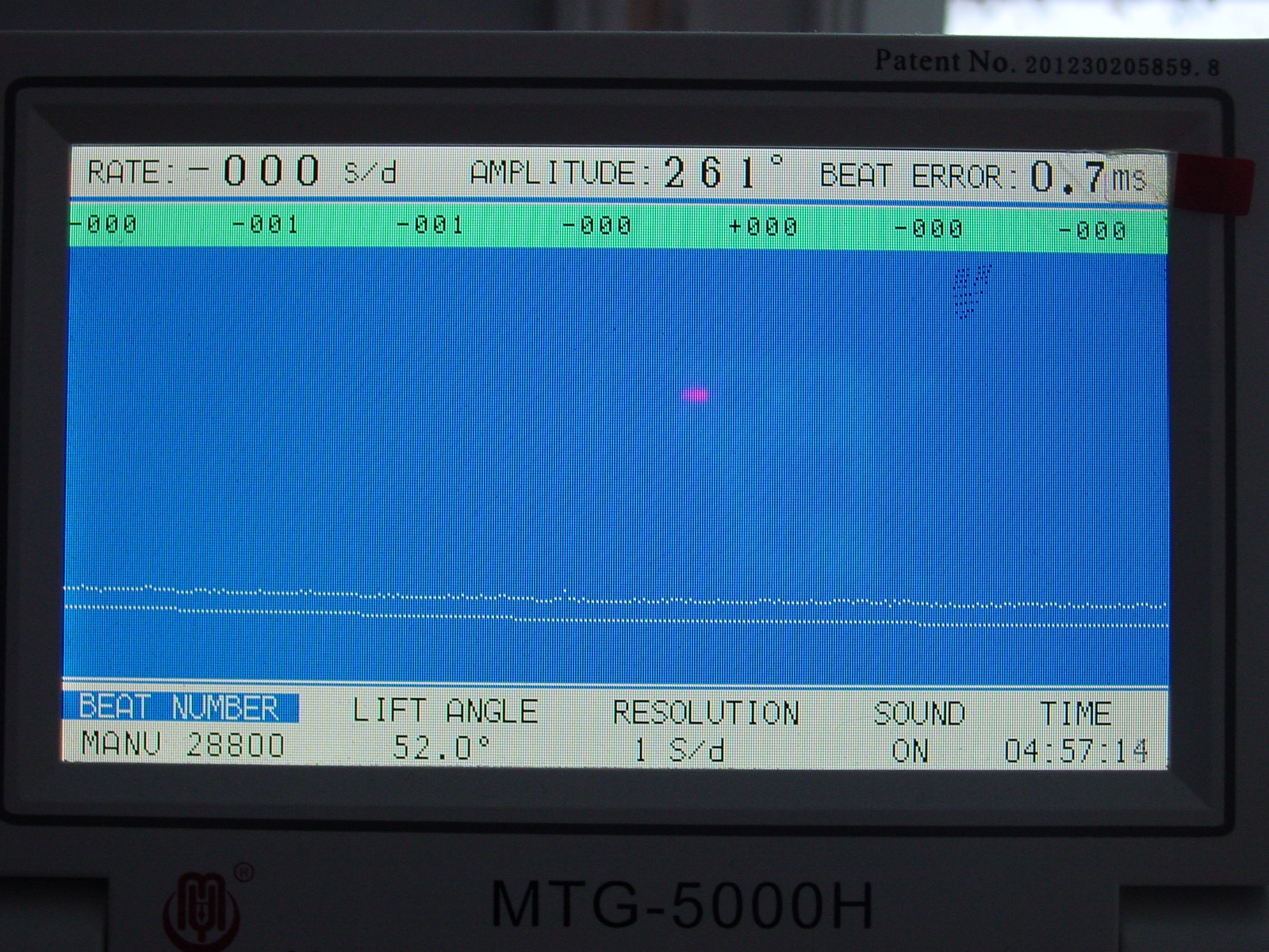

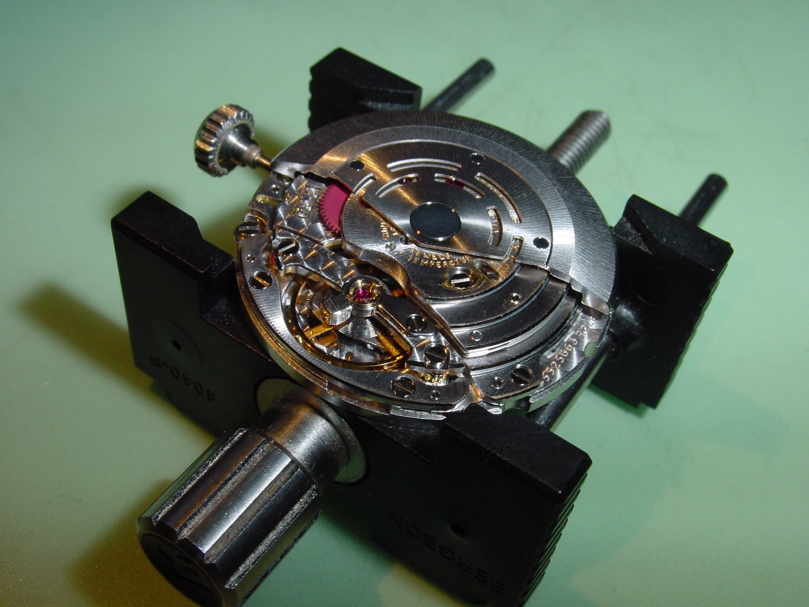

Here is another factor that may have an impact on the amplitude but in this case also seems to stabilize and reduce the beat error. I have just made a service of a Rolex 3135 and installed a new mainspring. I was happy with the rate and amplitude but thought I have to adjust the hairspring a little to get a better beat error value. My first check in the timegrapher was before the automatic part/rotor was installed and gave the following values. Amplitude above 261 and beat error 0,7 MS. Then intalling the automatic part/rotor and the following values occure. Amplitude up to 260 and beat error 0,4 MS. As said before...many small things will have a huge impact.
