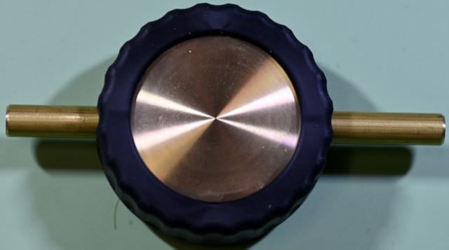

Received my Pahawi's Custom Made Speedy Case back Opener yesterday. What a superbly crafted tool.
Thank you Pahawi
1,206
3,646
Thank you Pahawi
Thank you, Sir 👍

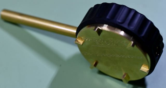

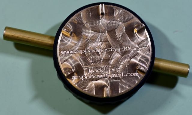

Super cool & useful tool to own! I wonder if this can be 3d printed with rigid material and maybe functional, I think that would reduce the chances of toolmarks incase someone forgets to use a layer of a ziplock bag between the tool & the case-back. Just a random thought…
6,609
26,777
Well for peace of mind, brass is a 3.0 on the Mohs hardness scale, which is a bit less than stainless steel 👍
5,700
9,501
Used that for all these years on many Speed/Sea300/Railmasters without an added layer of Plastic and: No scratch at all....
