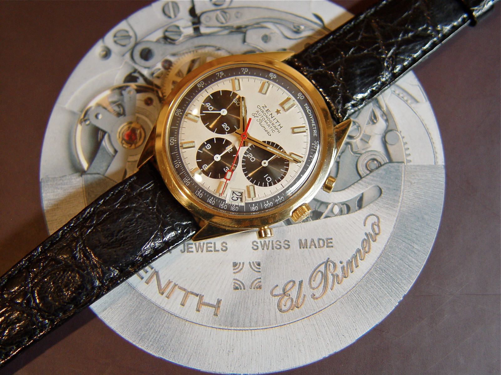

    that's a good point. It shares the case with the other G 58x references, which seem to have a polished bezel, but brushed lugs

    I have a fine G581, and the lugs are indeed brushed, not polished.

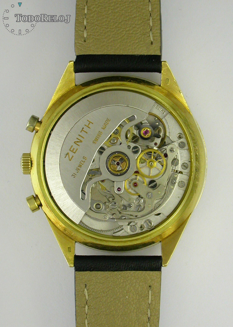

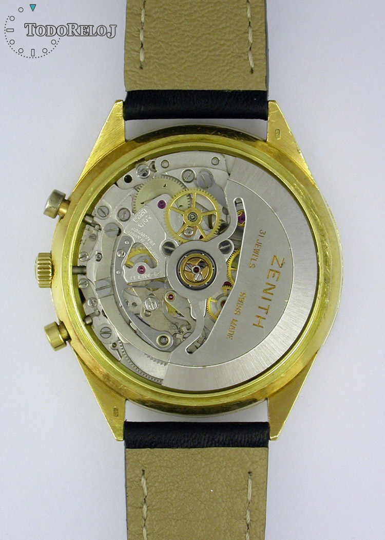

    Well here are some pictures of another G581 movement (case # 485Dxxx), which has some of the features mentioned but not others. Note also the different ball-bearing/pivot arrangement for the rotor. A "replacement" 3019PHC? I don't think so. What would be the point? Experience suggests that hard and fast rules like BGBG proposes were seldom in play at the Zenith manufacture. But further research may convince me! By all means have a go.

    According to the technical manual:
    "In order to prevent the operating lever hook from jumping over the saw teeth of the pillar wheel (8070), we have added a new guard (8157) fixed above the pillar wheel by a screw (58157). The latter replaces the former pillar wheel screw (58070)"
    So the presence of this does not preclude the movement from being an early one and would have been sensible to fit at any service after its introduction to prevent damage and/or cost if this were to happen.
