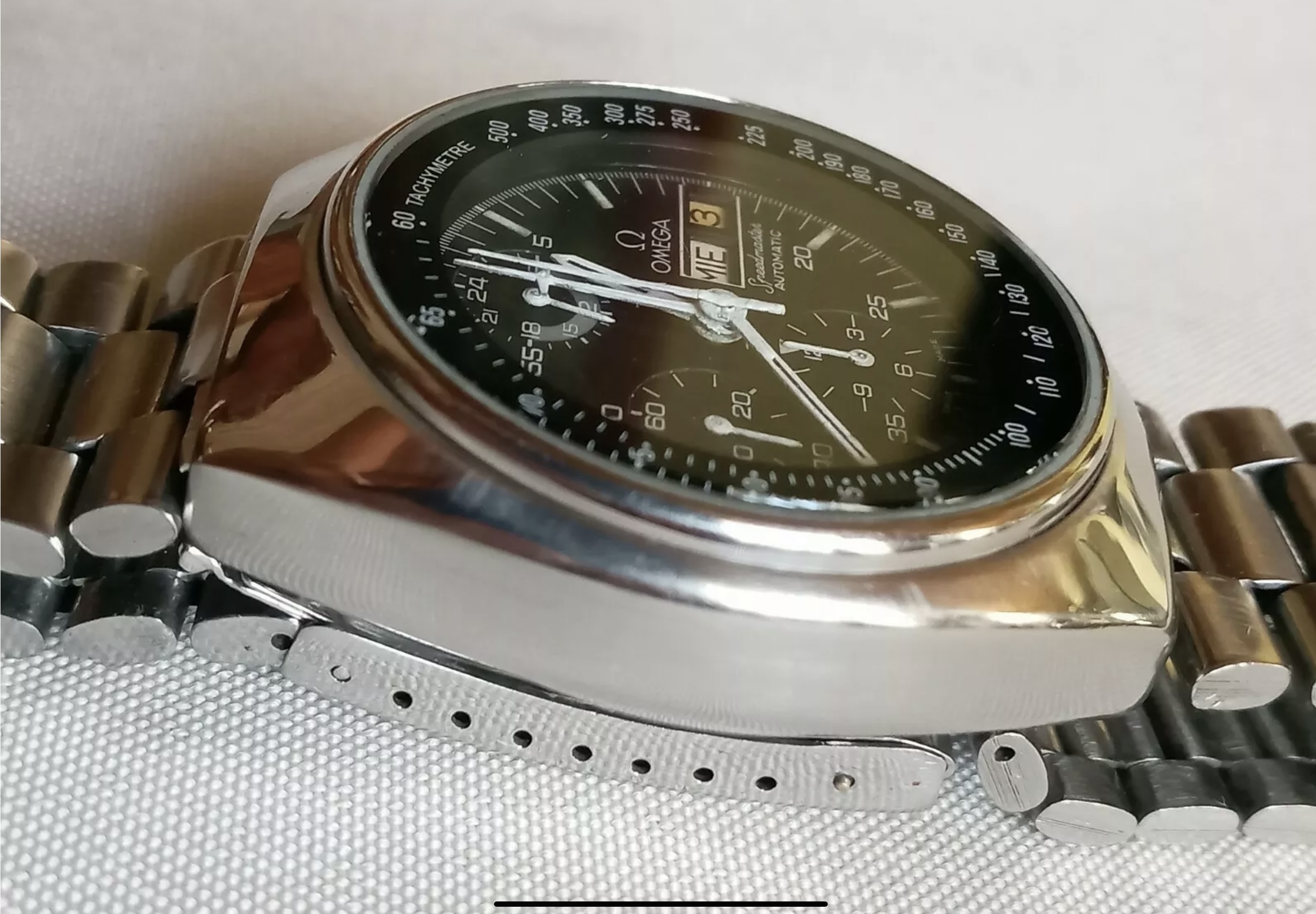

Overpolished POS - Can You Top Speedmasterfan88's Find??

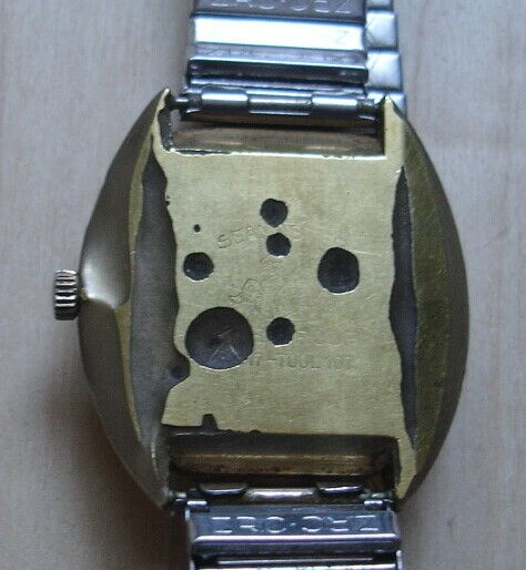

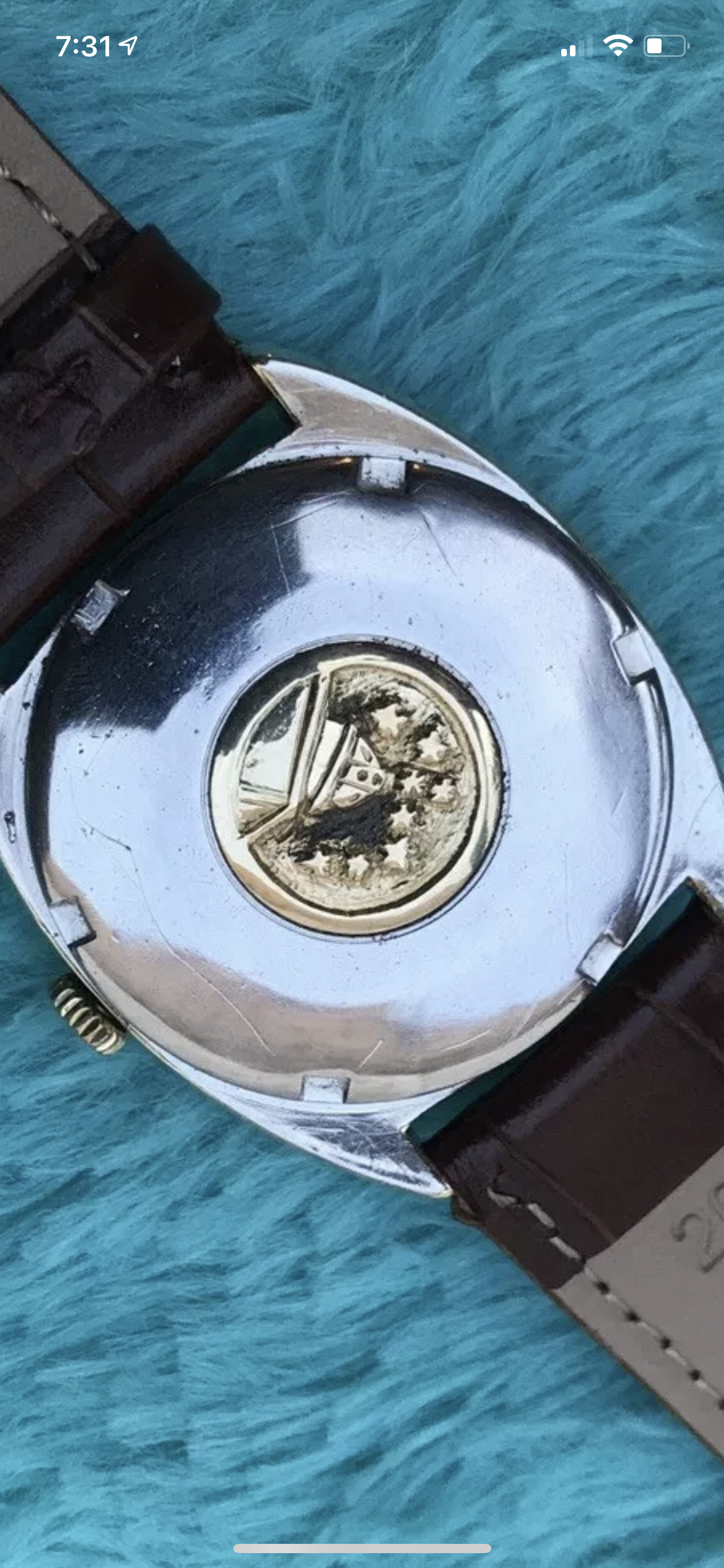

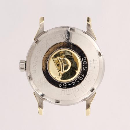

Can someone explain to me what happened to this? Looks like someone didn't have the right caseback tool so tried to drill / grind their way into it?

Body sweat/acid + 40 years.

So I actually looked up what could cause the body Ph to drop to the levels of causing this kind of acid sweat- watch your diet and alcohol intake. The owner of that watch probably died of some seriously bad lifestyle choices

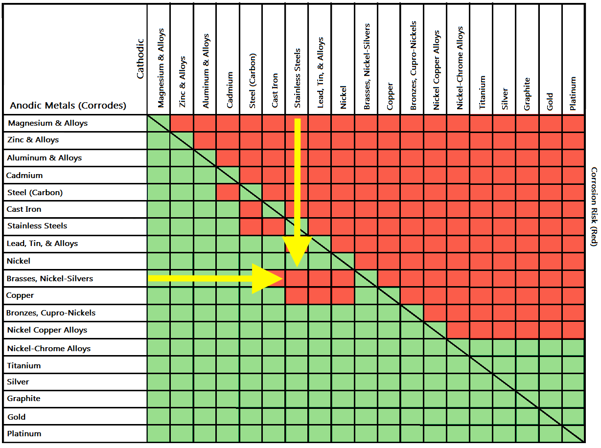

Looks to me more like a case of dissimilar metal corrosion/galvanic corrosion. The mild solution of perspiration acts as an electrolyte and when you get two unlike metals in that solution corrosion takes place.
So, add a stainless steel bracelet and a brass case with worn plating and a humid sweaty environment, possibly marine, and it doesn't take long.

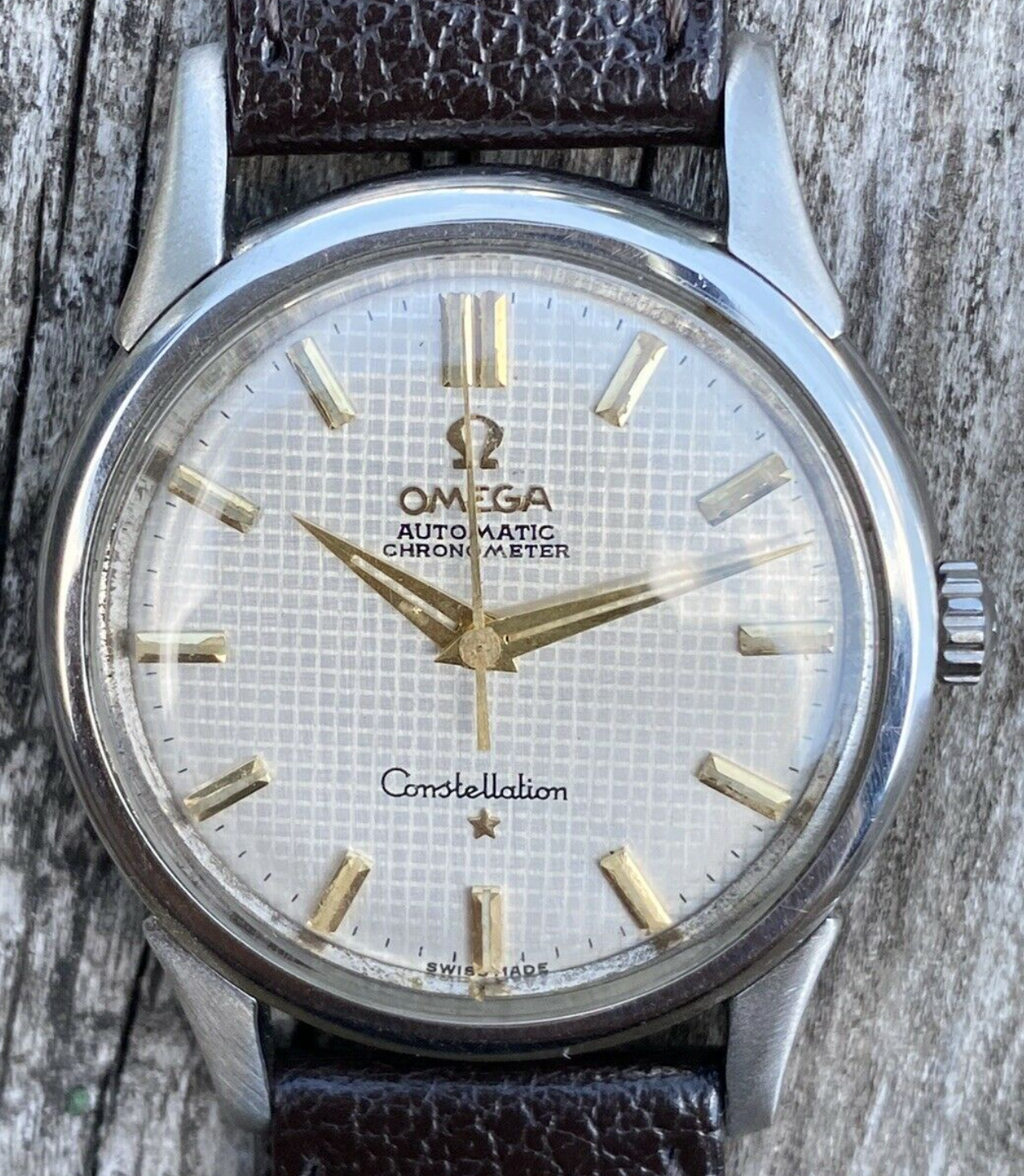

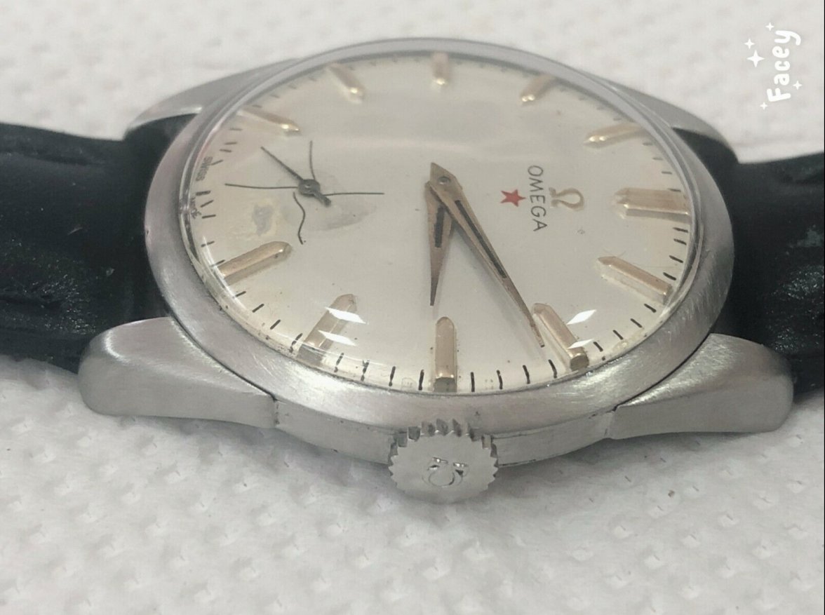

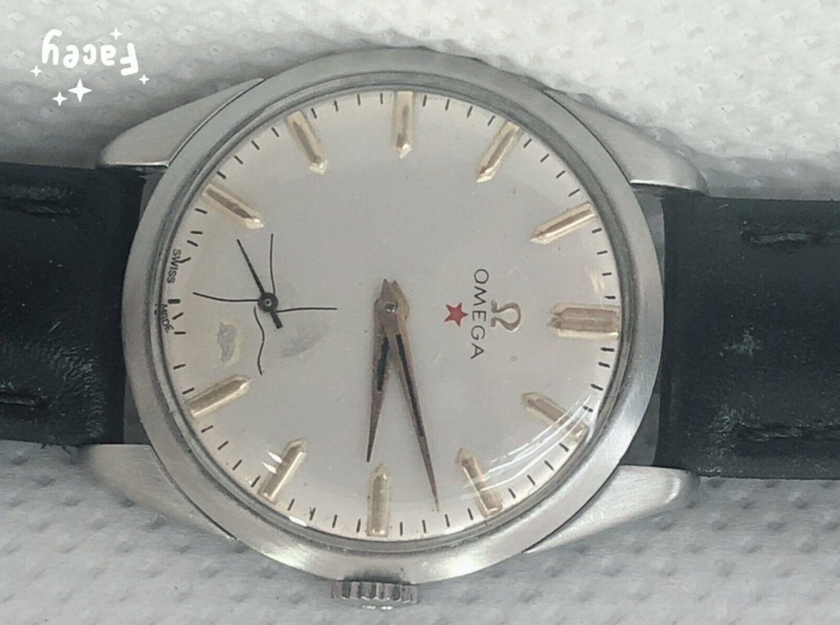

A bit of light pollution has obscured a few of the little stars in this constellation

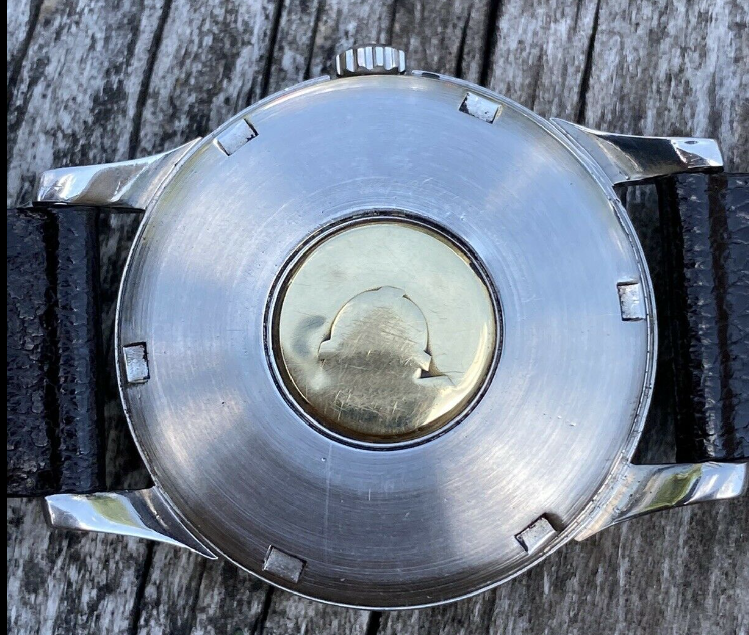

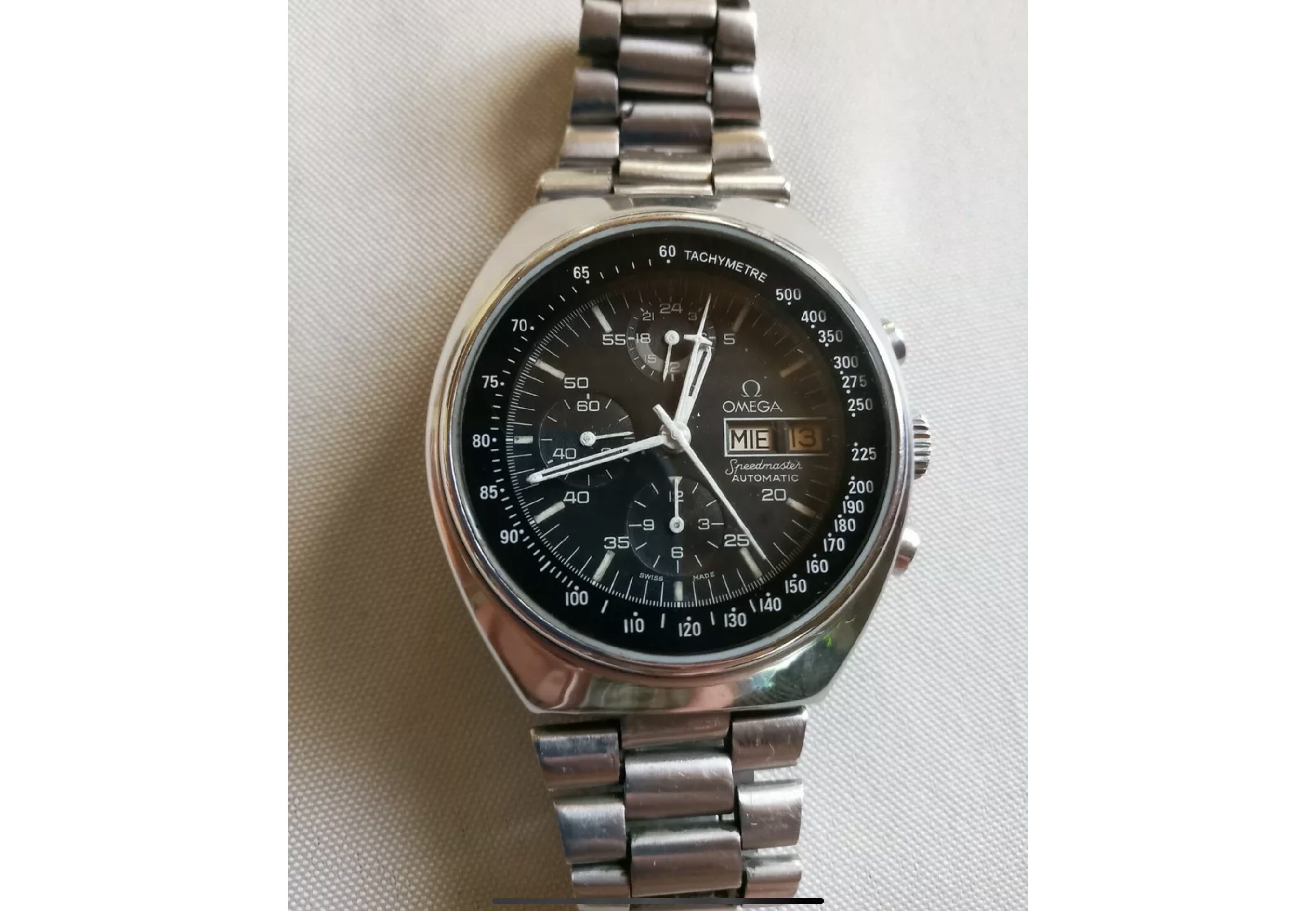

Mmmmm, shiny.
Over the years, lots of posts on shops that specialize restoring the brushed finish on these. This watch is a crime scene.
