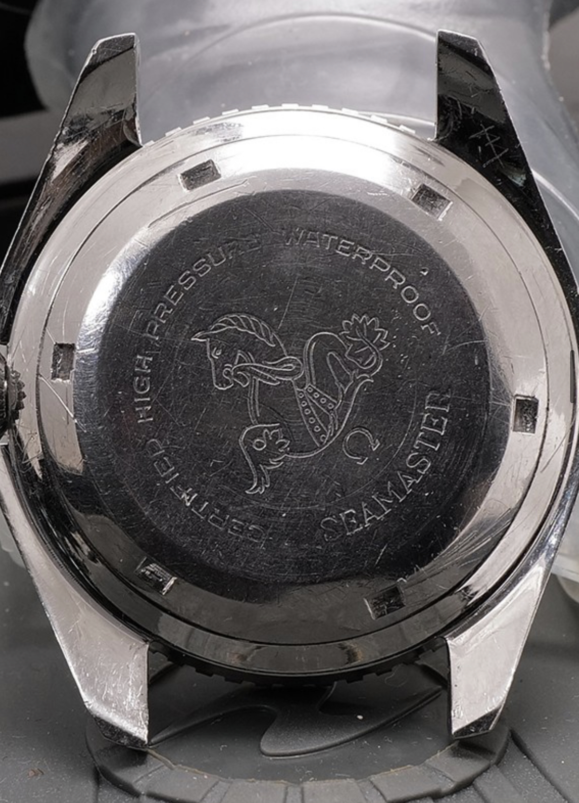

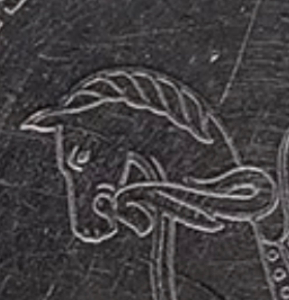

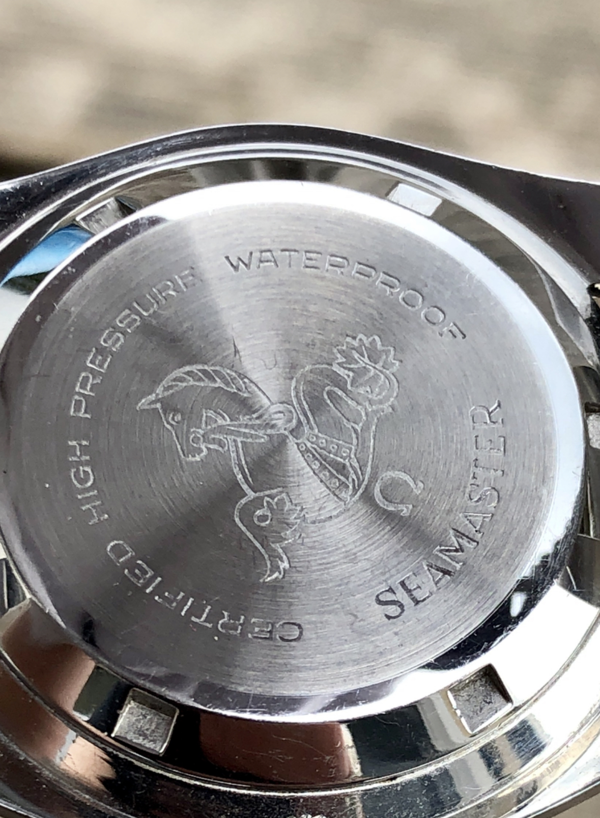

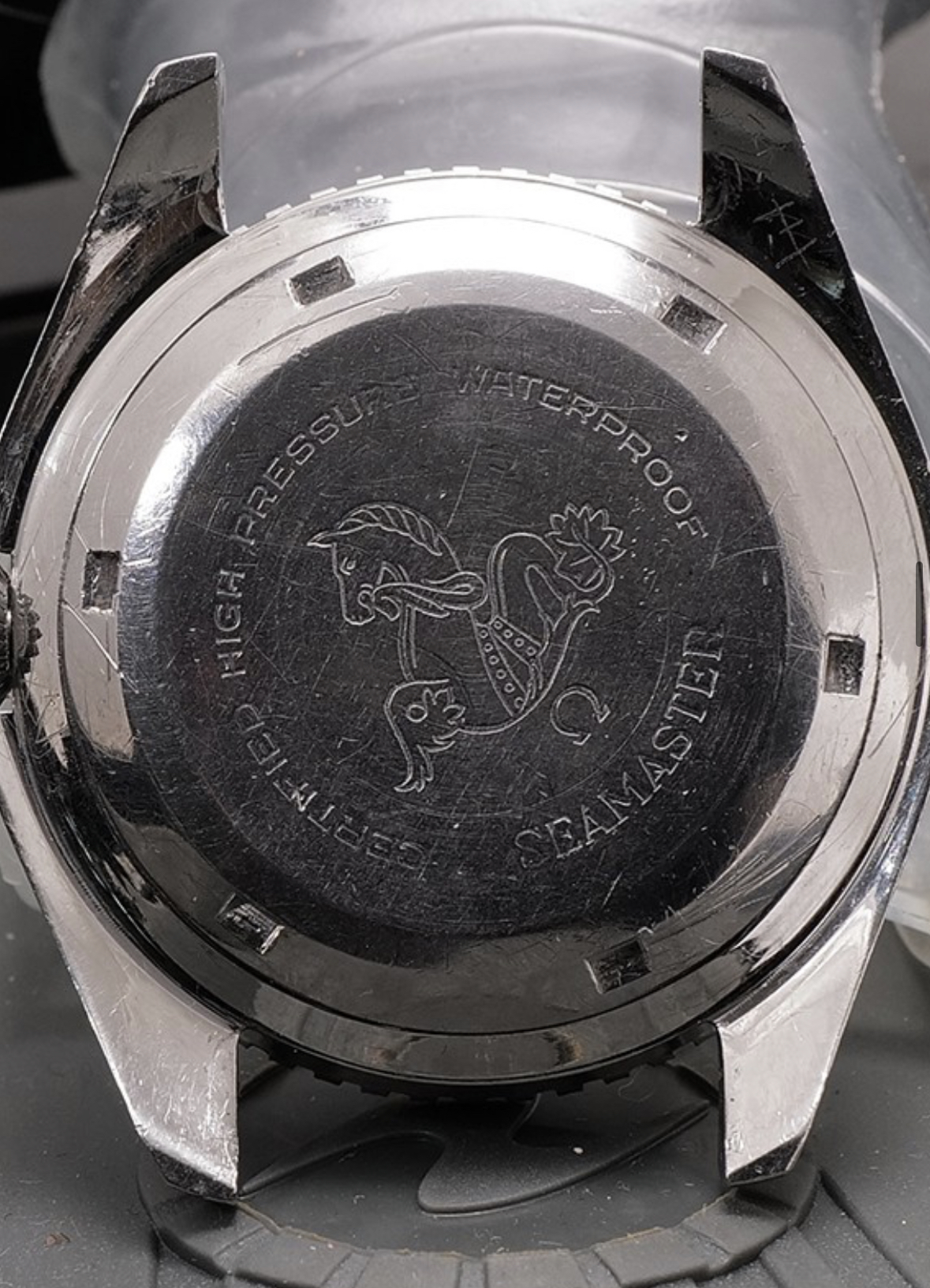

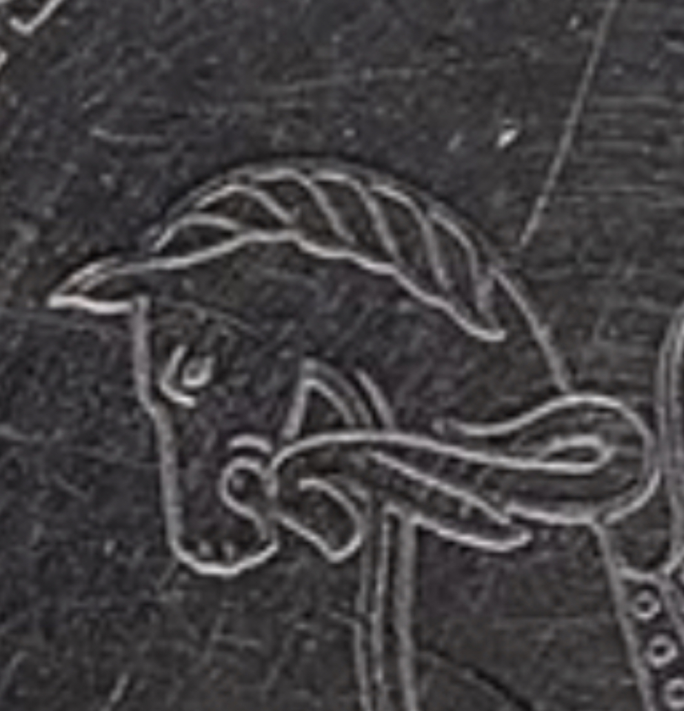

The case back looks genuine to me, same fonts as mine..
109
105

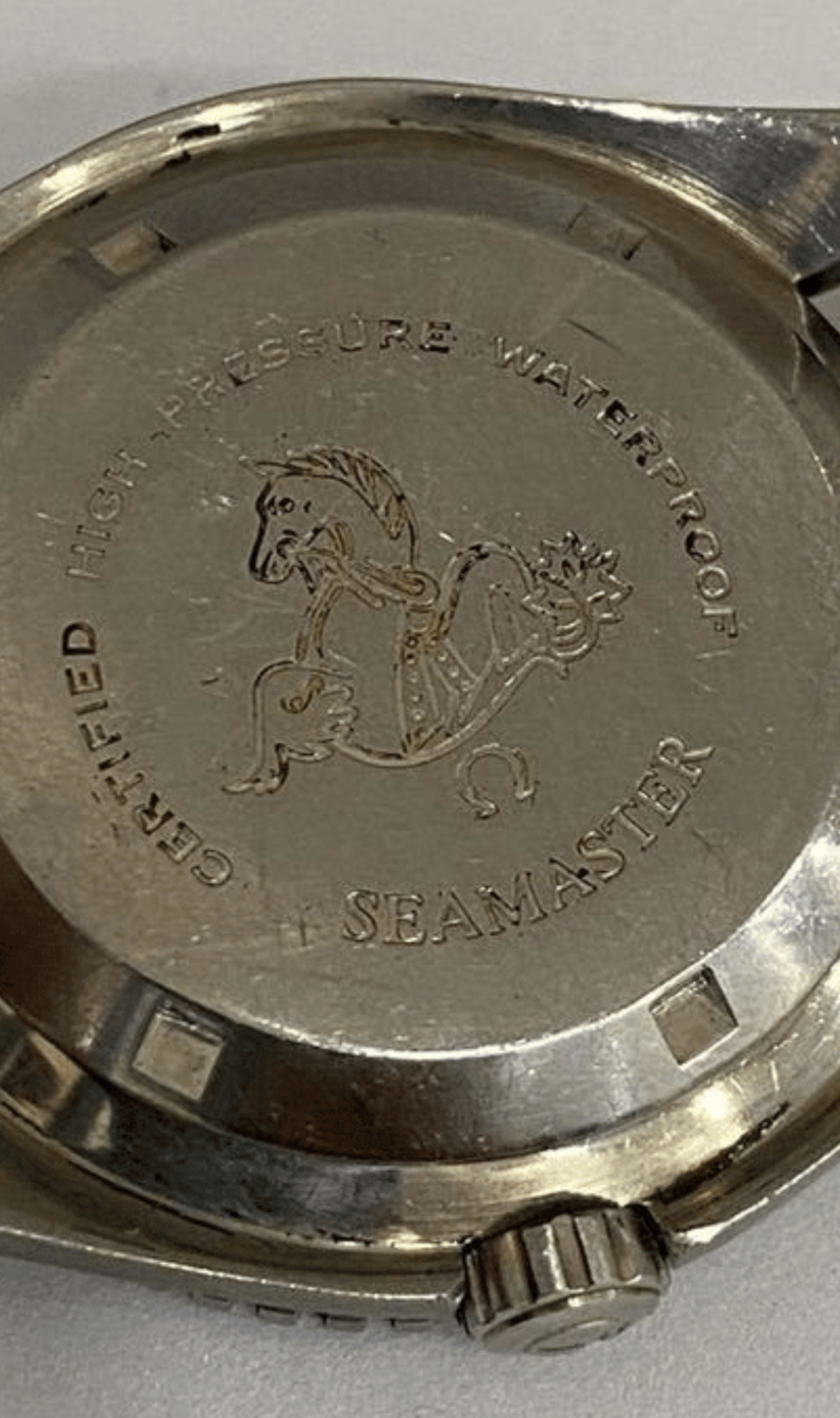

So is it a fake back? What gives it away?

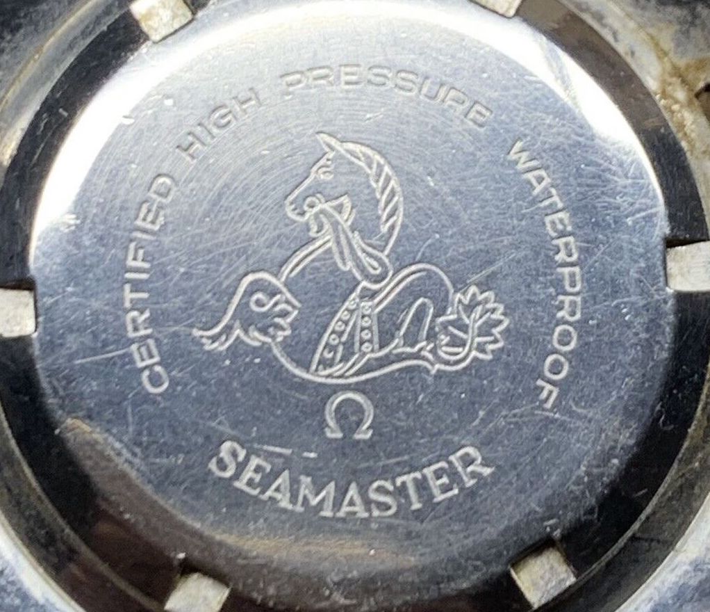

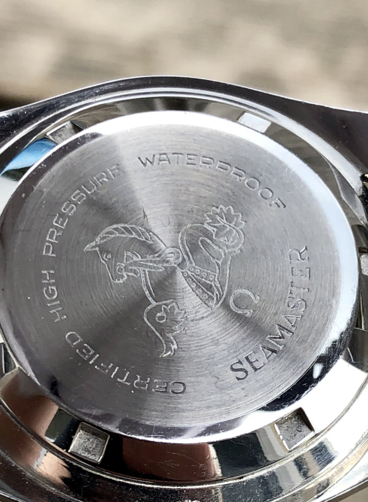

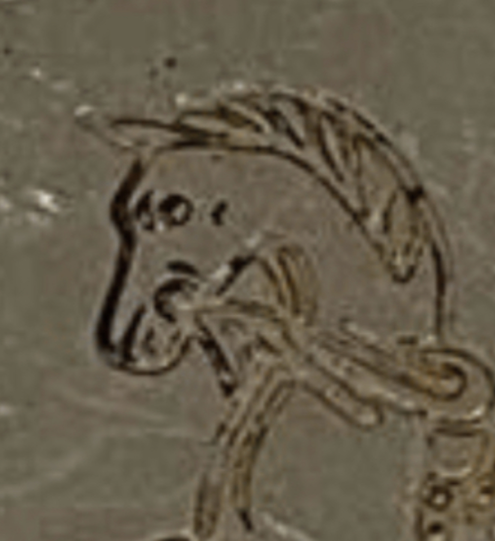

This is the back from my one:
109
105
Other than oyster perpetual I don't know what op means😕
6,609
26,776

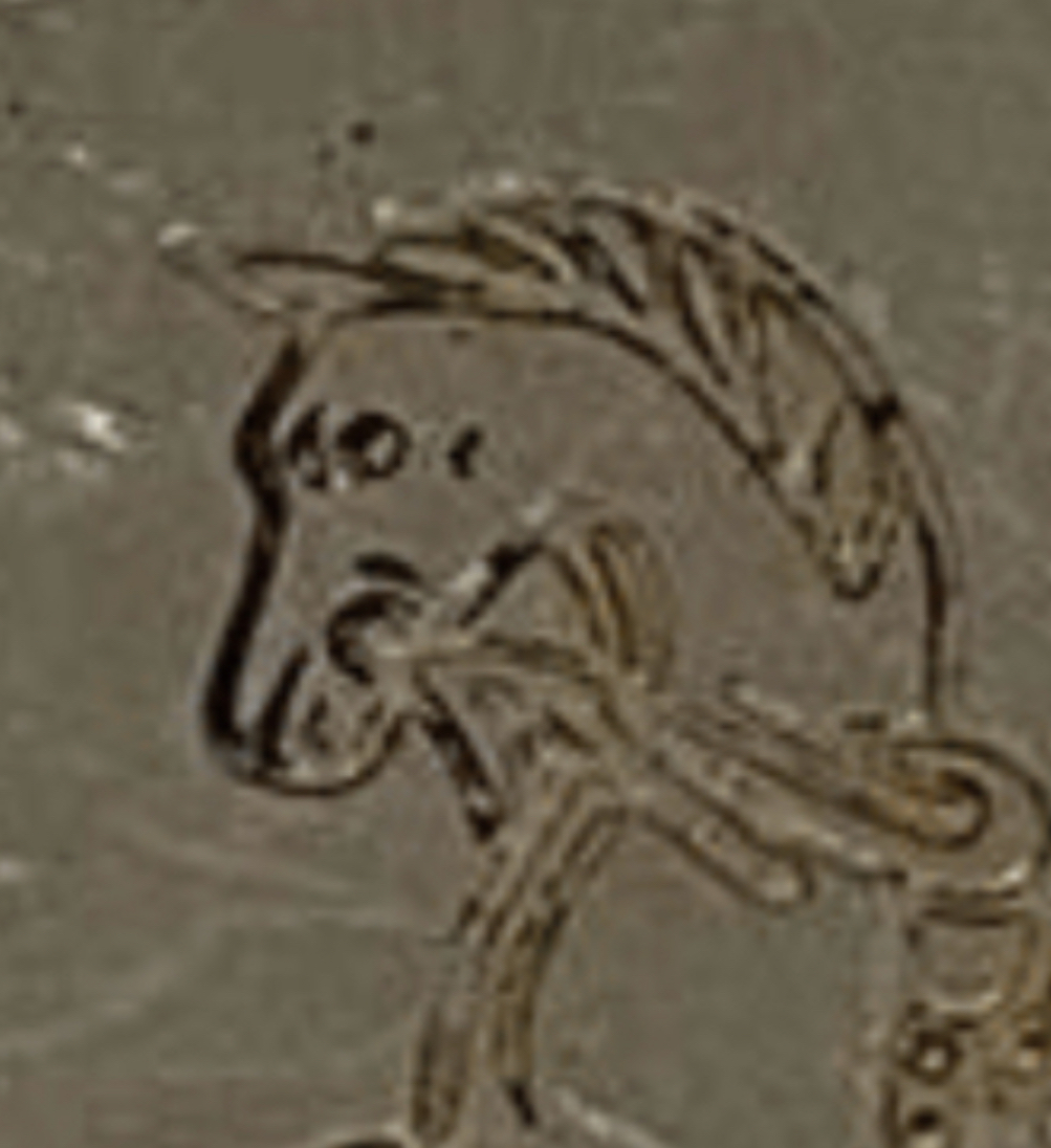

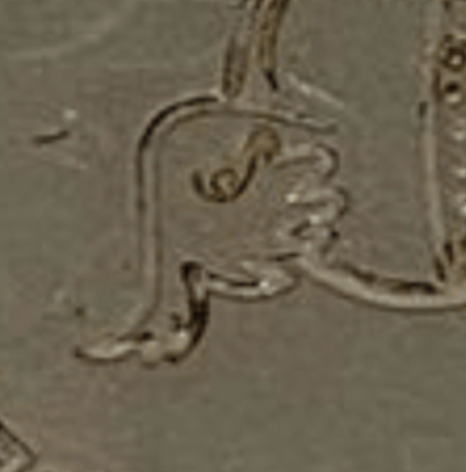

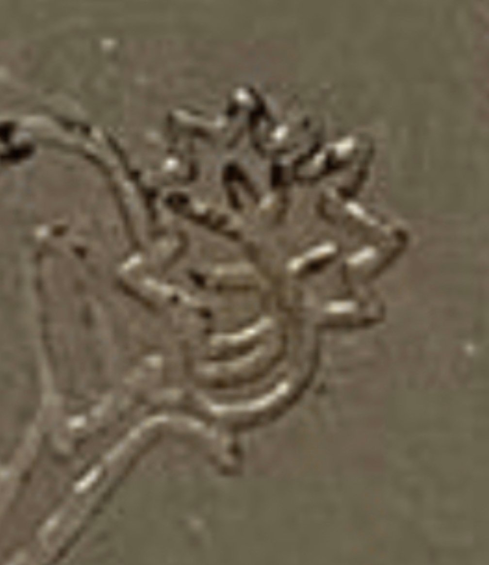

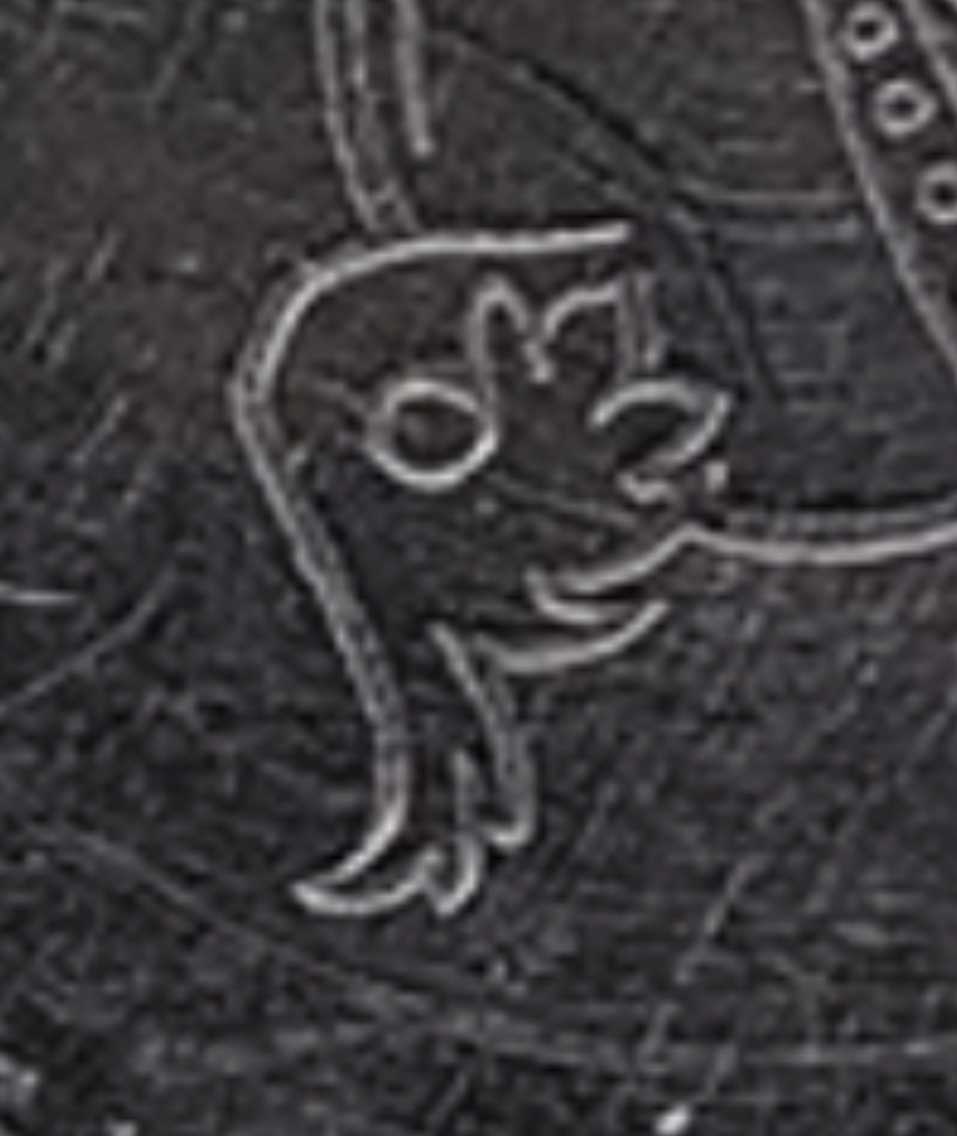

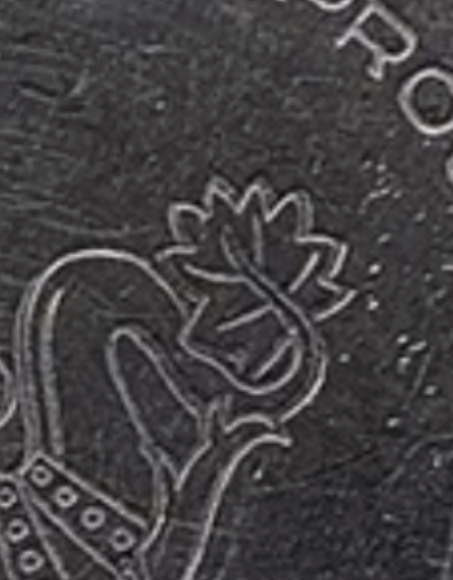

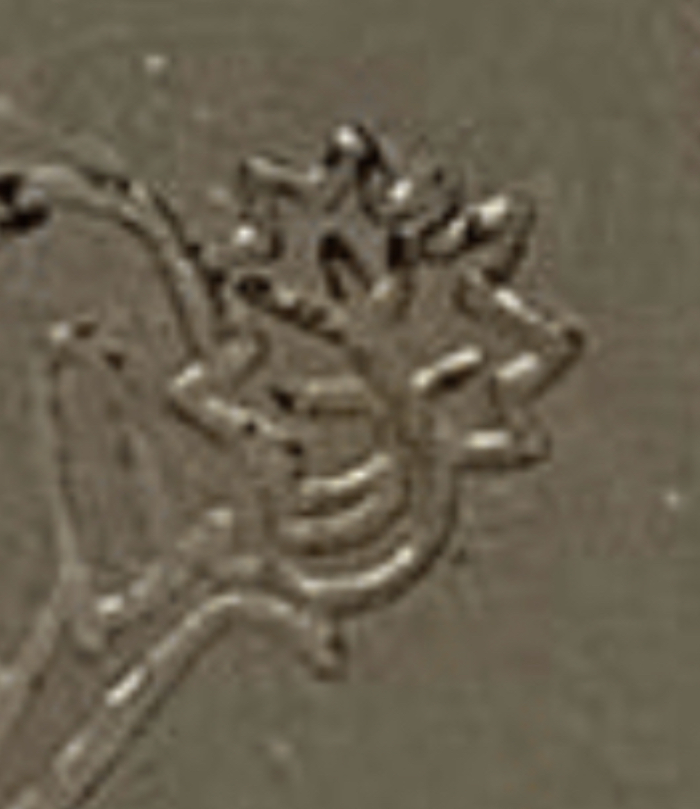

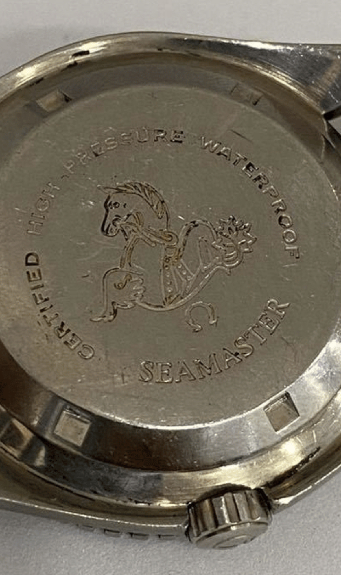

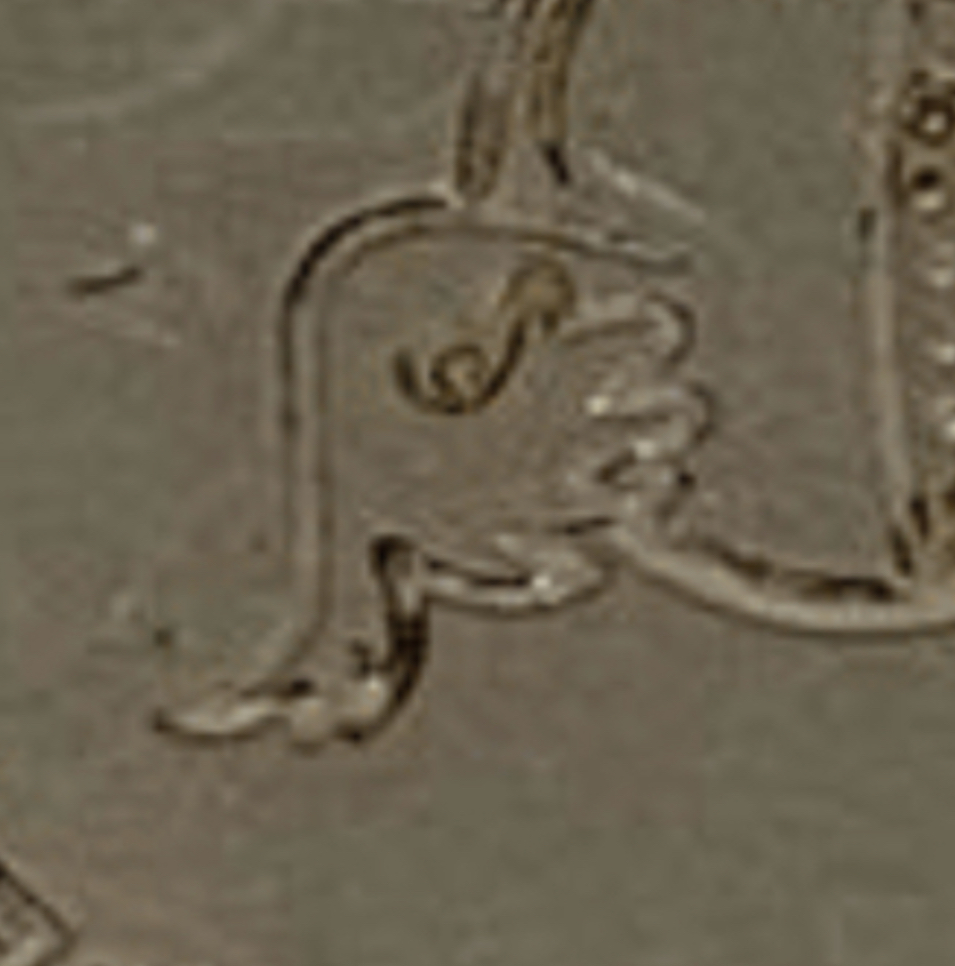

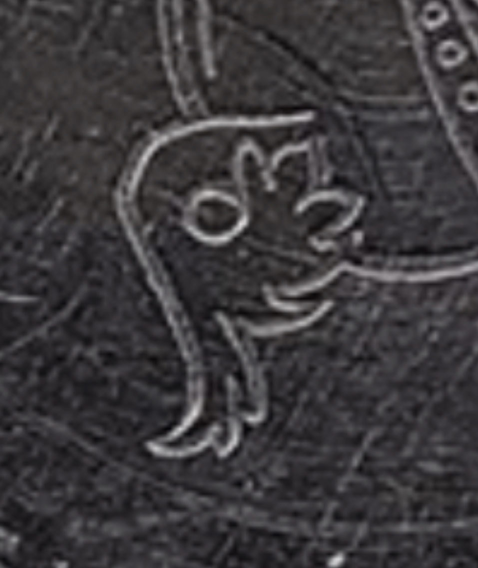

OP means original post. The fonts don’t match, but for me the hippocampus is a huge factor. Just go back over and look at the lines and details. I’ll point out a few:
What even is this? It’s like they got frustrated with the tail and made a scribble hoping no one would notice.
109
105
. Thank you.. Though I'm still struggling to see the telltale signs on the OP 😉 case back
109
105

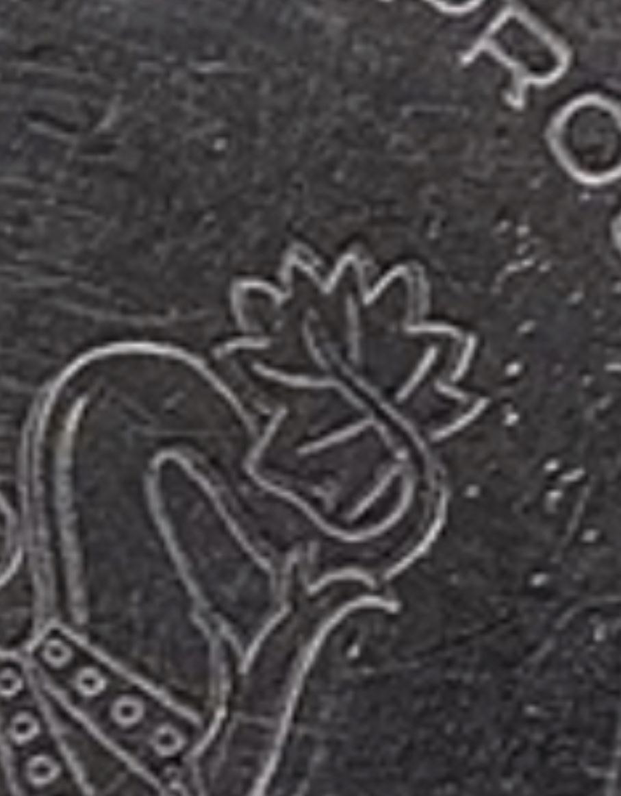

Ok, that's really helpful! It's subtle you've really Gotta have a good eye for these kinds of details.. I was looking specifically at the fonts and they looked okay apart from the R.. But now you point it out, the expression on the head of the hippocampus is completely different.. Especially the eyebrow
109
105

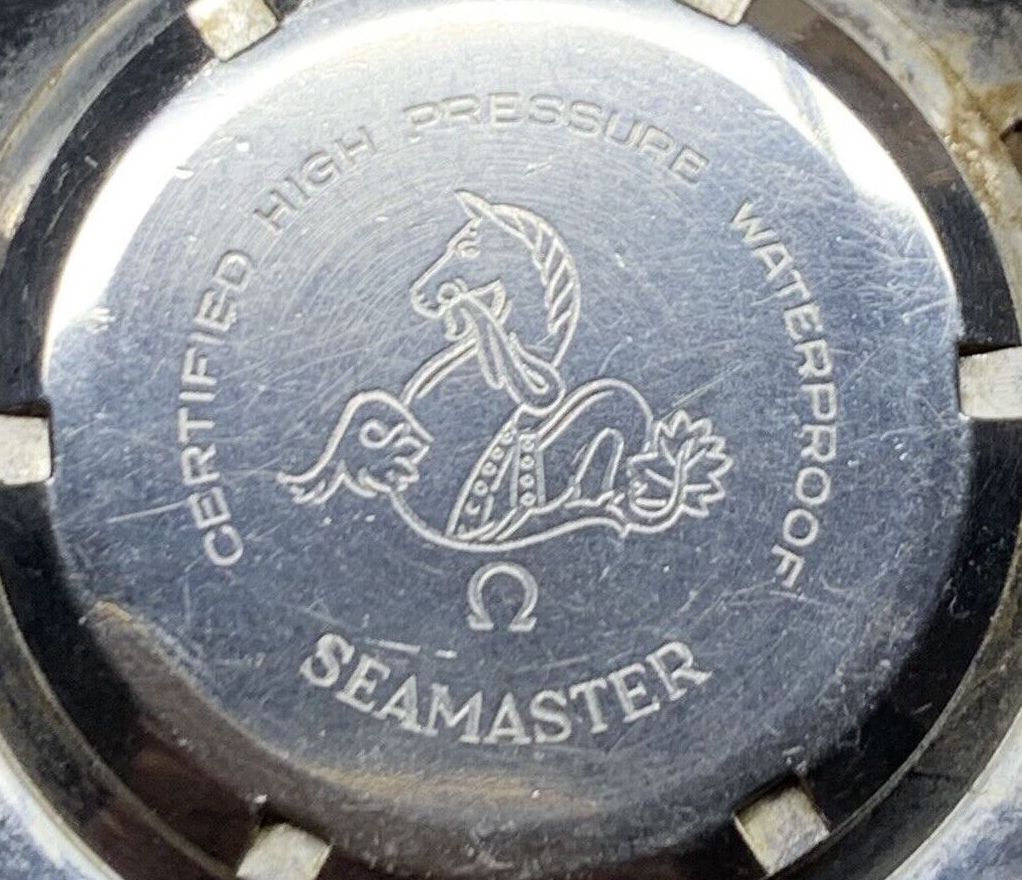

Actually, the more I look at your examples of the hippocampus comparisons the more obvious it is.. And I'm looking at mine at the same time to compare and contrast..
