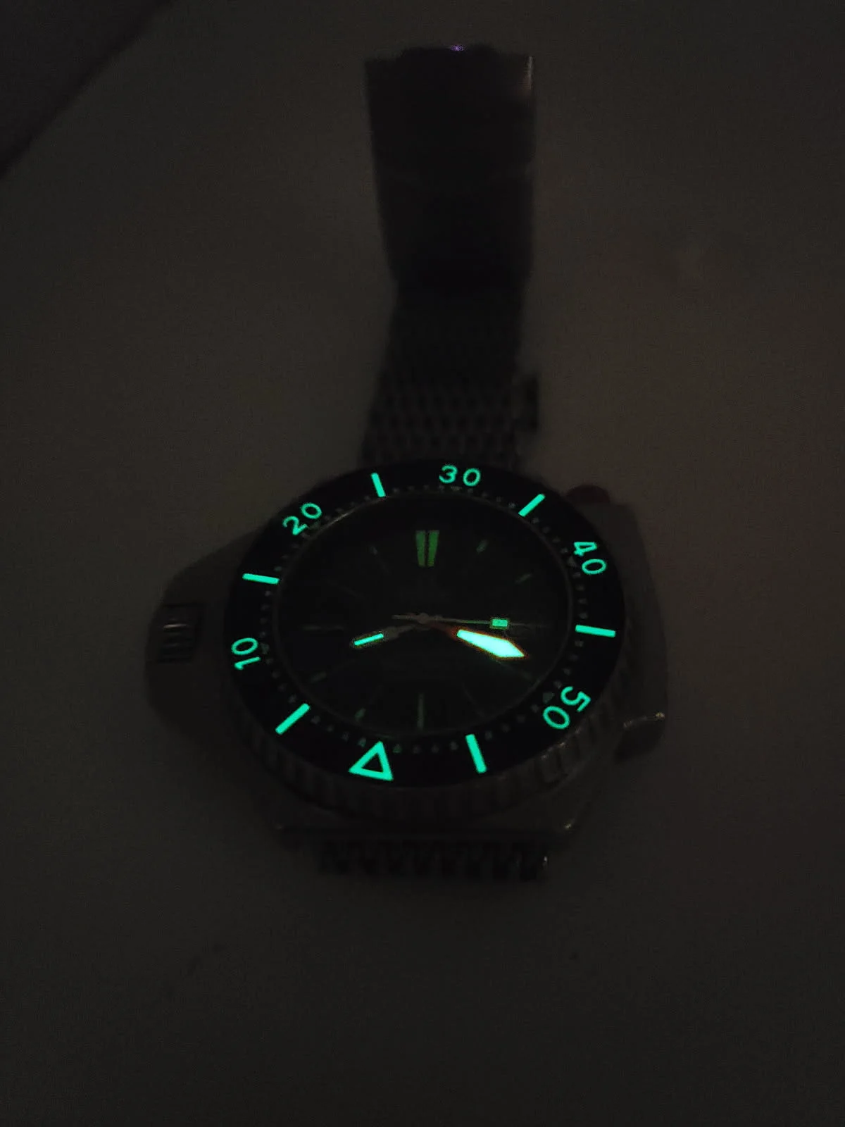

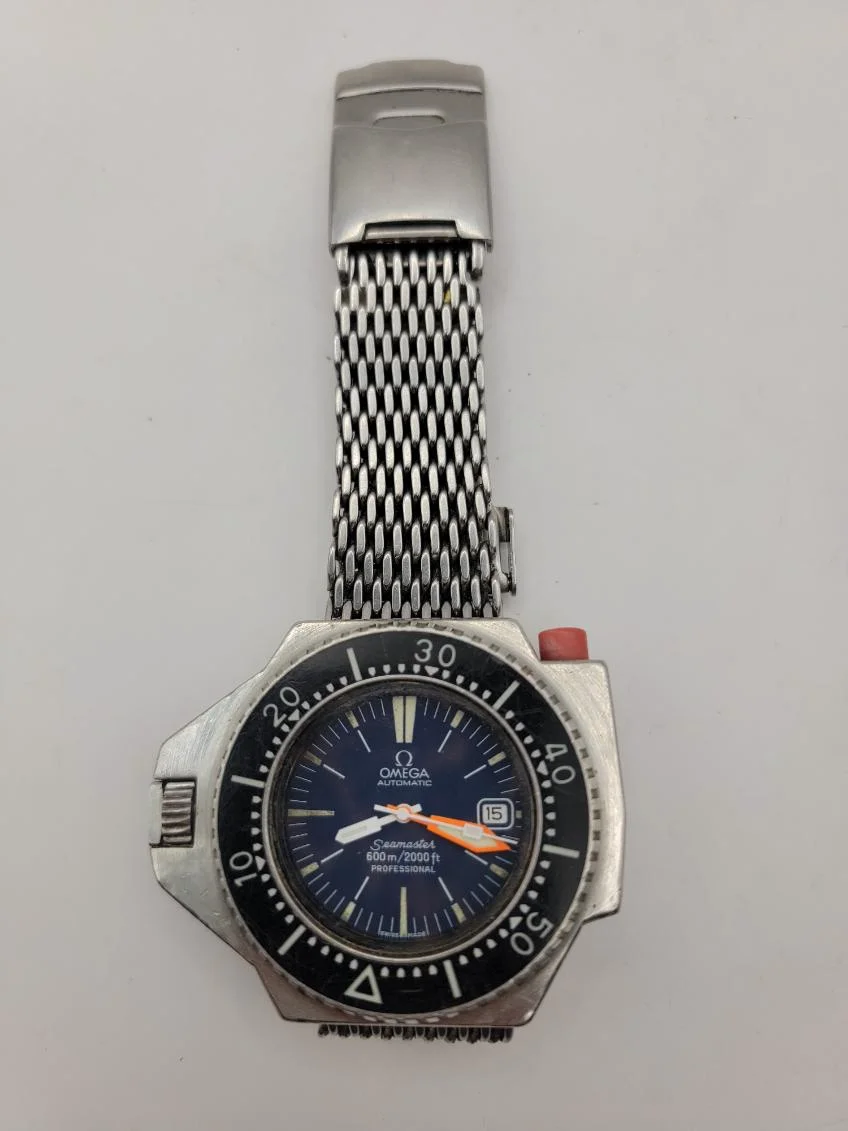

Hello i was givin this watch and was told that it does not have some of the original parts but i dont really know much about them. Any information is very much appreciated.

Service bezel and handset, aftermarket mesh bracelet. Rest serms legit.
thank you that helps tremendously

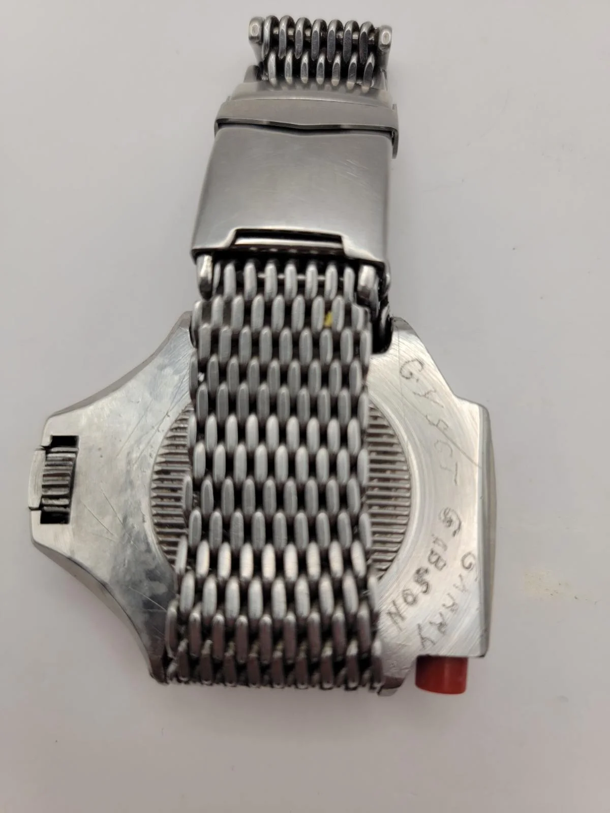

Lucky man! Did Garry Gibson himself gift the watch to you?

yes he gave it to me in person before he passed. he said it kept him alive at the end of the Vietnam war, not sure how though. o was unaware of its value until recently and i am not really a watch person so i have no use for it but to pay some bills
