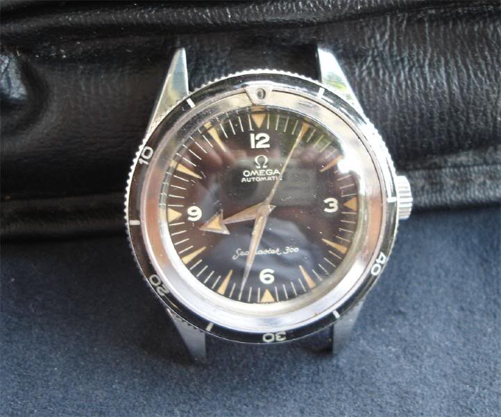

here is my 2913 w original count down bezel....
Good Hunting
bill

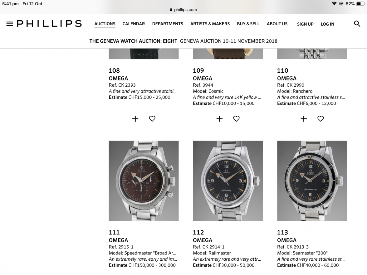

Makes sense to split them. Normally I’d think together is better... but a 600k+ omega auction?
I think they will see more money seperate... also if the watches are from multiple owners how do they split up the results?
SS Rolex flooding auctions ? Who should have thought.... perfect storm for people wanting to sell not quite vintage pieces.

Price estimates are under the listing, just convert from CHF to your local currency...
