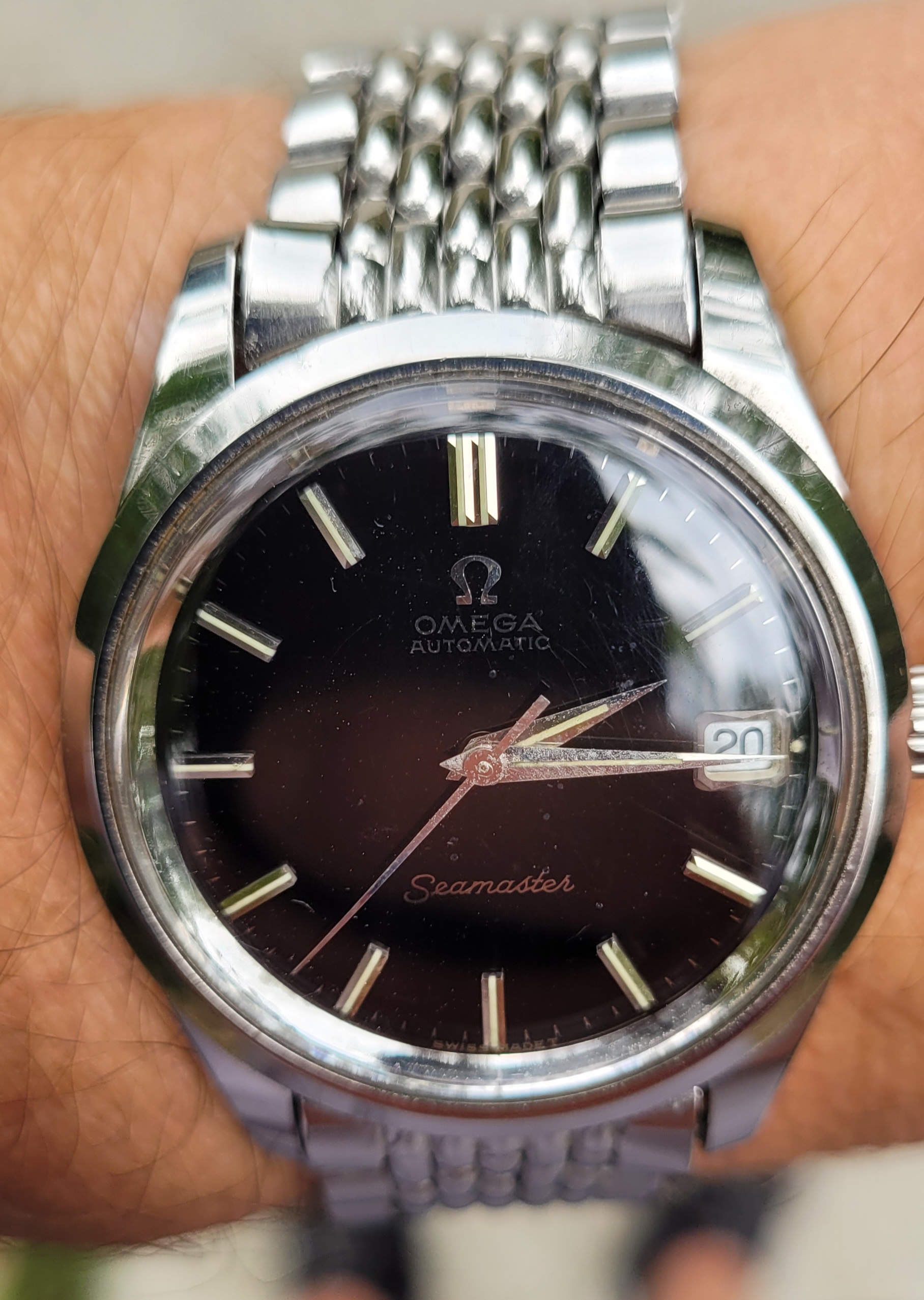

Original Black Dial 166.010?
12
3
The seller has indicated all the parts are original and the dial is original. The case doesn't that polished (I think), and the parts look good. I can't really tell if the dial has been repainted. What do you guys think about the dial and the overall watch?

The watch is a redial and the case is overpolished. I would stay away from black dials until you know what you’re looking for.

Agree. Not a watch for a collector, but at a decent price its a watch I be tempted to buy

Personally I like the watch. I will appreciate more details from the other members of the group with more experience to learn how to spot a redial. What to look for? I also think that for a decent price in's not a very bad buy.

About 1,000 USD
For that watch honestly I'd pass even at $500.
An original black dial would have gilt printing not paint as this one does.

There's a bunch of tips in the how to fish thread: https://omegaforums.net/threads/learn-how-to-fish.52603/
I usually pull up a good example against the example in question for side-by-side analysis.

I did not know that. Any other tips on how to identify if a watch has an original black dial? I usually check the minute markers, and the font.

I attached a copy of my black dial 166.010 bought from a member on this forum

Thanks for the stunning example. If you ever feel like letting it go, I'm always here haha.
