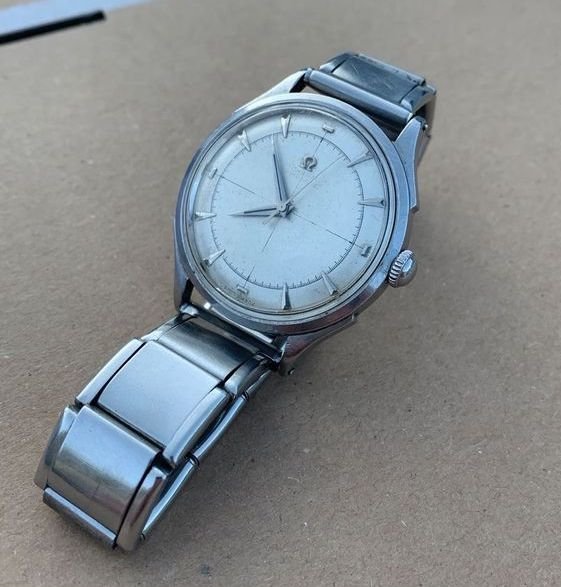

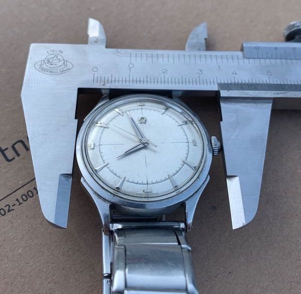

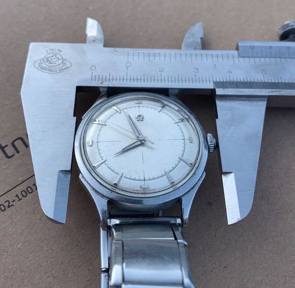

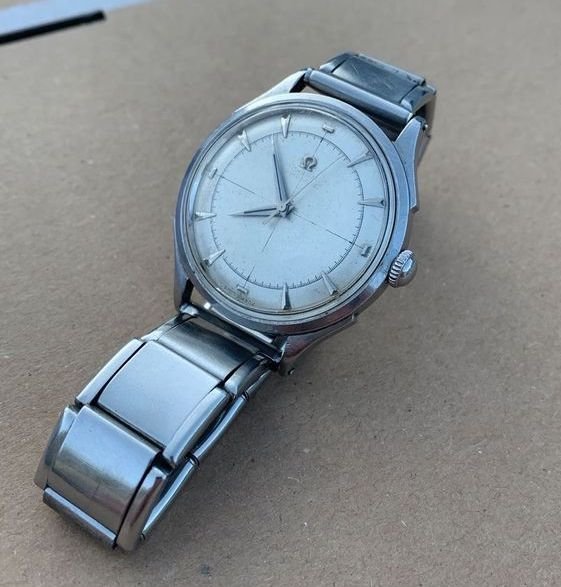

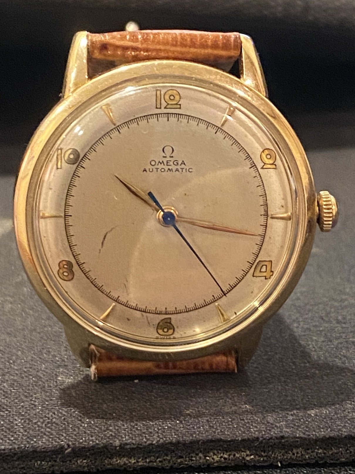

Hello,
Am I getting interested in vintage watches and just came across this Omega online.
The seller just says that it works and does not intend to remove the back case so I have no more information than the pictures attached.
To give a bit of context, I'd like to try my hands at giving a second beauty to vintage watches as a hobby and would love to start with an Omega. My beginner researches lead me to think this is from the 50s-60s, my clues being the absence of logo at the back as well as collection name, and (more importantly?) the crosshair dial, but of course there are strong chances I am completely wrong. I did not manage to find any other model with the same hour markers though.
The price looks fairly good to me (€150). What do you guys think? Any help with identification, dating, and if it can be a good first purchase to start a restoring hobby, even given the lack of information about the movement condition?
Also, as this is my first post on this forum, don't hesitate to let me know if I missed some guidelines.
Cheers!

Welcome! It s a nice model 👍.
On a flea-market: I would buy (unopened) for the 150! It s a steel-model-so less a dress watch and can have this "patina".
At first glance: around 1950 or before....
just my2cents

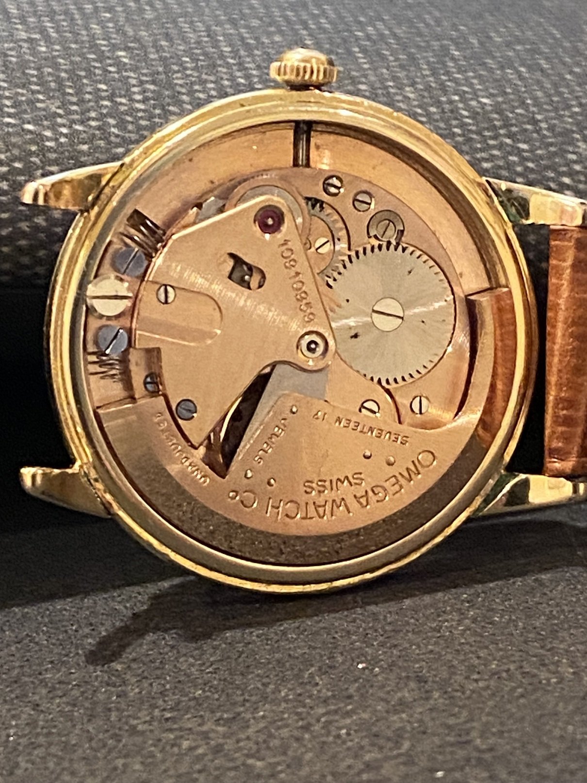

I still can see the Automatic on the dial and the logo with rounded edges. So, it could be powered by a bumper 354 or 351 maybe?. €150 is ok to buy.

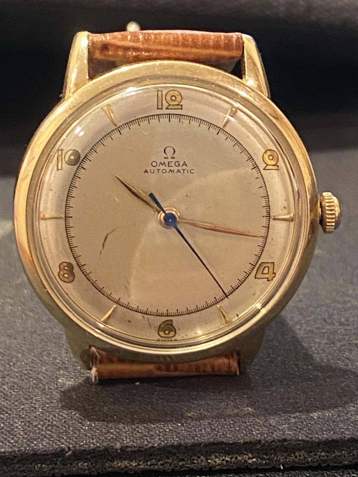

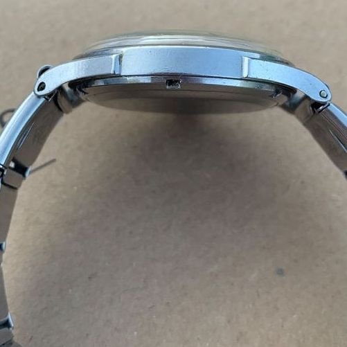

I'm guessing that this is either a 28.10 or 351 bumper auto. I attach a scan of my 28.10. 150 euro is a great price if the movement is turning. I would ask seller to rotate the watch back & forth a few turns to verify the seconds hand moves. It should as the 28.10 and 35x series were all shock protected.

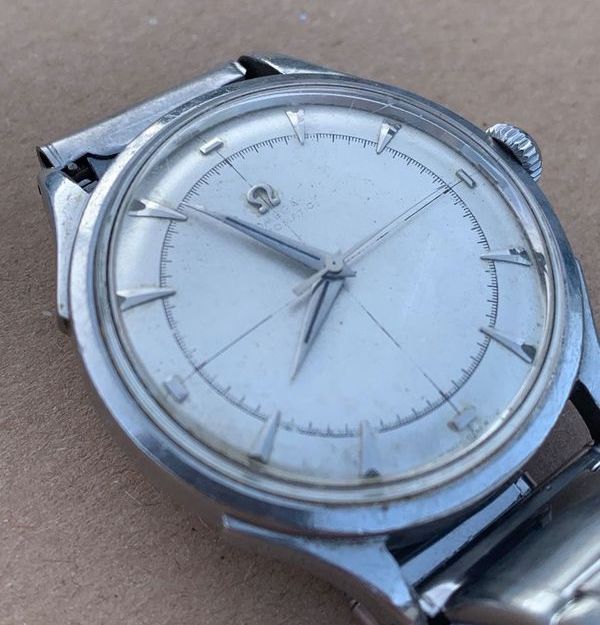

The price isn’t crazy, but it looks like someone attempted to clean the dial and pretty much ruined it. I’m not sure what restoration you are considering. Are you planning to hunt down a replacement dial?

My observations:
1. This is most likely an early Seamaster model, circa 1948-51. Some models did not have the name on the dial.
2. There is no point in cleaning the dial as someone has beat you to it. It looks to me as the original lacquer finish has been removed chemically. That probably took part of the original dial printing with it. If you go any further, you may lose the rest of it.
3. Probably worth the €150 they are asking, but negotiating a few euros off couldn’t.
4. I’ll echo what other above have said about trying to learn how to service a watch here. This is probably not the one you want to try first.
Hope this helps,
gatorcpa
10,827
16,846
Personally I think it is actually what is now known a pre-Seamster. By which I mean it actually predates the SM brand which was launched with the 2576 and 2577 models in 1948. I agree that those also didn't have SM on the dial for the first year or two but that looks more like the waterproof bumper models seen 1946 -1948 which were never actually acknowledged under the SM sub-brand. The model number will tell all but I suspect the serial is in the high 10m to very low 11m region. Would I buy it for €150? Yes I would, despite the less than optimal dial.

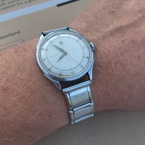

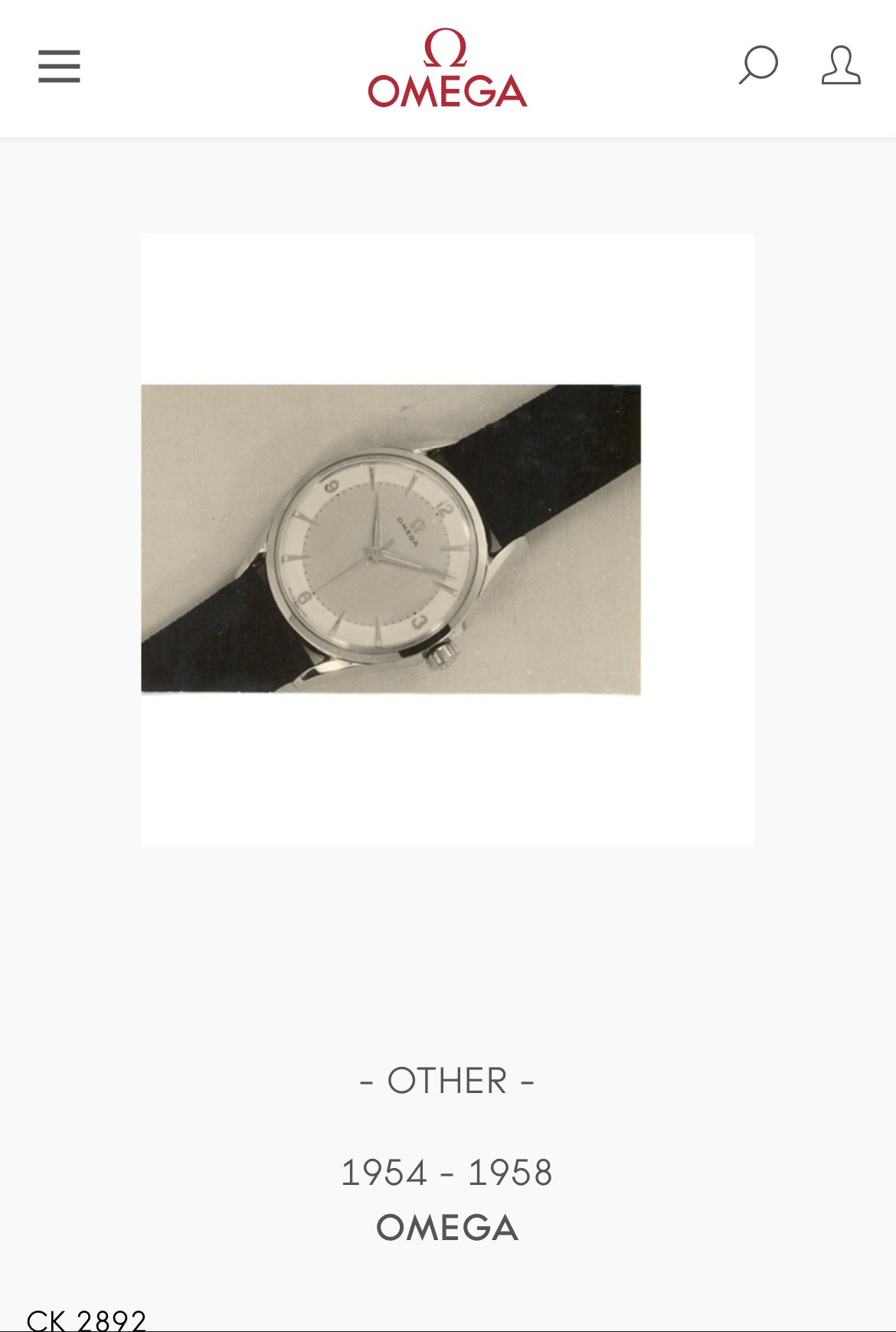

Is it automatic? If not, then my guess is CK 2655. Either way, its battered character is irredeemable, and the perfect way to wear a beauty without worry. Buy, open, report back, but please don't "restore".
PS Please get it off that bracelet.

As several people have suggested, the loss of the printing in that way (the text and crosshairs) is typically due to a failed cleaning attempt. If you try to clean the dial, you will likely make it even worse. As you note, finding the correct replacement dial will likely be difficult. For those reasons, as a collector, I would not buy this watch, even though it's cheap. I can tolerate almost anything else for the right watch, but at this point, I won't buy a watch if I can't live with the dial.

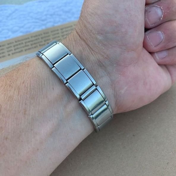

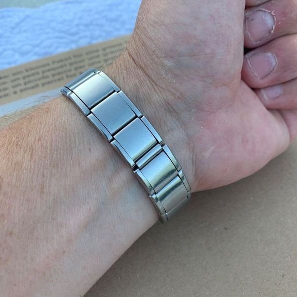

The bracelet is one of the best features of the watch IMO. Not Omega, but those Expandros are cool vintage expandable bracelets.

I actually think the watch might be enjoyable. It will likely never be collectible and the dial is not salvageable,* BUT in my opinion the ruination of the dial has a striking look. I’d probably buy it at €150, especially on that nifty bracelet. It might still look good on a leather strap.
That said, the way it typically goes is you buy a watch cheaply, get interested in the model, do research, learn how a well-preserved example looks and then yours inexorably begins to lose its appeal.
But hey, we know when we get a pet it will inevitably break our hearts by dying. I think you can get €150 worth of enjoyment out of this watch. Maybe more if you don’t succumb to the temptation to make it worse.

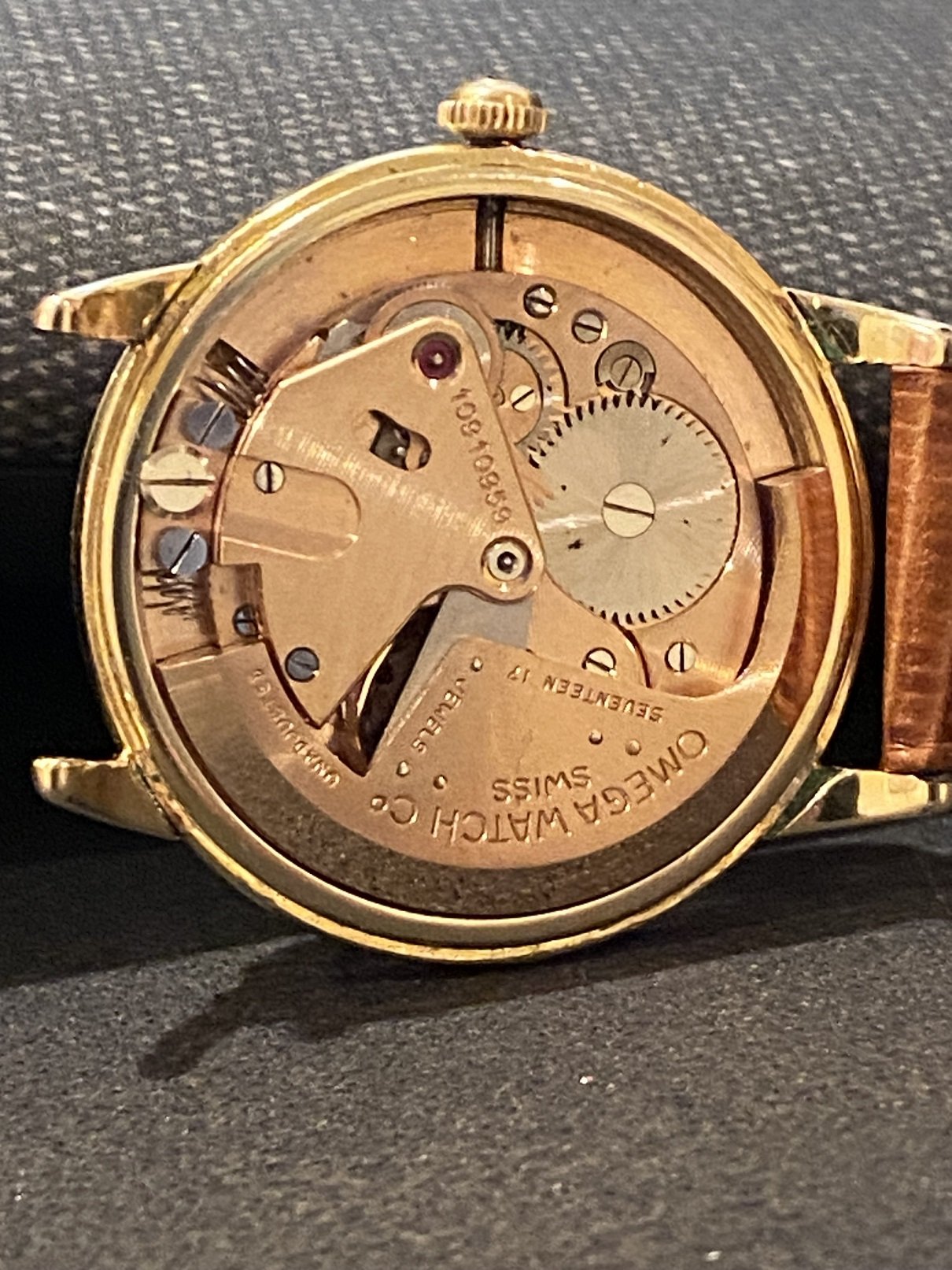

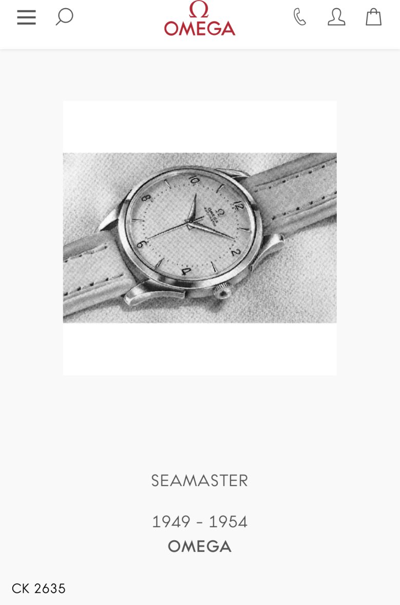

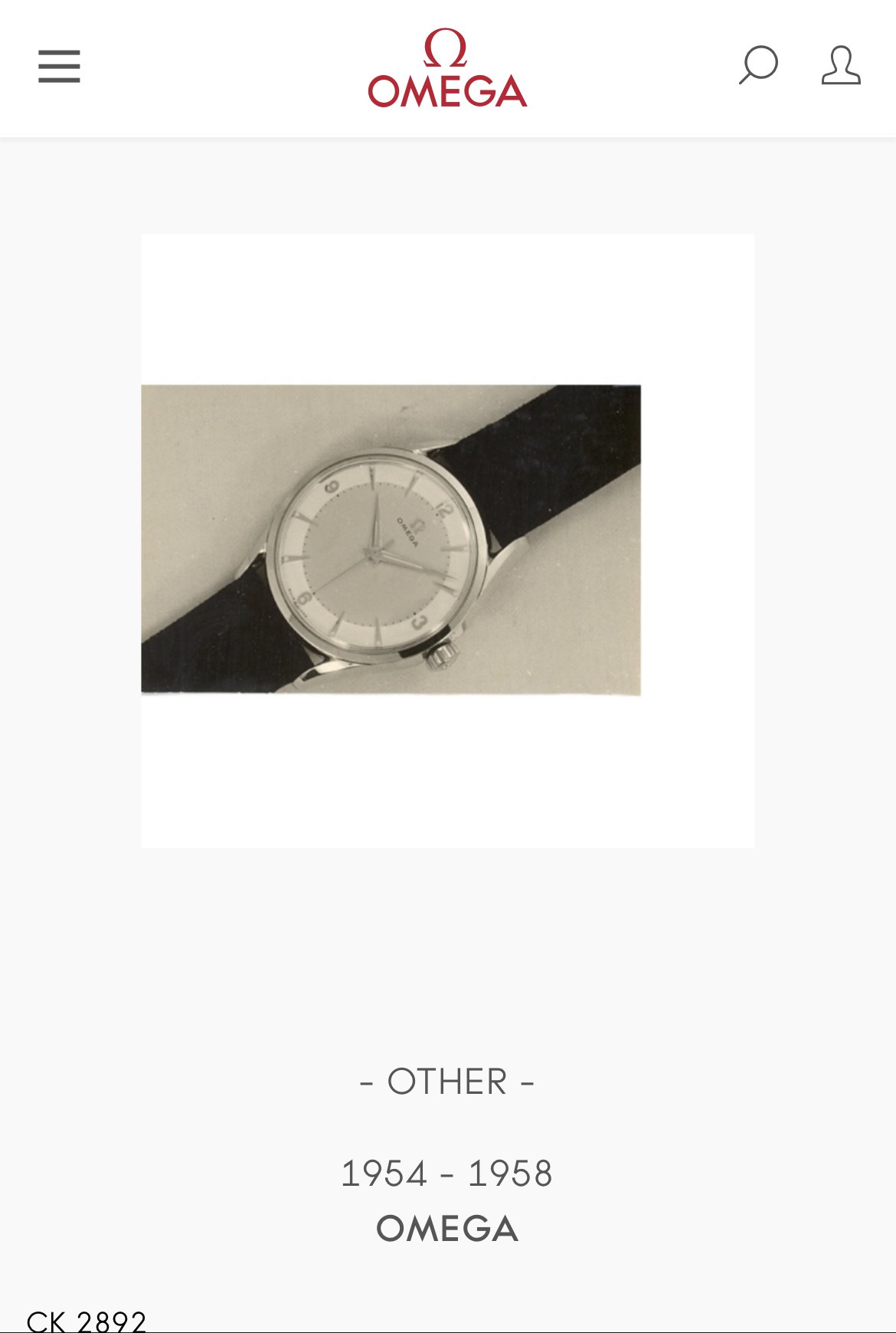

I’m thinking it’s a or a 2892, 2635- something. They all had that case and dial as well as a 351 bumper
10,827
16,846
It’s not 50s with that dial. Your second guess is better and you might have it. Nearest the bull wins a beer from the others I say.
917
1,780
It’s not 50s with that dial. Nearest the bull wins a beer from the others I say.
I had one dated 1950 by serial number similar dial.
