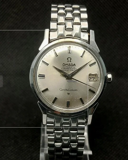

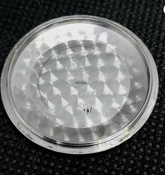

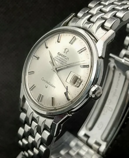

Hello everyone, I found this Omega with reference number 168.005. I've searched for other references but can't find similar models online. I wanted to know if it's a special model or one that's rarely produced. I greatly appreciate your help. The price is US$1,600.

Am I missing something? It looks like a standard dome dial 168.005.
Has some patina to the dial, dome dials are less sought after than pie pans and the bracelet is wrong so not a buy for me at that price.

168.005 (date) and 167.005 (no date) are by no means rare references, they are pretty widely available with pie pan or domed dials as Davidt said. To answer your question directly: it's not a "special" model or rare. I also feel like I am missing something ... if you search 168.005 you don't find any other examples that look just like this one?

I see. My problem was that if I searched for 168,005, I only saw watches with a "PiePan" dial, but now that I added the "dome," more results appear. Thanks! As for the price, do you know what a good price would be?

I have a 14900 which is the predecessor ref to the 167.005. Pricing really comes down to condition in the general order of dial, case and movement. A clean, original dial without lume seems to be the most sought after. Pie pan will cost more than a domed dial. A case that is not overly polished is also a big factor. Be sure the lugs still retain their shape, you can see the bevels and the case and lugs have not been rounded and lost their original shape and design. Stainless steel will generally be a premium over gold cap. Other factors that can increase the price will be whether it comes with an original bracelet (1037) and end links (70). If it's recently serviced. And if it has the correct crown and signed crystal. No date may even be a small premium over date, all other things being equal (they produced less and some like the more symmetrical look).
Honestly, if you only just learned this ref comes with both a pie pan and domed dial I'd say you're probably too early in your journey to make a prudent, informed purchase. There are many beautiful Constellations on this site. You should view and learn as much as you can before worrying too much about price - it can be quite a range.

$1,600 is way too much for a dome dial 168.005. For that price, you can get a pie pan 168.005, which is more desirable. I'll say aim for $1k for a dome dial.
