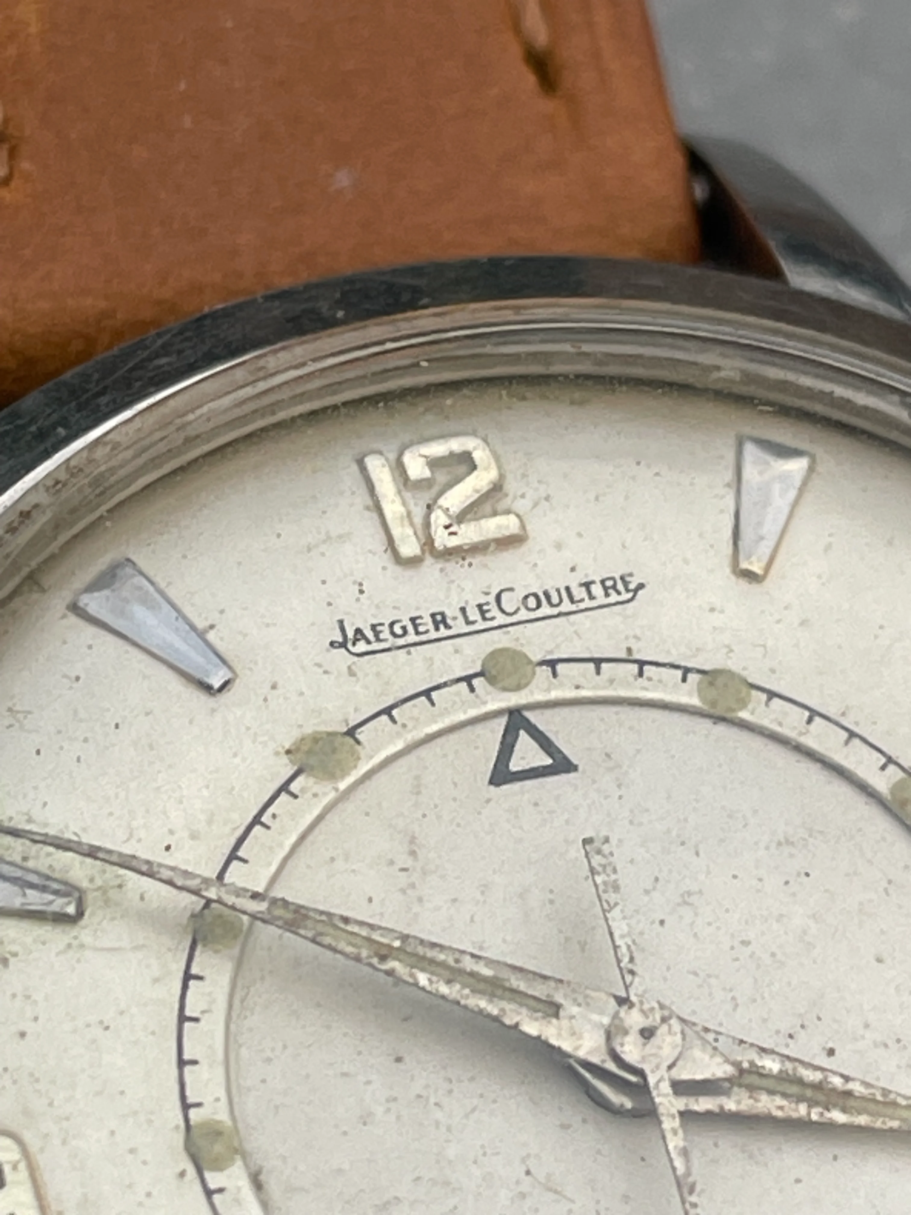

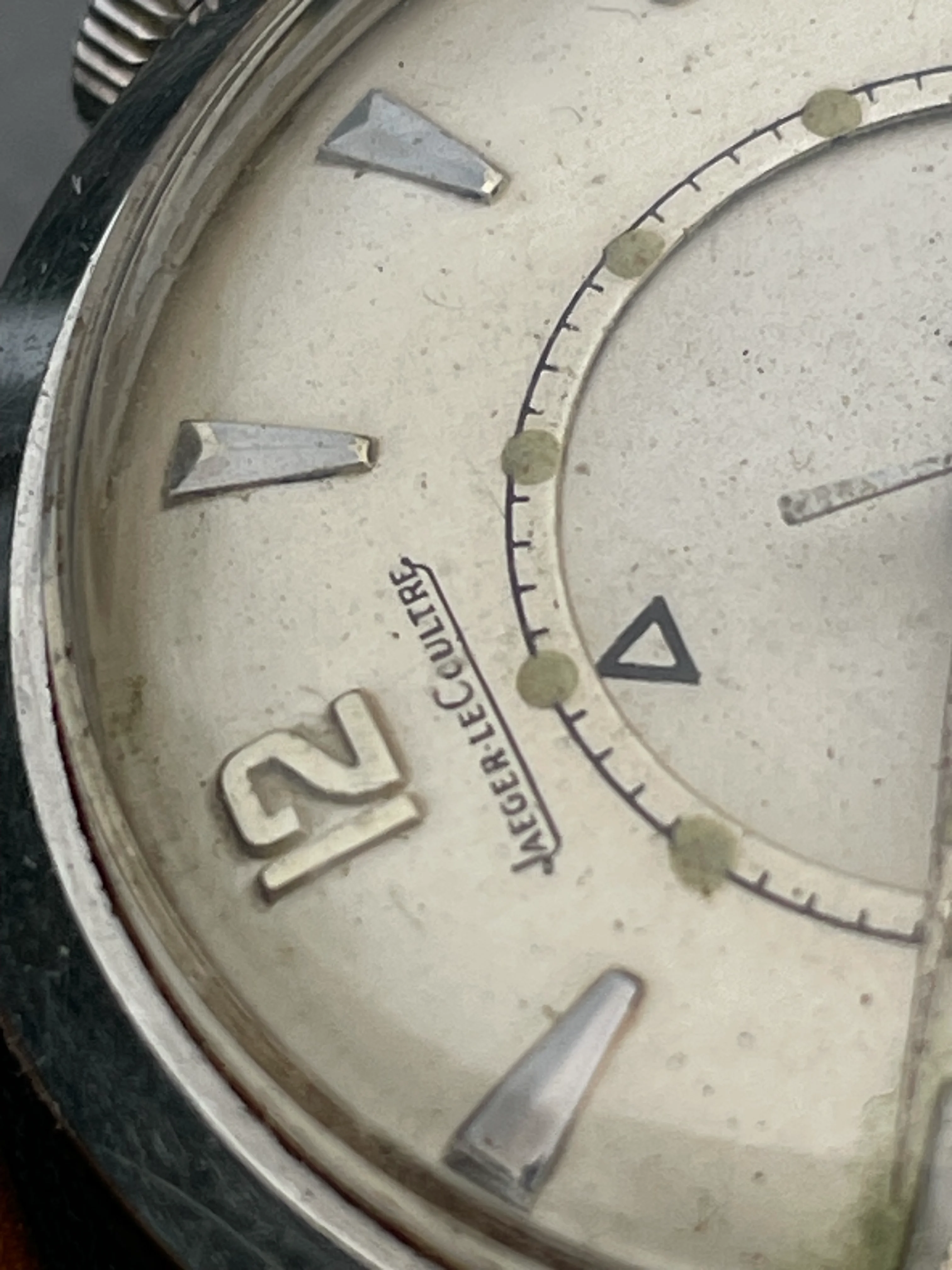

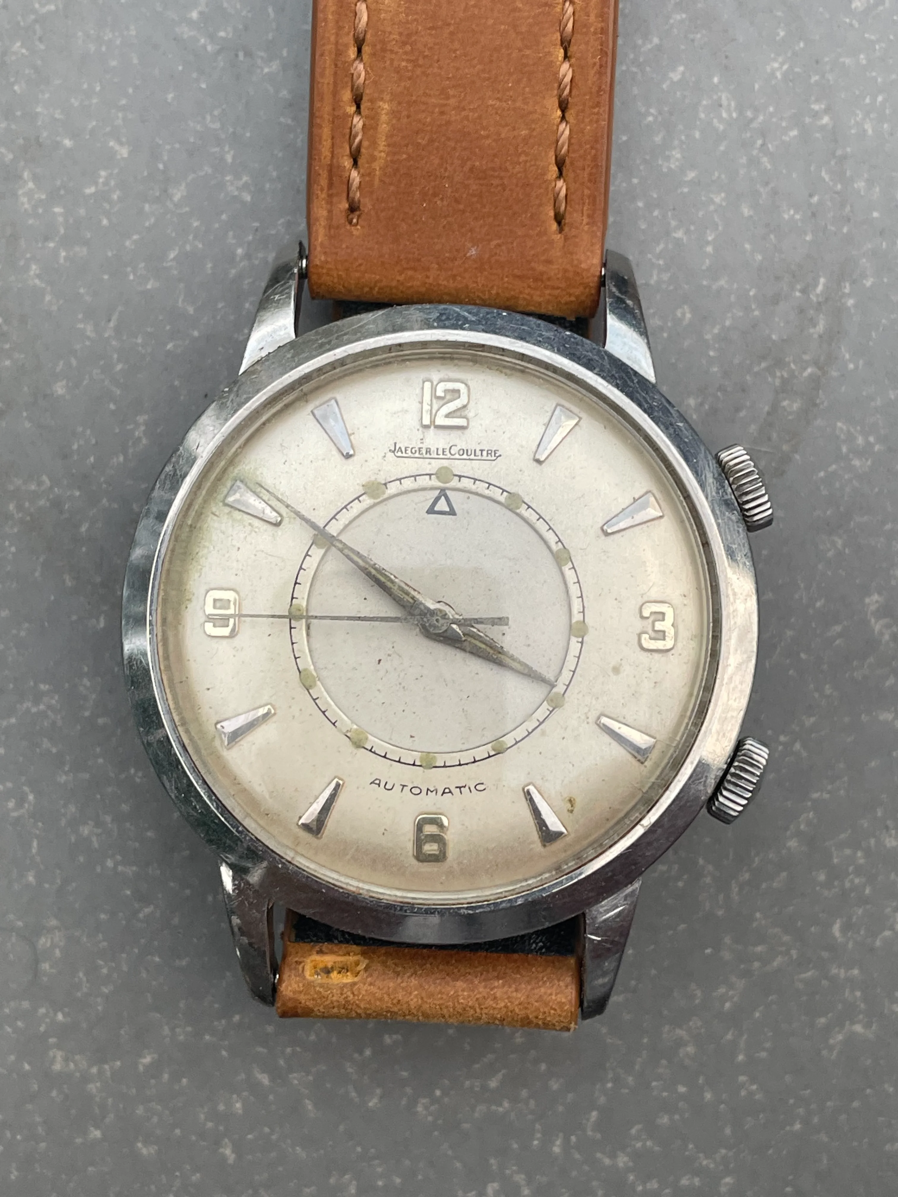

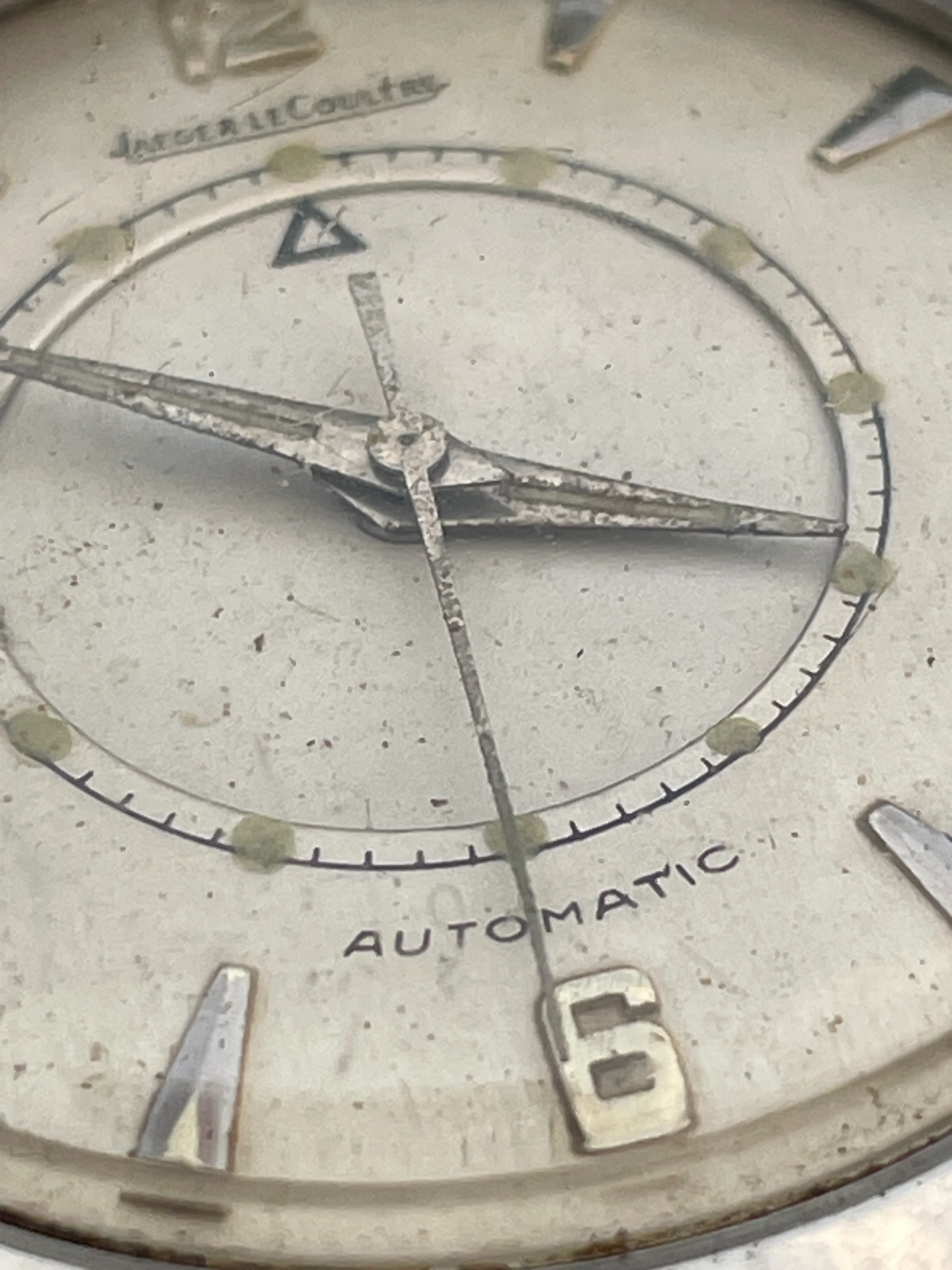

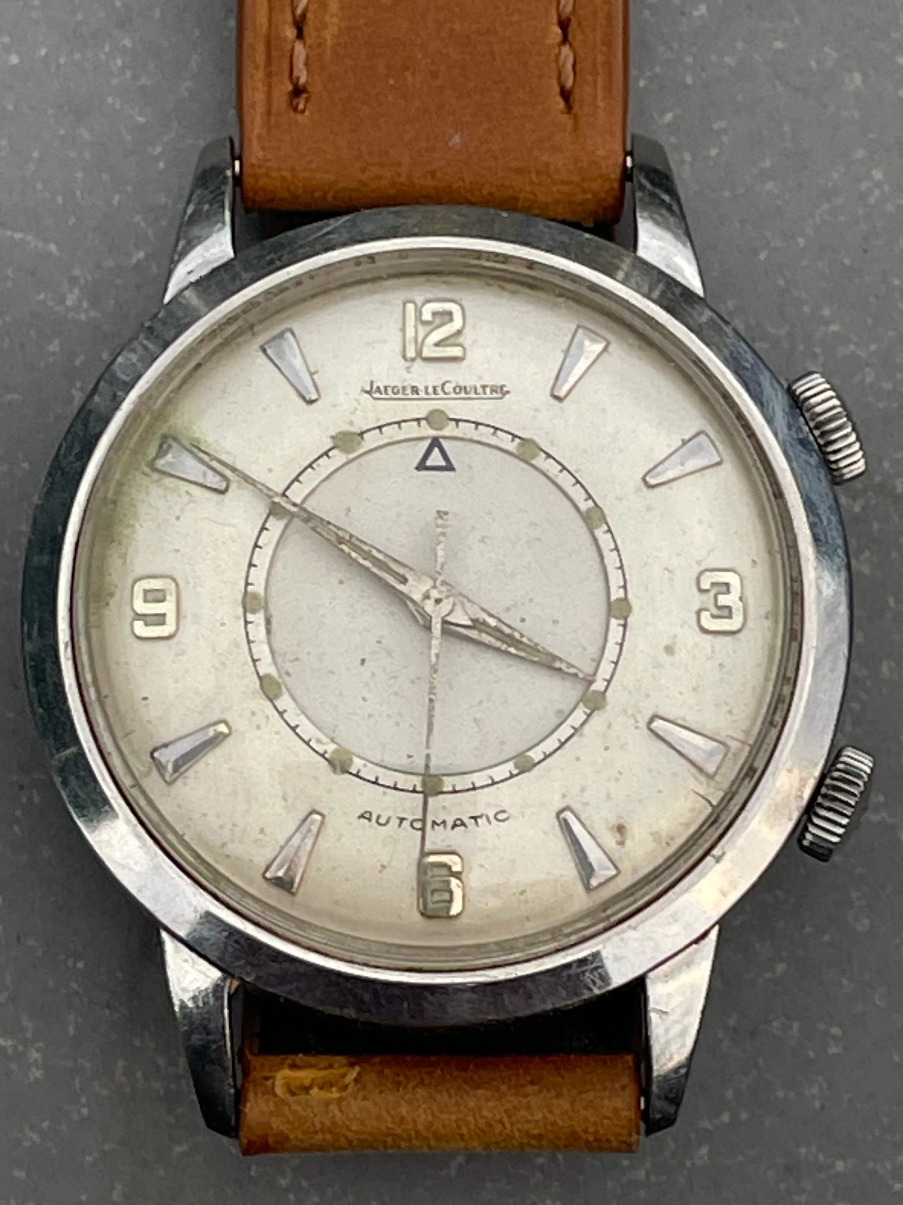

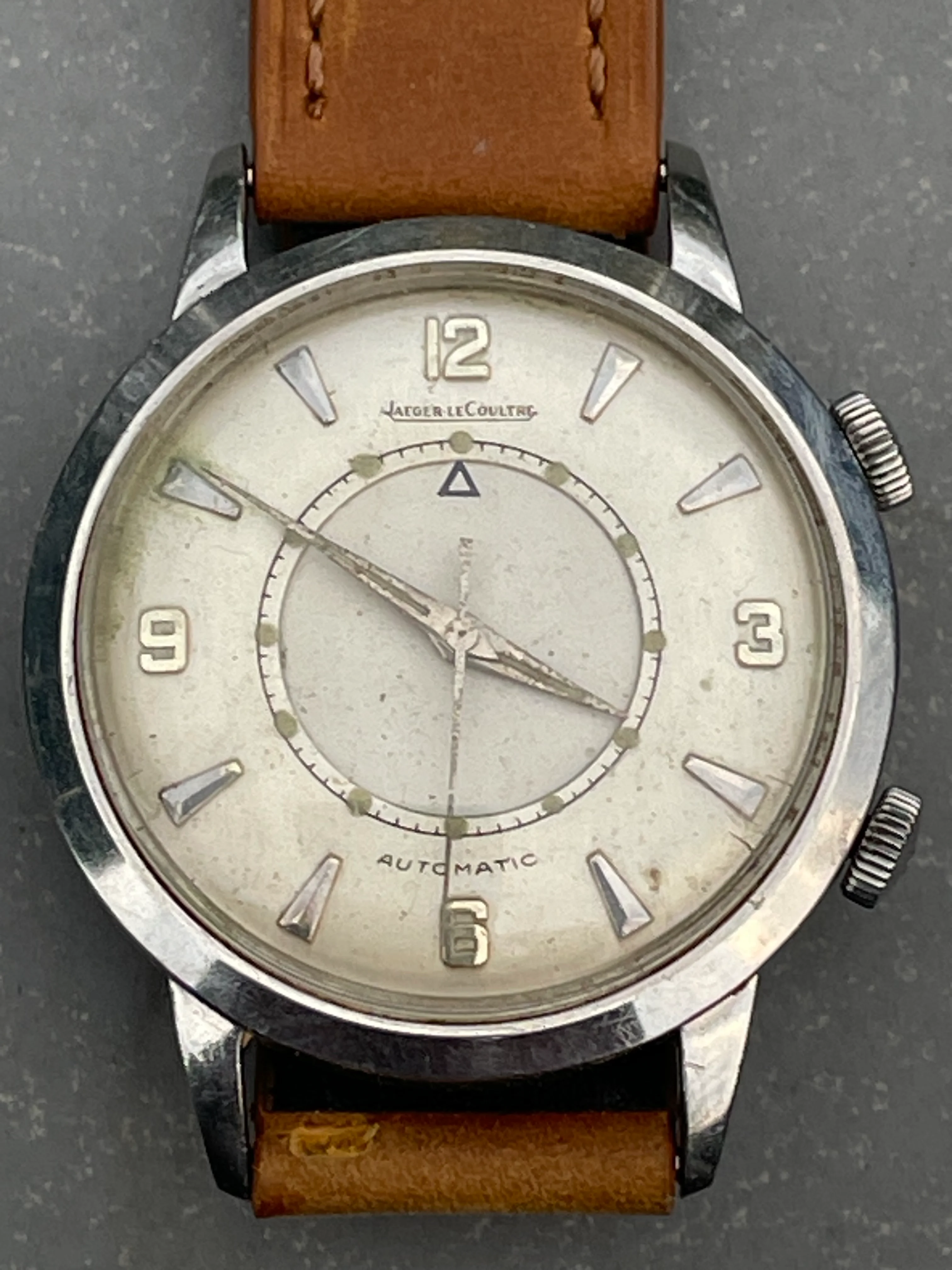

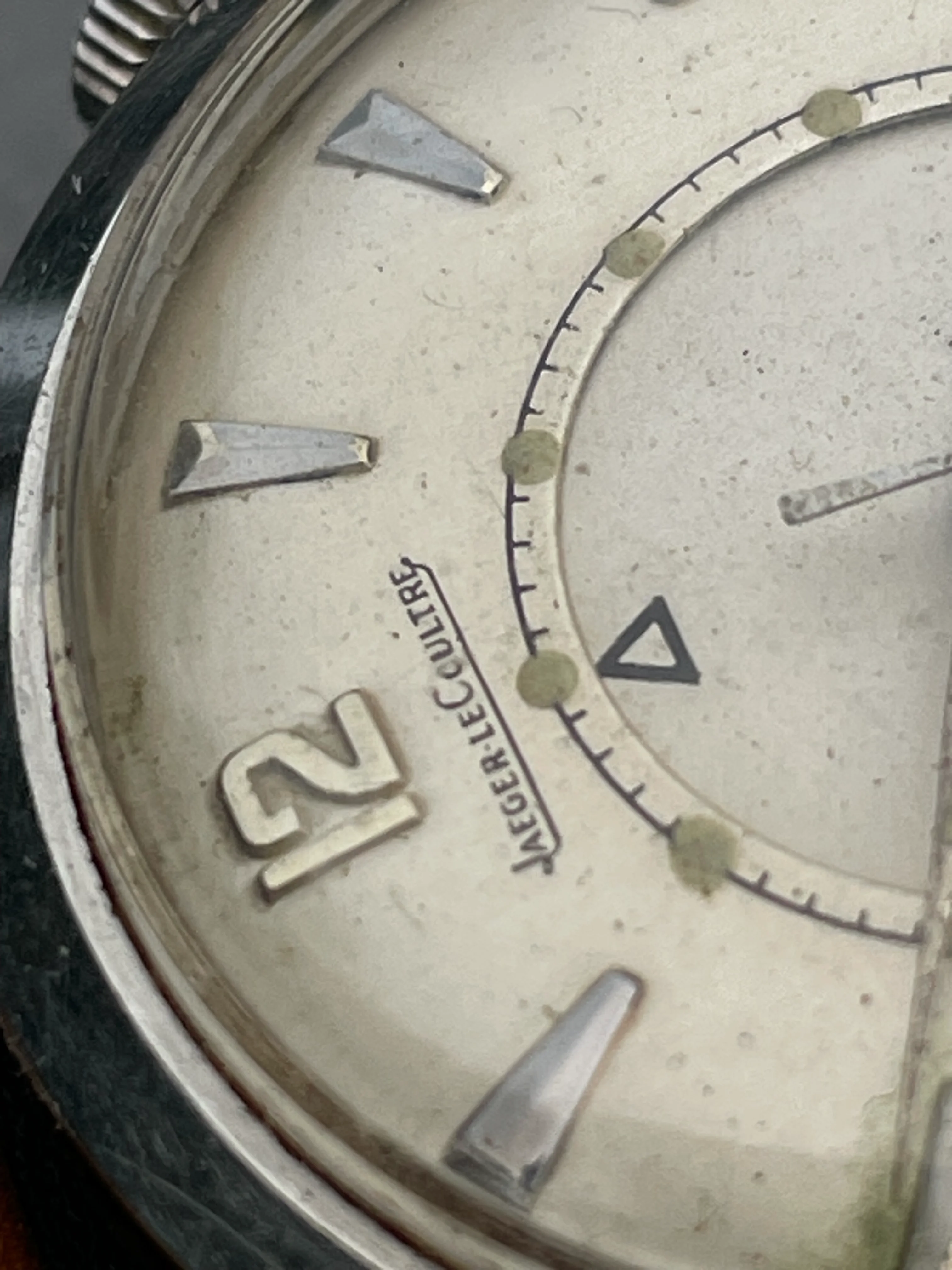

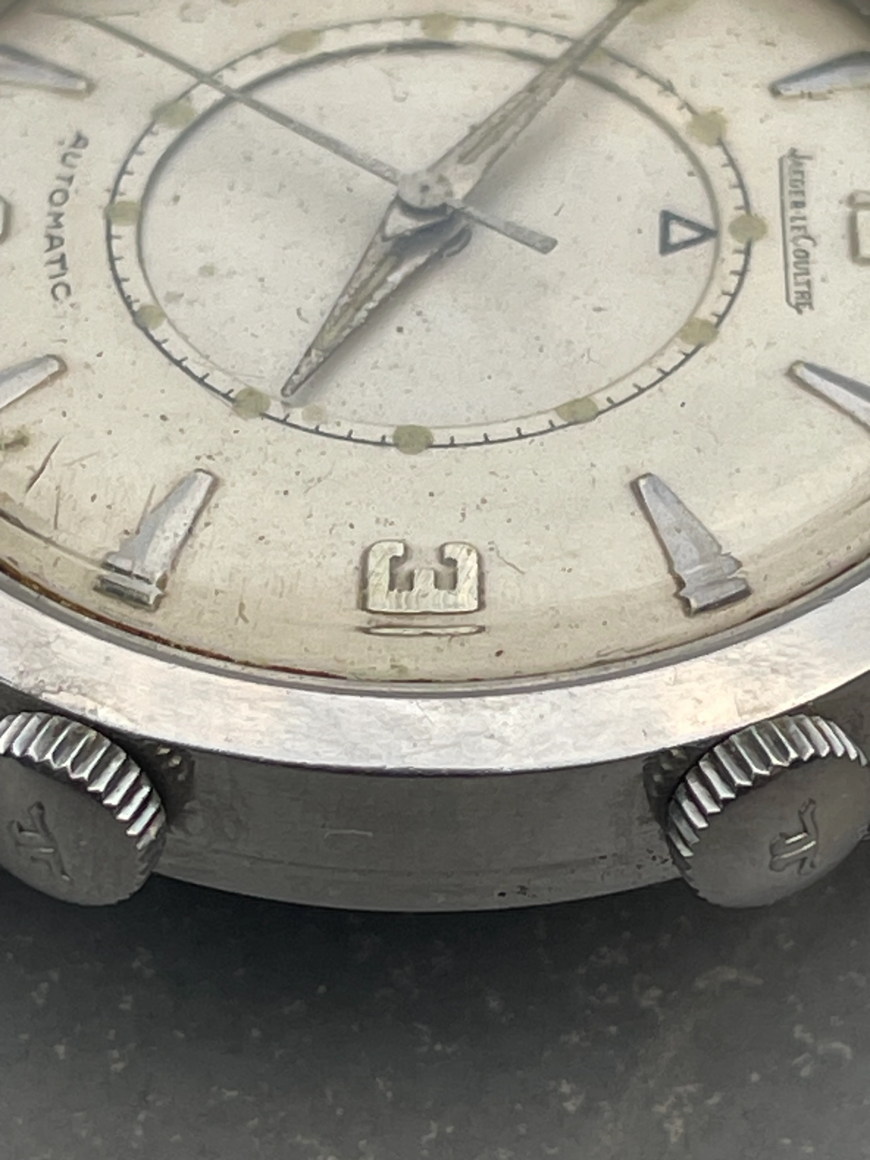

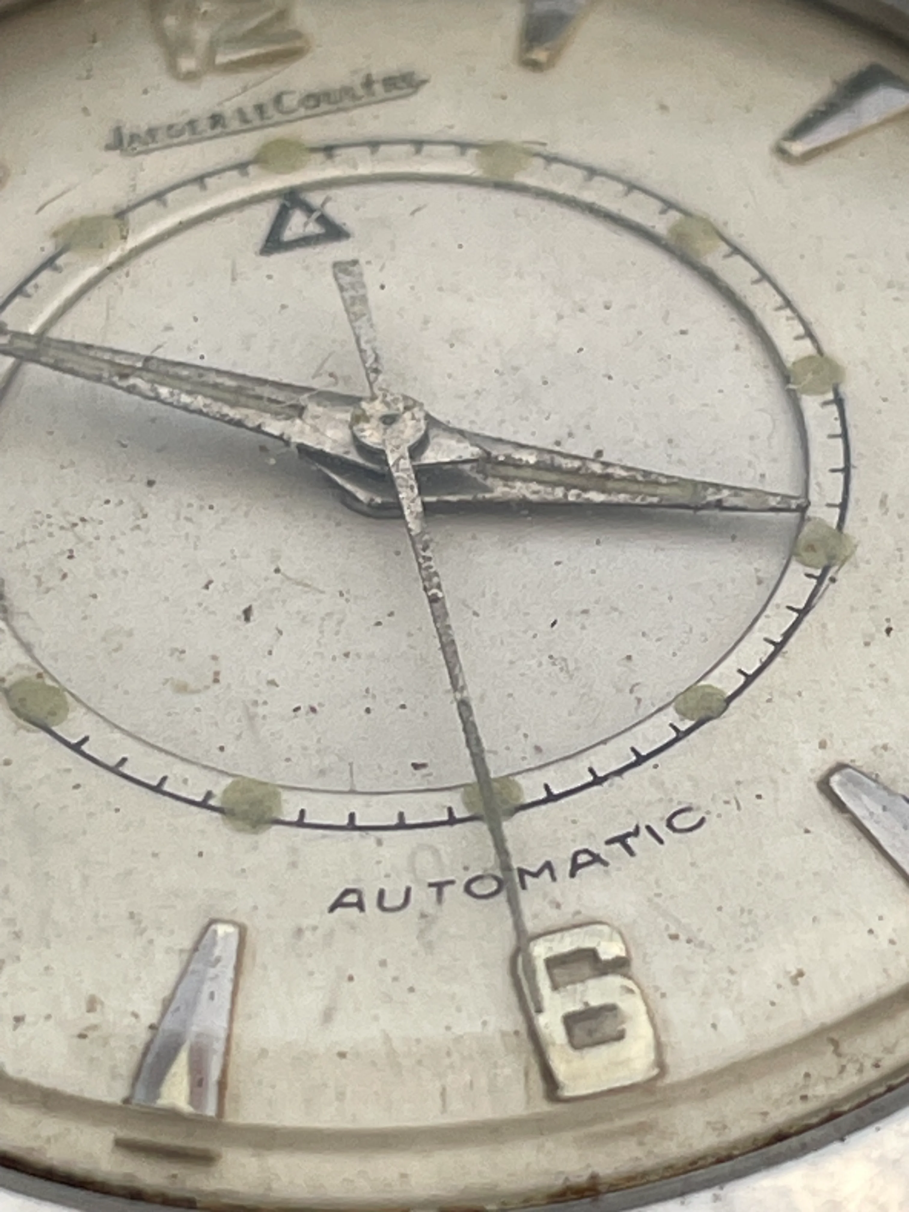

Hello everyone, what is your opinion on the dial of this watch? Is it reprinted / retouched?
My suspicious spots:
  • JLC logo it might not be as crisp and linear as i think it should. I looked up this watch and I have found similar logo treatments and some much crisper.
  • Lume Spots seem smeared.
  • Triangle and track appear a bit too black.
  • The word Automatic seems a bit off, and I could not find any other examples where it is arched.
  • Missing the word Swiss at the bottom. I have examples with and without it.
Thank you in advance
13,389
18,571
My opinion is that it is an older redial with the lume dots added or replaced.
The lack of “Swiss Made” at the bottom is a tell.
