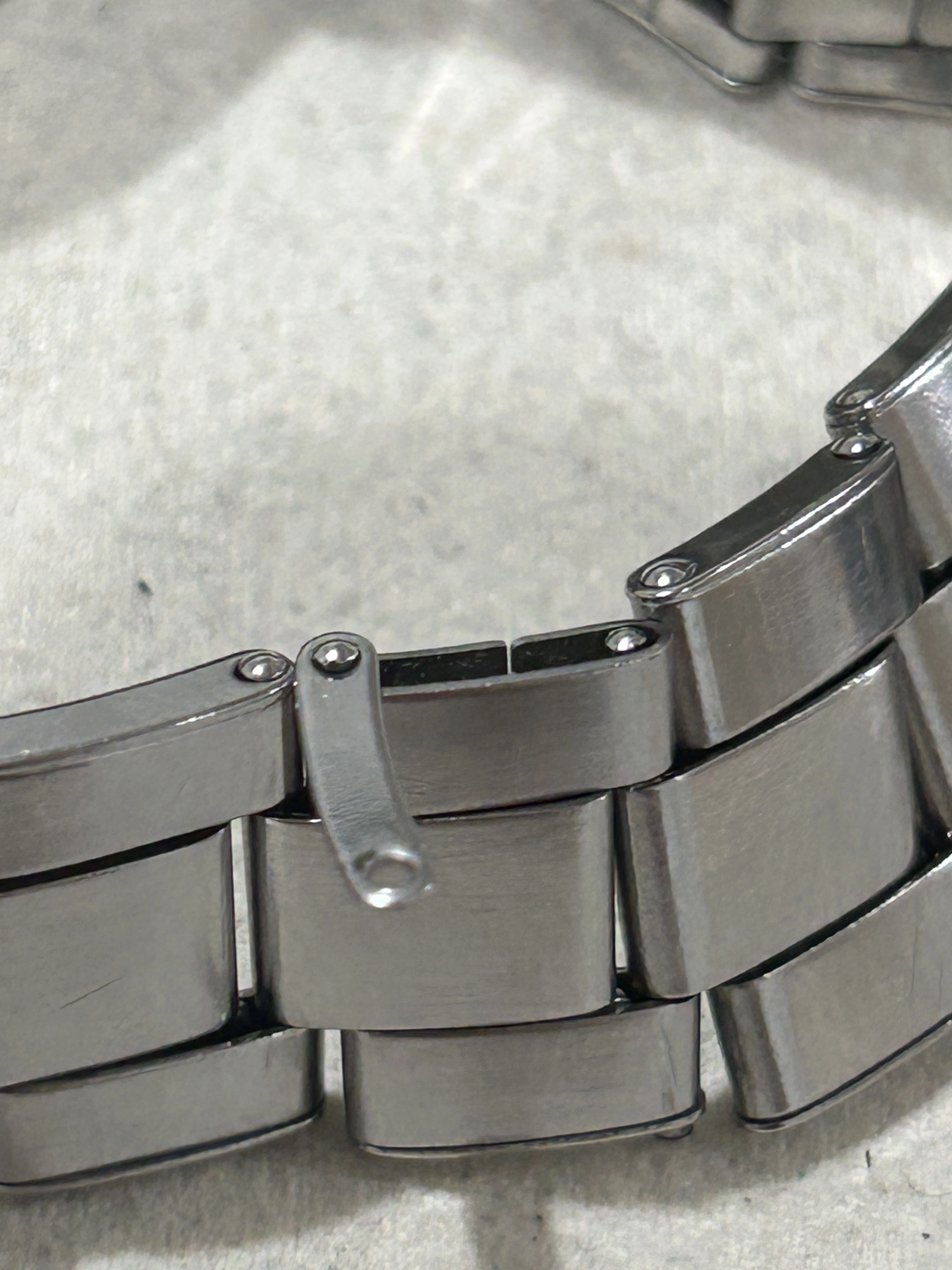

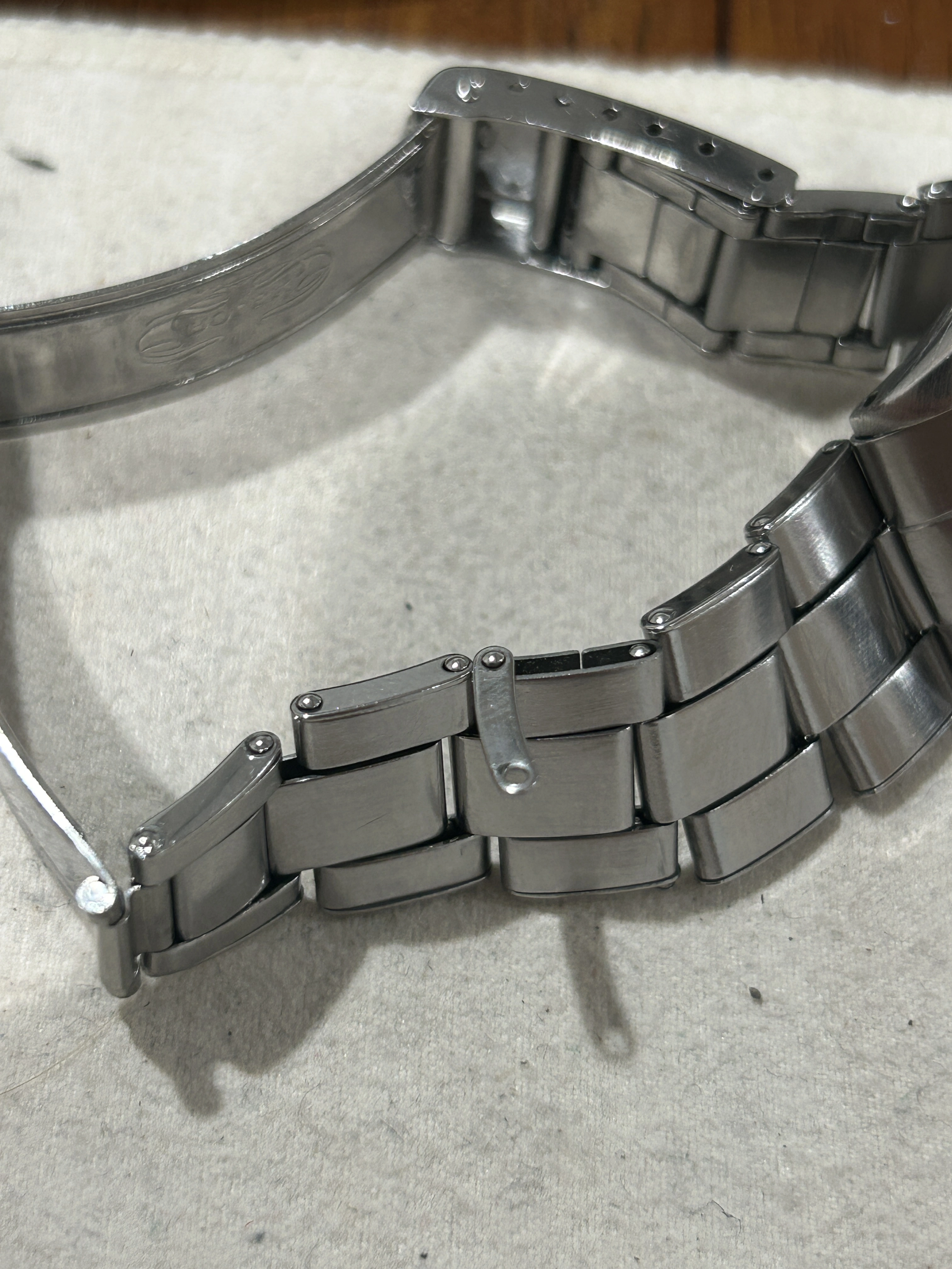

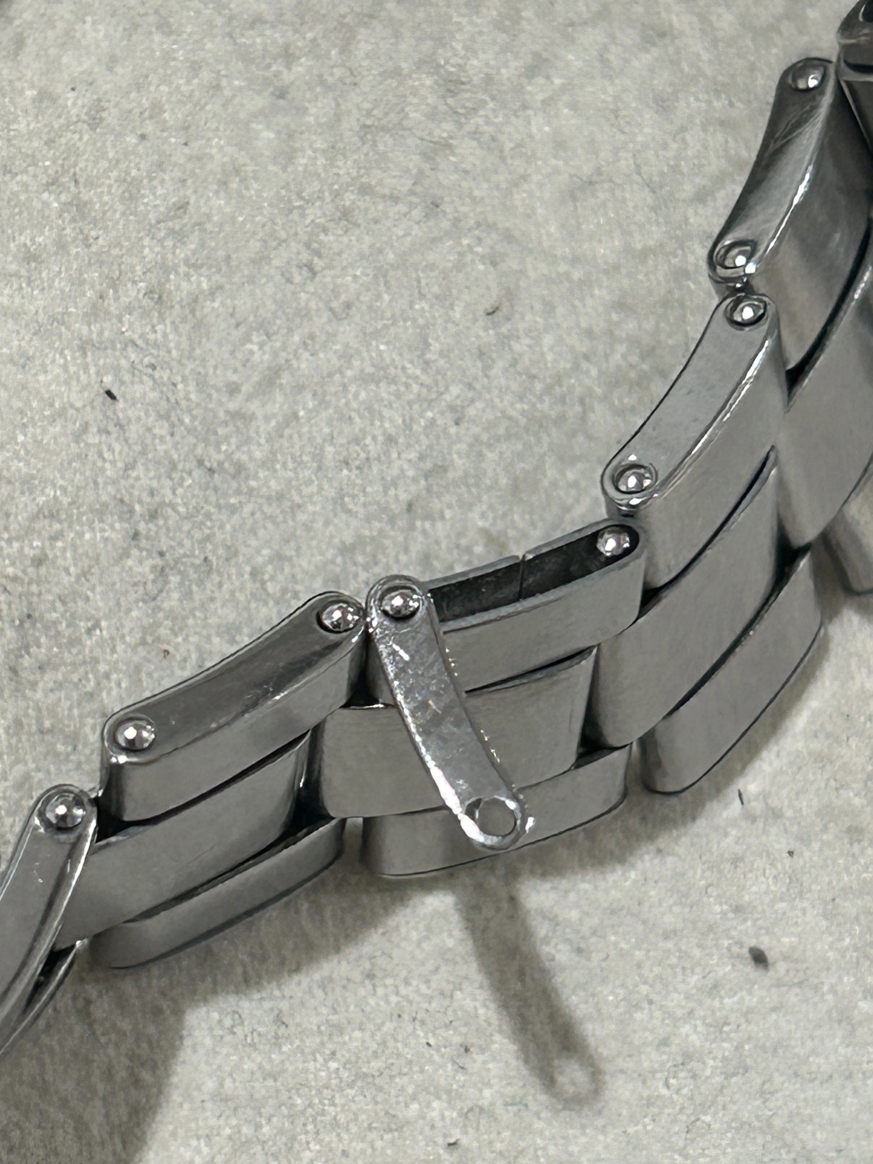

Seems like my refusal to adopt modern bracelets just keeps causing issues. Hahaha.
Anyone ever dealt with this on vintage rivet bracelet?
Not even really sure what happened 🙃

Looks like quite a few of the holes in those side pieces have become oversized from wear. Eventually more of the rivet heads will slip through. The bracelet would benefit from a re-build. If it's a Swiss bracelet, the value justifies the cost. If it's a C&I, then maybe not.

That's frustrating! Yes it is Swiss. Just bought this one off eBay. I think you commented on my other post Dan.
Who would you recommend for rebuild?
Michael Young? Rolliworks?
I assume it'll be around $500 for a 7205 with 57 ends?

Not sure what happened? it’s badly worn!
