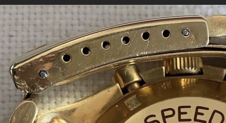

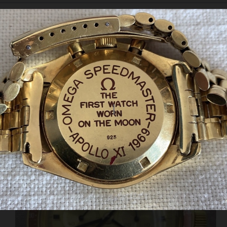

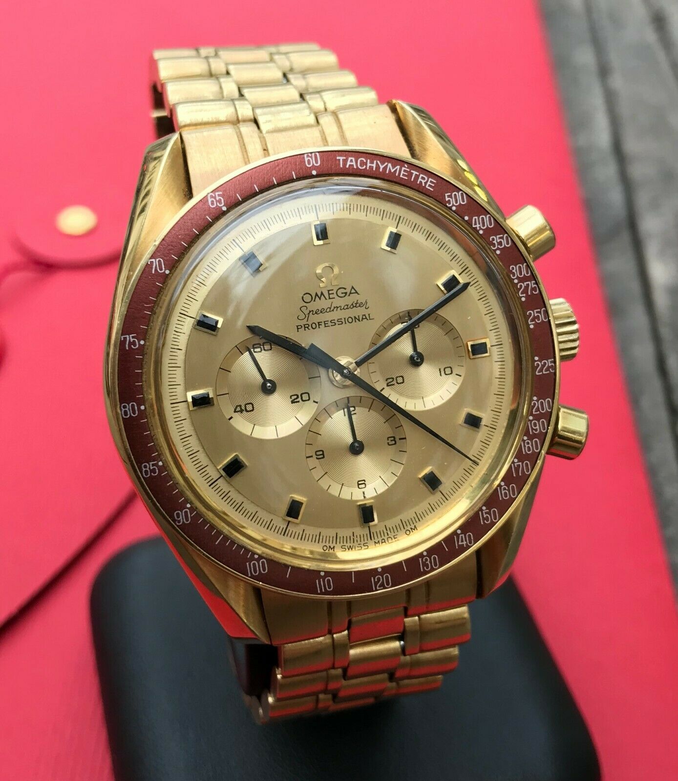

Another Mexican 1969 Apollo XI BA145.022 with same end pieces and clasp here> https://www.ebay.co.uk/itm/Omega-Sp...377800?hash=item342030f148:g:nP8AAOSwePpeLc2C
Looks like Mexican XI 18k 69s had Mexican manufactured 18k bracelets after all.
Just in case anyone is looking for info in future.

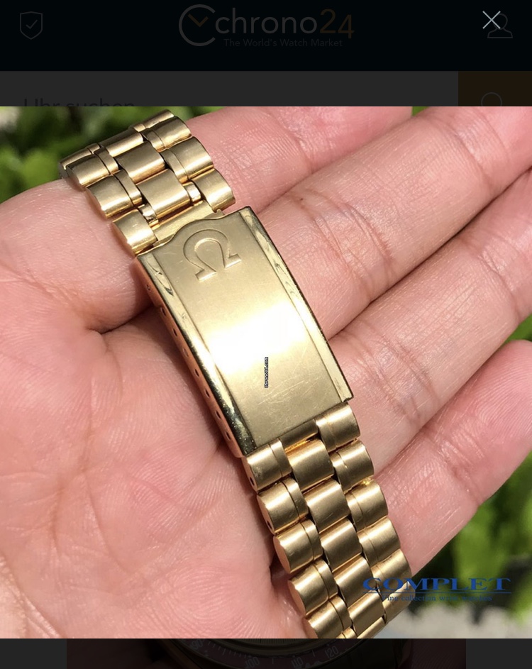

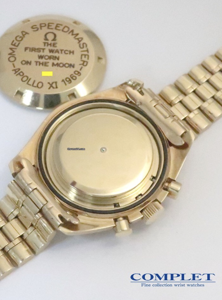

Hi @michael e ,
For full disclosure: I manage the ebay shop for the seller and wrote the listing of the Mexican Apollo XI.
I came to the same conclusion as you, that the bracelets for the Mexican marked differ from the ones we see at the rest of the Apollo XI‘s. There are two other Apollo XI for sale at the moment on chrono24 with the same style of bracelet/clasp. One from a private seller from Mexico nevertheless and one from a dealer in Japan that i would suspect to have Mexican origins as well (but that’s a pure guess).
Pics for future research:
The one from Japan:
And the one from the private Mexican seller:
Also interesting to note is that most of them are in a higher limitation number range. What was the number of yours Michael?
I hope this does not come across as me promoting the sale. It‘s not meant to be.
