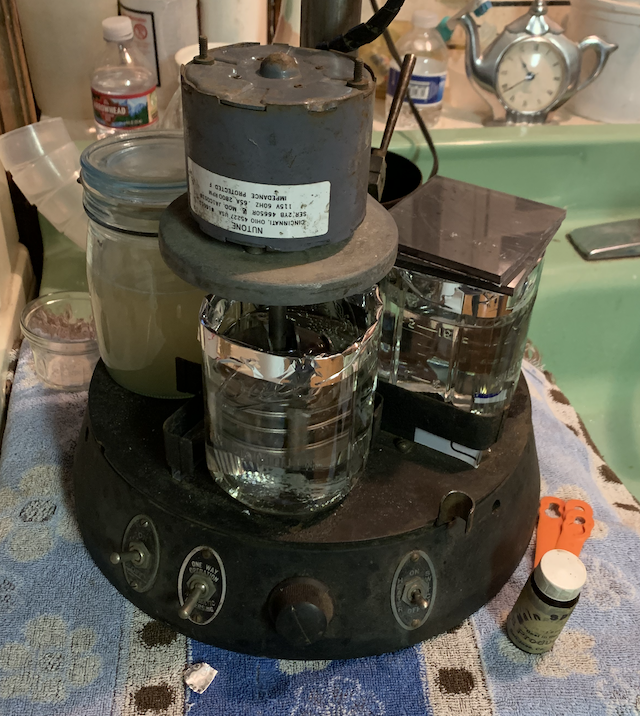

Used L&R machines can be found easily. Although like everything else I am astonished at the prices. The shipping can be a bit of a haste. I broke the jars, but cut down masons jars seem to work, There must be a reason the spin cyclers are still used. Could be the drying, the parts come out quite warm due to the heater. Not sure brushing and shaking can get the flows that seem to be required.
There is a star shaped piece of metal which seems to do something with the flow vortexes. Also notice someone replaced the motor on mine with a fan motor.
I have also read on the other forms that Ultrasonic is not recommended for the actual parts. Not sure why. So I stick with the spin washer.
I was also taught to do the last rinse with distilled/di water. And if hand cleaning (a clock) to boil in in the microwave first. Which creates a sort of steam cleaning effect.
One of the most satisfying steps in watchmaking is when the warm shiny parts come out of the cleaner. Almost like cookies from an oven.
