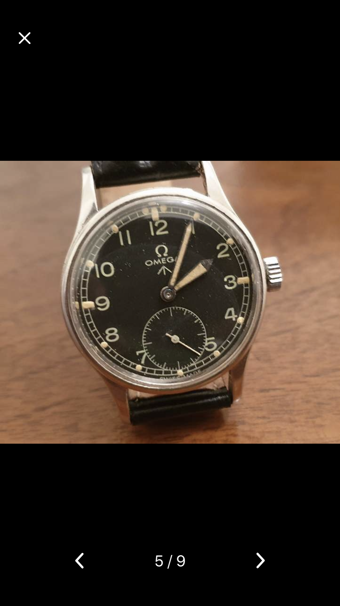

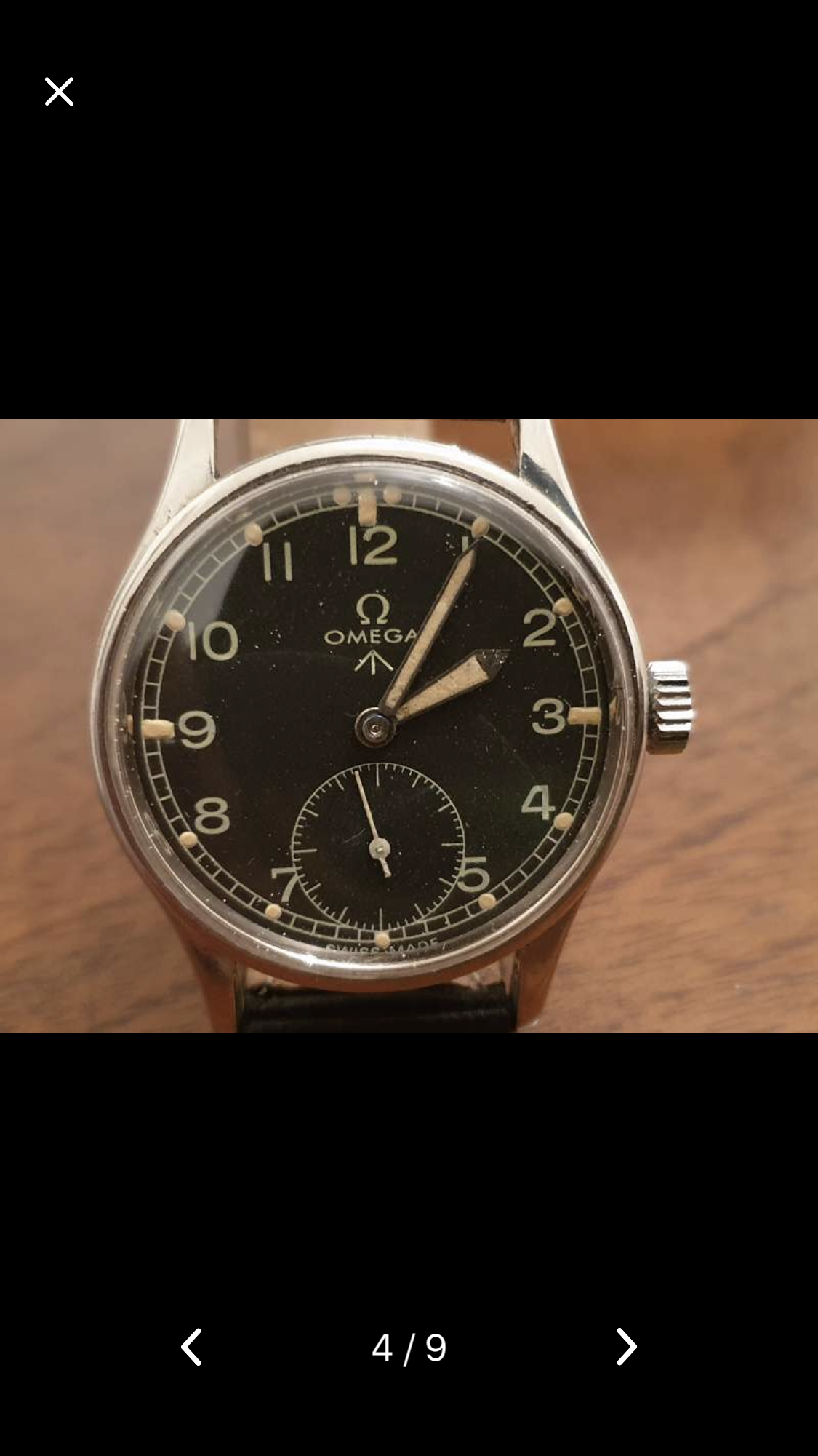

Good morning,

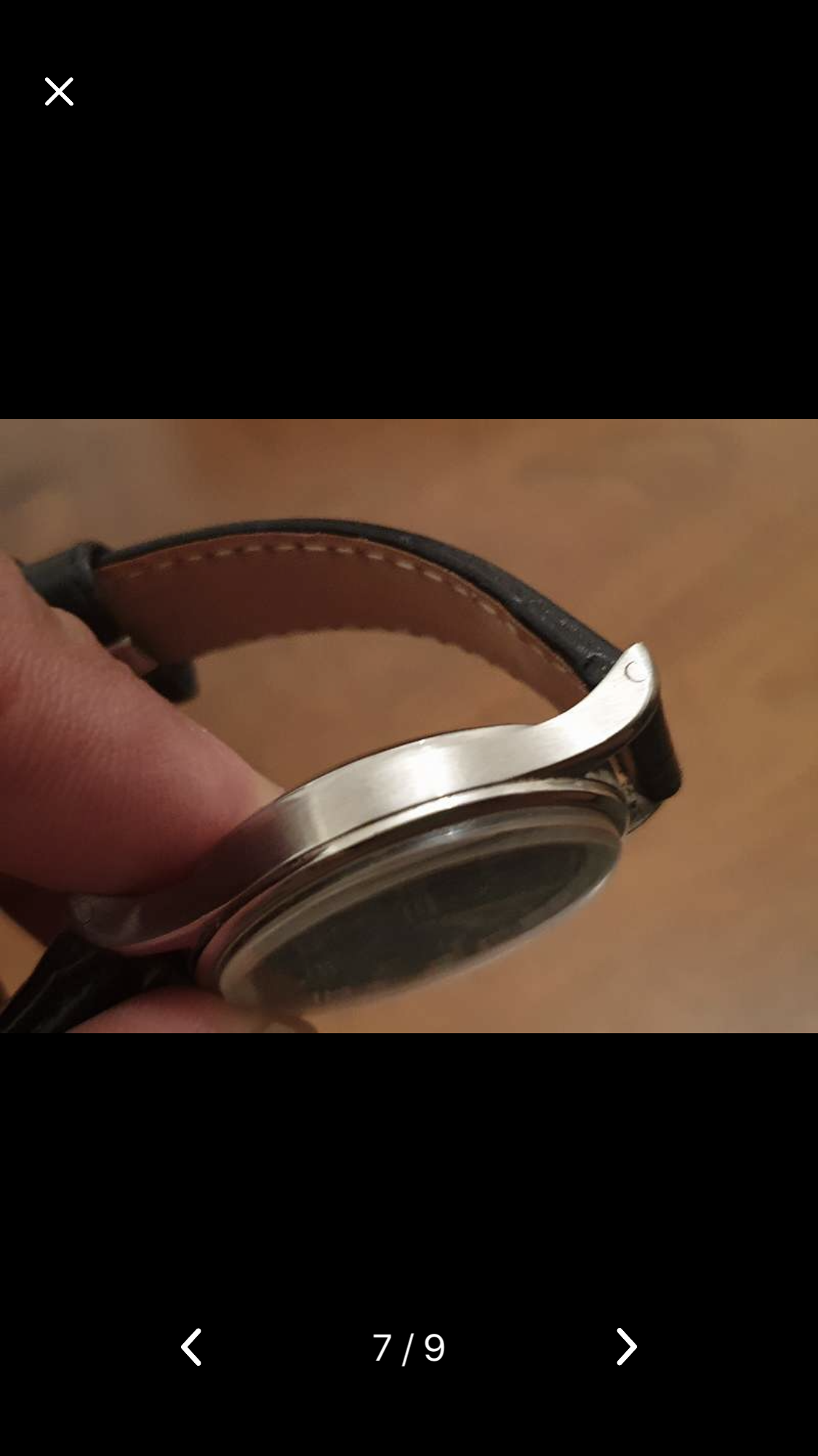

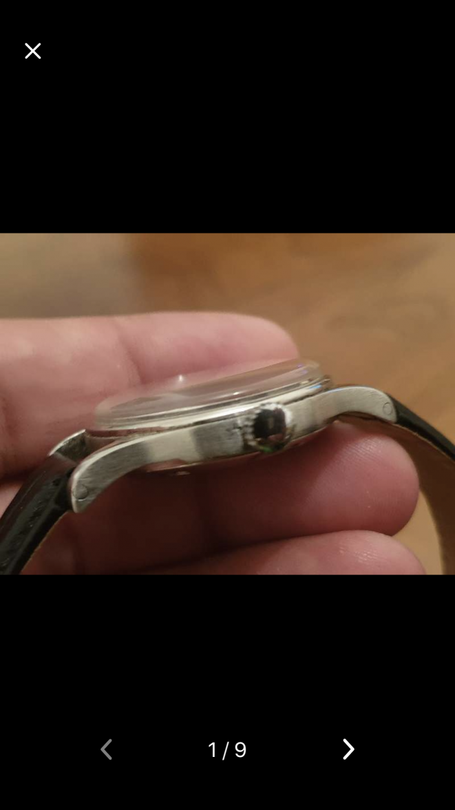

I was offered an Omega military which looks to me like a redial or at least relumed The number 5 on the dial looks different to what I found and the plots are not as clean but on the other hand the hands fit colourwise. The serial is 1068xxxx and the crown is not correct for sure in my opinion.
Any experts words on this example?
Kind regards
Max
A Ministry of Defense redial, as shown by the pointed A in Omega.
So something that was done as a part of service for an MoD issued piece?

IMO just a poor redial. There are several things wrong, but the easiest to spot is the broad arrow.
MoD used these pointed A dials as well as different hands when issued watches needed replacements. Still genuine and authentic but not first issue. Here's the Omega entry from a WWW page that's no longer active, unfortunately:

That’s not a mod dial sorry. That’s just a horrible redial.
Cheers
Chad
