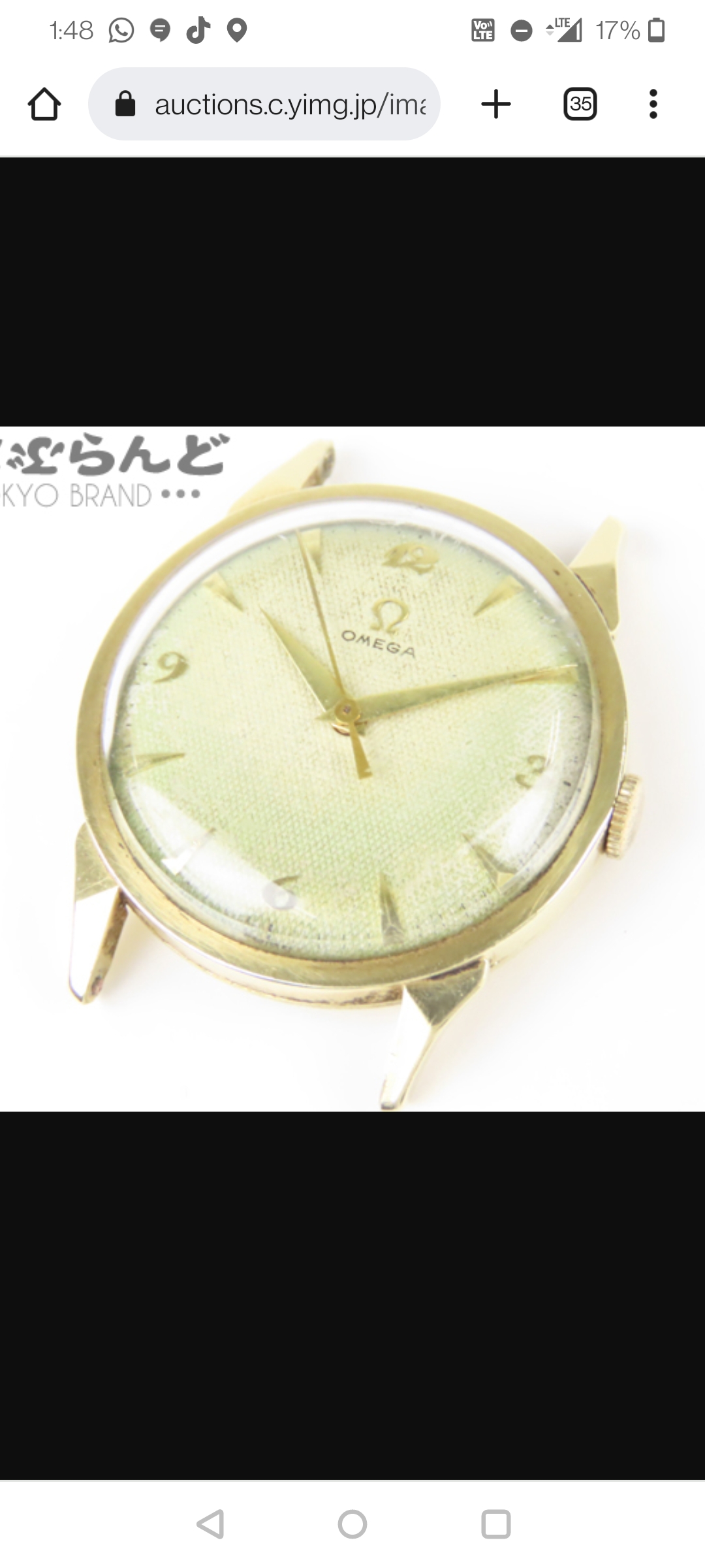

Since this gifted watch is one that was locally cased it doesn't use standardized reference numbers. I am trying to search for what the watch would have looked like originally. I used the vintage omega database to filter references that used the caliber 420. The only example that came in a 14k case is this one: https://www.omegawatches.com/en-us/watch-omega-other-omega-oj-2690
Am I correct in my approach? Should I should try to find a similar looking dial and crown that's included in that picture from the archives?
Although the markers are different, the dial text is probably the same. One line that just says Omega.
