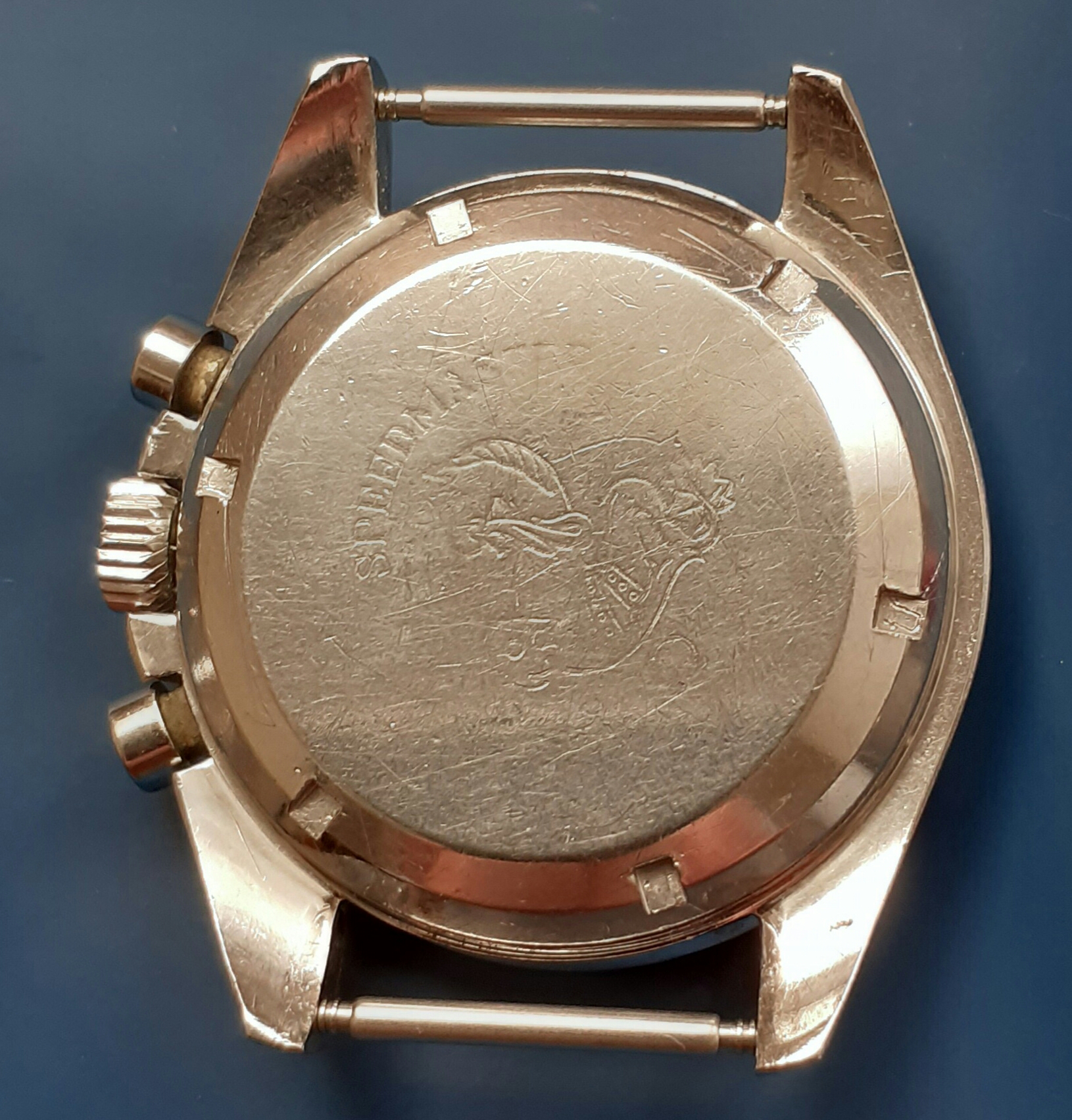

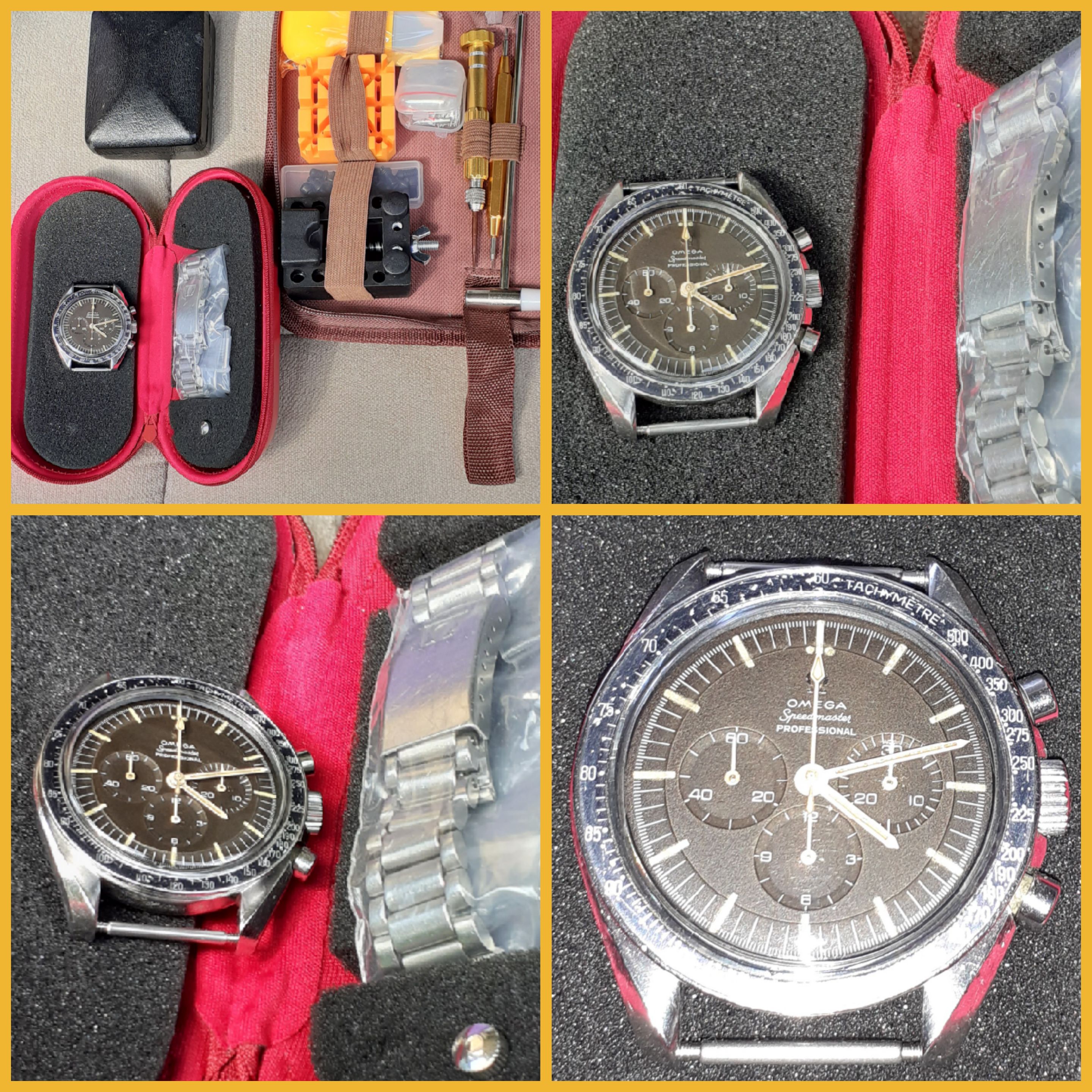

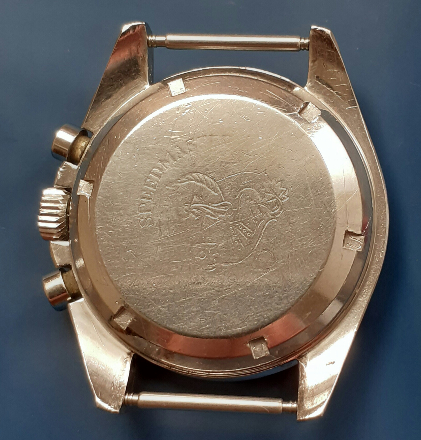

However, you will all be pleased to know that, so far, I've left the DIY watch repair kit it in its box well away from my Dad's Omega Speedmaster 105.012-65. Now.... If it had contained a @Pahawi case back opener??? I may have been tempted to have a quick look inside.馃槻

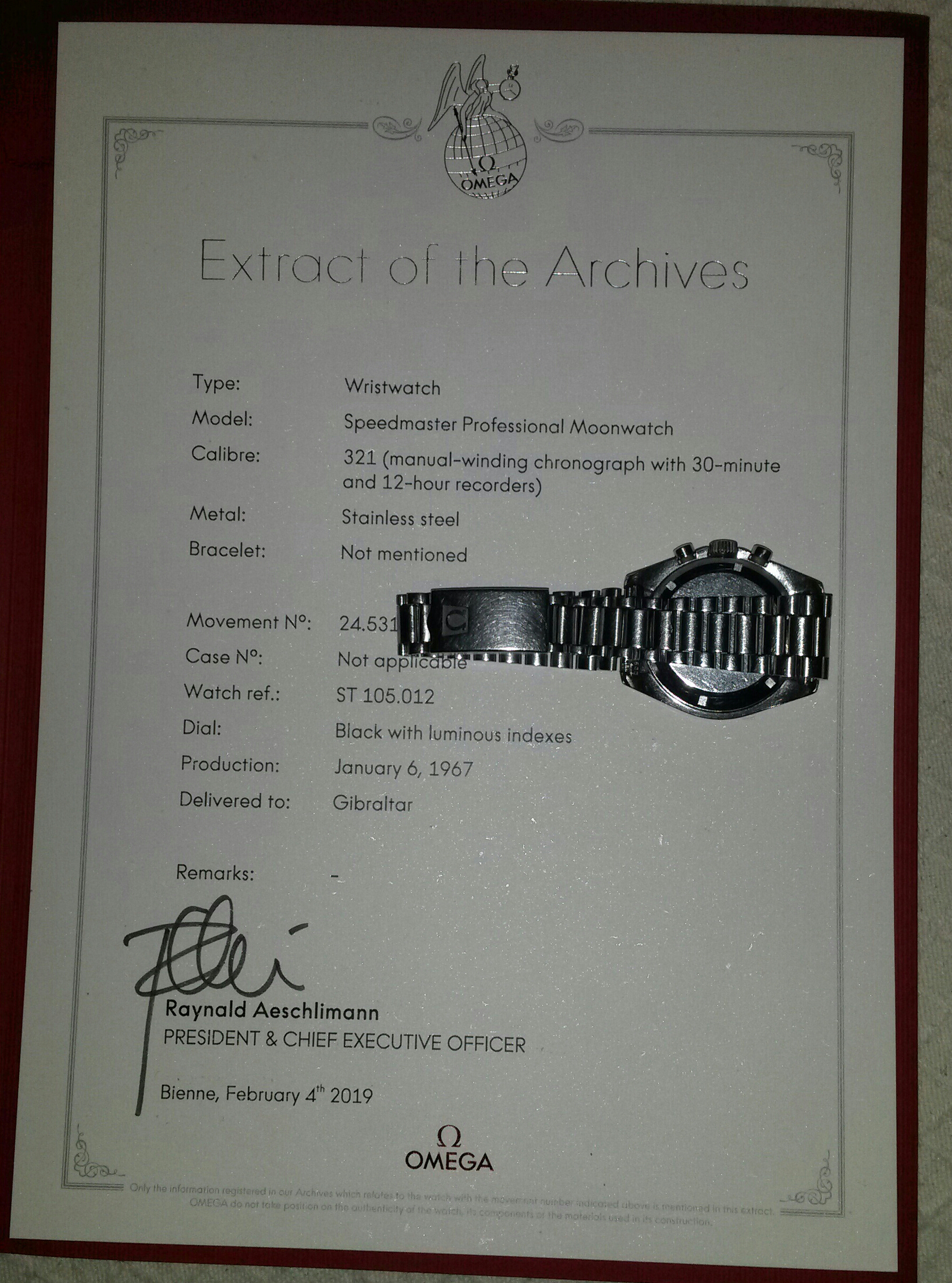

My question is:

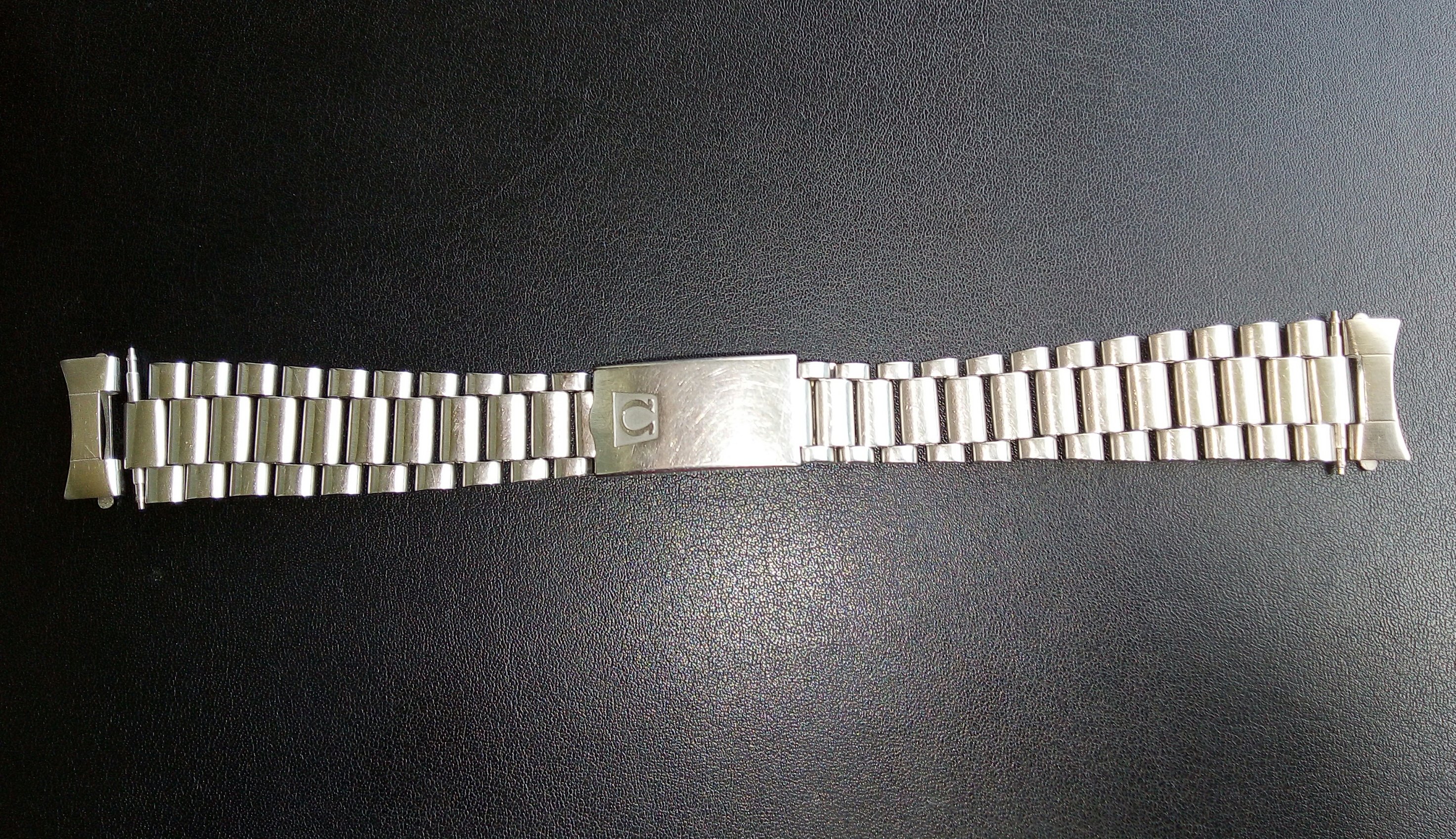

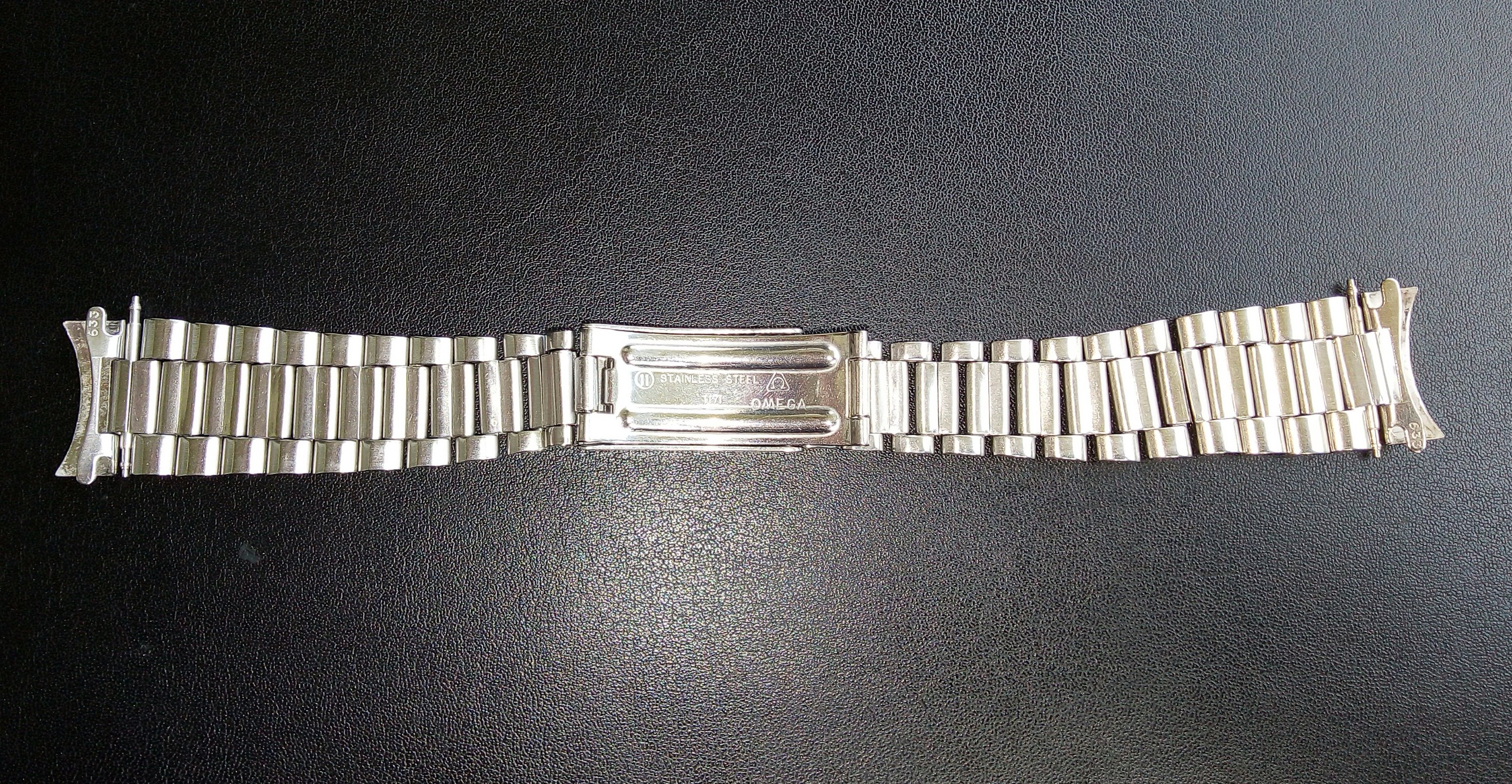

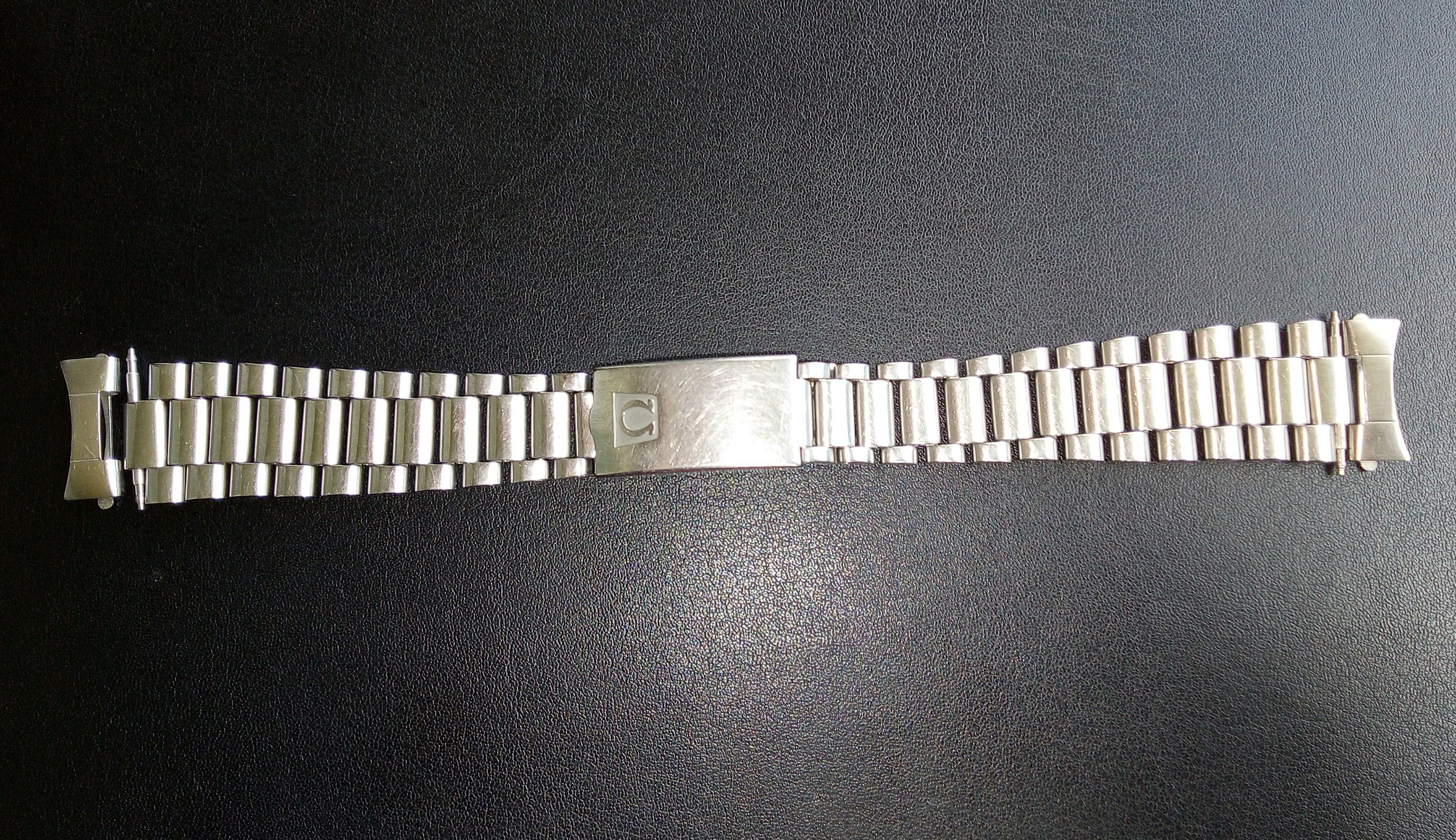

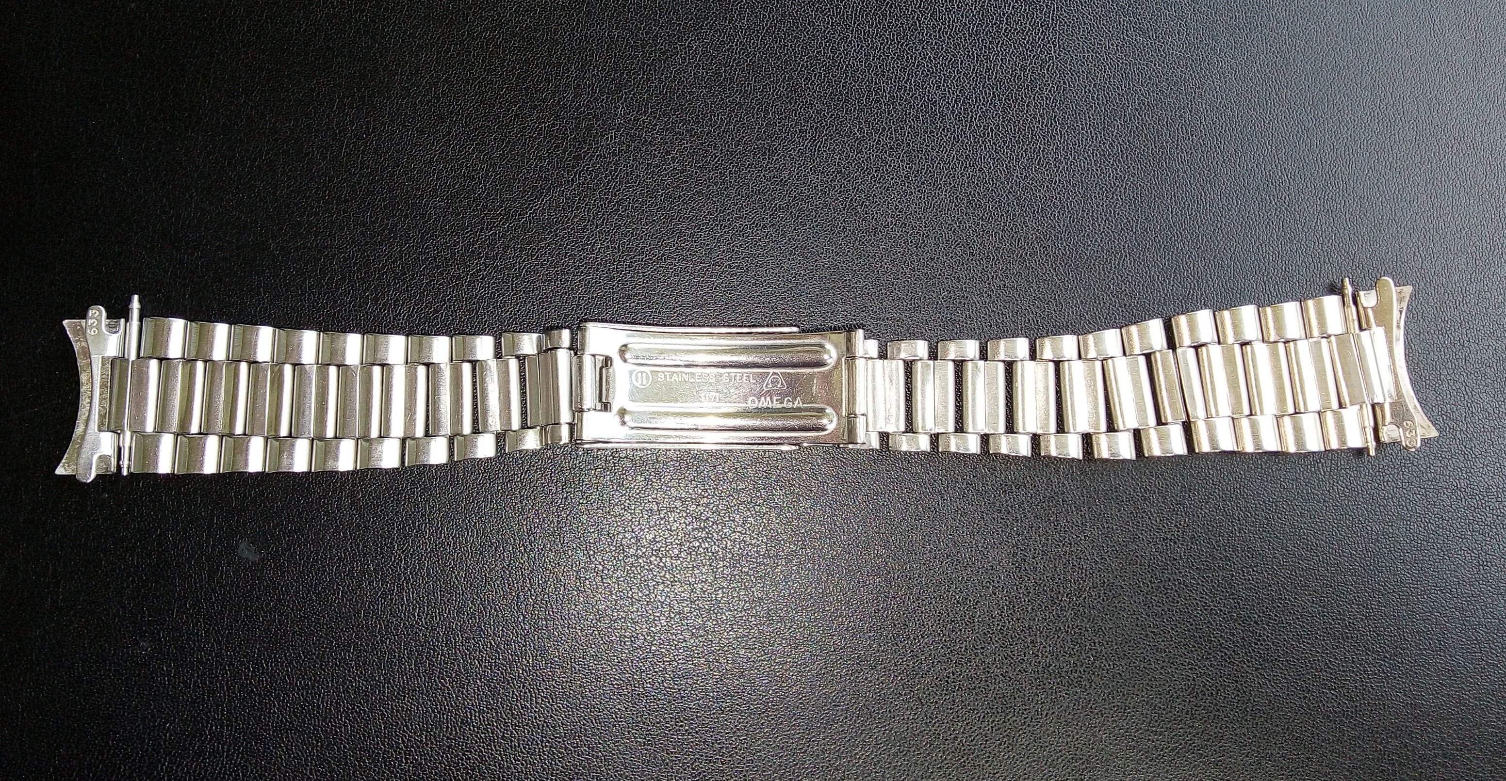

Do you think I should have a go at reuniting it with its long time 1171/633 service bracelet? I really would like to start wearing it again this Summer.
(WARNING: STAND BY FOR MORE GRATUITOUS PICTURES OF MY DAD'S OLD, OMEGA SPEEDMASTER 105.012-65) 馃槦
Don't worry chaps! I won't be trying to look in here using the evil 3 pronged case back opener, that is included iN the kit. 馃憤

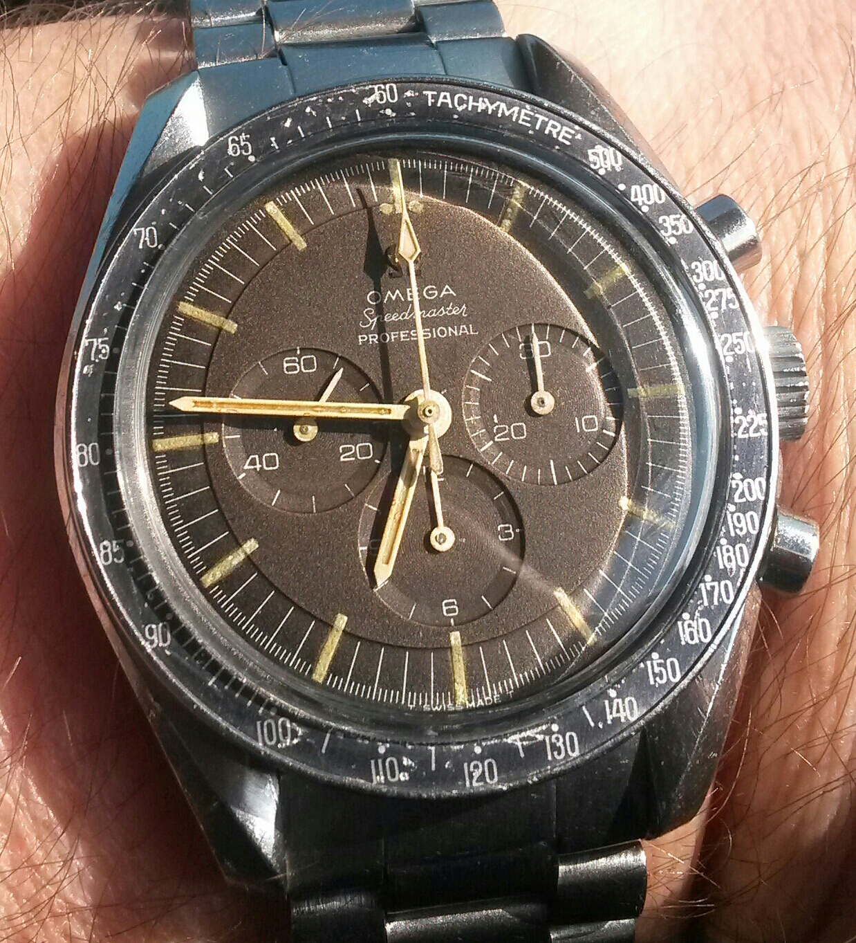

(P.S. Look at how black the dial was in the 1970's)

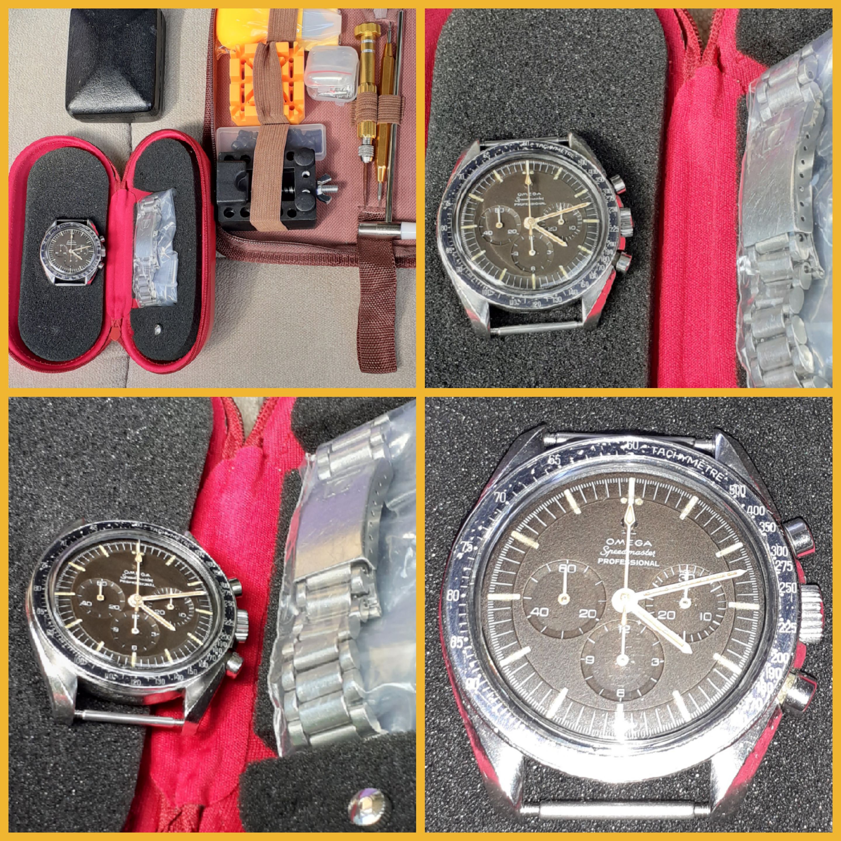

The question is: what do you think of the spring bar tool?... and what's all that other stuff for?
18,845
39,191

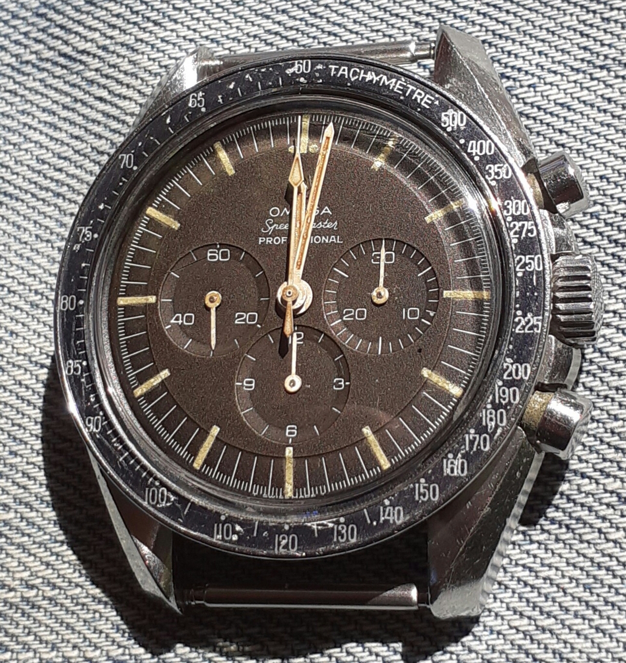

Have a go at it mate!
Good soft surface to work on (folded microfibre towel), even tape over the crystal if you like.
Check the orientation of the logo on the clasp so when it's fitted to your wrist, it looks the right way up.
Use a pointy thing to remove the pin holding the clasp together so you have two halves of the bracelet.
You can use some tape on the back of the lugs to stop scratching if you want to.
Remove the springbar from the case, fit it to the end link/bracelet, with the watch face down (lugS to the right if you're right handed), fit the end of the springbar into the hole in the lower lug and then use your yellow thing to ease the upper portion of the springbar down into the lug.
Repeat for the other side, refit the clasp pin and head for the beach.
PS: When that's all done, put the kit away and don't touch it again.
Good soft surface to work on (folded microfibre towel),.......
Use a pointy thing to remove the pin.... (see Jim's post above for the full info).....
Fakkinn hell Jim!... I might just have a go mate! 馃槻
To be honest, I'm not so much worried about damaging the watch. I reckon, if I take my time and follow your instructions, I could get it done without any damage!
I think my worry is making a bollocks of properly locating the pins in the case lugs... and my lovely old Speedy ends up falling off and hitting the pavement! 馃槦 I think there is just enough room between the strap and lugs to have a look and carefully check that they are lcoated in the holes.
Cheers Jim! 馃憤

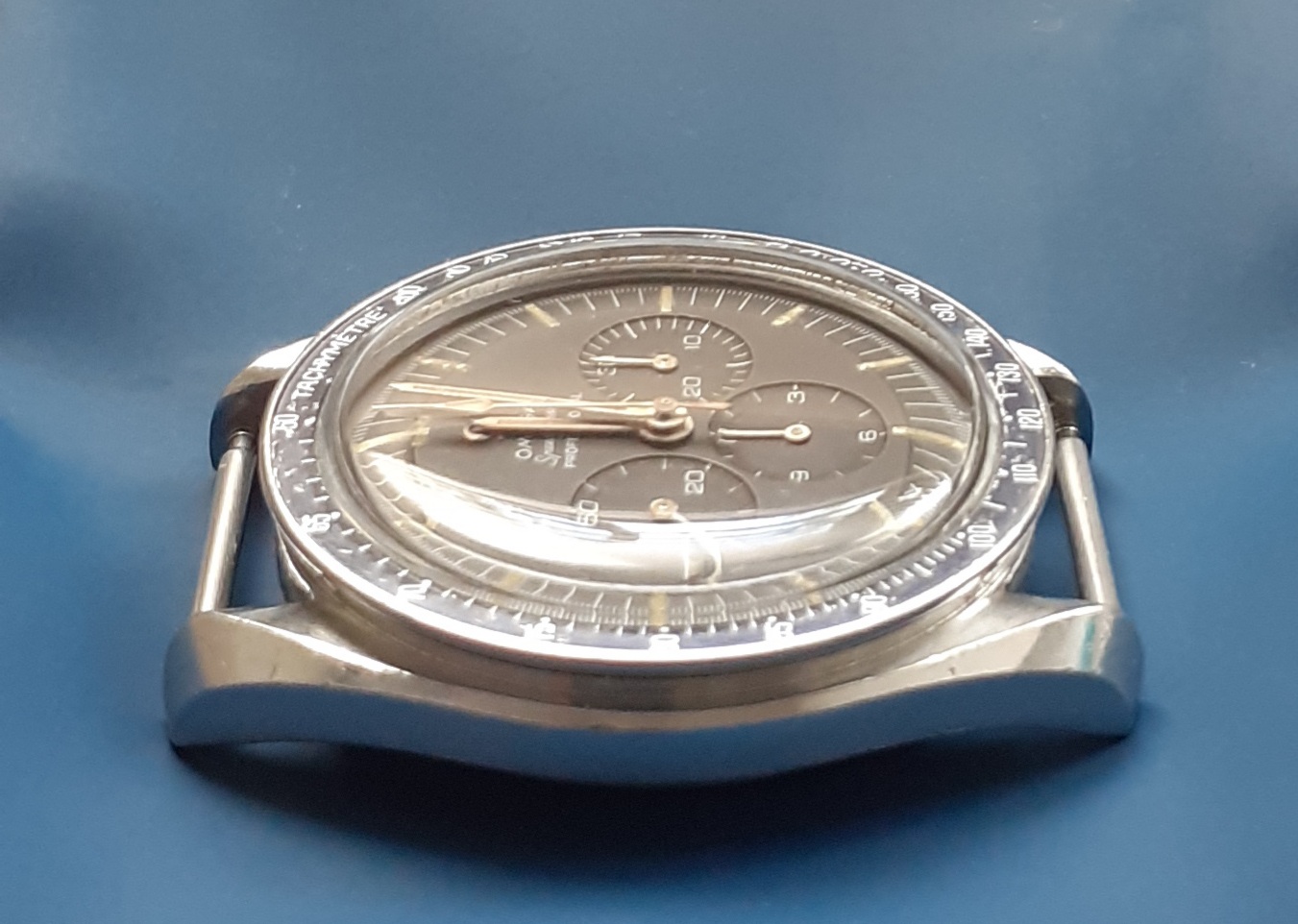

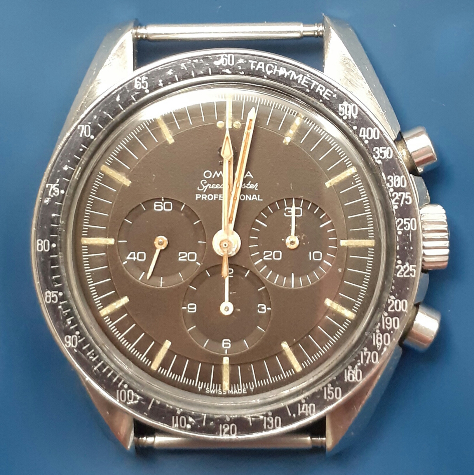

Make sure you use the proper length springbars for the bracelet.
13,558
23,506
You should hear a reassuring click when the prong bars engage. I always give it a gentle tug to make sure they鈥檙e in then check with a loupe to be on the safe side.
I鈥檇 give it a go!
2,170
5,733
Well thankyou for the reminder. Much appreciated. 馃憤 I have to say, I wouldn't know if they were correct or not. 馃槙
However, the spring bars, currently on the watch head, were actually fitted by Simon Freese of Simon Freese Watchmaker UK, following some calibration adjustments. He gave me the old ones back in a little plastic bag. That being the case, I'm pretty confident that they are now correct.
Cheers
Jonathan.馃榾
I鈥檇 give it a go!
I'm a big fan of "reassuring clicks" David.... I get them on my neck now and then, just to let me know my heads still on OK! 馃榾
Yep! I will definitely check it with my loupe and also will be giving it the odd gentle tug and will start by wearing it indoors, sitting on a soft sofa surrounded by cushions. 馃憤
The funny thing is David; when I picked it up from Simon Freese Watchmakers, he said "Do you want me to fit the bracelet back on the watch?" ...... I said "No... don't worry Simon, you've done a lovely job, I'll sort the bracelet out later!" 馃槦
As I walked back to the railway station, a little voice in my head was saying.......
"Why didn't you let him do it?.... He's obviously done it a few times before!" 馃榿

I have a Speedmaster that I bought with a 7912 bracelet on it that I could not remove. Off it went to Simon to have the spring bars removed. He changed them over for new ones and sent the old ones back.
It was advice from this forum that made me follow that path and it was certainly very good advice. With the new spring bars and a little patience changing bracelet/strap is fairly straightforward. If I can do it anyone can.
2,510
3,737
Hey glad to see you still have this! I know at one point you had mentioned possibly needing to sell it. I honestly would consider purchasing one of the Uncle Seiko flat links (or one of the other other manufacturers that have made flat links recently) and selling the 1171 on ebay since it doesn't really go with that watch. You could buy a new aftermarket flatlink and still put a few hundred quid in your pocket on the proceeds from that bracelet.
It is worth sourcing actual Omega spring bars, as they have the right length for the bracelet (can't remember the part numbers off the top of my head but I know @Archer can steer you right). The Bergeon 6767F tool has served me well for bracelet and strap changes. I had a knockoff Bergeon first and it was NO WHERE near as good on the fine tip. Name brand really does make a difference.
6,609
26,780
I believe there is sentiment behind the bracelet as it belonged to the OP鈥檚 father and looks to possibly be the bracelet he鈥檚 wearing in the photograph above.
my Dad's, early 1970's, 1171/633, service bracelet.
2,510
3,737
That makes sense!

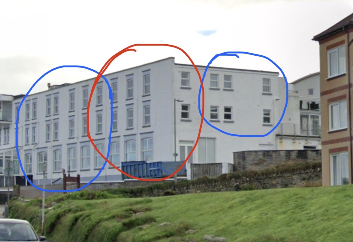

As to recreating the pic, there are a couple of problems you may encounter, first that building in the background has probably been knocked down by now and replaced with some monstrous 30 floor apartment block and the Ford Escort will have dissolved into a small pile of red dust! 馃榿

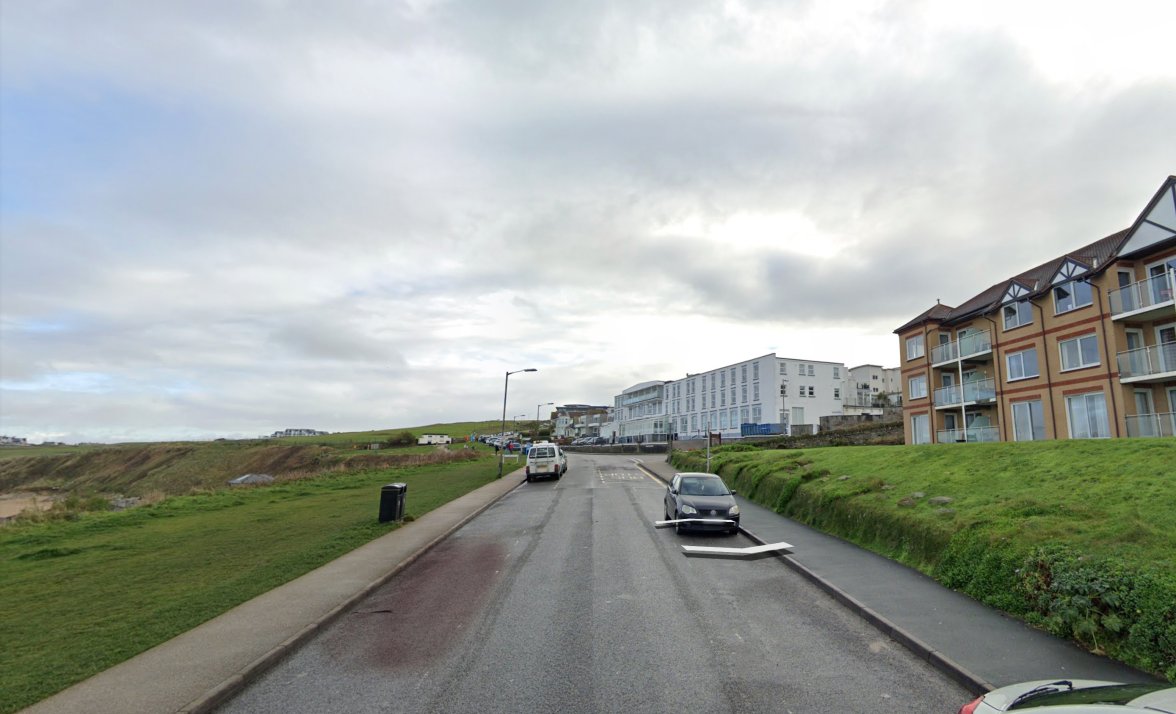

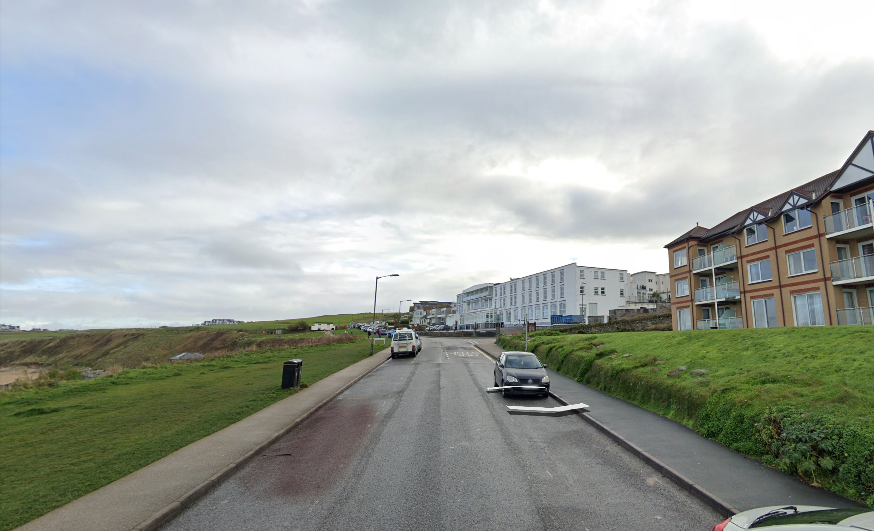

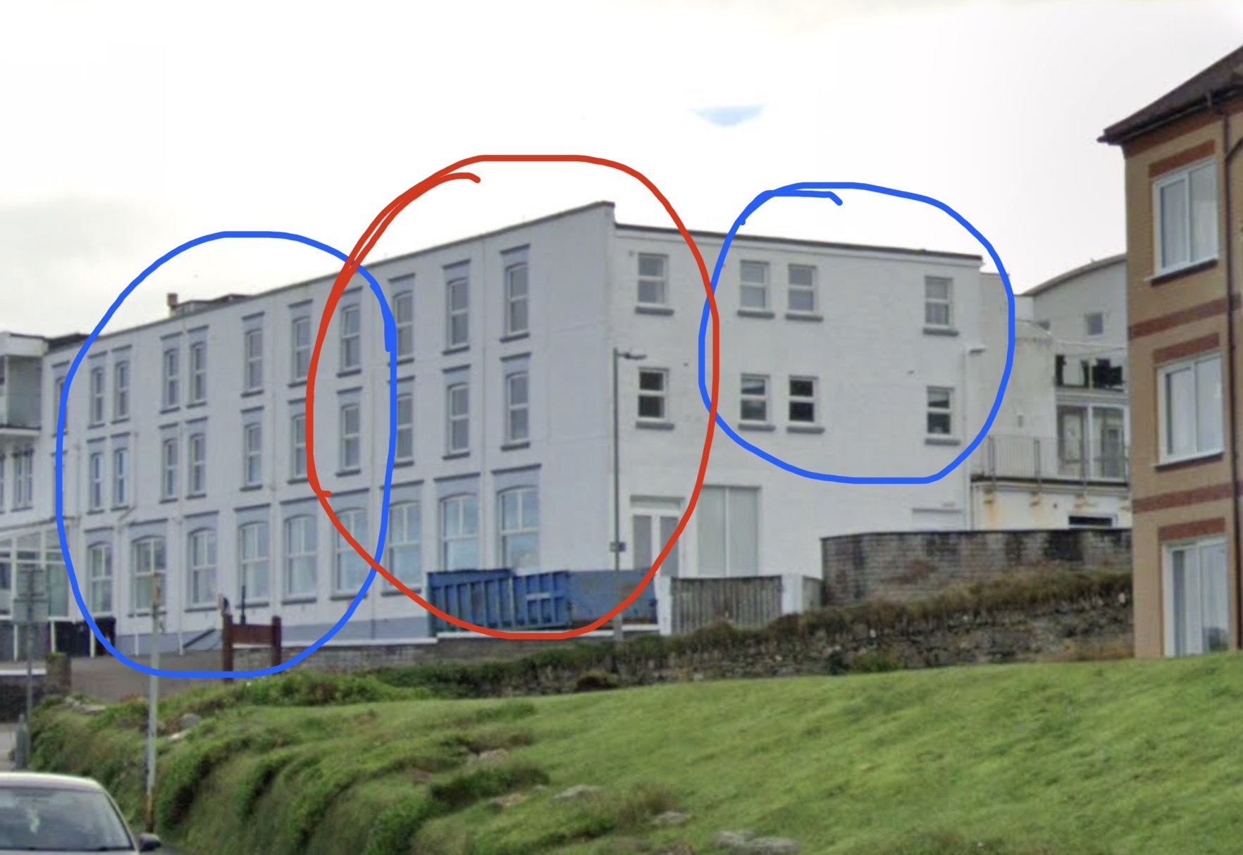

I needed a mental break from my school work so, thanks to your aunt and the photo of your dad, I spent some time virtually traveling around Fistral beach in Newquay and I am quite confident I found exactly where this photo of your dad was taken.
The landscape and surroundings have changed a little since that photo was taken, however, there are enough similarities that make me feel confident this is where he was. The red circle in the second image helps to visualize where your dads head would be and what details it would be blocking. The blue circles show the details that are the same- the paired up windows on the front of the building and 6 total windows we can see on the side. *It's impossible to recreate the same perspective/compression in Google street view to match the image of your dad, but I do believe this is where he was.
Right in front of these buildings is a huge grassy field and overlook of the beach below. Your aunt has a very good memory 馃憤
I will send you a PM with the address 馃榾
Edited to add more information and better readability
The red circle is roughly where your dads head would be in the photograph above.
Where鈥檚 the Ford Escort?
That鈥檚 a really wonderful gesture on your part to find the location.
6,609
26,780
Thanks 馃榾 it was fun to explore and look for clues. I like a good puzzle and mystery and this was a fun one. Now I can't wait to see the OP's recreated image! That's a fun idea on their part to relive this history and bring this watch full circle now on their wrist. I like that idea a lot.
