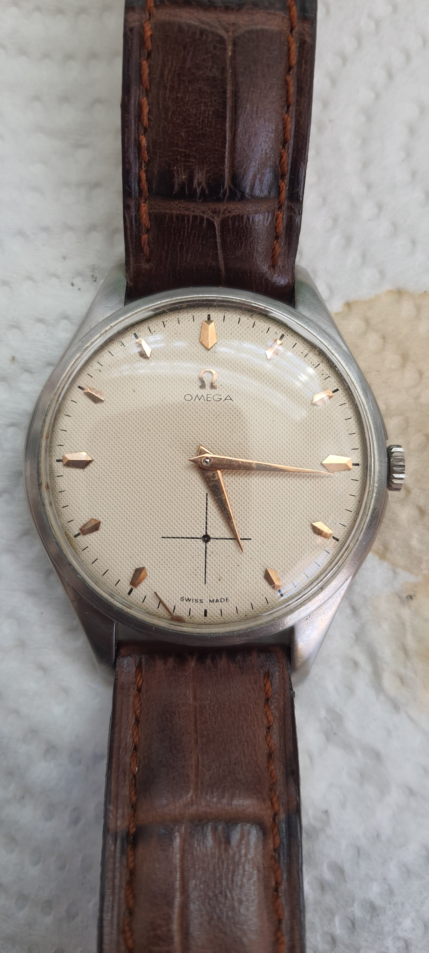

Hola...alguien puede decirme algo sobre estos relojes..? Gracias

Hi..Could someone tell me something about these watches..?? Thanks..

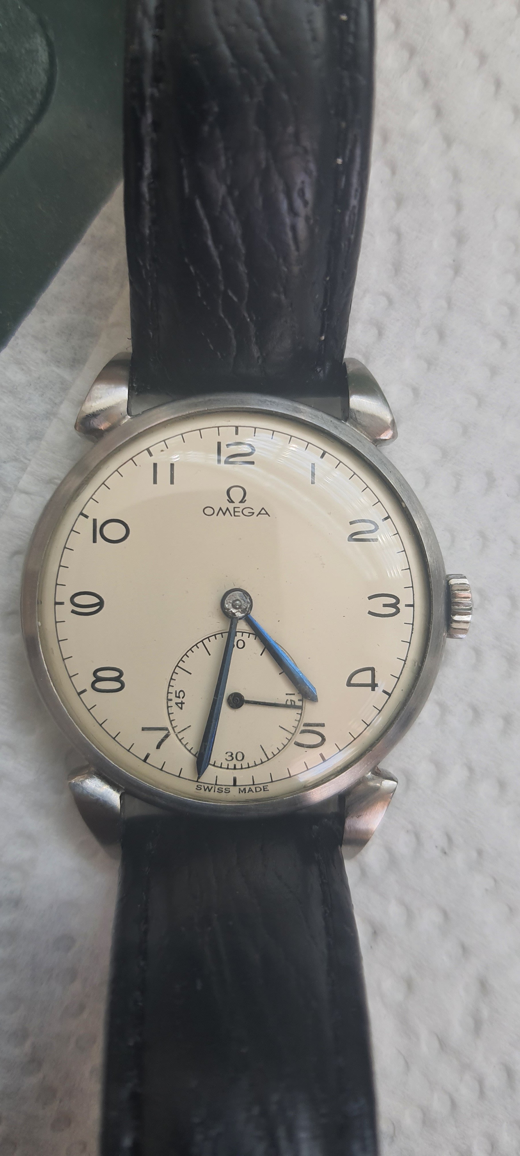

Two Omega watches with redone dials, probably from the 1940’s. The hands do not look correct for either of these watches.
We would need to see the movement and the inside of the caseback to say any more.

okay..!! I will put photos of the machinery.

I do not see what would make doubt about the 1st watch.
it is often said that textured dials are very complicated to redo, so they are most of the time authentic.
more pictures would be needed
The location of “Swiss Made” is incorrect. It should be below the minutes track. The logos have a more modern font than they should.

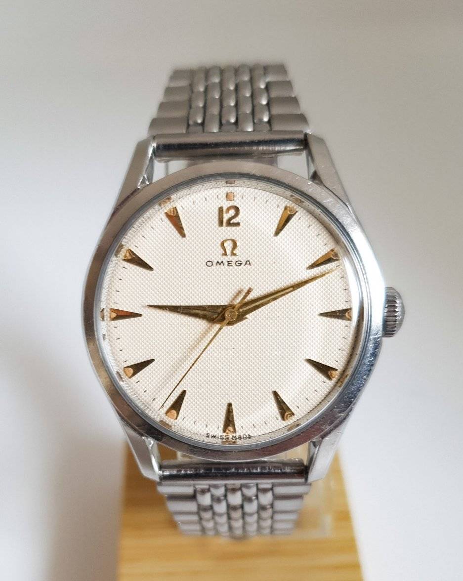

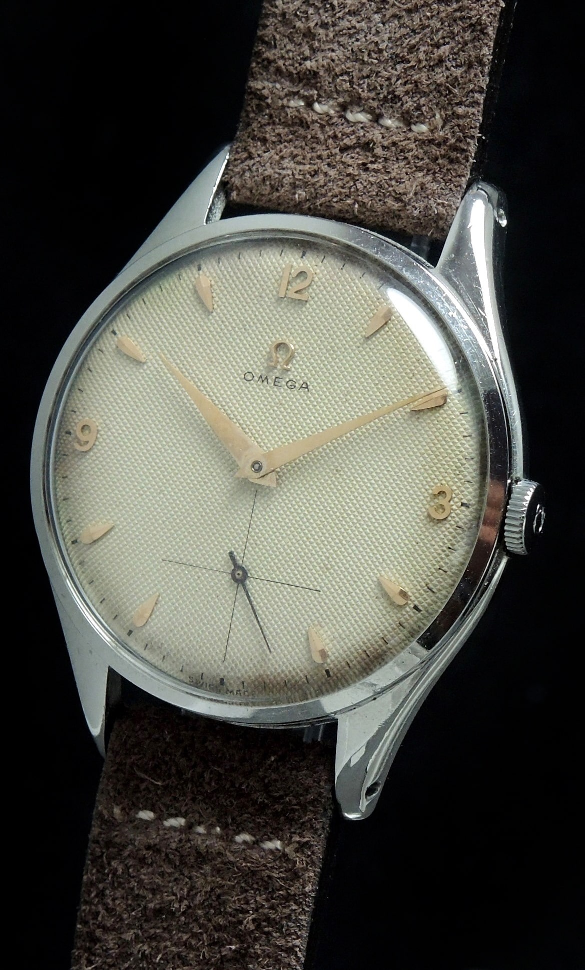

please some image as an example. to show .... thanks
17
It is similar, but it is not the same... it changes the tips of the hours and it does not have a second hand. Thanks for the image

Is this better?
There are hundreds of different case, dial and hand combinations with these watches. You are unlikely to find one that matches exactly.
