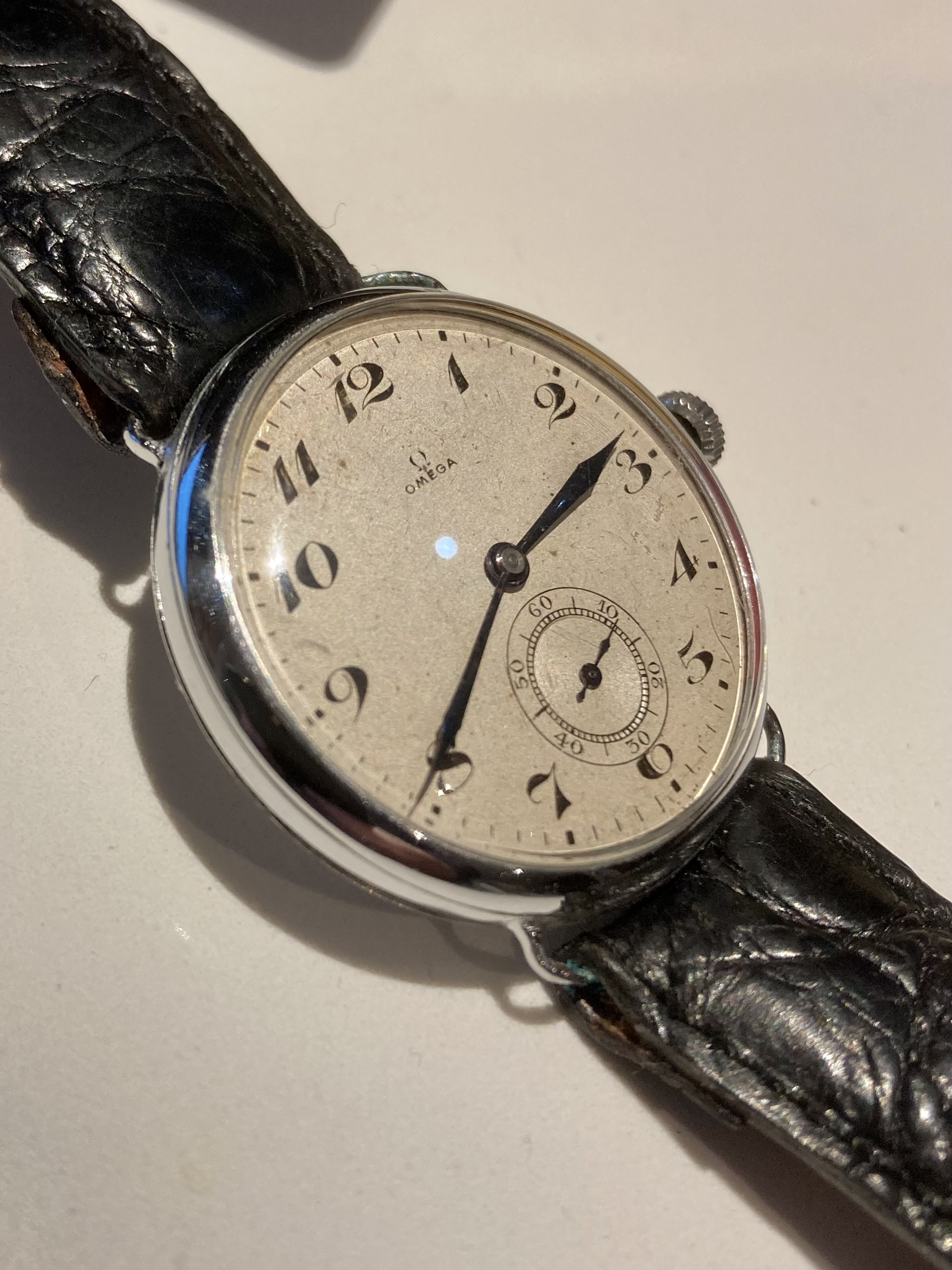

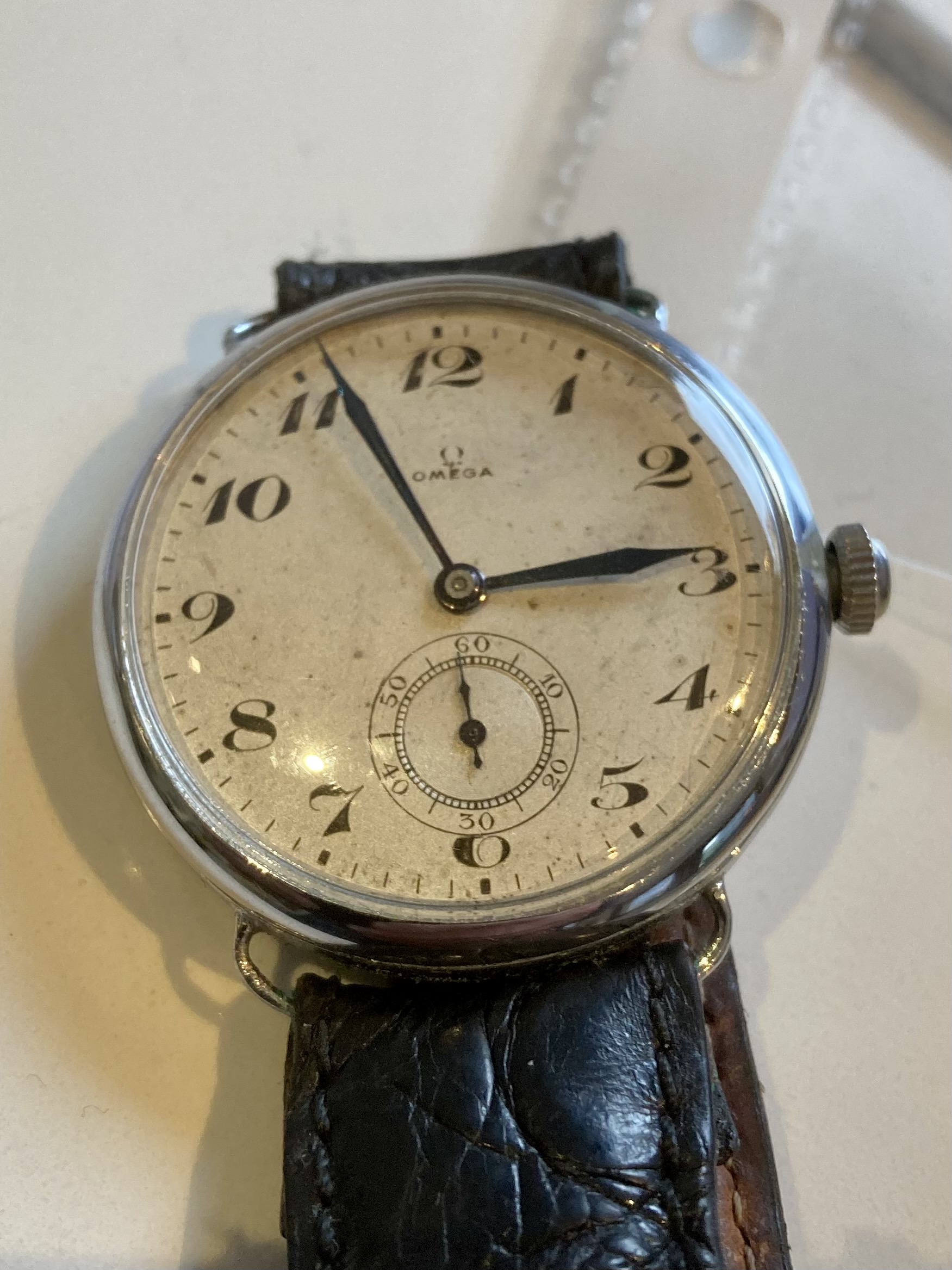

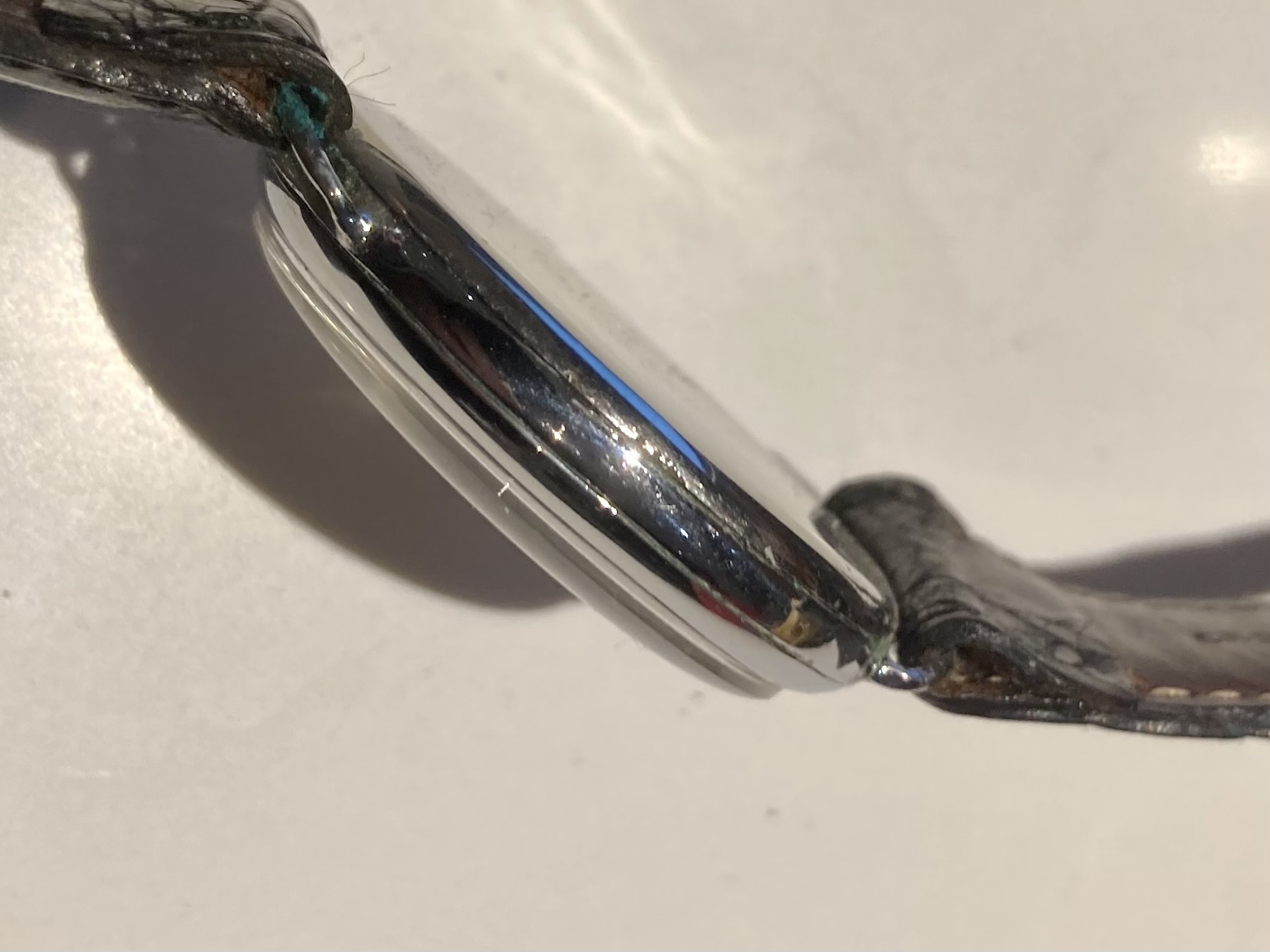

Good evening all...
Total newby here who would love some information on the watch in the attached photo.
No markings on the back just smooth...
I'd love to know something about this watch as it was a gift a long long time ago that was misplaced and
has just been found again !
Best wishes and many thanks
Tim

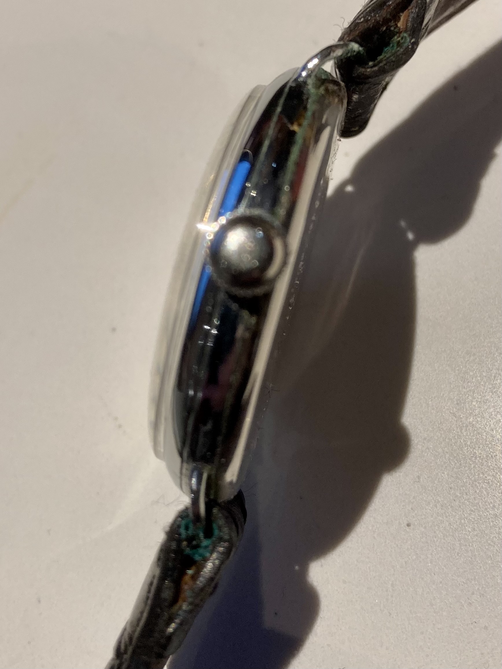

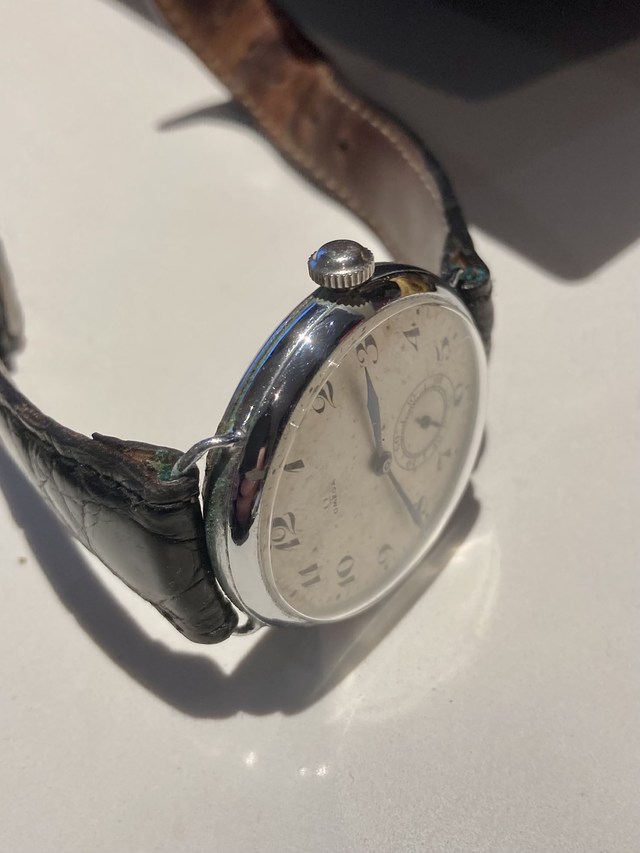

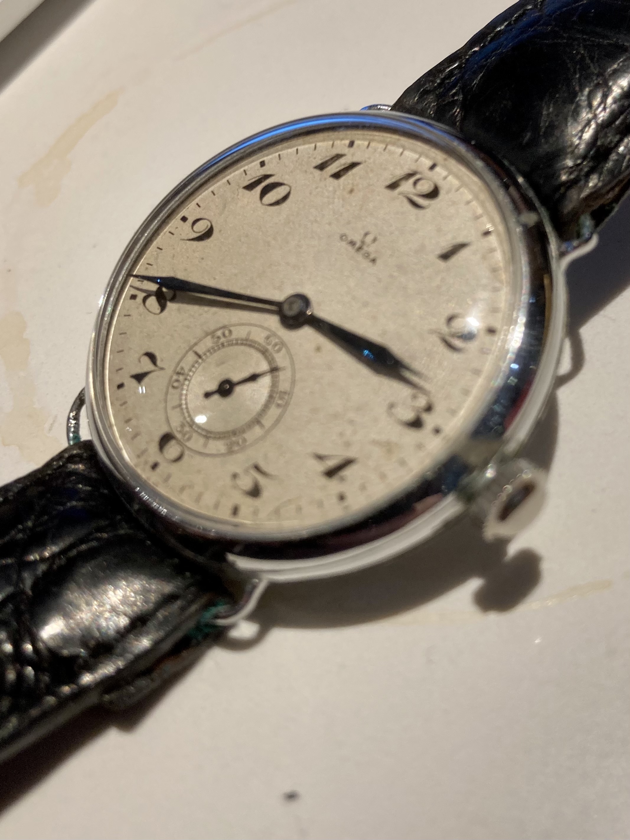

Hi and welcome, please post more pics, different angles, side view etc and the experts will help you out.

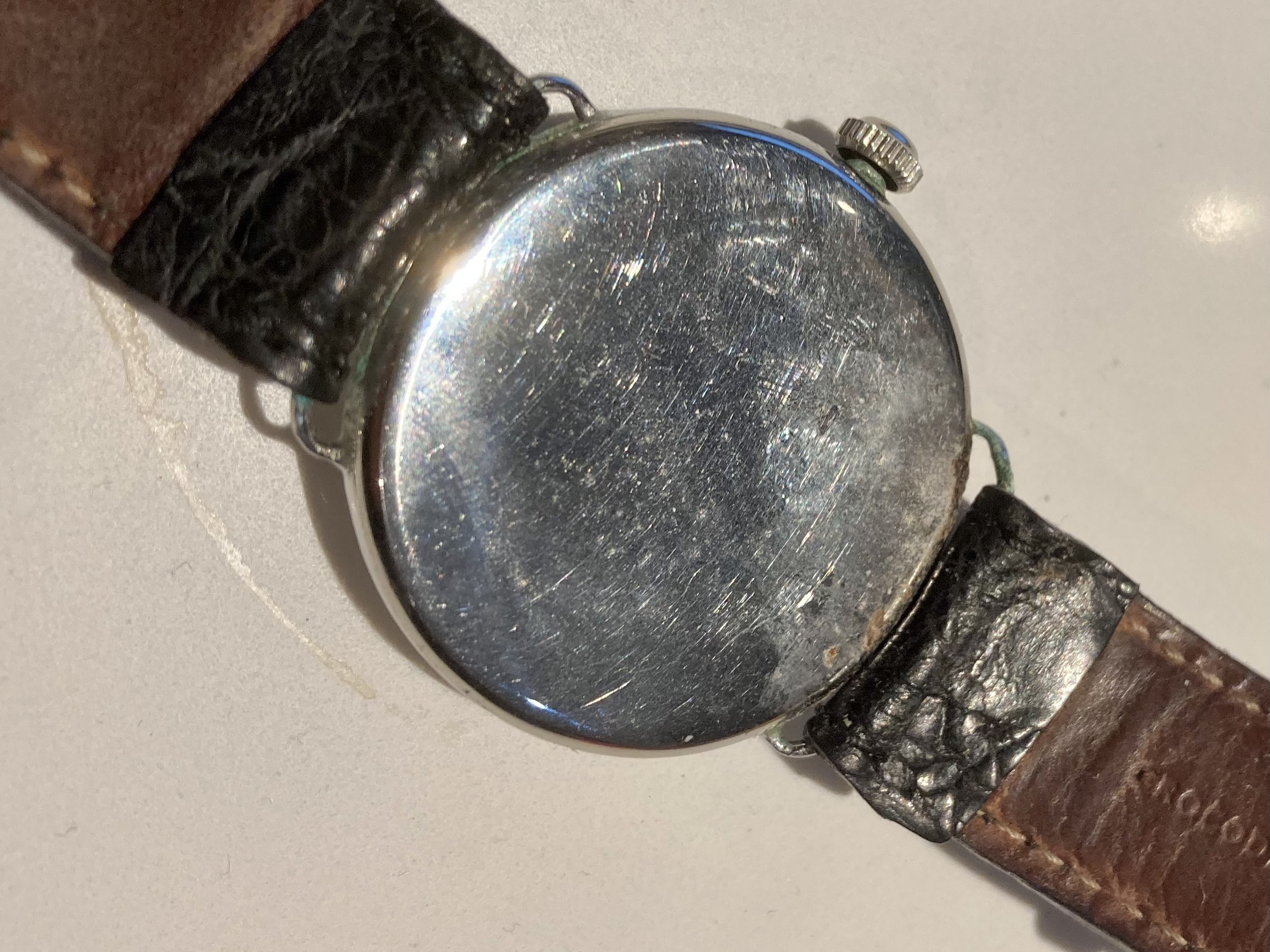

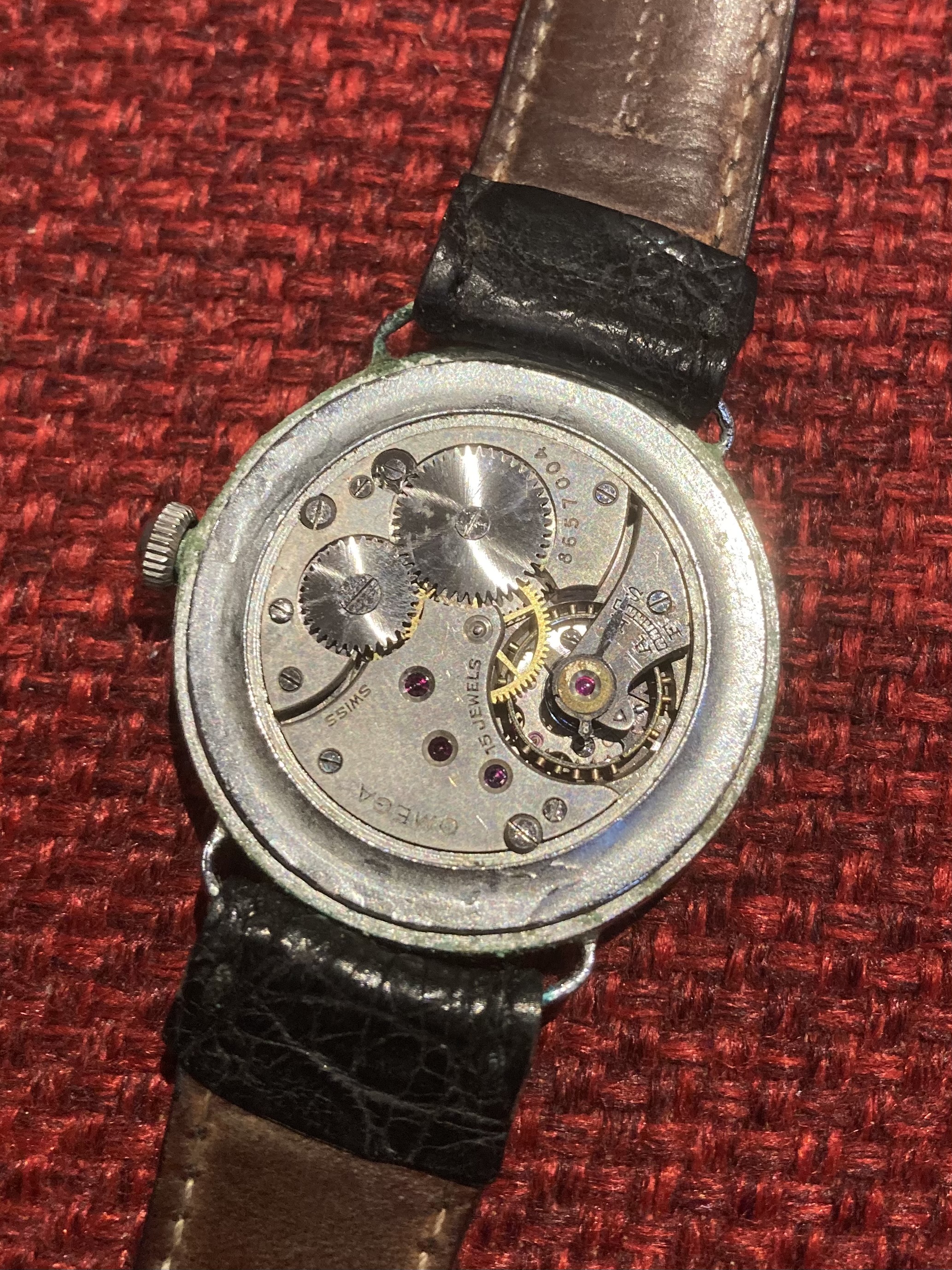

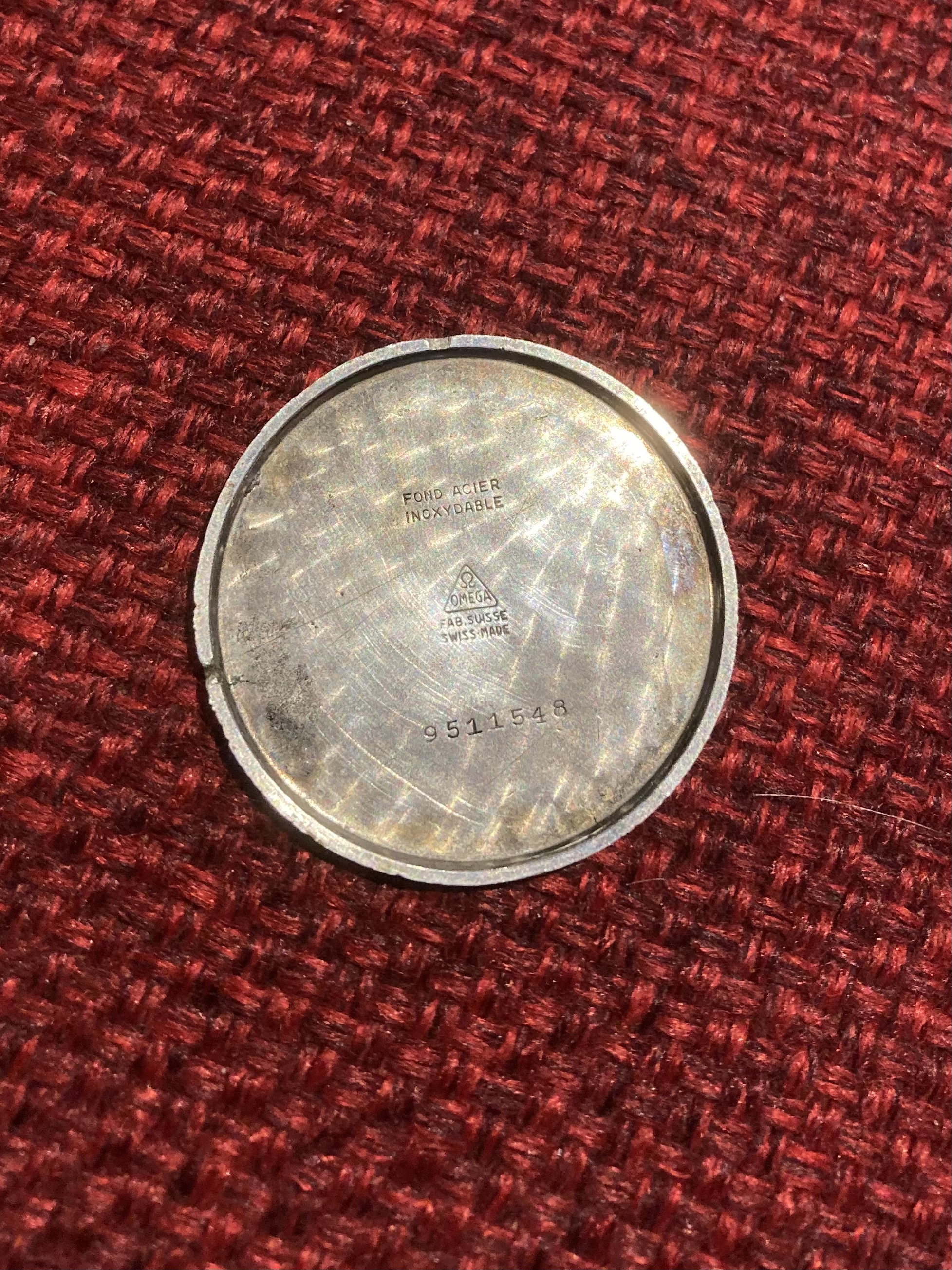

I'm wondering if this is a pocket watch conversion. It would help to see the inside of the case back and the movement. Are you able to pop off the back? Look for a lip or gap along the case back seam where you can slide in a fingernail or blunt knife. It should open if you go gently, don't try to pry or twist.

Serial number puts the manufacture date around 1935.
I'm not seeing any shock protection, so my guess would be pocket watch conversion, done a long time ago, judging by the wire lugs.
Cool piece. Does it run and keep time? I would get a new strap, get it serviced, and wear this around.

That is not really indicative. There are a lot of watches built as wristwatches that are not conversions and have no shock protection.

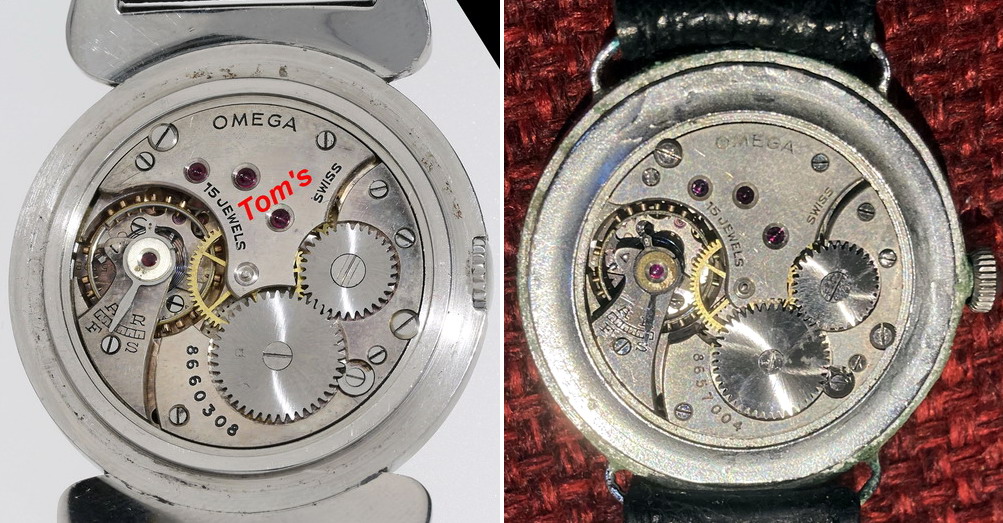

I suggest that your watch started life as a wristwatch (just as it is), probably about 1938. It has the calibre 26.5.
To start with, the calibre is 26.5 - which was a wristwatch movement: there would be no point putting it in a pocket watch (although Omega did do that with the 23.4! But not many - because there were many dedicated pocket watch movements at that time).

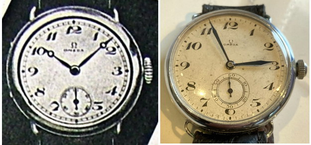

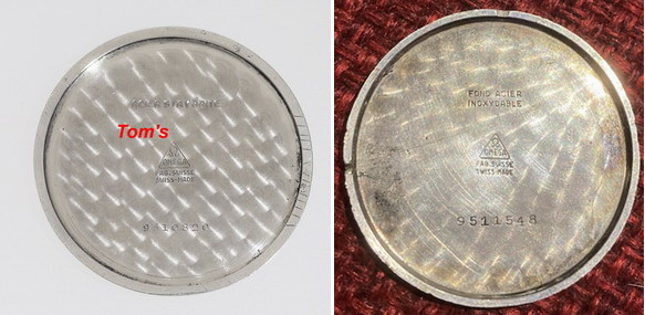

I show a catalogue image from 1933 which shows three 26.5 wristwatches– with a similar watch (not quite the same).
I also show a 1938 watch of mine with calibre 26.5 and similar numbers. OK, the watch is different (it’s a Scarab) but the guts are the same.
I suggest you find a suitable watchmaker (not so easy) and get it serviced - and ‘wear it with pride’!

Agreed, it’s a wristwatch. I was surprised to see that the wire lugs persisted into the 1930s - I had thought that they disappeared well before then.

I ruled this out as a pocket watch conversation because of the Omega signed case back. Is that a reasonable assumption, or did Omega make cases that could be used for converting pocket watches? (@OMTOM ?)

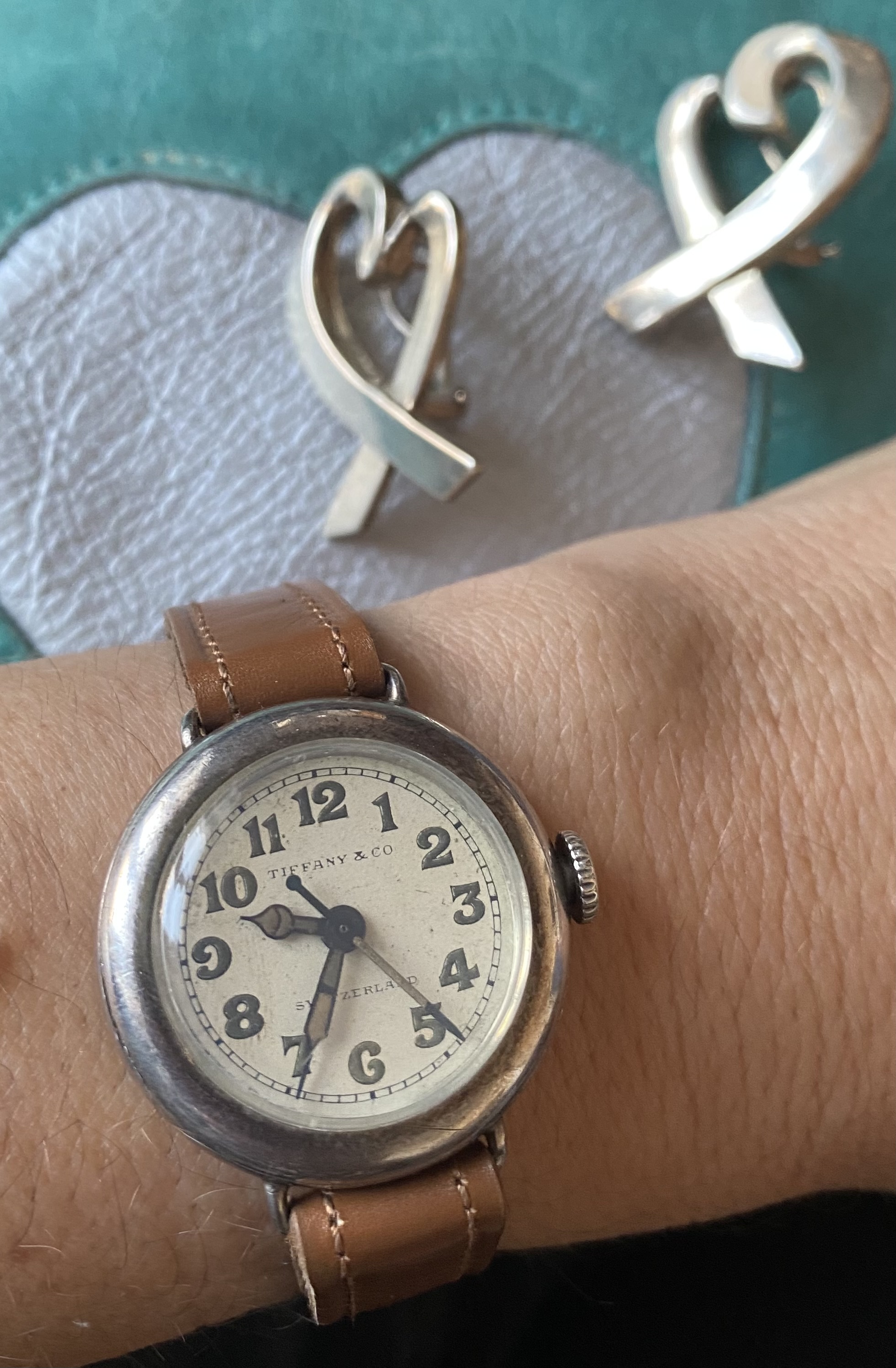

As for wire lugs lasting into the 1930s, here’s another exampoe from a different brand, sold in 1932. I was quite surprised myself.
