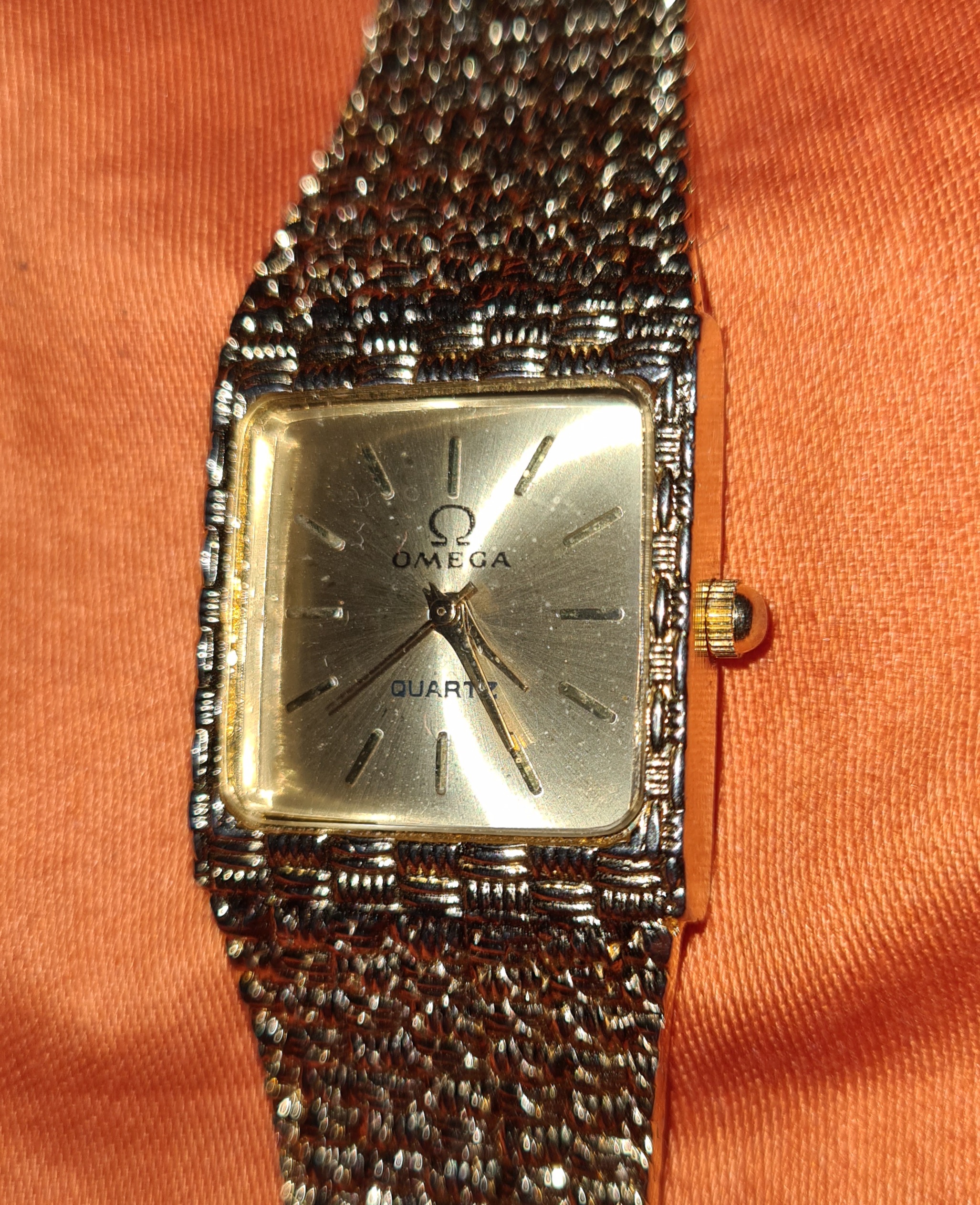

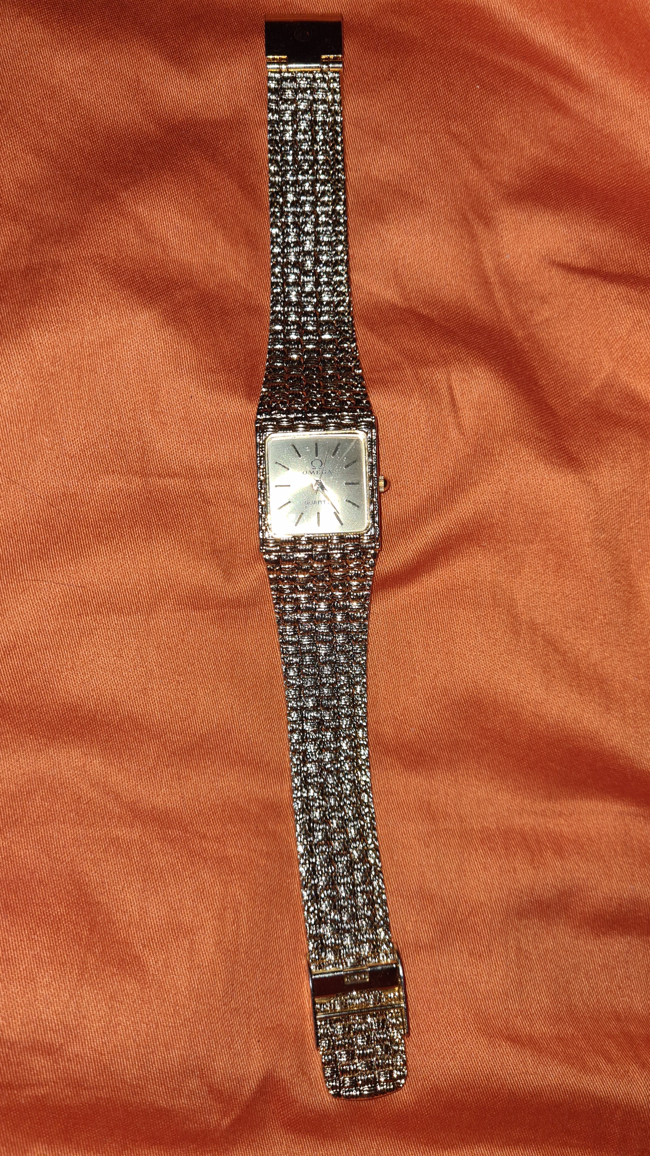

Hello. I have a question. Is this watch original or fake?I couldn't find anything on the internet about it. I don't know the history of the watch.

There were lots of different variations of small dress watches that Omega made for women.

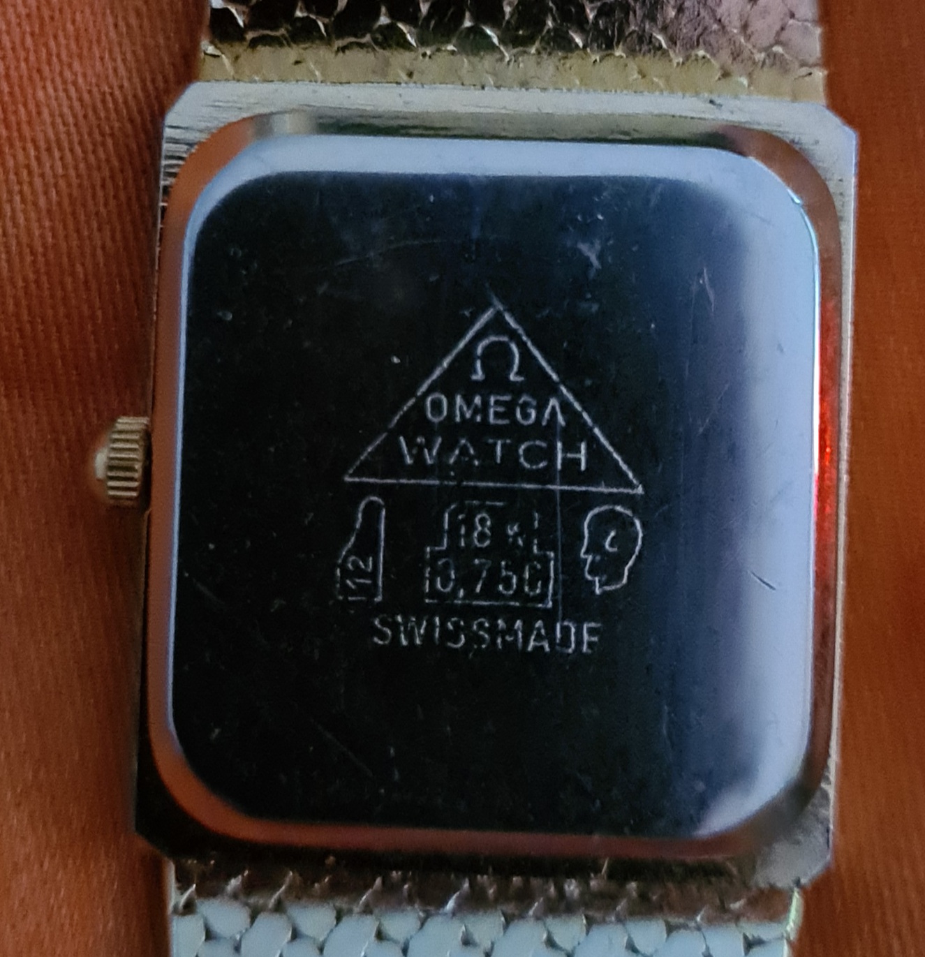

What you have there is unfortunately just a cheap watch that has Omega written on it. They may have been copying a specific Omega, but just as likely not. Even if they were copying, it’s a bad job; even the logo is way off.
The 18K stamp on a steel case back is a dead giveaway.

As a rule to spot fakes..Omega never stamp the outside of the case with 18k, 0,750 etc ..those are always inside of the watch..
That’s not always true. Many US made Omega watch cases have fineness hallmarks on the outside to comply with the law here.

Google “Autobahngold”. Those were sold to tourists in Europe (especially in Italy) in the 60-70s.
