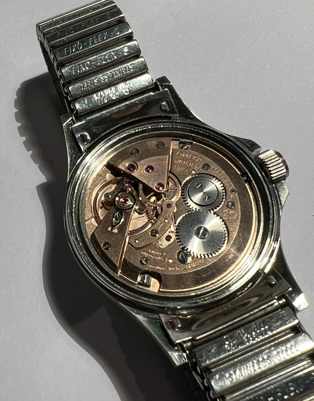

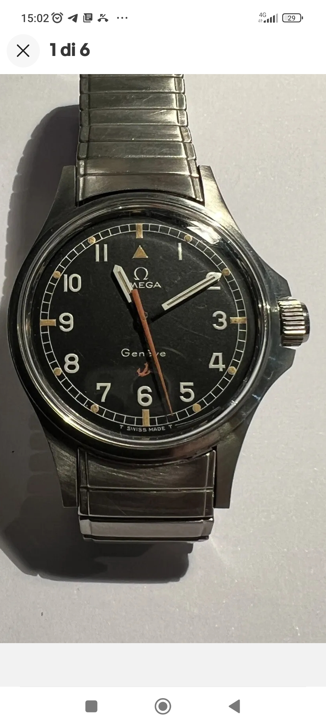

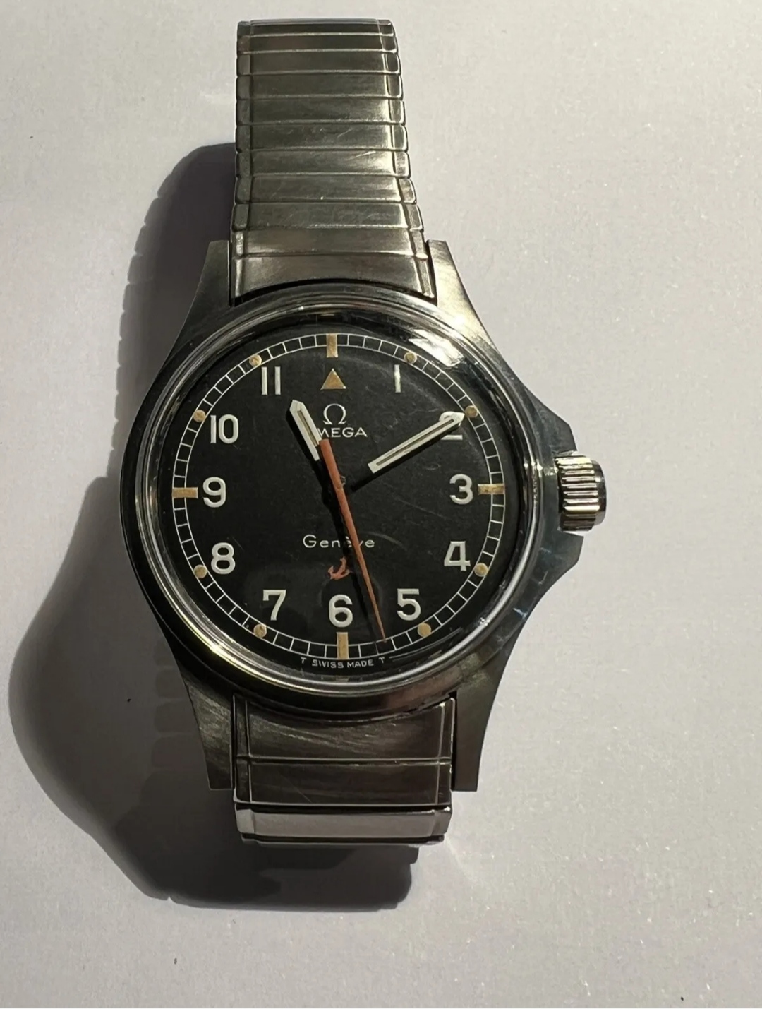

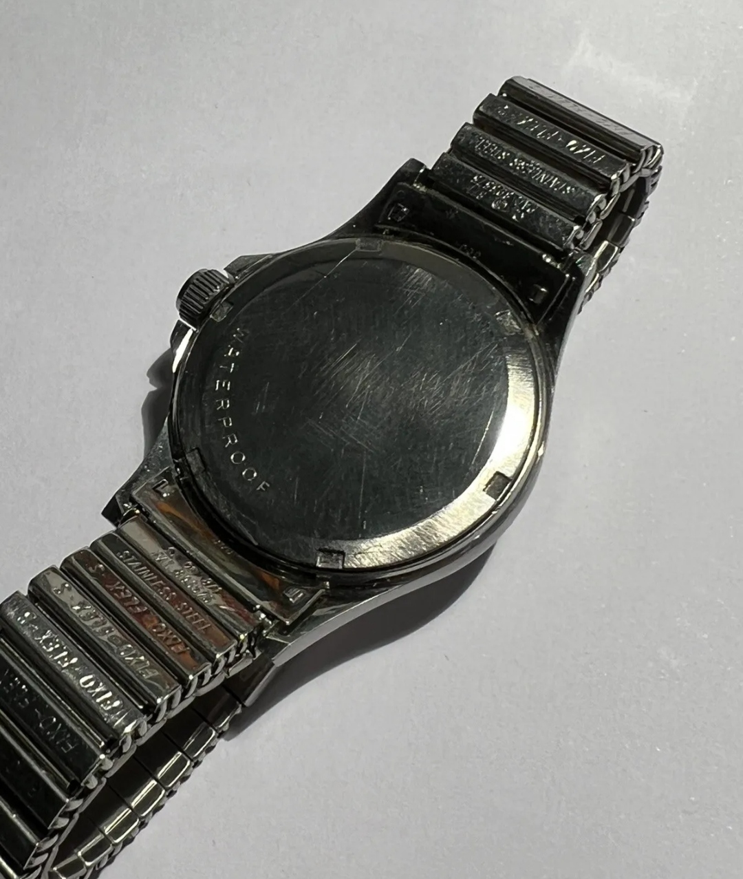

Hi friend. I dont find thia reference.
Can you hel me.? It Is originale Watch or It Is Frankenstein? I find similar with date buy not without. Thanks

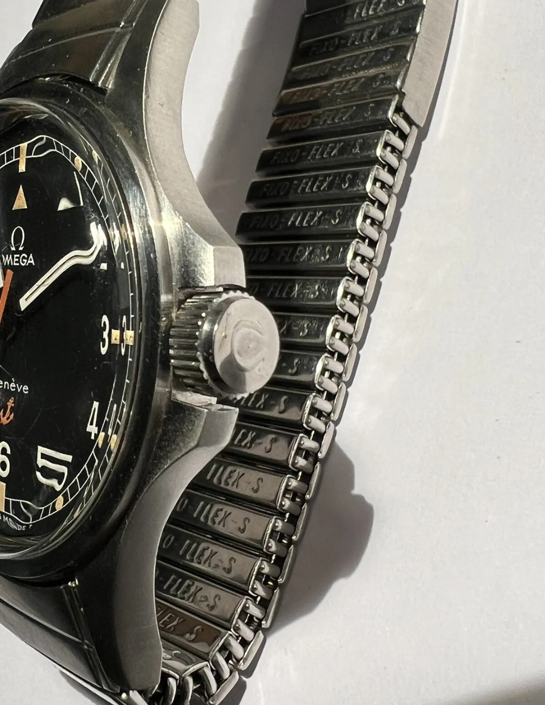

The watch is legit but the crown is a wrong replacement.

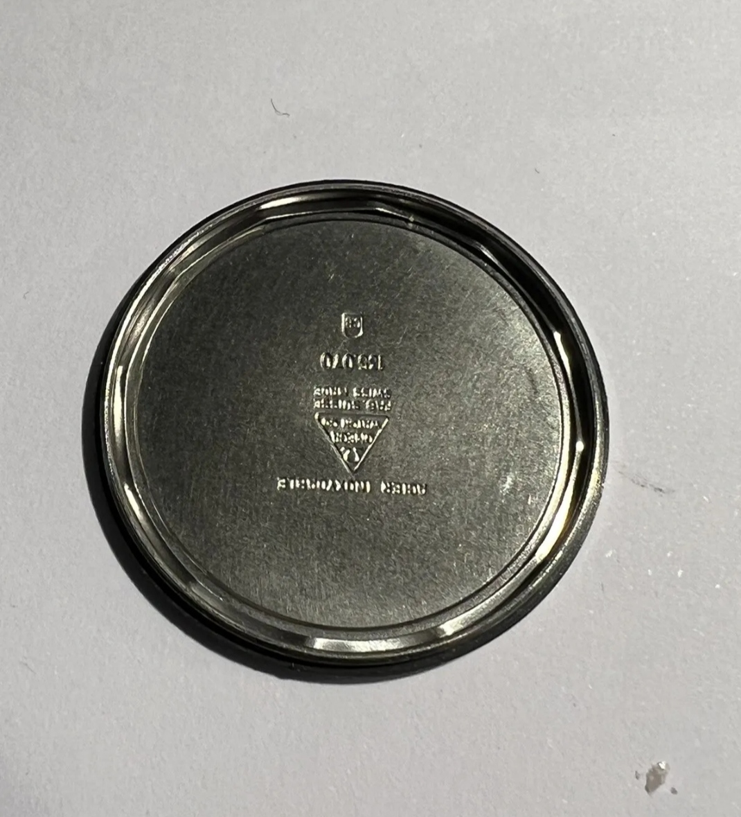

Also the case back has probably been swapped, it is reporting the wrong reference.
Correct reference for this model is 135.015.
100% correct. The original winding crown is no longer made and even the official replacement crown is a different shape. Look up the thread I started called "Comprehensive Admiralty Thread"
