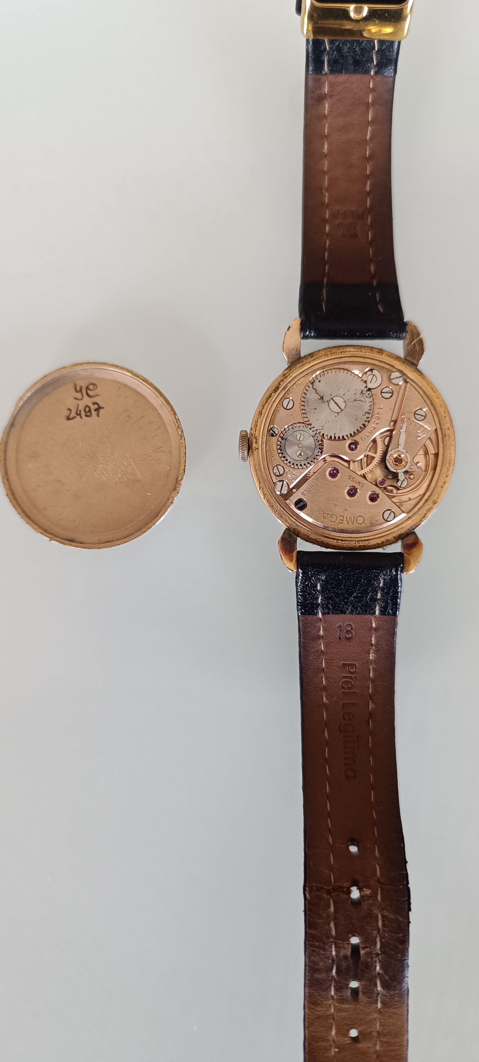

Hello everyone.
I need help identifying this model.
I received it a short time ago and I don't know much about it.
Thank you all.

Please open it up and post good photos of the inside.
185
170
Doesn’t appear to be in too bad a condition, other than the dial spotting. Would love to see the movement and inside caseback. As for the model, not all Omega watches have a model name.

'good photos' means legible text and numbers!
We don't need to see the entire strap in every photo...
185
170

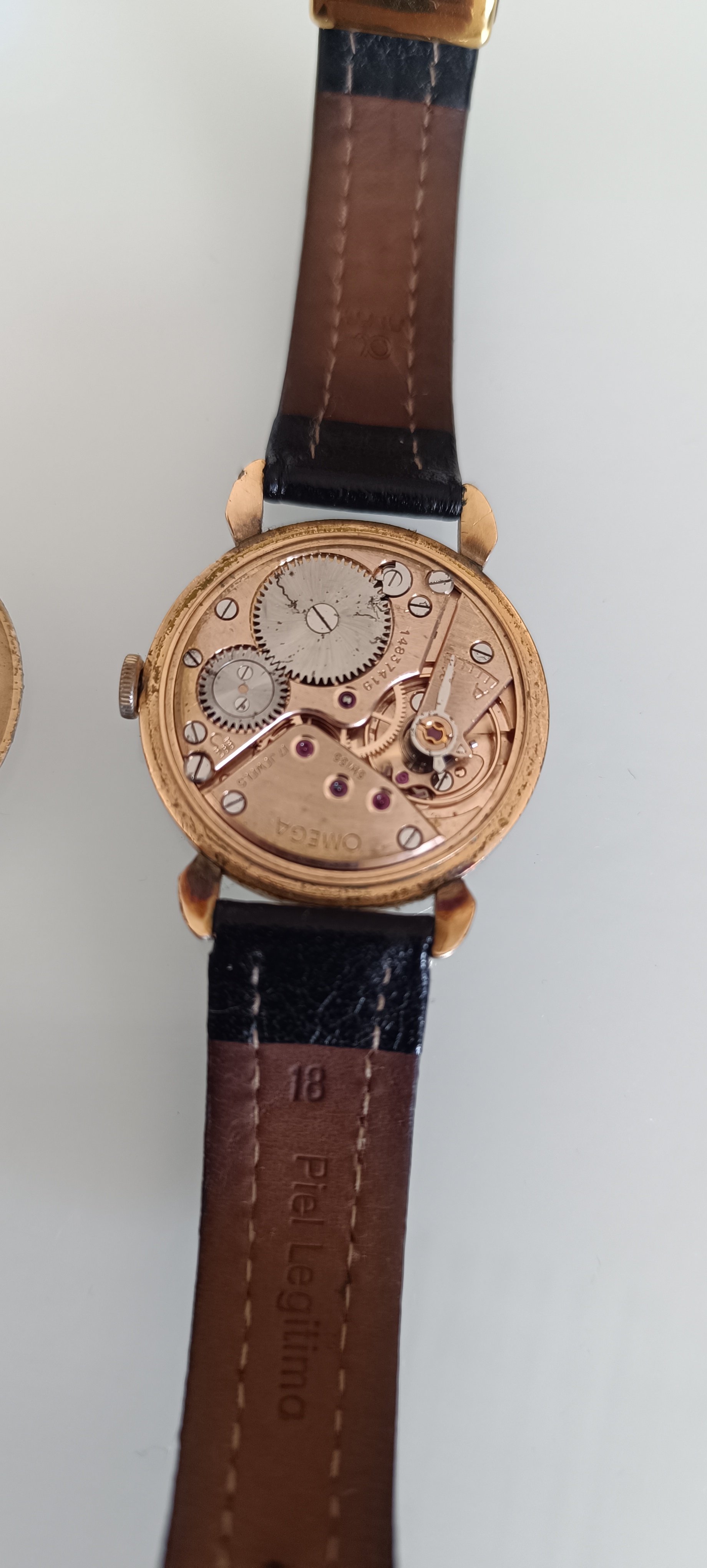

We need nice tight photos of the caseback and movement in bright light. Use the macro setting on your phone.

Gold plated case, caliber 268, ca 1955.
Can't say much more without a clear photo of the inside of the case back.
