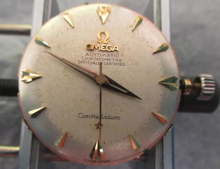

Hello, does anyone have a document showing this data? I have a lot of docs regarding calibres, I don't remember where I found them however there is no data re hands.
I have a Constellation bumper w/ cal 354 and I need new hands.

There is documentation from Omega and hands are based on the caliber and case reference
On the Jules Borel site. Minute hand could be either 10 mm long up to 12.5 mm depending on dial design. You supply the info and they match up the hands.
Same for any supplier
Unless someone has a copy of the Omega reference book. Not sure where you would find one.
Could email Omega and ask if they have one

I asked Omega customer service. Hopefully they will reply one day.
Hand part numbers are determined by the case number. You haven't stated what case it is, so that information is required to help. Also the case material and hand colour...
hey thanks, it’s ref 2782-9SC luminous dauphine gold (plated I guess) hands.
