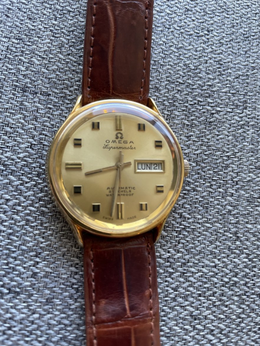

hi everyone, so I just restored a vintage Omega Supermaster from my father, I guess he bought it in the 60s or 70s??
Would love that those Omega connoisseurs could give me some info about since there's little to none information online about this model. Also, it seems the crown has only one position, and changing the date/day is complicated, any advise on this?
Thanks!

It’s a reminder of your father but it is completely fake.

It looks very nice and you’ve done a great job restoring.
Stick around OF and enjoy vintage watches generally

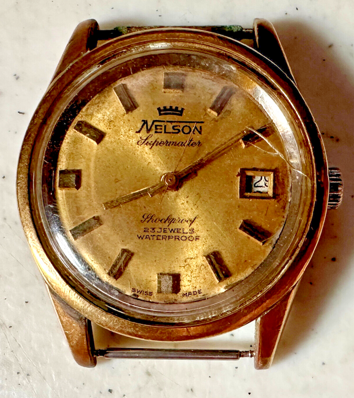

It's actually a Nelson Supermaster.
At some stage in its life somebody thought "Omega" would bring in more cash than "Nelson".
A Nelson example from eBay.

When I read the title of this thread, I was wondering why I’d never heard of an Omega Supermaster…….now it’s clear I hadn’t heard of it because it never existed.
Pity it’s a nice looking watch.

I’d rather they left it as a Nelson
It’s a bit like sticking a Mercedes badge on a Toyota…… nothing wrong with the Toyota but the Mercedes badge is an unnecessary addition

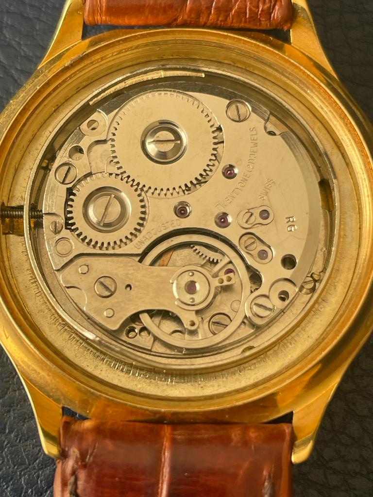

Looks to be a Lupermaster. Is it indeed an automatic? a movement pic would be interesting.

A movement pic would probably be uninteresting.
Nelson watches used a variety of economical calibers such as EB pin lever movements.
The OPs watch is a manual wind, possibly an EB (Ebauches Bettelach) of some description.

Could be an A Schild 1187. Which is a pretty decent lever movement.
I am surprised at the finish on the EB movements. Found I had a box of disassembled parts. For a pin lever these were top of the line. Some of these even had chronograph complications. Duplicating such movements would not be easy. Must have been an incredible system of automation to create these. Quartz of course killed all this. Probably benefited from the knowledge gained.

I am surprised you/your watchmaker did not notice the fact that it is not an Omega during the "restoration". Nonetheless enjoy your Dad's watch!
Thanks all for your comments, now I wonder how this was sold to my dad and how he got scammed LOL - When restoring, the guy told me the mechanism wasn't Omega, so now all makes sense. I will open it later and share a pic with you all.
--Updating with the mechanism picture with the following legends: "unadjusted", "twentyone (21) jewels", "swiss" and "RG"
