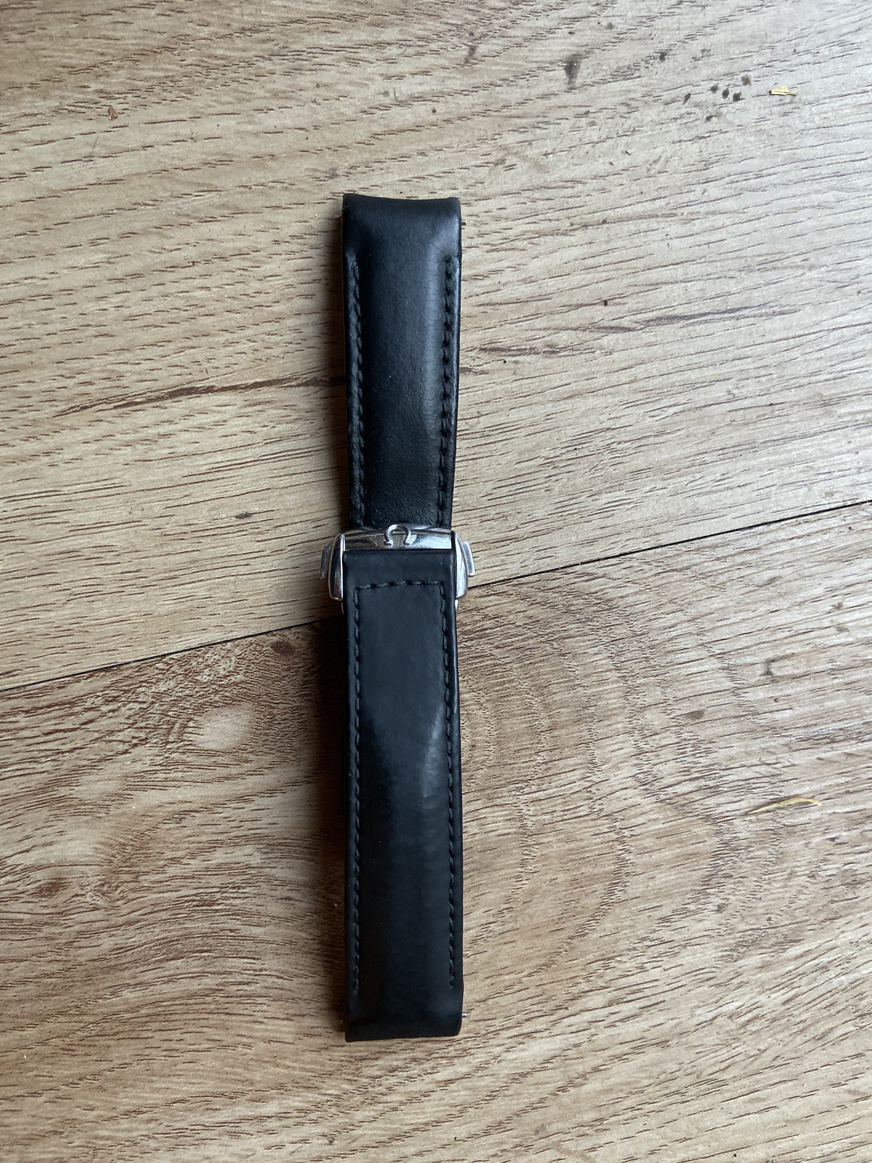

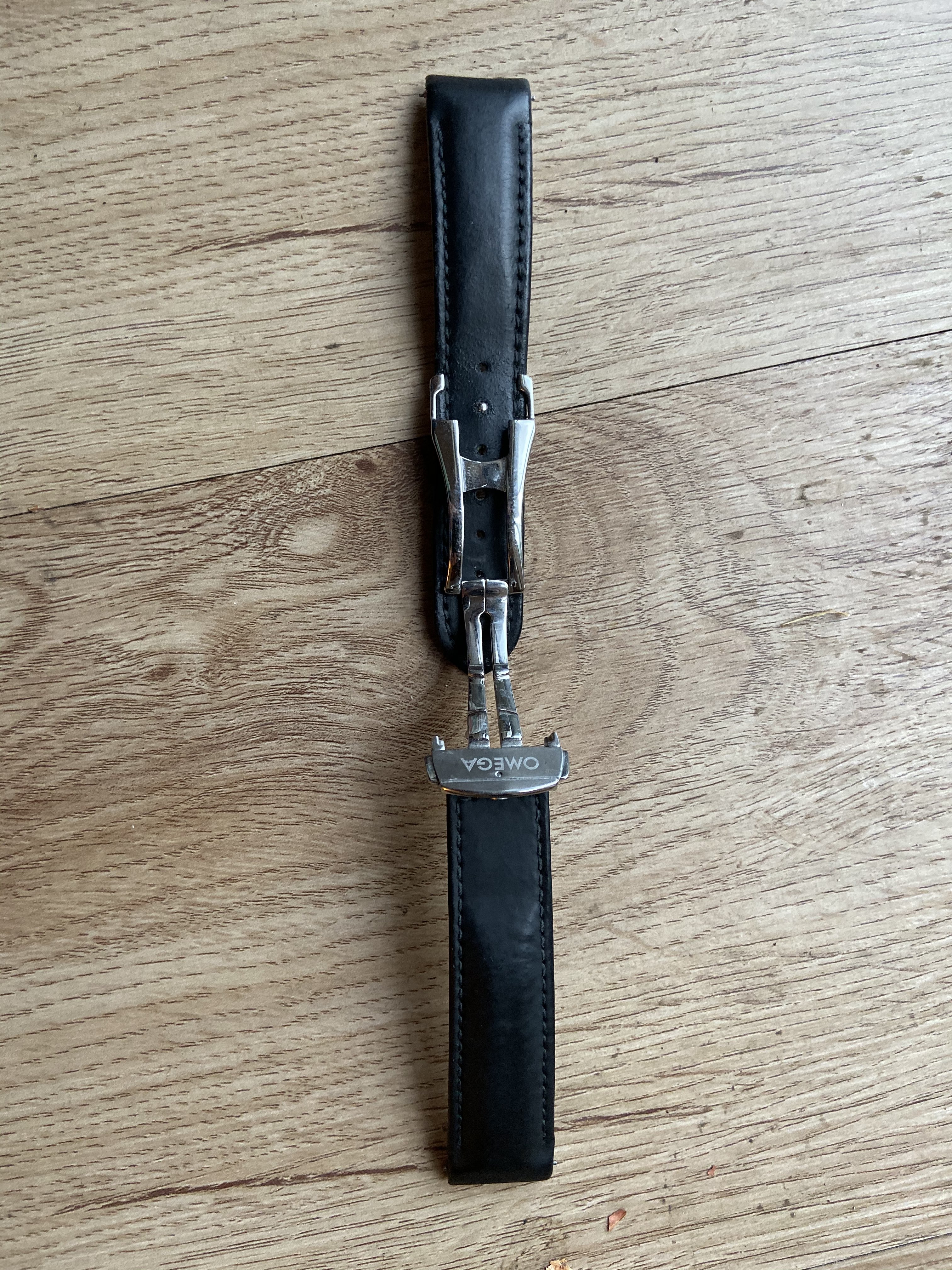

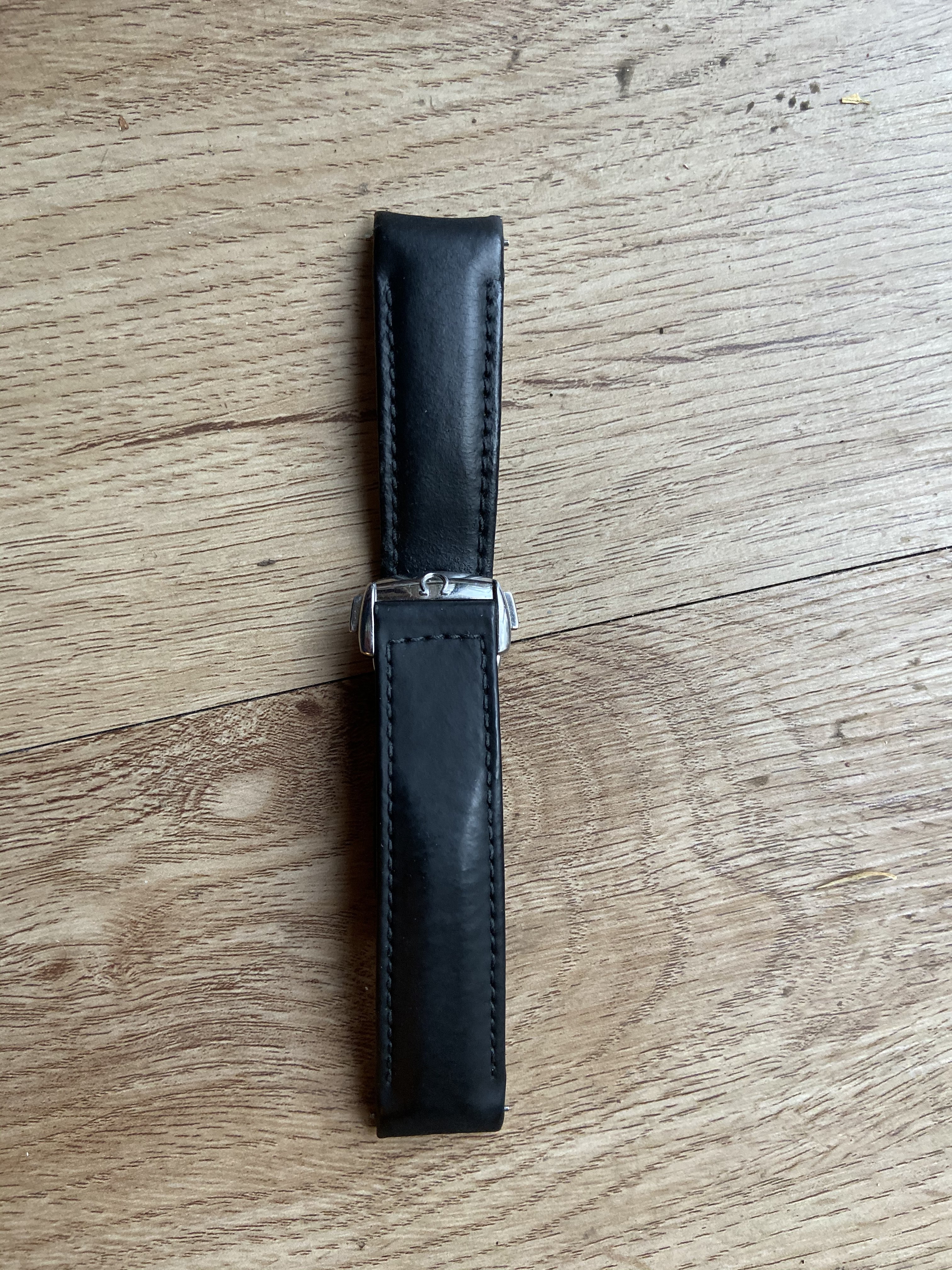

That (or any Omega or Omega-style deployant) won’t fit a Hirsch Robby strap, because the ends are too thick. Omega deployant straps are only 2 mm thick at the end in order to slip through the guides on the deployant and be secure.

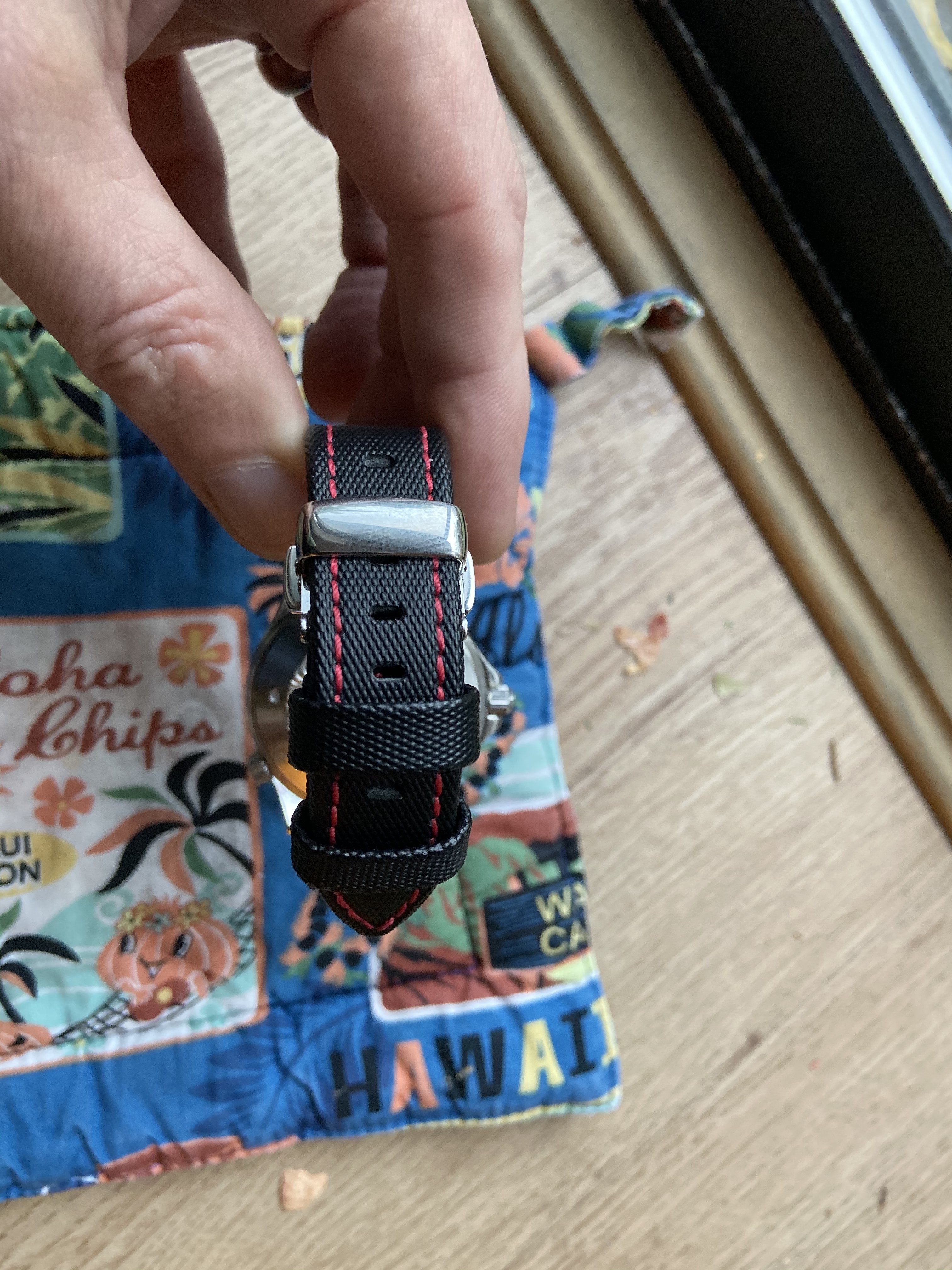

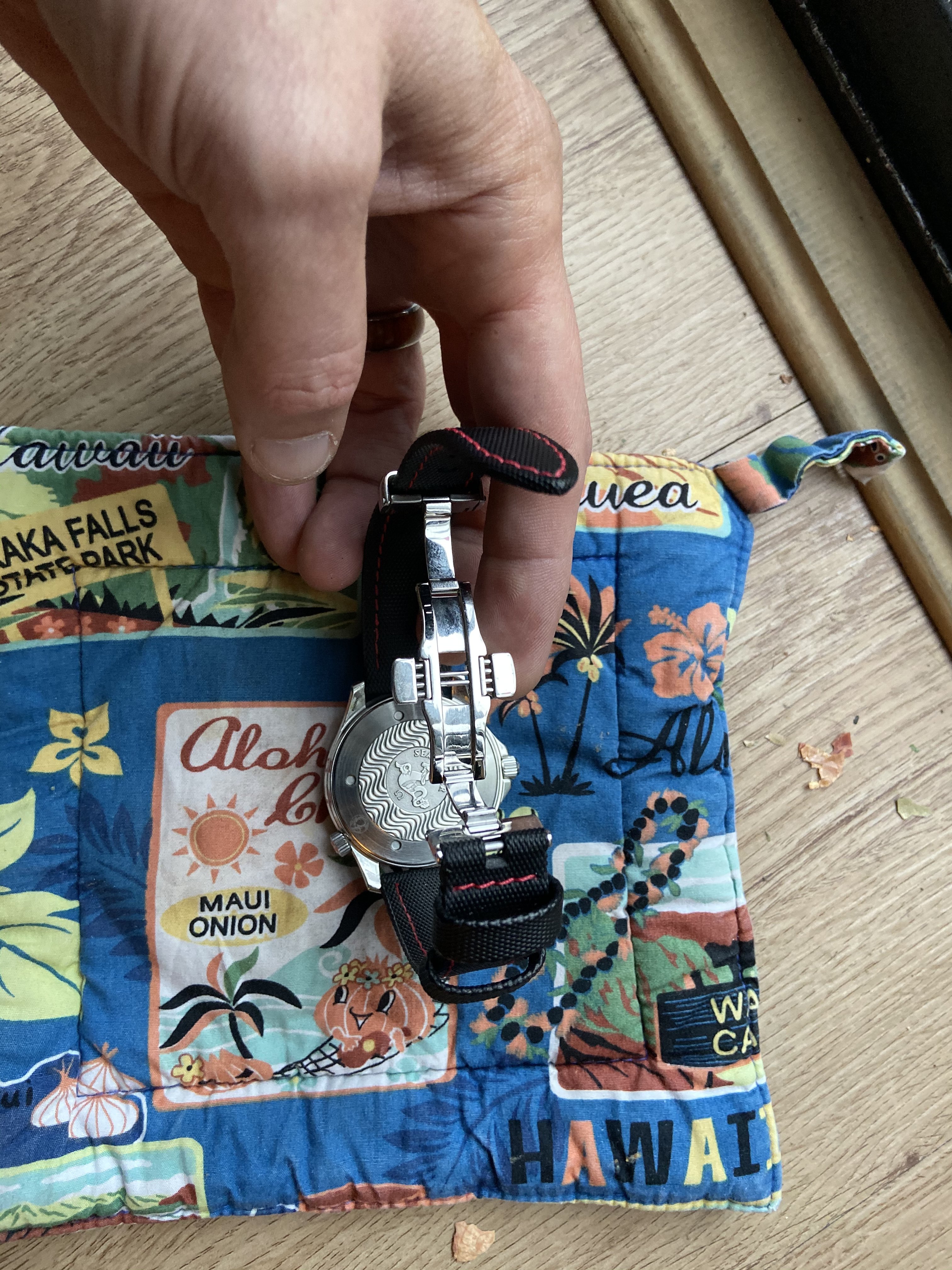

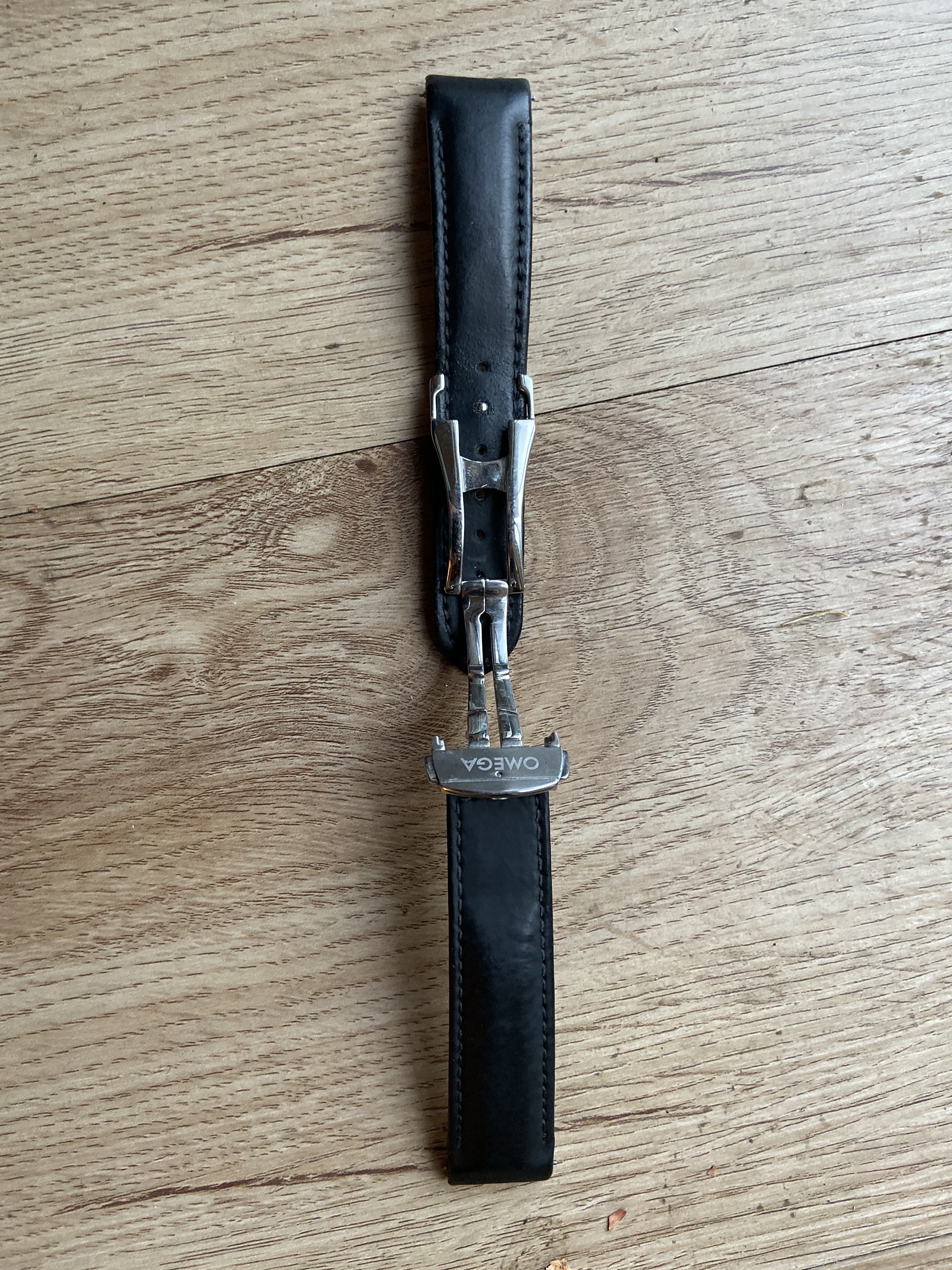

The Hirsch clasp is also butterfly style. With a strap that has loops, like the OPs Hirsch Robby, it’s the style that looks right in the end. Using the Omega style bifold you will end up with an empty strap loop with nothing to tuck into it. Not the best pics but may help clarify a bit, and no loops on an Omega strap with deployant.
Some Omega clasps are specifically designed to fit thicker 2.7mm strap ends. The one for the Snoopy sailcloth strap is such. I have one, model 94521883. I think in reality there is some leeway on all of them, but I agree I wouldn’t personally use a std strap on one, the length would be all wrong too.
