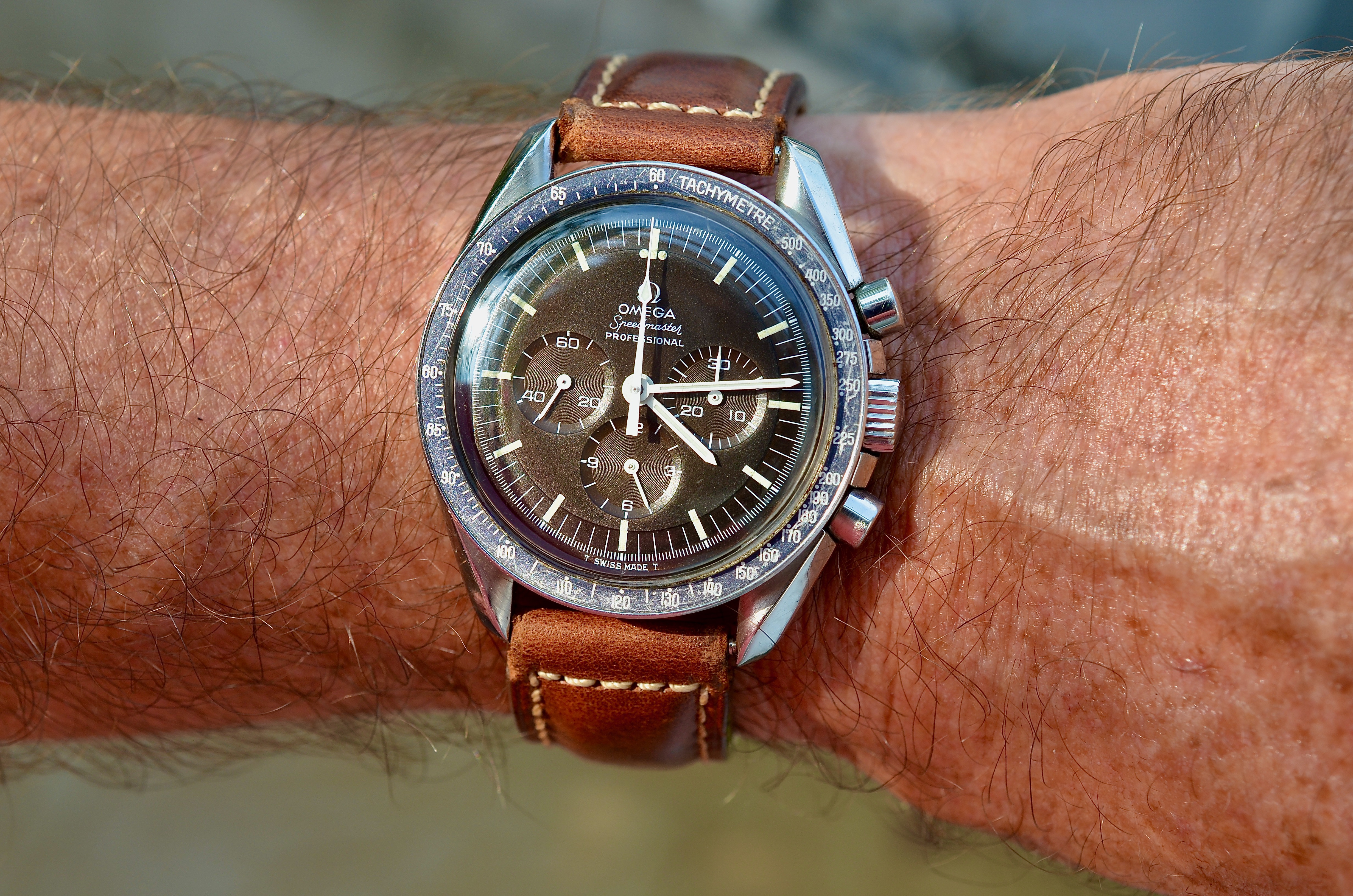

This is mine, straight writing and also a creeper (well was).
I have owned this watch for years and when it first started creeping I could reset the chrono and it would return and start creeping again. It finally got to the point like yours where the hand would not move at all.
It is now away being serviced and I should have back any day now. From here on should be the creeper in name only😀

Thats lovely. I like the insert.
I discovered that the hour register hand actually moved somewhat freely. if you tapped the side it would move a bit.
I have sent it off to Mr. Freese now for some spa time.
