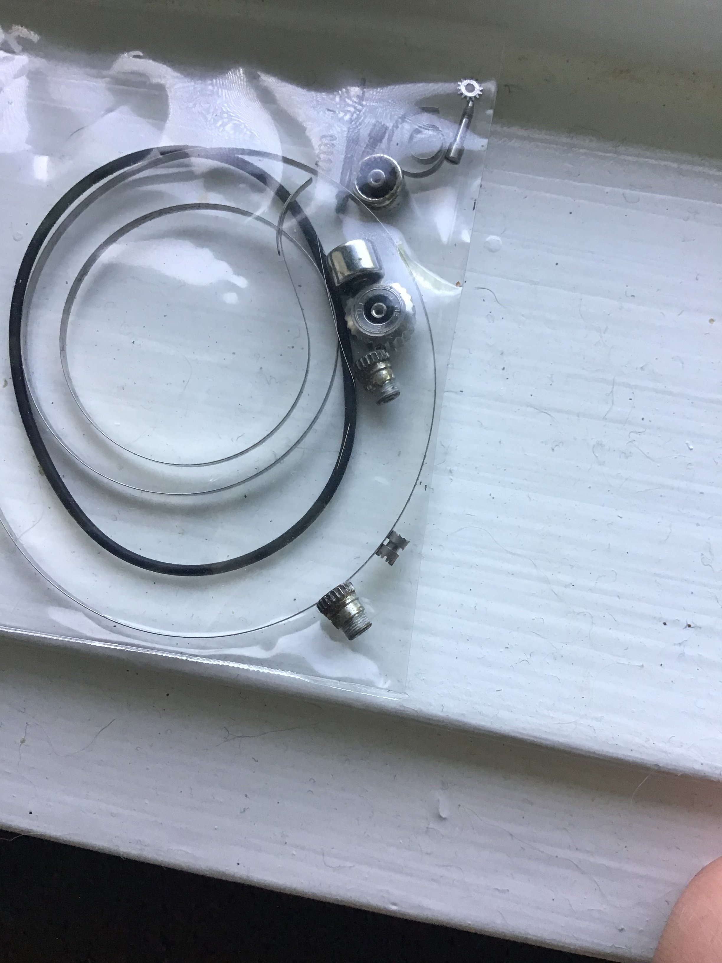

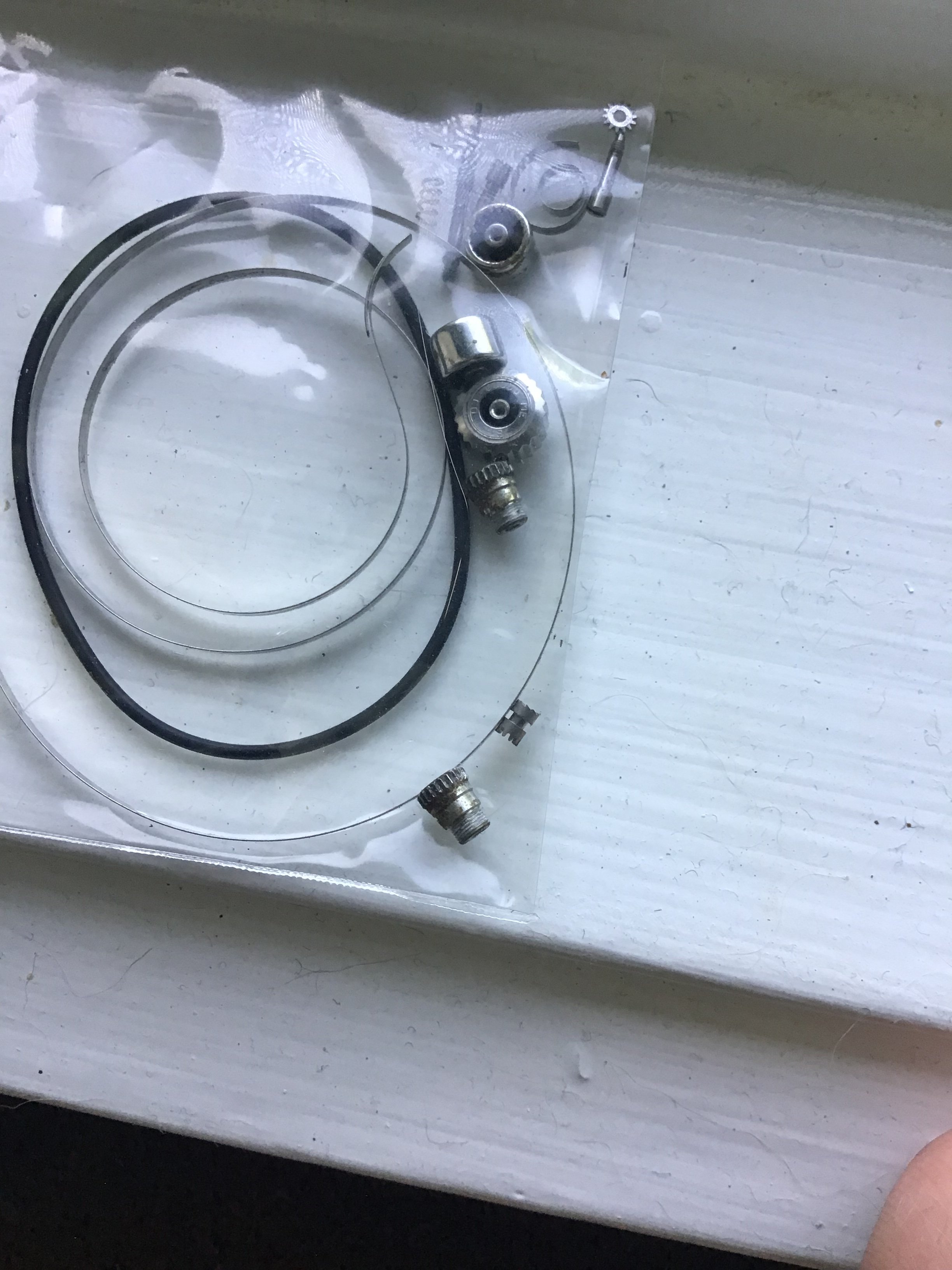

My Speedmaster is not working anymore and seems to be able to wind indefinitely.
Does this sound like a mainspring problem and require full service? Any people in the Chicago area you would recommend or do I have to go to the OB?
30,292
78,209
Yes, most likely a broken mainspring, which will require a full service.
Cheers, Al

Same thing happened to me. The crown would just keep winding, but with a noticeable lower resistance than normal and every 5-7 turns there would be a very faint clicking sound. Mainspring broke. See it from the positive side - you will get your watch back looking brand new after a full service.

Mine was mainspring plus crown and actually it was not lower resistance but very tight to wind.

Will keep you all posted on the turn-around time for repair. Heard back from the OB a few weeks ago and was told it was definitely a mainspring issue.
