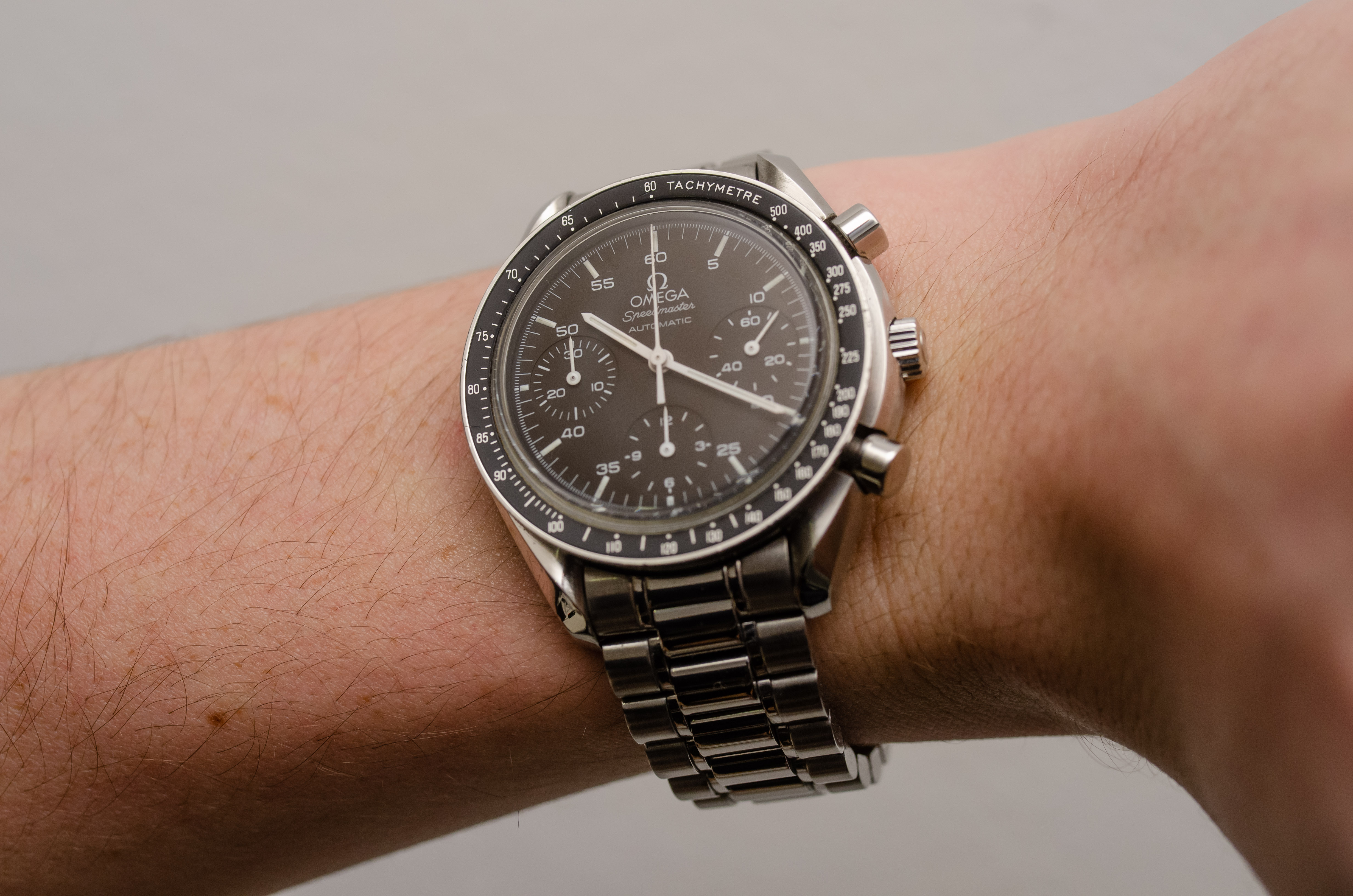

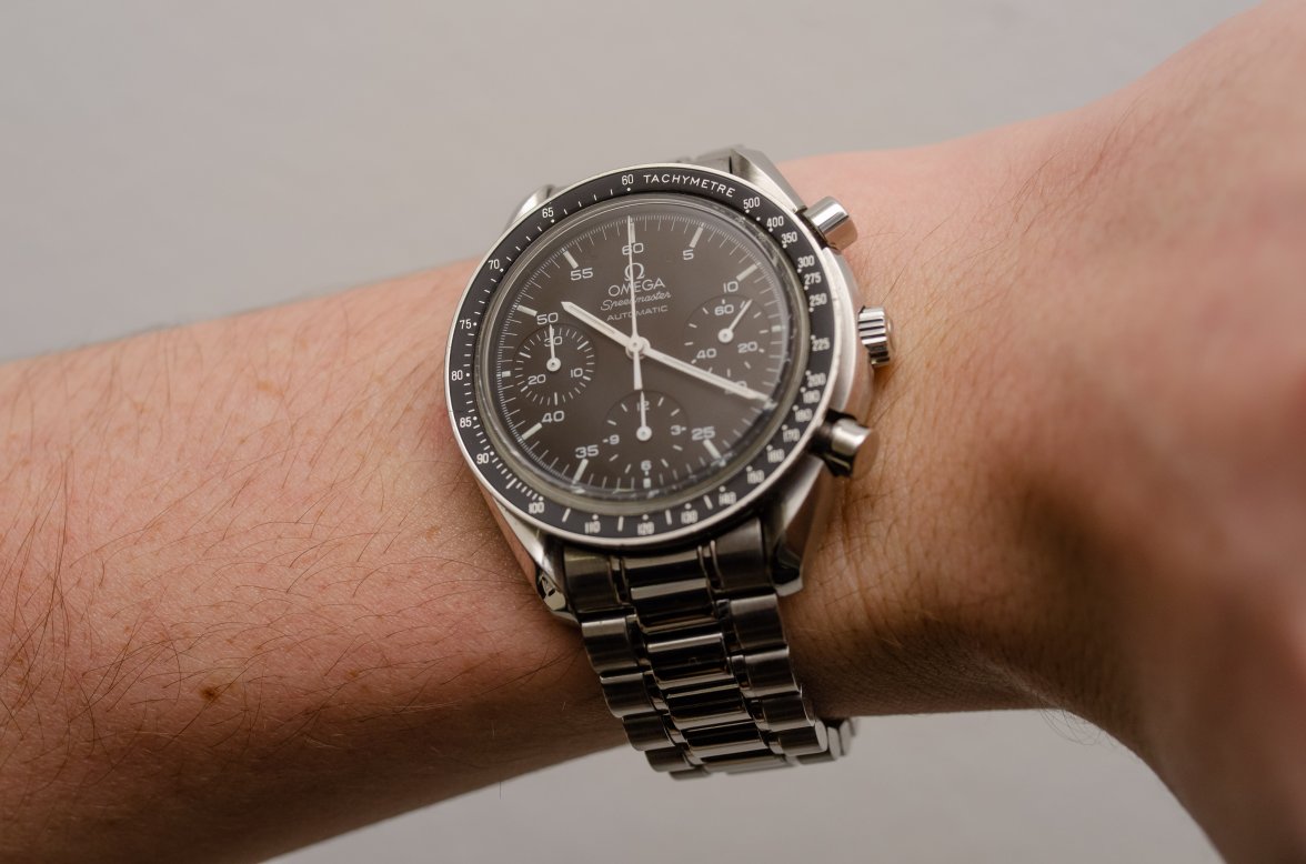

Here's a pic of me wearing the watch, as you can see my wrist isn't very large, that's why I got the reduced.
