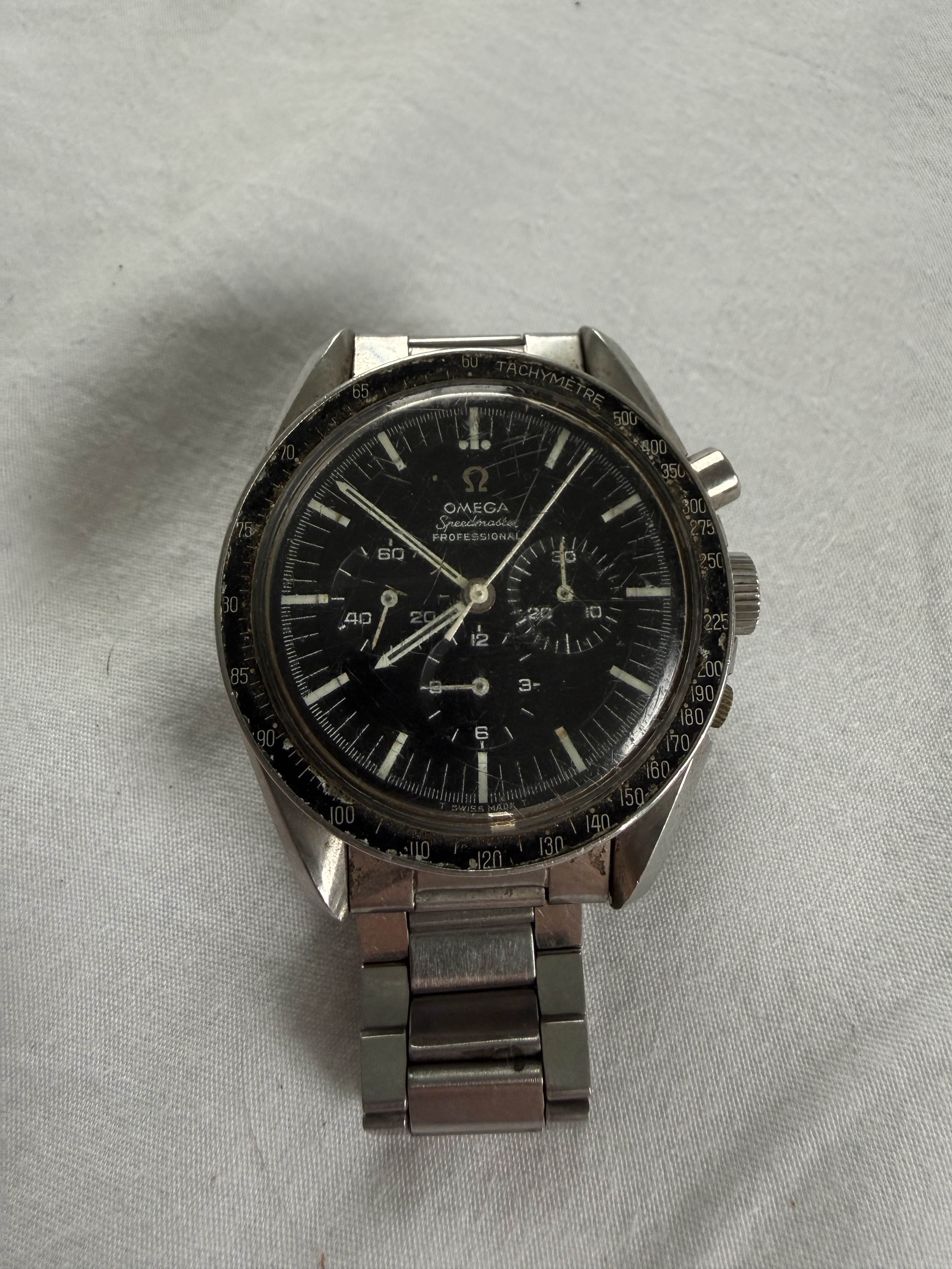

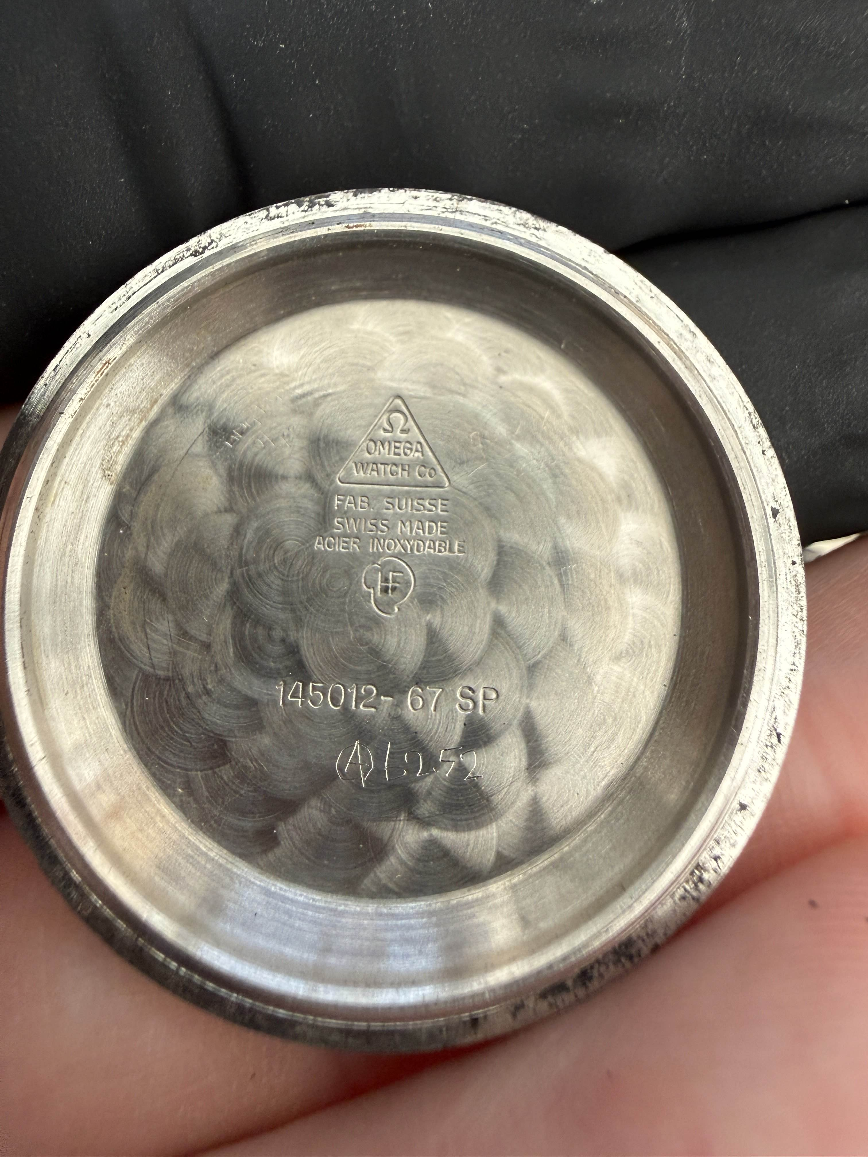

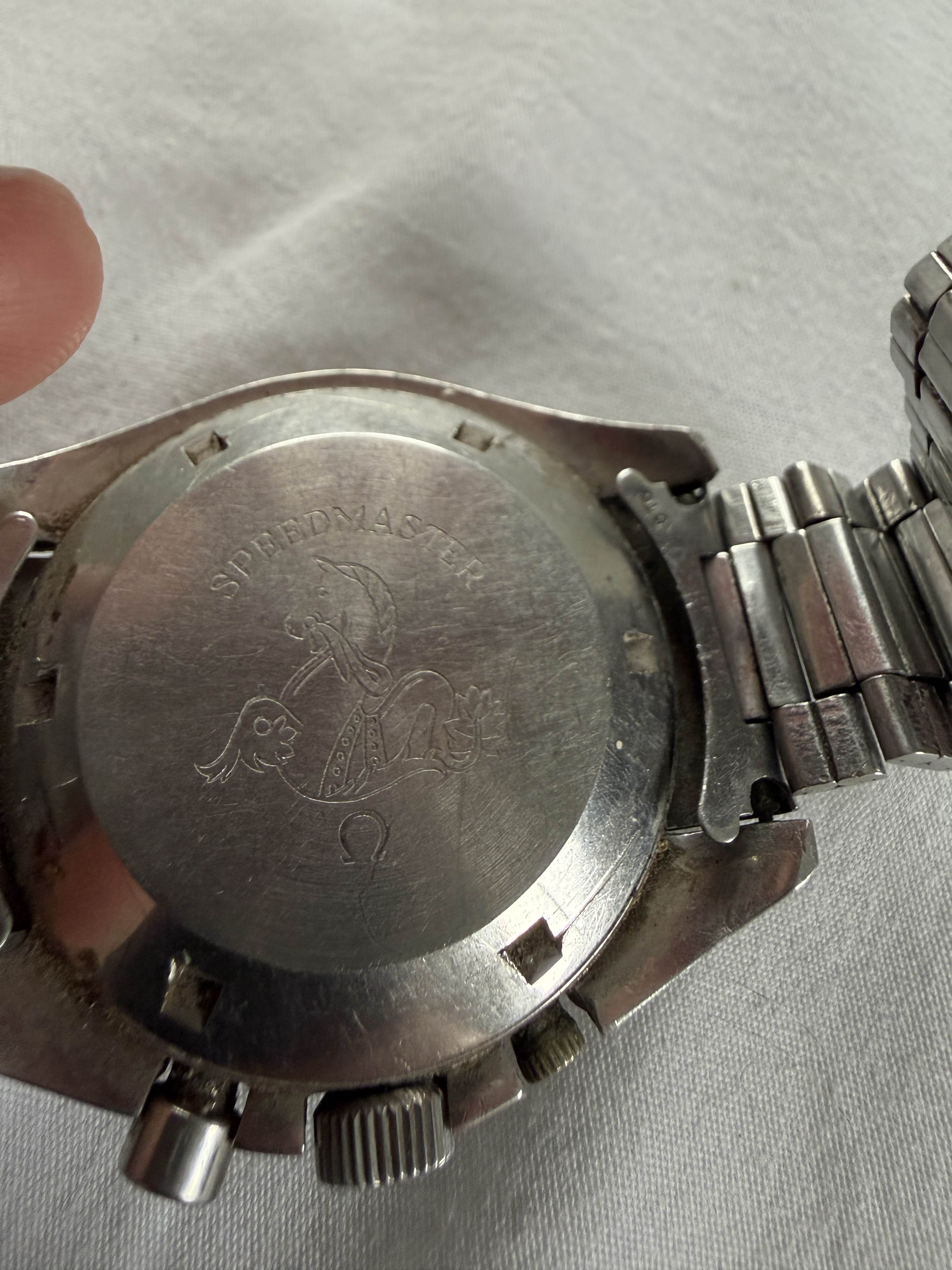

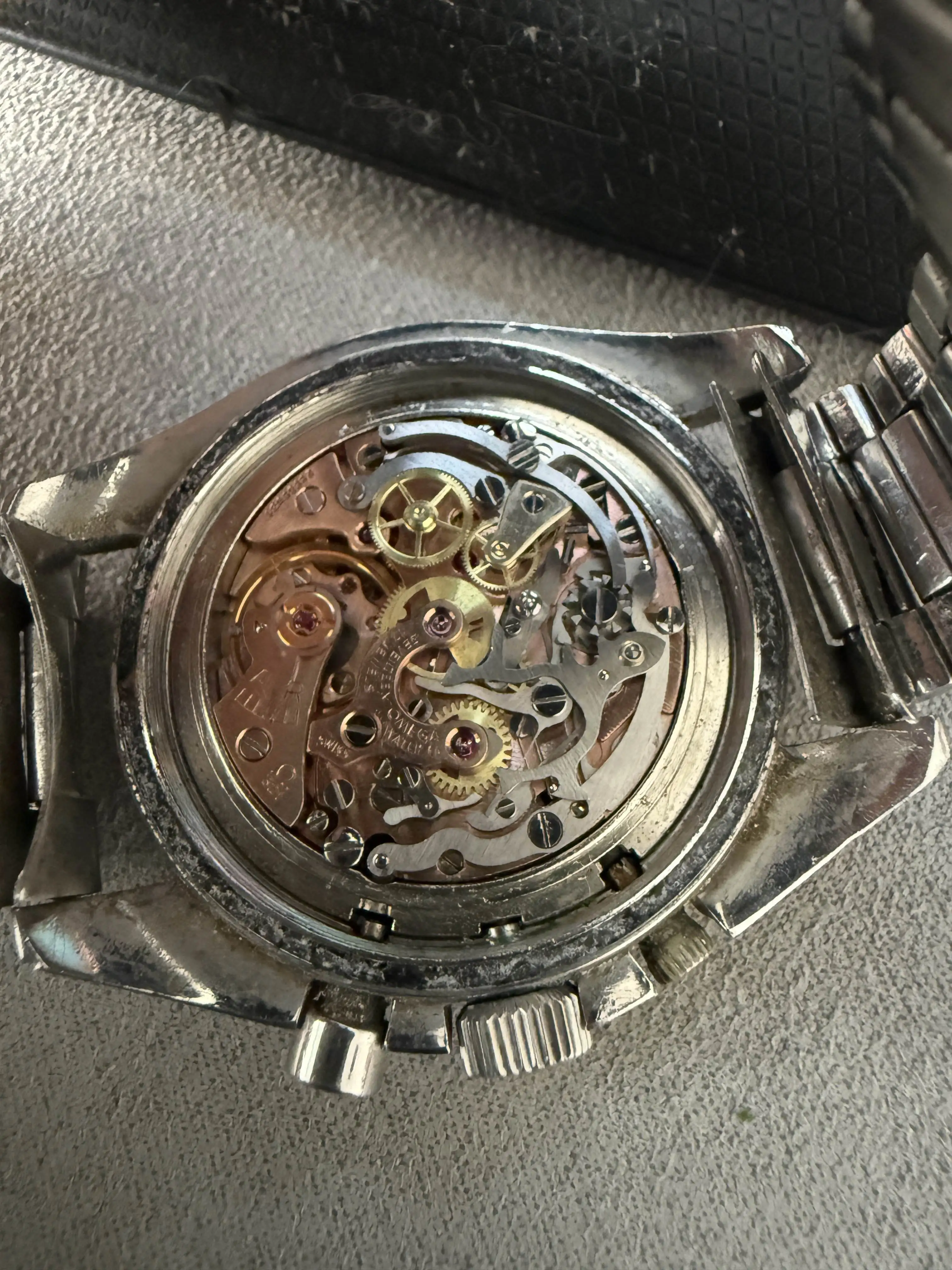

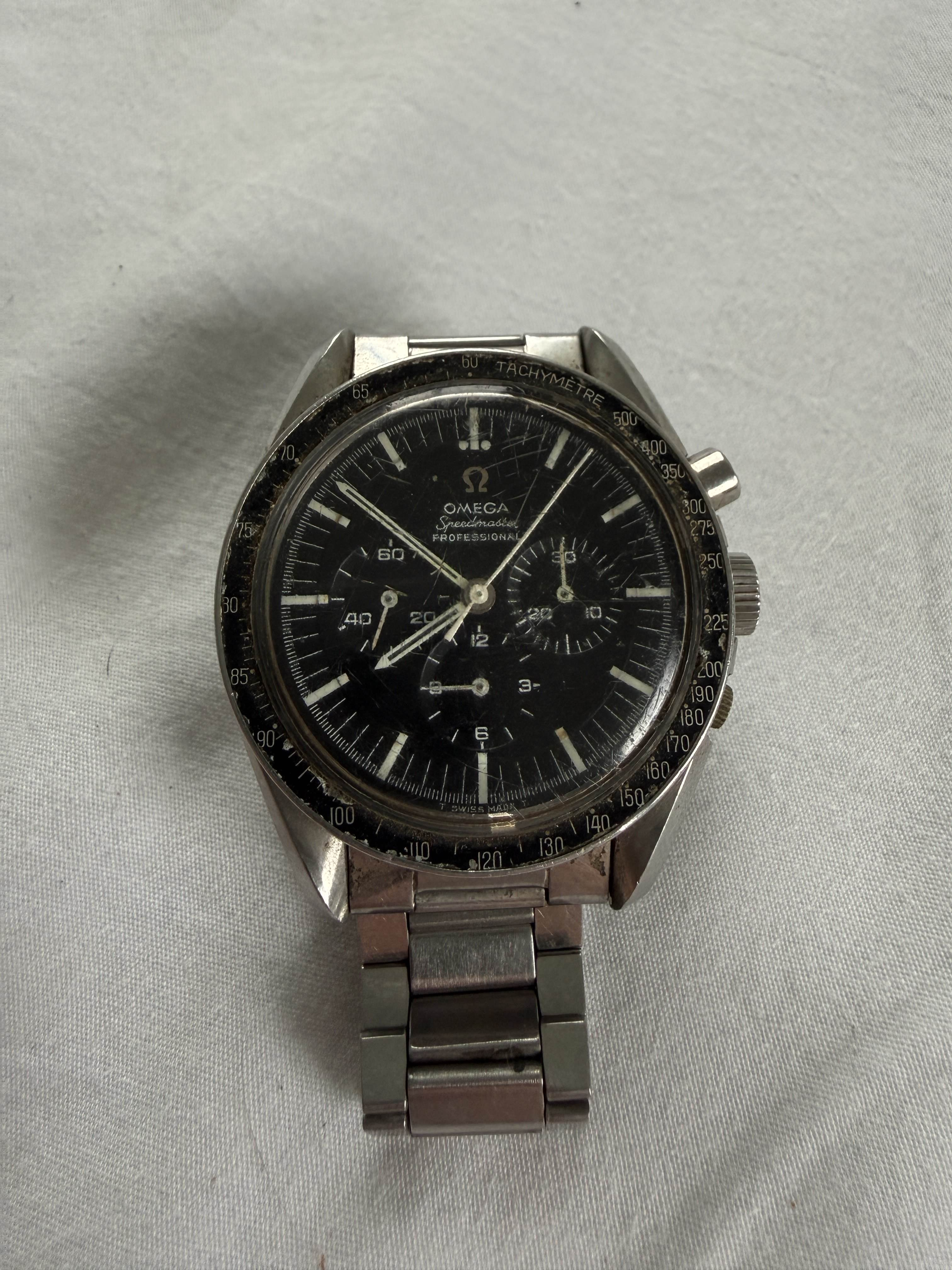

Dear readers, unfortunately my dad has passed away and among his possessions I’ve found this watch. I plan to restore it but I’m not sure if it’s legit, the watchface looks different to what I can find online. Rest seems go checkout. Can someone help me out and tell me if it’s worth restoring at all.

Condolences on your Dad mate.
You have a very nice vintage Speedmaster, although in rough condition.
It's a desirable model and will be envied by many of us when it's restored.

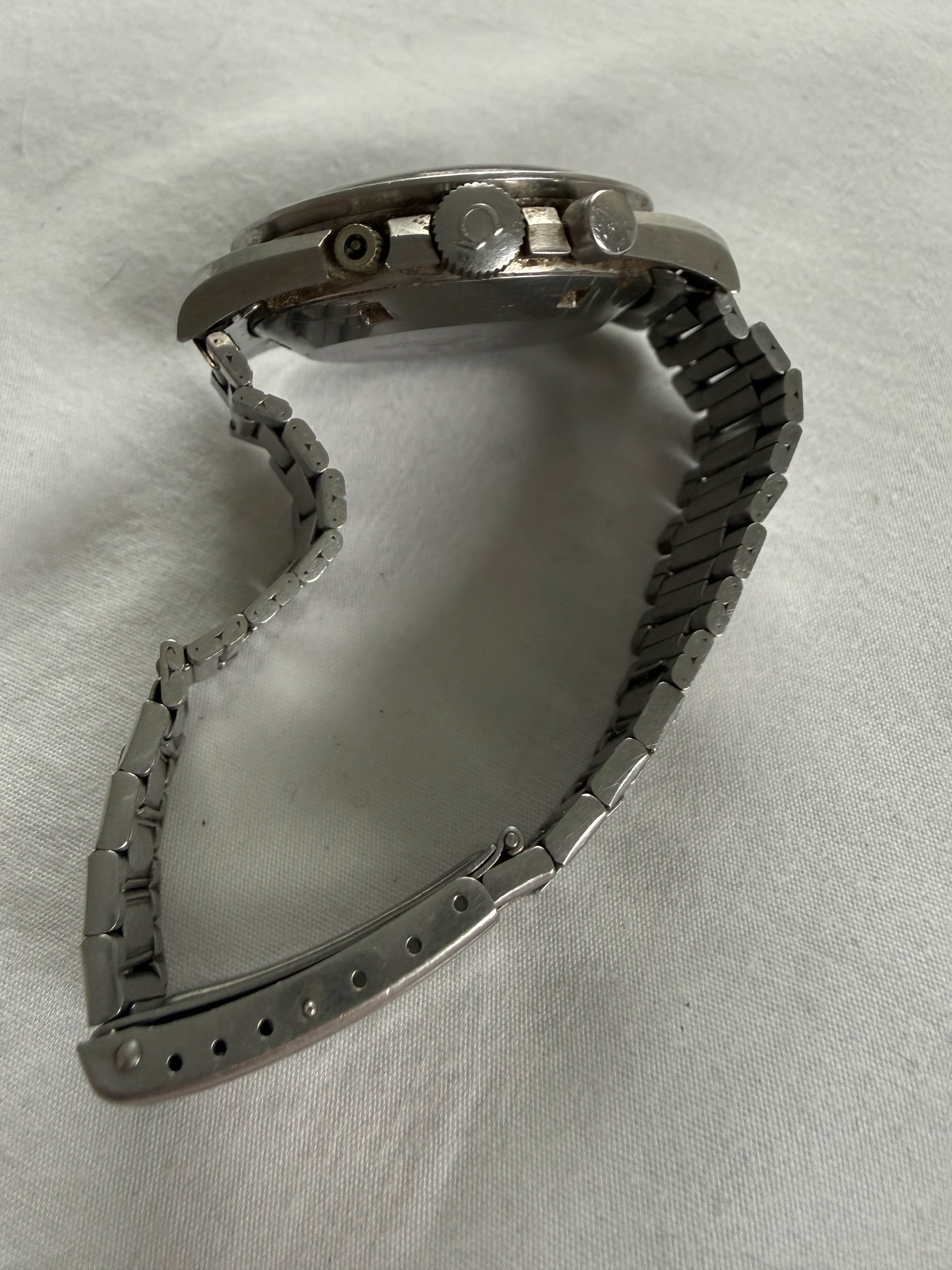

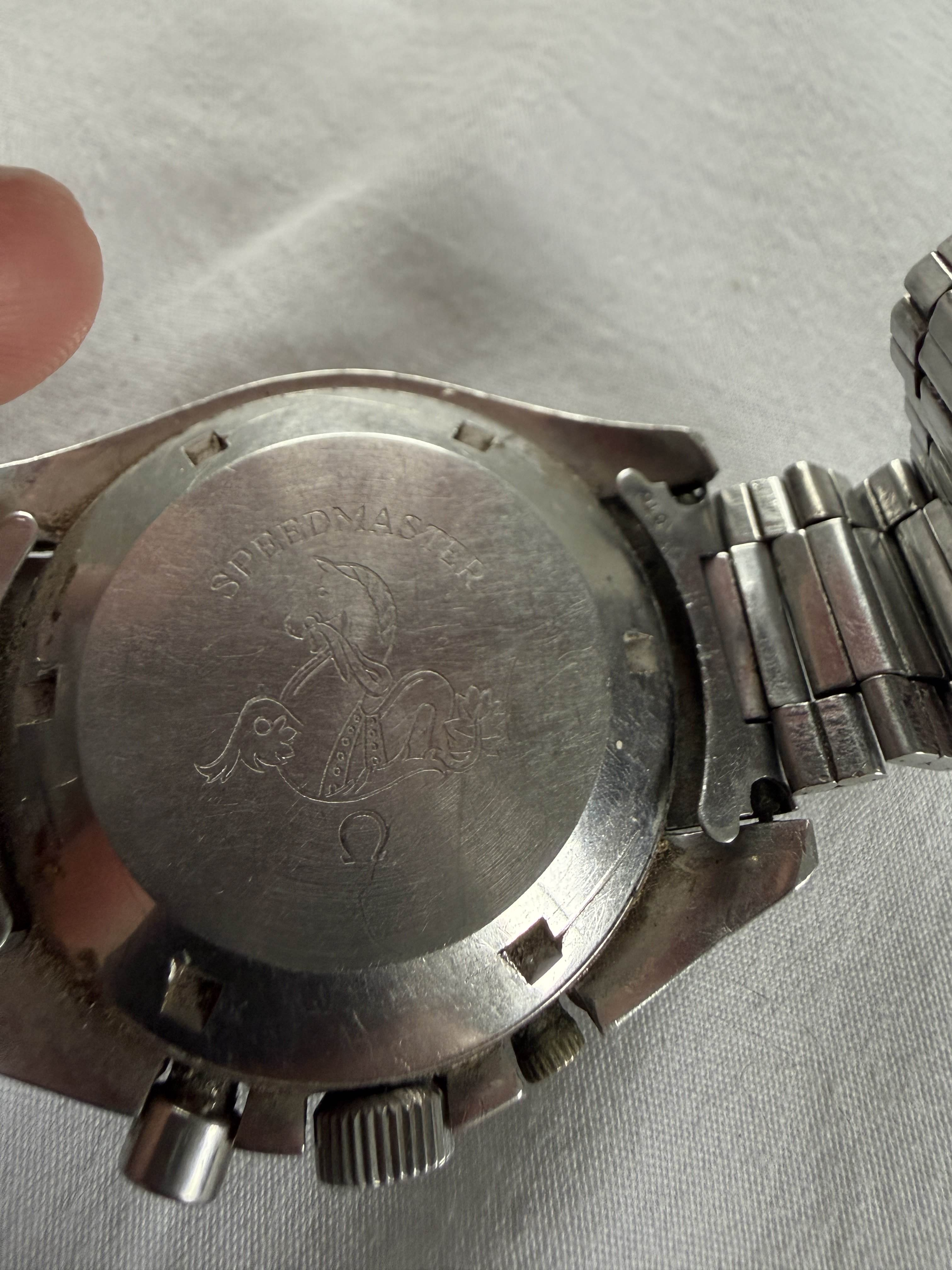

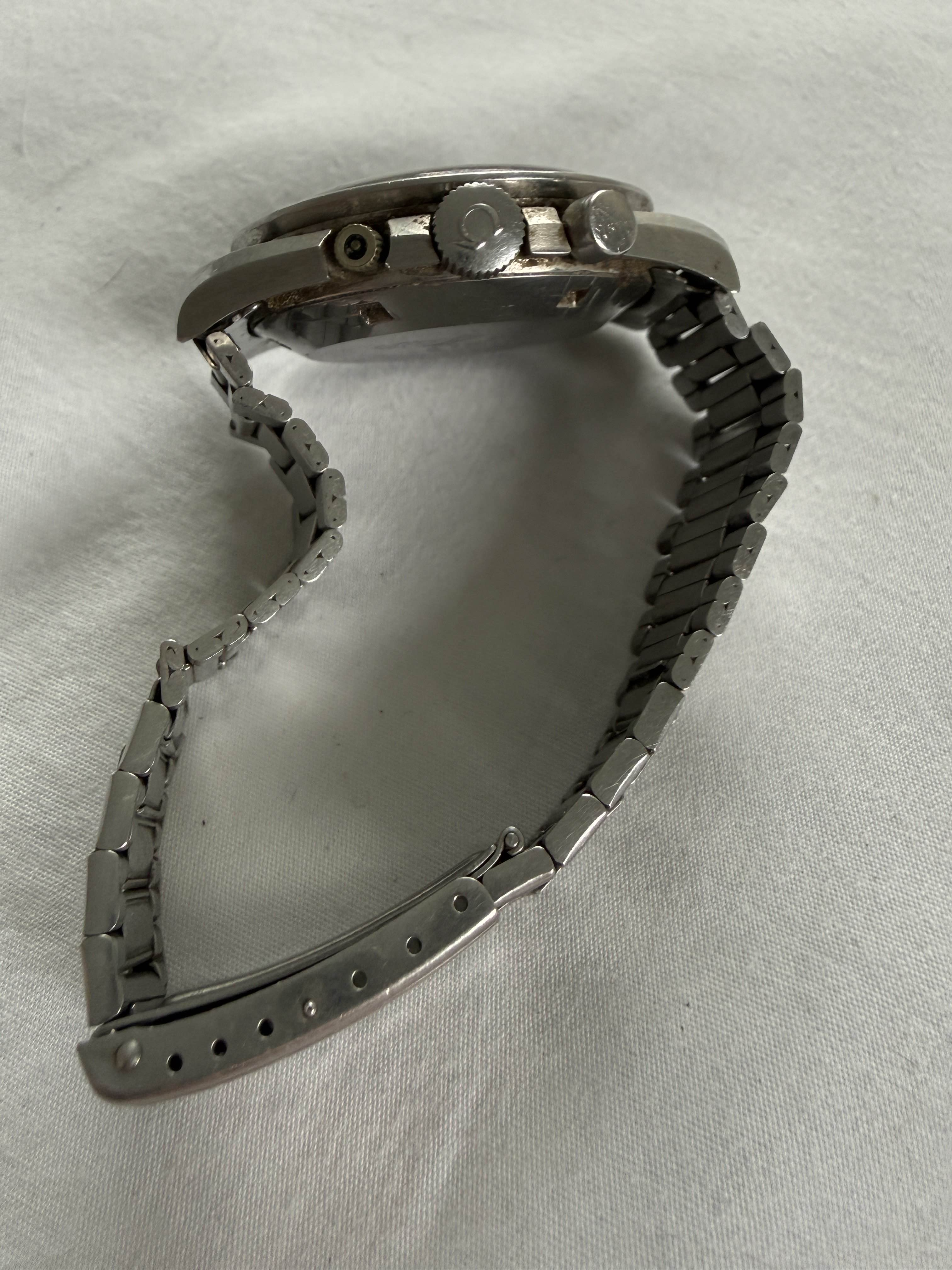

That is a perfectly genuine and nice vintage Speedmaster. The condition isn’t great and the chrono hand is wrong but everything else, even the bracelet is correct.
Bear in mind even in that condition the bracelet is worth c.£1000 and the watch a minimum of £2700 (very conservative, more likely £3000+).
I would strongly urge against restoring this yourself unless you have experience. One slip damaging the dial or movement will have significant impact on condition, value etc.

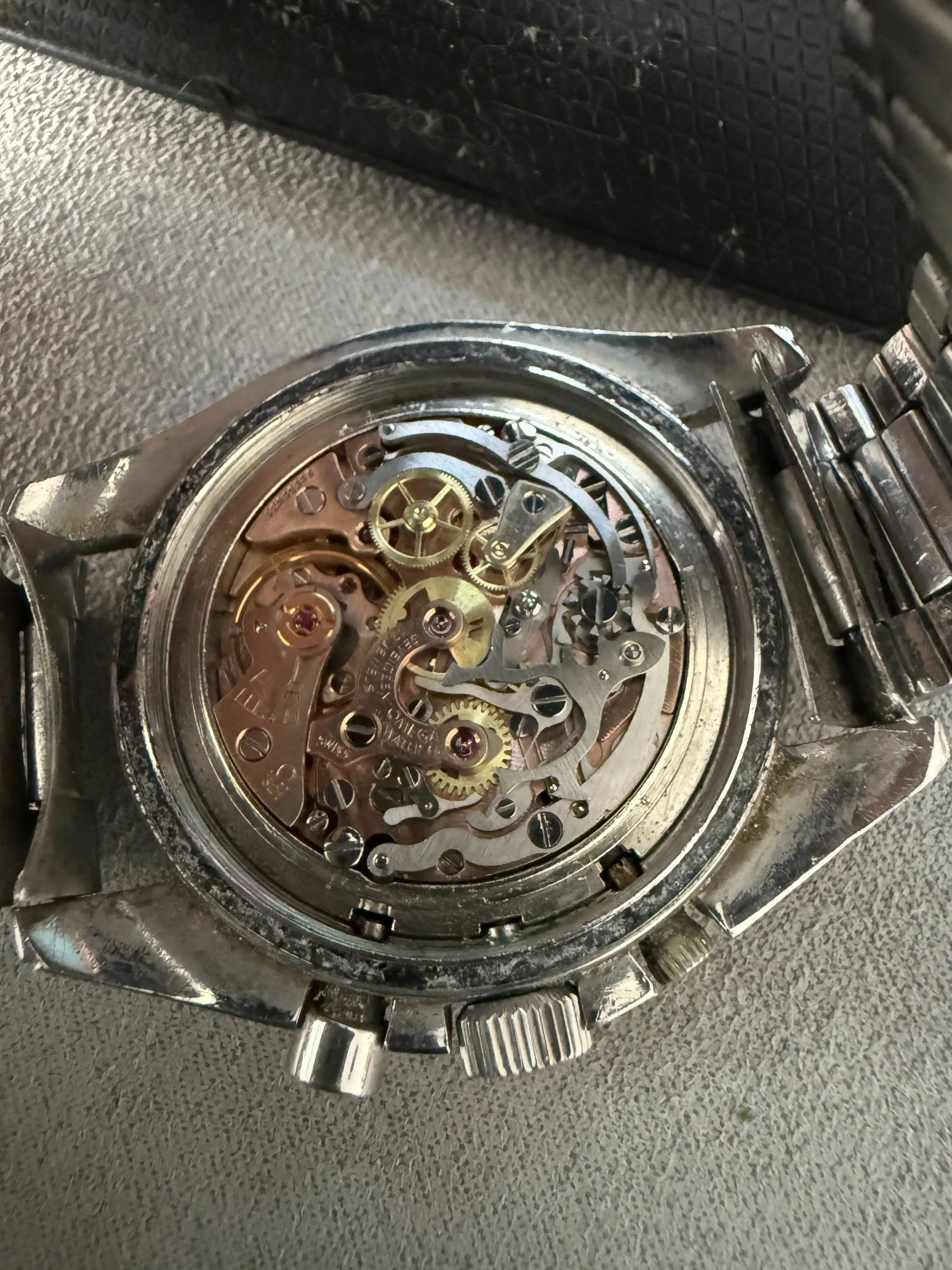

Thank you, I checked that link however the only one I see with a similar seconds hand is the ultraman but that one is orange. This is why I had doubts about it being legit, however the inside seems spot on to what I've found online.

Thanks, thought so as well. Pitty they replaced that chrono-hand. This one will never be sold. Just want to restore it so it can be worn by myself.

There are a few things that you might need...
A new pusher, and if the crown and chronohand bothers you - change them to a correct ones?
These could be found here on the Forum /watch parts for sale.
There are a few Speedygurus here on the Forum that are from the Netherlands, they might help you out with a watchmaker that knows how
to work with vintage Speedys?

For £3000 I would buy this watch in a heartbeat. It looks like the lume was removed but otherwise the shape is not too bad. Bracelet looks like it is in excellent condition and that alone is worth a lot. Movement is super clean. All you need is a correct Chrono hand and a pusher. You should have it serviced by a local watch guy who knows what he is doing if one is available. The 321 movement is not a movement to get your feet wet in the watch service world.

My estimate was separate. Ie, bracelet £1000 and head £2700-3000, so £3700-4000 total.

You have a number of options to consider. For example, you can have vintage-style luminous paint applied to the markers on the dial to replace the lume that has been removed, and matching lume used to fill the hands. It's your decision about what would give you the most enjoyment from the watch.

If you’ve never worked on a mechanical watch and a chronograph, prepare for a very expensive lesson.
