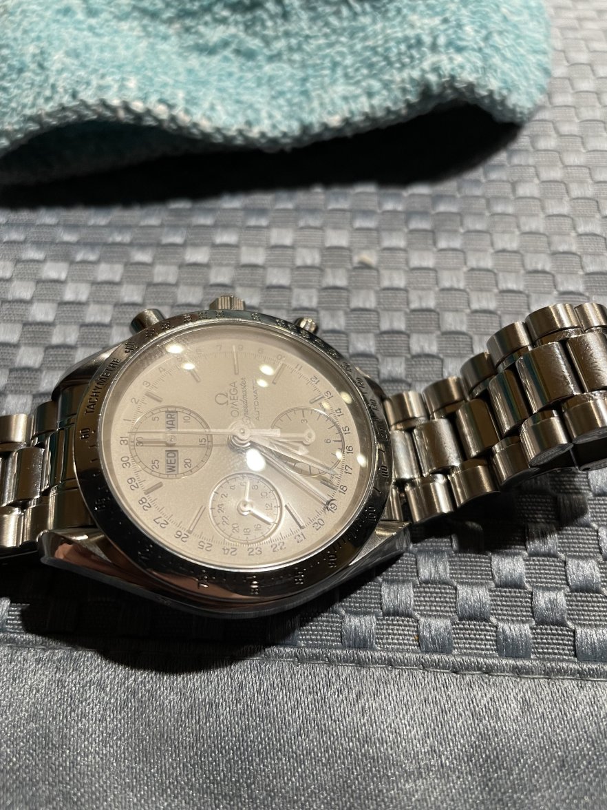

My newly purchased omega Speedmaster just randomly clouded up yesterday, no rainnor anything. How do I fix it???
Your newly purchased watch is at least 20 years old and has very likely never been serviced in its life. As others have said, needs all the seals replaced and should probably have a full service as well. One of the costs to be aware of when buying old watches with unknown service history. Just because a seller says it is "running fine" or "has been cleaned and adjusted" doesn't mean it was actually serviced.

yeah ik, its from 1994 and i doubt its been serviced ever.

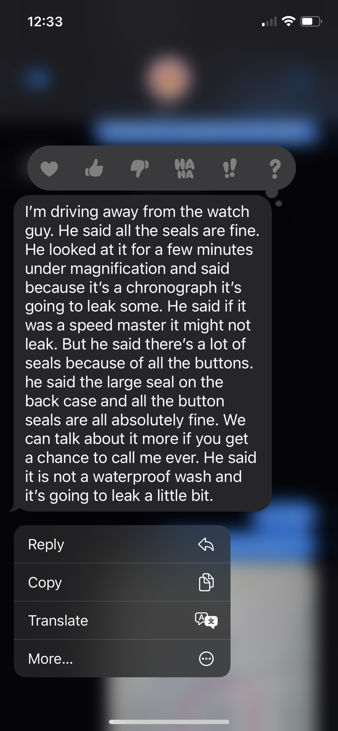

Colorado Springs, I took it to someOne in the area and they said some confusing things, it’s definitely a speed master but idk what to do from here.

If the "watch guy" actually told you that, find a proper watchmaker.

The very fact that you wearing this watch caused condensation, this is BS, with the exception of the fact that even after service this will not be a swim watch. Find a competent watchmaker. A proper service will ensure that you can at least wear this on a hot day. Unfortunately for your age and resources, you have jumped into the deeper end of the pool.
