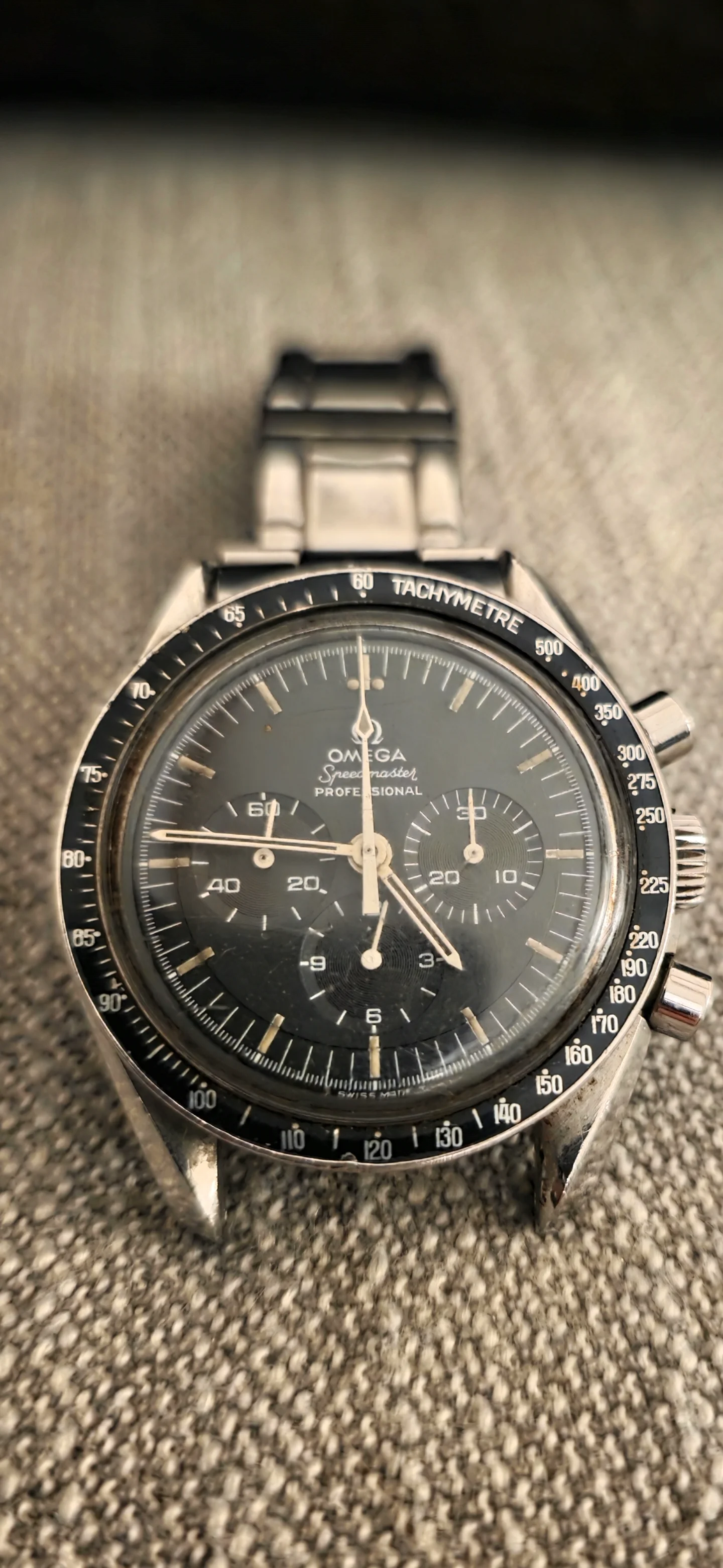

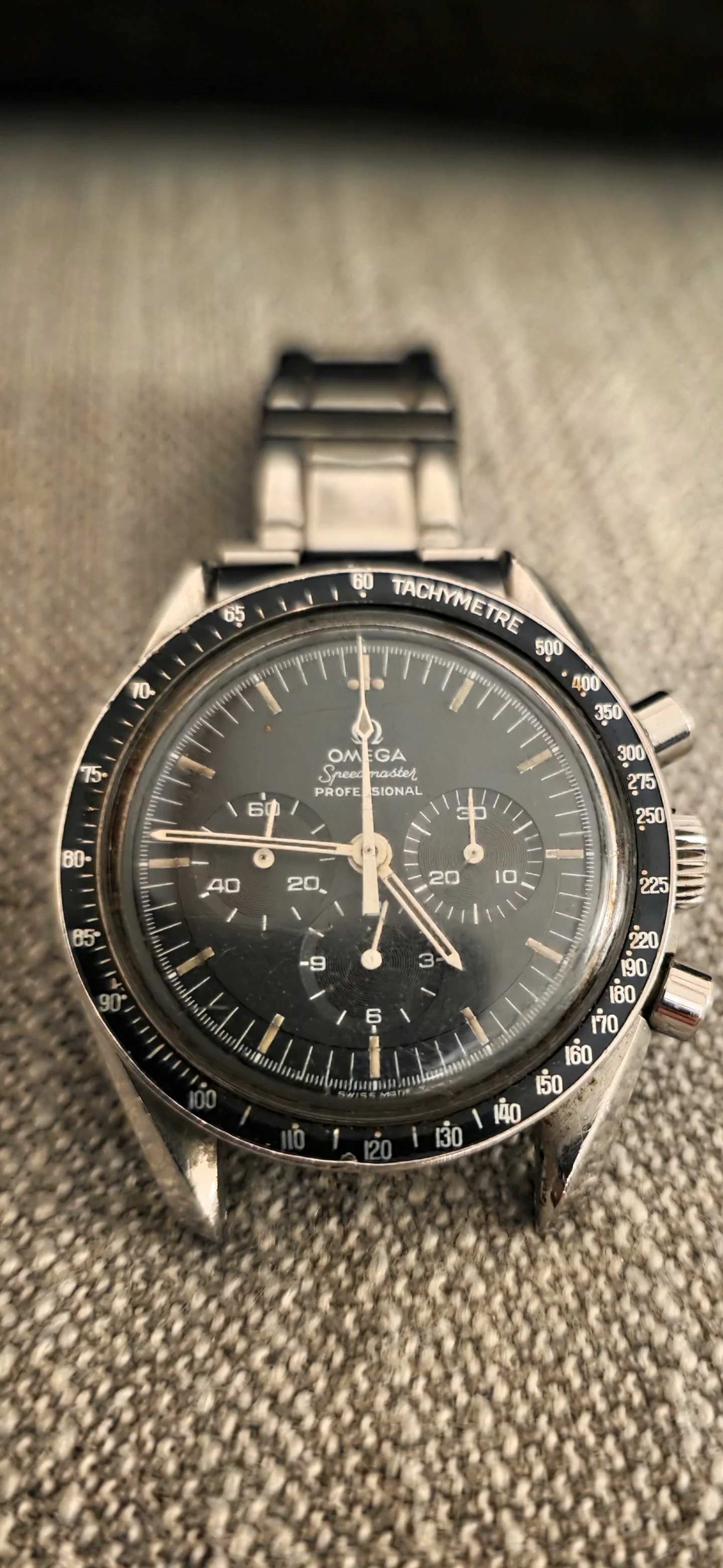

My grandfather had the watch mounted on a custom silver cuff. I began researching the watch to find an original, period-appropriate bracelet for the watch. In doing so I discovered the watch was the "220" bezel variant. Photo attached.

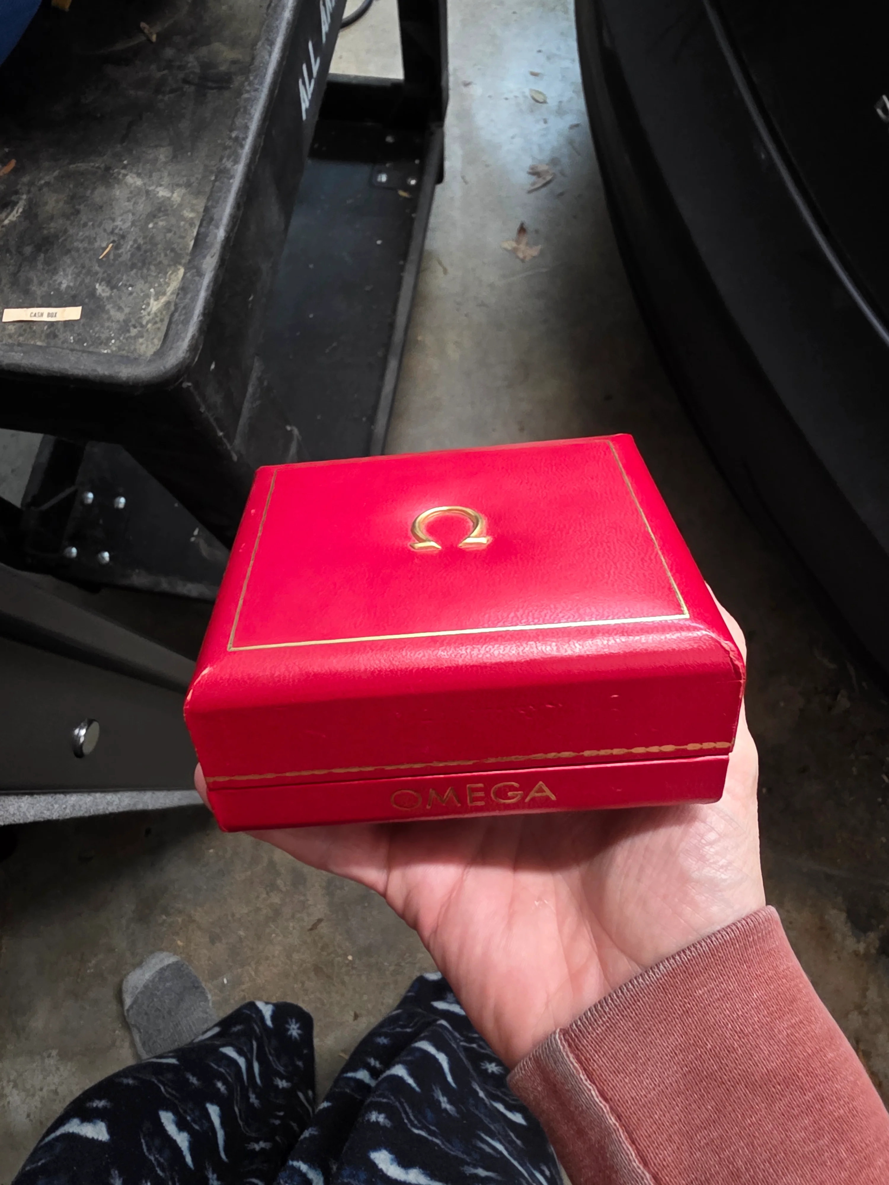

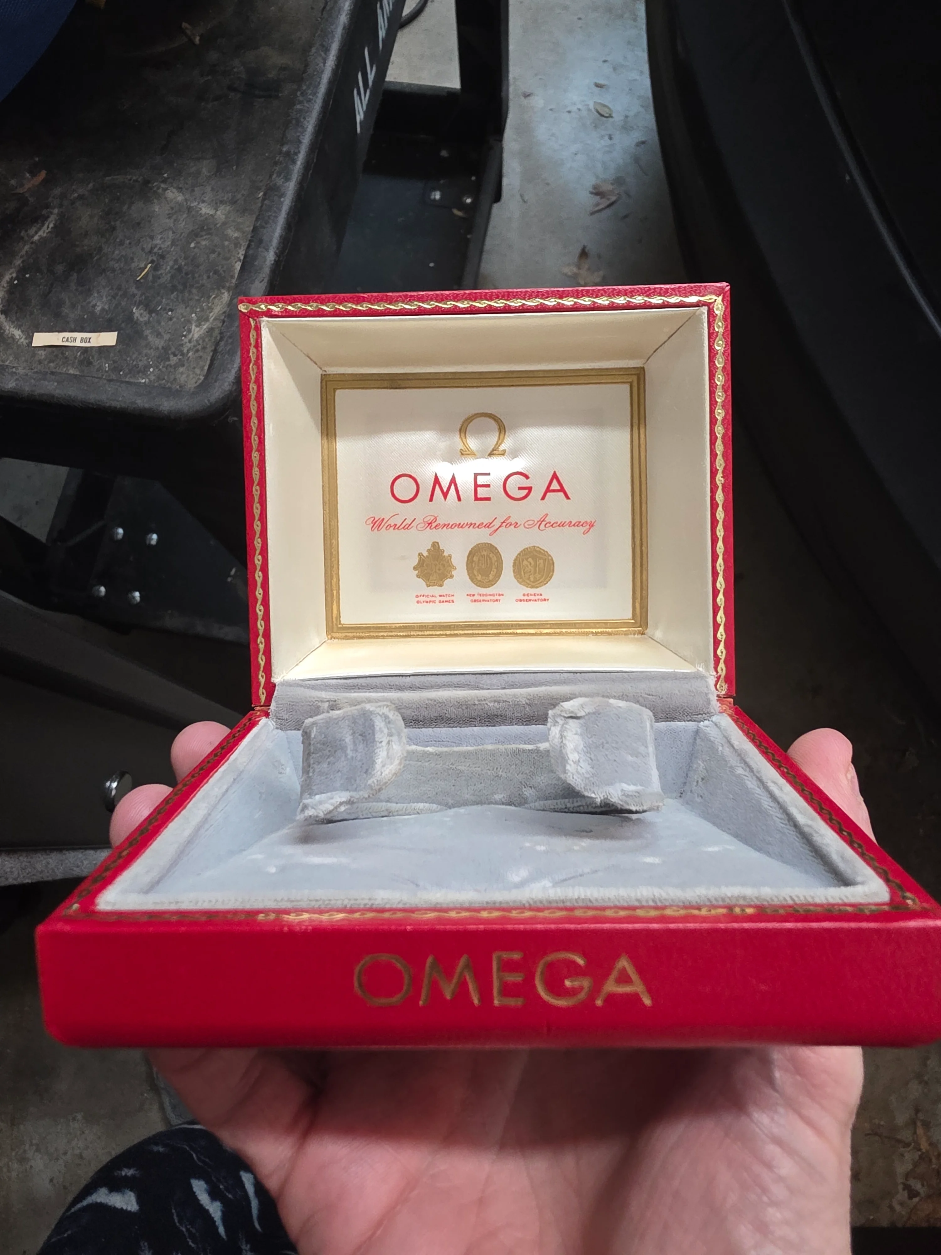

- Do you think the box pictured is the original box? This was the box it was passed down to me in.

- Have the watch opened to verify the serial number and request Omega produce the verification certificate
Omega no longer offer this service. Serial number etc can be confirmed when the watch is serviced.
- Find a period appropriate bracelet. I'm not sure how practical it will be to find & any help would be appreciated.
A suitable alternative may be an aftermarket, Uncle Seiko etc, others can advise
- Given it works perfectly should I have it serviced in any way?
Without doubt. would you drive a car that hadn't been serviced for twenty years or longer?

It's possible, back in that era boxes were just picked from the jewellers stock.

Agree with the above, although obviously if you are curious about the serial number, there's no reason not to have the watch opened and take photos of the inside. If you post photos, we can provide more information.

It’s a nice watch in fair condition and a great heirloom.
As Jim says, Omega used to offer an extract of the archives. This confirmed date of production and country of delivery. It’s not currently available but wasn’t a verification certificate anyway.
I would have it serviced if you wear it, even infrequently. Don’t rush into this. Spend some time researching reputable watchmakers on your country. The serial can be confirmed when you do this.

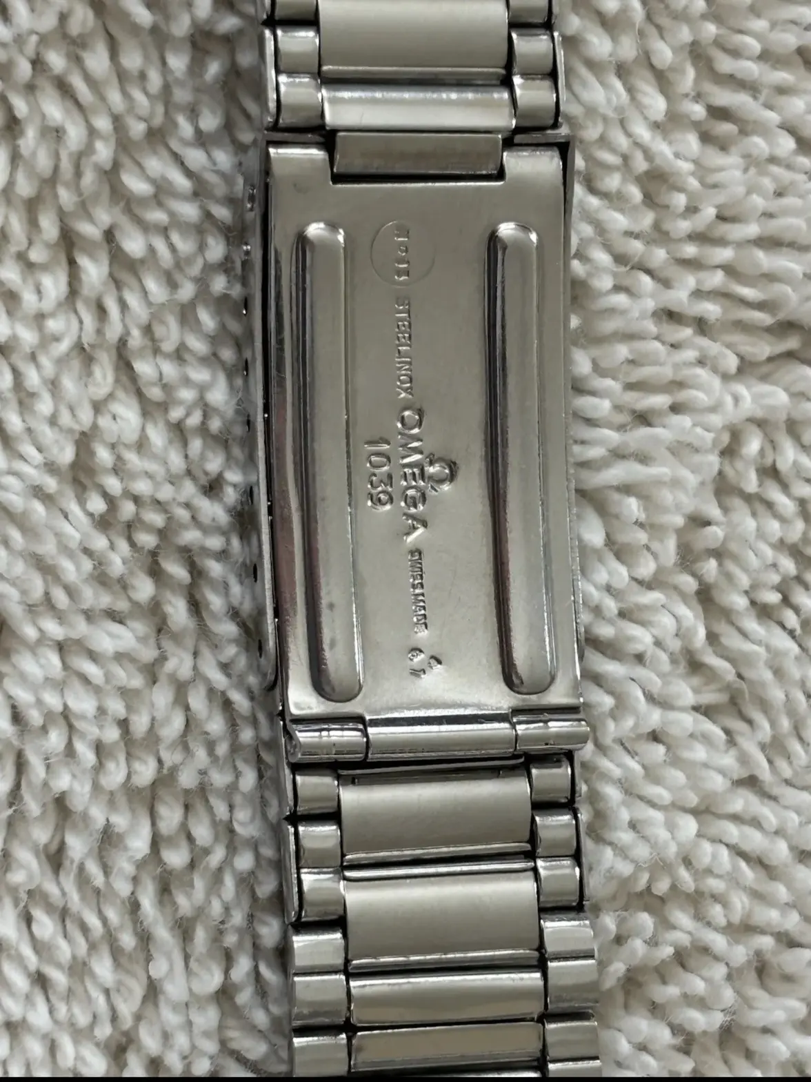

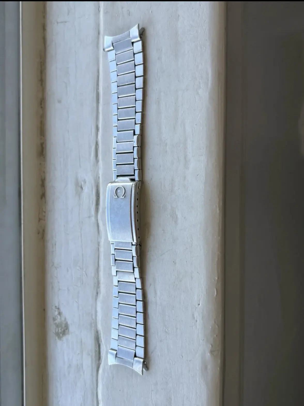

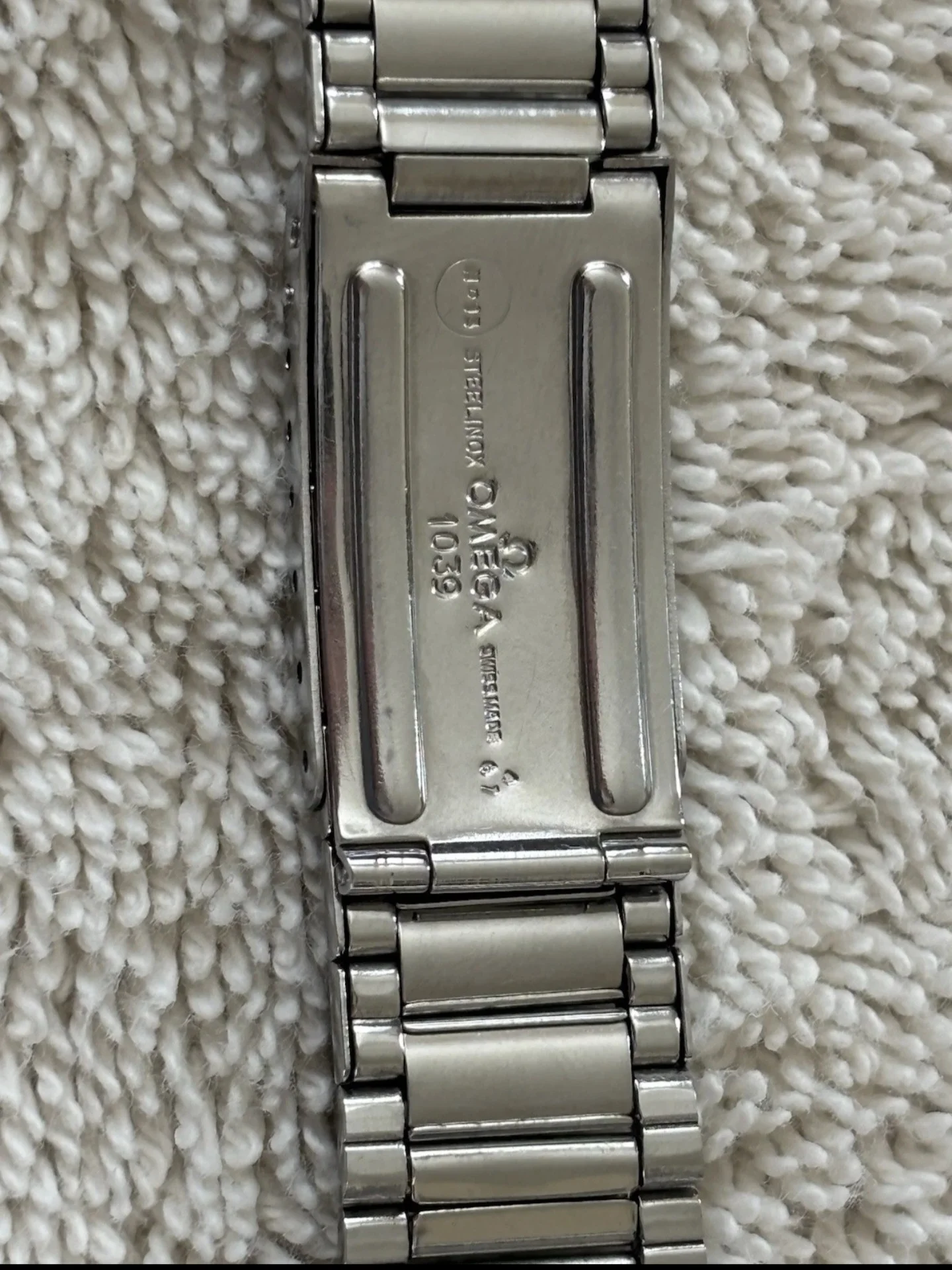

A 1039/516 bracelet is correct but good one aren’t growing on trees and they aren’t cheap. An alternate is an 1175/640 which is probably a year or so after your watch but almost contemporary and slightly cheaper. An 1171/633 is 2-3 years after your watch but much more readily available and around 1/3 the price of a 1039.
4
4

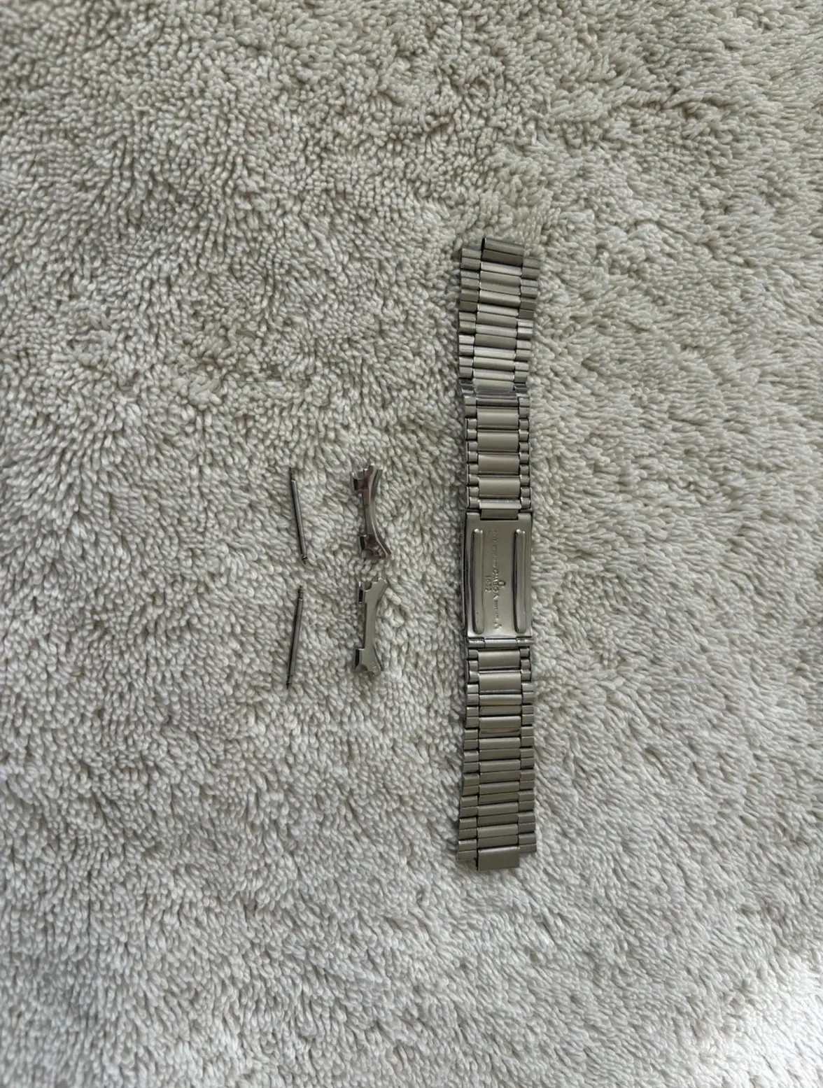

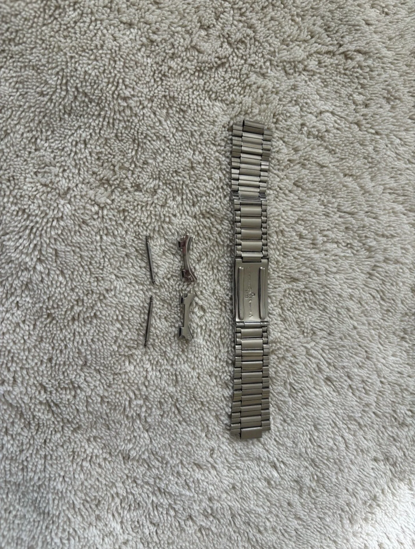

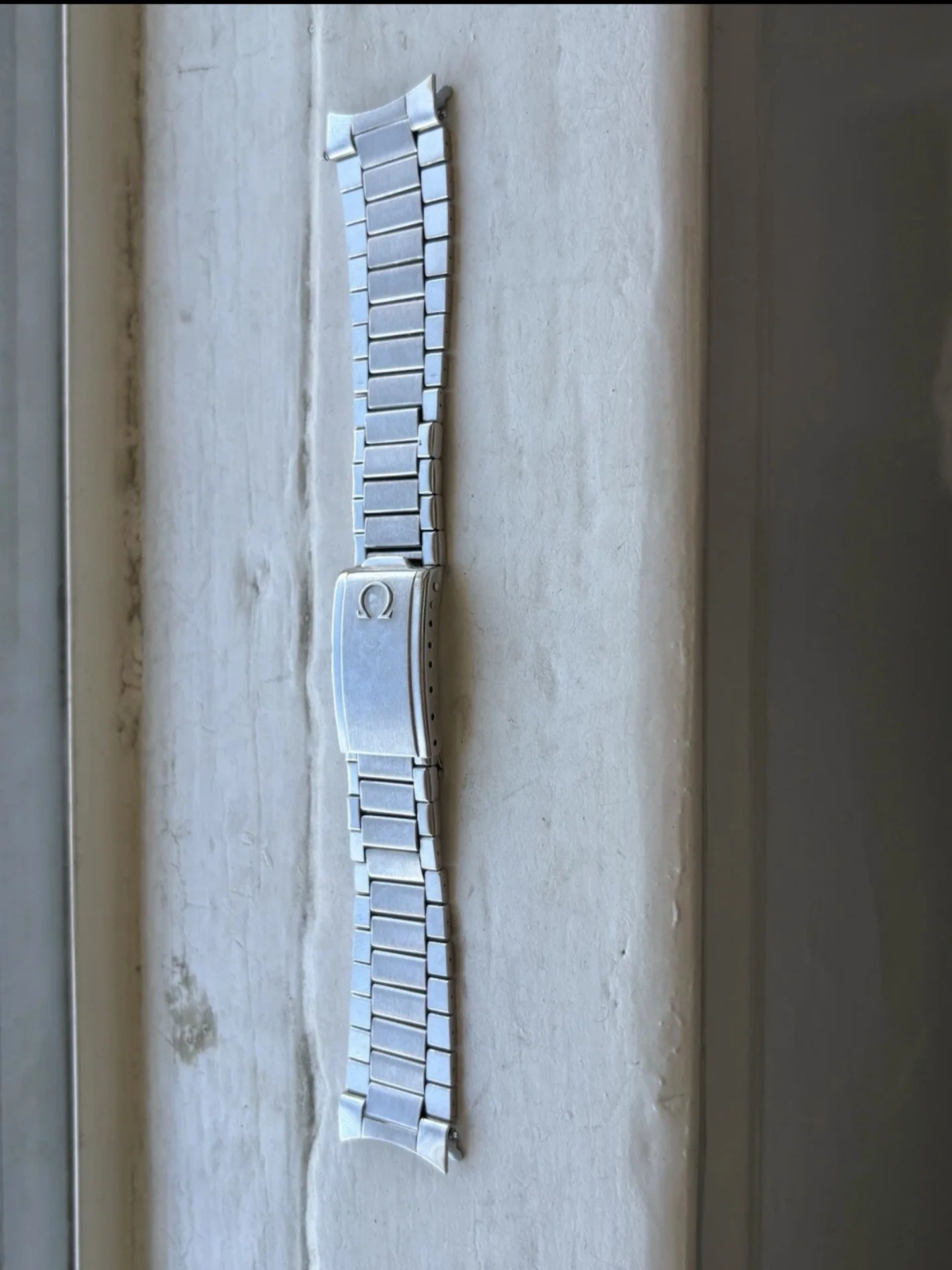

Thanks everyone. I really appreciate it. Yes, I can confirm: the 1039/516's do not in fact grow on trees. I just picked up the one pictured. Should have it in a few days

That’s a really nice 1039/516 example that you sourced. For info, the three digits on the inside of the clasp denote the quarter and year of manufacture.
