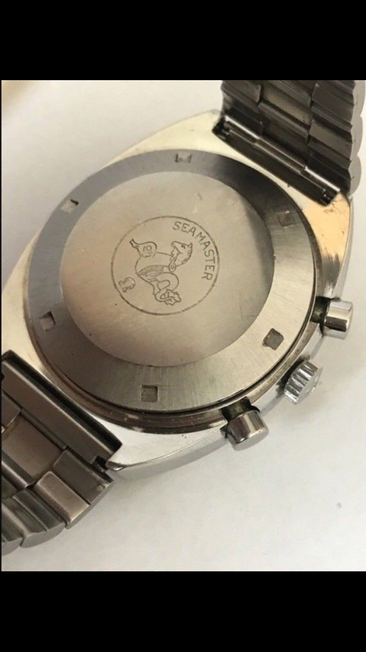

    hey friends,
    Do somebody knows the reference number?
    The seller tells me that this Speedmaster was limited to 2000 pieces. It was made for the 125 years standing of Omega.
    It should be from the 70‘
    But I cannot find a reference number and the seller colud not open the watch. He asks about 2000 Euro.
    D63CD483-A34D-4F6F-A5CF-CA752B977456.png 7D88162C-76C5-49EB-9048-E3DD7C39B85C.png 916C33A8-8E66-4B68-86CF-8010D7FCADFD.png A0D687E9-9A29-4333-82A3-996341426D10.png

    Looks like a 125 dial, but certainly not a 125 case...watch out!

    Thank you! This could be the „reason“ why the caseback is „locked“ :)

    Perhaps a Seamster „Jedi“ case?

    A Seamaster Chronograph case, but not a Jedi. Those are very different... despite what some dealers say in their adverts. :thumbsup:

    176.005
    What is date on bracelet? Bracelet might have more value than this particular watch head.

    The seller has the watch in banksafe ::shy::
    No infos available. But 176.005 would match perfect!

    looks like 4 69 to me

    A 1039clasp or flat bracelet , and after the big chunks bracelet , really special sale

    That doesn't look much like a 1039 bracelet to me.

    Yep, looks like it is either a 1039 clasp attached to wrong bracleg links or a pic of 1039 clasp from a different watch.

    Pretty bad mashup of unrelated parts. Case, movement/dial, clasp and unknown bracelet.
