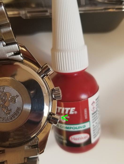

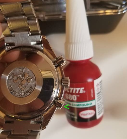

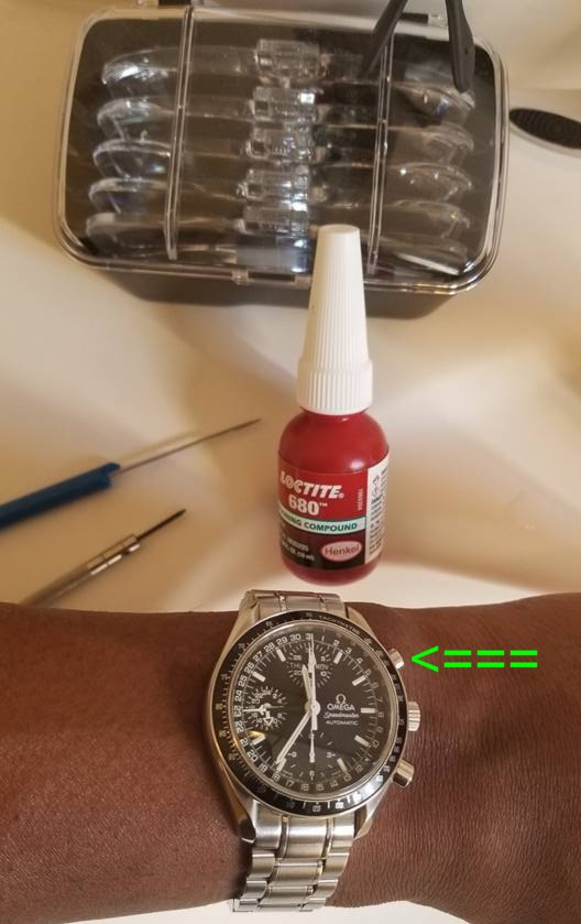

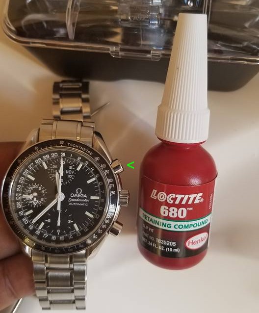

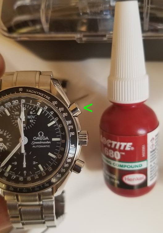

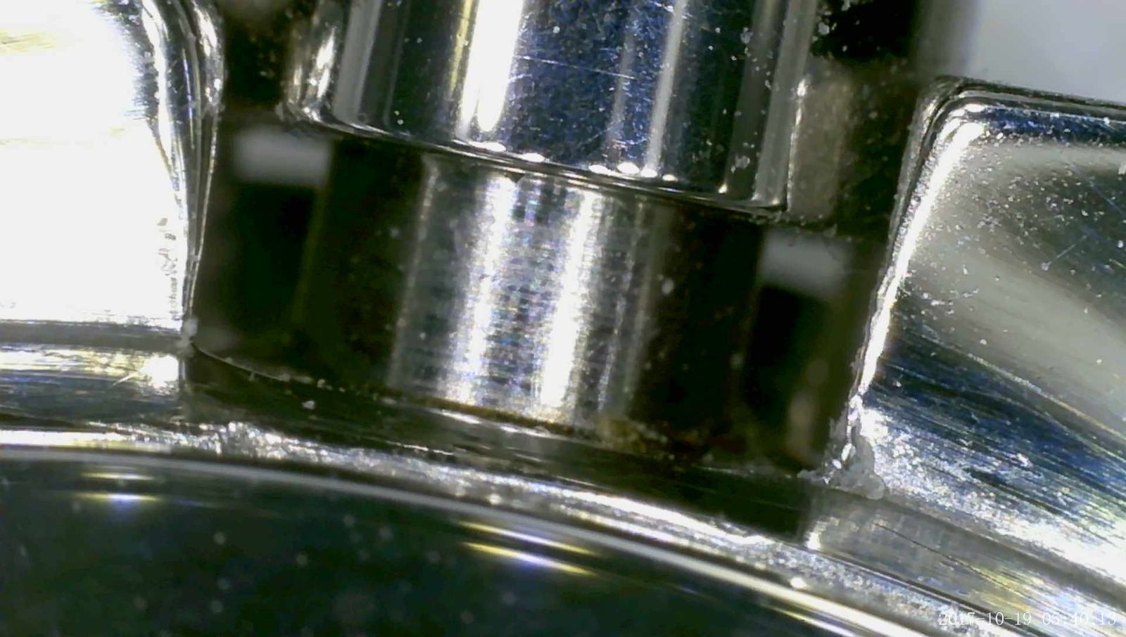

So last night I used a tiny drop from a $16 bottle of Loctitie 680 RC to re-seat the upper 2 o'clock pusher. After the pusher was inserted I let the watch sit over night (12 hours minimum) before playing around with it today.
Results are remarkable. The upper 2 o'clock pusher now sits in firmly place and works as it should (starting and pausing the chronograph's second hand).

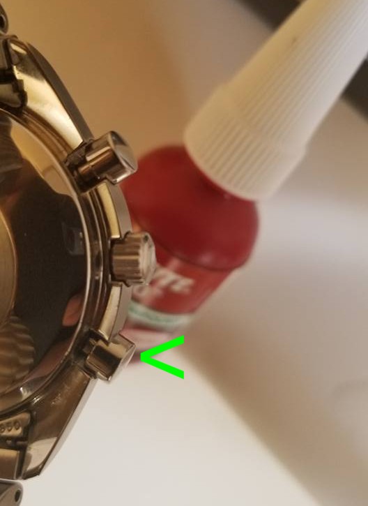

However, it is now apparent that the lower 4 o'clock pusher sits rather higher than it should. Archer first mentioned this and he is correct.
I tried removing the lower pusher to re-seat it but it is wedged in there firmly. It is vexing to see the pushers sitting at various heights above the watch but it is not too noticable when the watch is worn unless you are a watch expert and/or looking for this defect.
Regardless of my 'loctite' success I will definitely still take the watch in for the $750 full servicing at Omega next year after the holidays are over.
But for now this was a quick, cheap and temporary fix.
Please enjoy the pictures below (The green arrow shows the pusher I repaired) and let me know your thoughts?

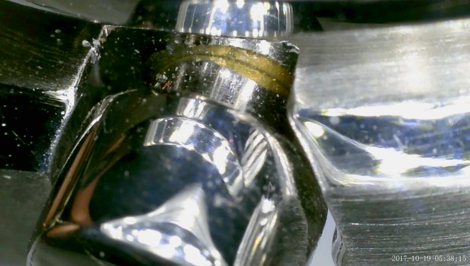

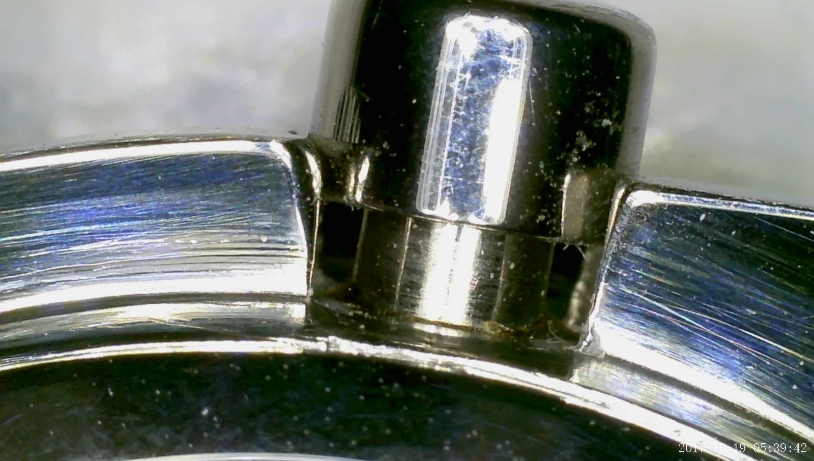

I was cleaning my speedmaster and I noticed some brown paste around the pushers, I thought it was dirt. Now I came across this discussion, and I realized that it was probably loctite.. not sure if I did a rookie mistake and I cleaned something that I shouldn’t.
fortunately I just removed from 1 pusher, small piece from the back. Should I apply a bit of loctite around the pusher?
17,939
37,516
.................. Should I apply a bit of loctite around the pusher?
No.
