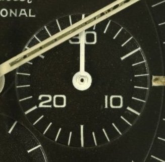

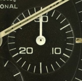

Since we’re talking about nipples…
I’m honestly having difficulty differentiating between the “no-nipple” sub-dial hand, and the “nippled ” variety.
This photo is from a 105.003-63:
This one from a 145.012. Both original, and should have different nipples. I’m not seeing much of a difference…
344
317

Thanks. Any comparison pictures that would help me spot the difference?
344
317
Mr Bob, focus on small hole and flat suface....you heve lot on net pictures of 2998-5 or 105.oo2 -62
7,421
23,896
Actually, if I could have easily seen the difference by just looking at pictures on the net, I wouldn’t have bothered asking the question.
