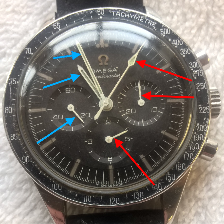

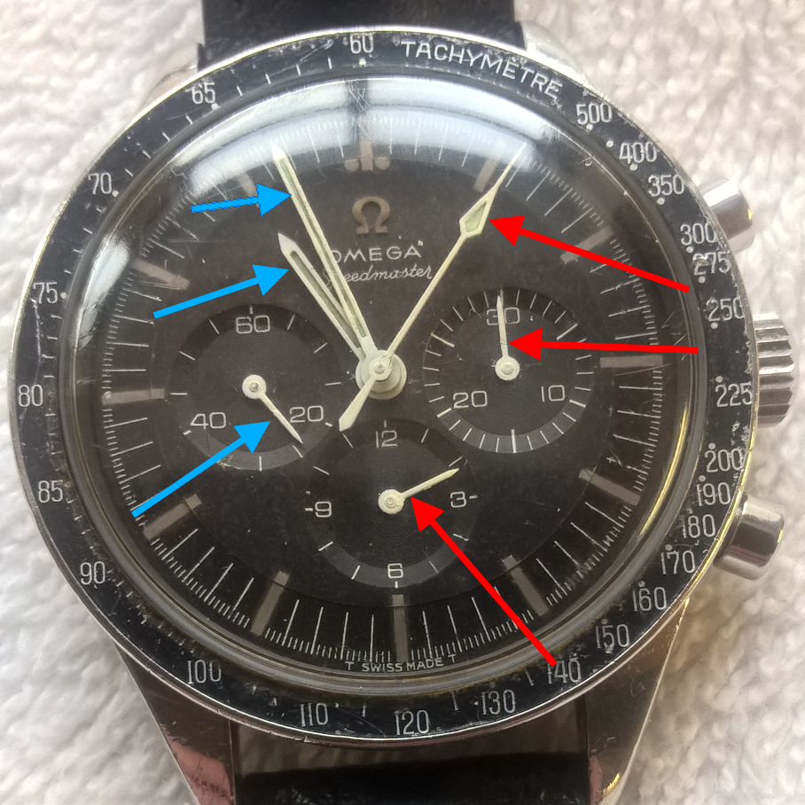

Just to make it very clear:
1. RED: The hands with a red arrow are connected to the chronograph function. So these should start and stop with the top right button and reset with the lower right button. These hands should stay in place when the chronograph is disabled and run when initiated.
2. BLUE: The hands with a blue arrow are running with the watch and will not start/stop or reset with the use of the chronograph functions.
Thank you so much for this. Totally clear and I'm somewhat relieved. As I mentioned in my reply to Dan S, I found a manual/guide which seems to give false info as the diagram is incorrect which makes the info incorrect.
I ran the chrono section overnight and all the hands are moving with no problems. I had wondered whether my non-centring sub hour hand might stick once it had completed a full rotation but it's fine.
One thought.....as the sub hour snaps back with ease (feels very precise) but to the wrong position (see photo in your post), is there any chance that the hand has simply been re-attached incorrectly? If so, removing it and then replacing it at the 12 o'clock position (presuming it then worked) would mean all was actually OK with the chrono. I have no idea how the hands attach and whether there is only one position they attach to. I'm sure you can sense a degree of clutching at straws here....
Thanks again for taking time to reply. Best wishes....Nick

So if I understand this correct, the sub hour hand stays in place when chronograph function is stopped, runs when enabled. When reset is made the sub hour hand is placed at the same position as in the image (slightly after the "2" index). Sounds like if functions as intended but the hand is incorrectly placed at last service. Quite odd but should clear up at next service.
26
17
That's correct although I'm now testing to ensure the hour does restart after being stopped.
I have no idea how difficult it is reset the hand but is it something that my local Omega dealer might be able to handle? They have an in-house repair person who I guess is there for small repairs.
I can't tell you how the weight has lifted off my shoulders since yesterday thanks to Dan S and yourself. Much appreciated!
Many thanks....Nick
24,836
55,255
Straightforward to make that adjustment on a hand. Most likely it was attached correctly at the last service, but something happened to make it wonky. If it consistently resets to the same position, it is an easy fix. You do want it to be done by an experienced person, since the hand needs to be removed and replaced, and you don't want any damage to the dial in the process.
