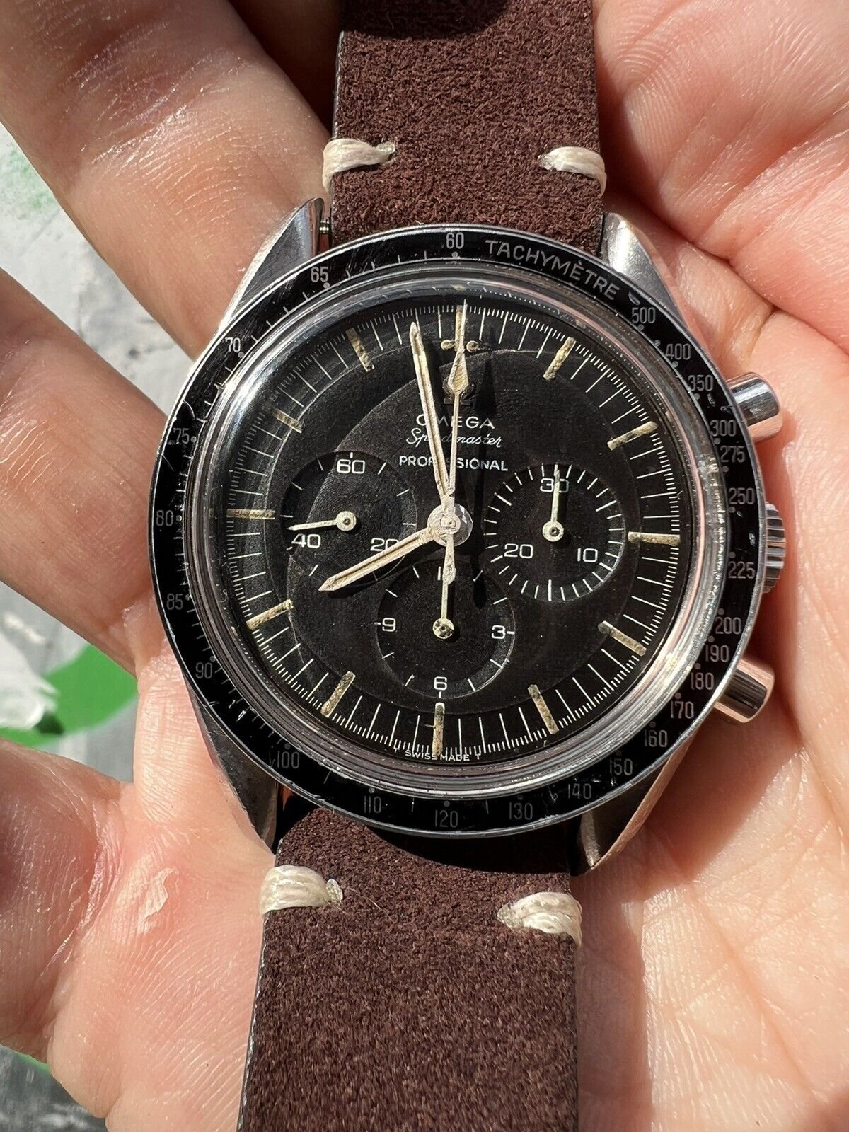

Hi Guys!
This is my first post regarding a strange seller on Ebay, so I do hope that this is the right way to post??
I am not trying to become a Perezcope Guy, I only want to warn other Forum members.
And here is the story:

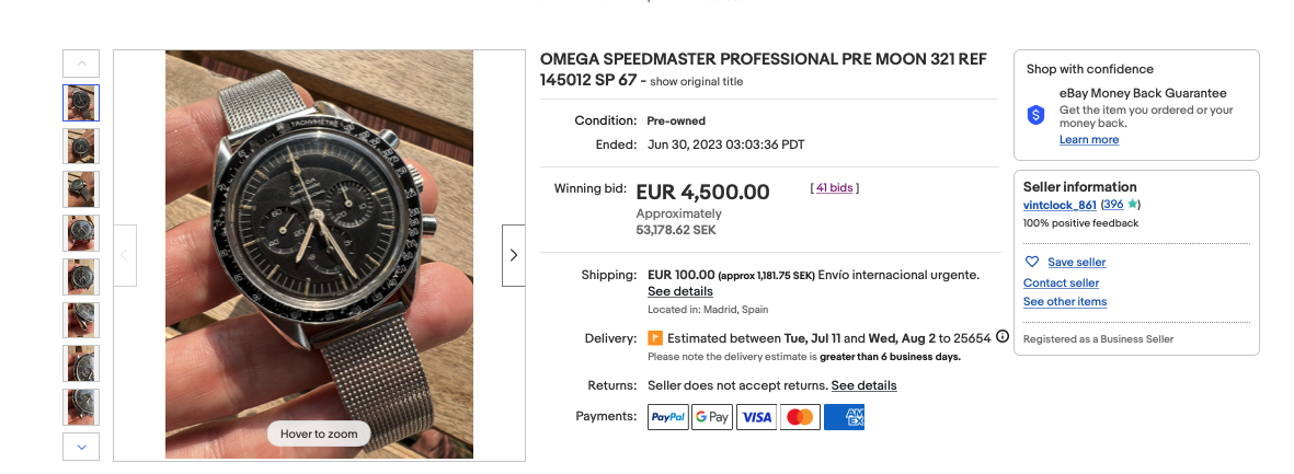

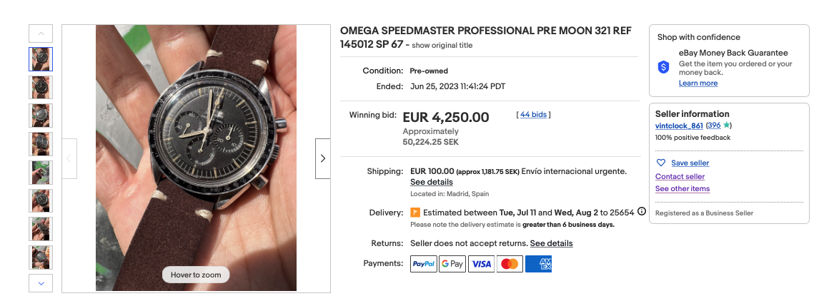

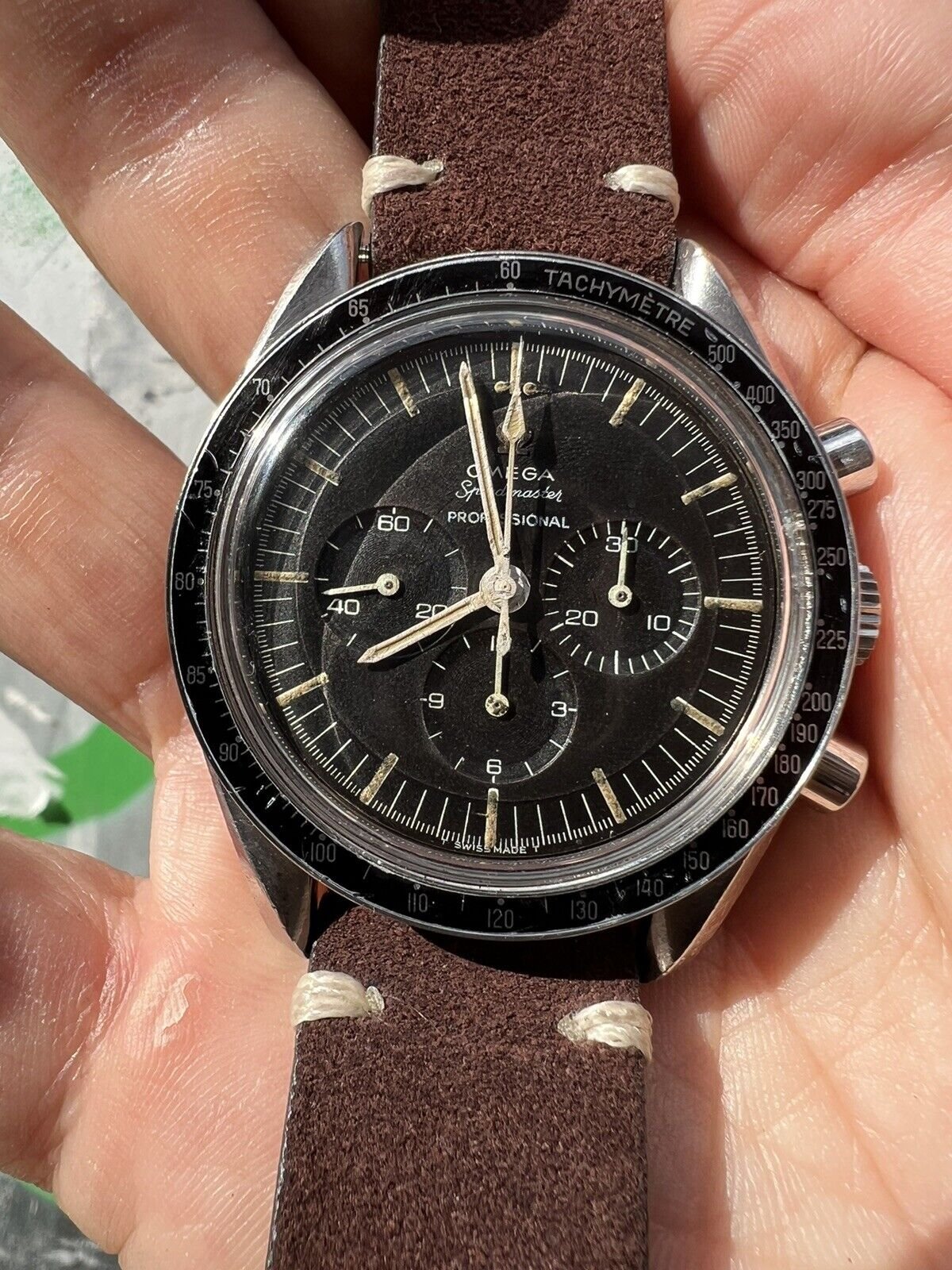

I found this watch on Ebay (I know - why the fudge am I searching there…)

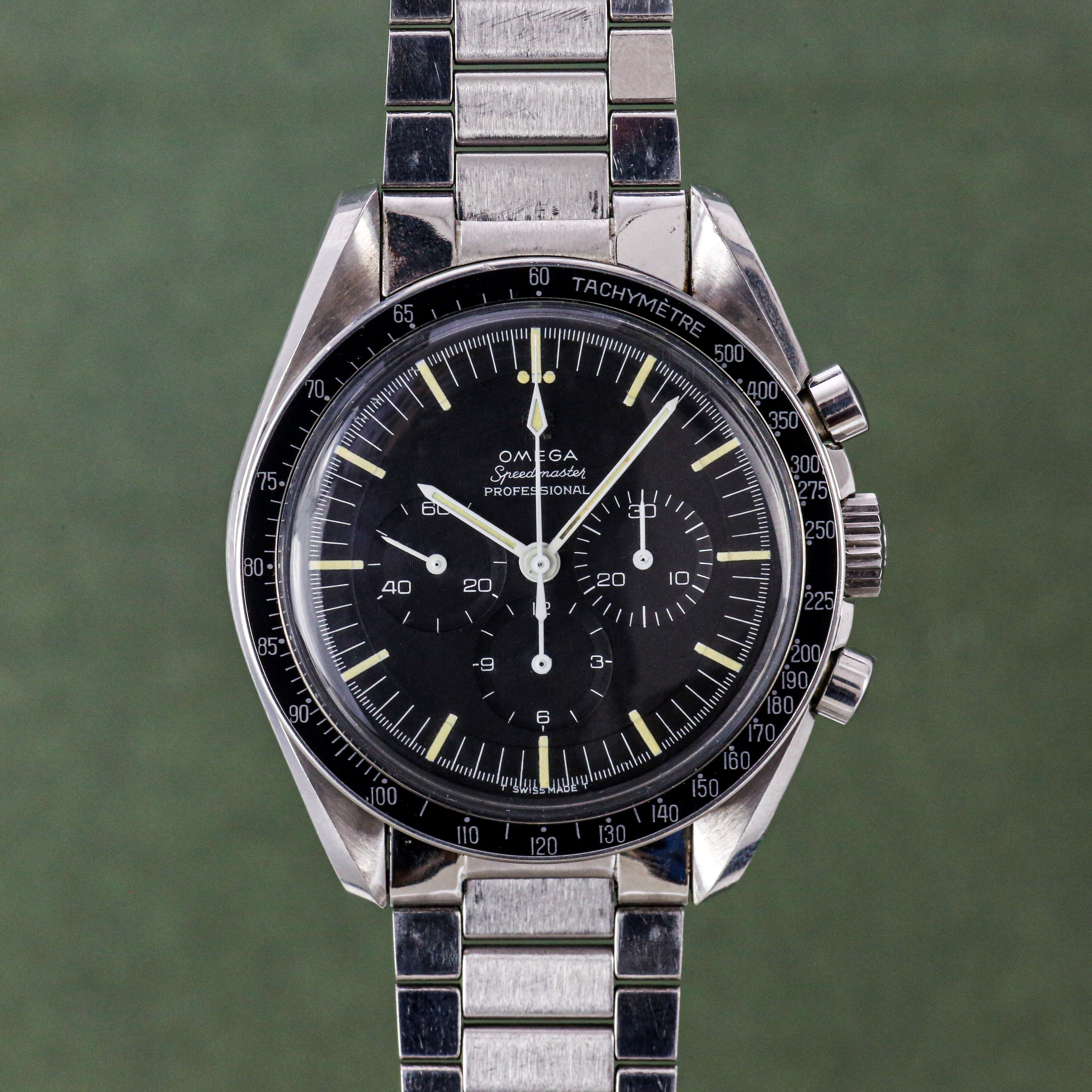

And it is a 145.012-67, I have been looking for this reference for a long time…

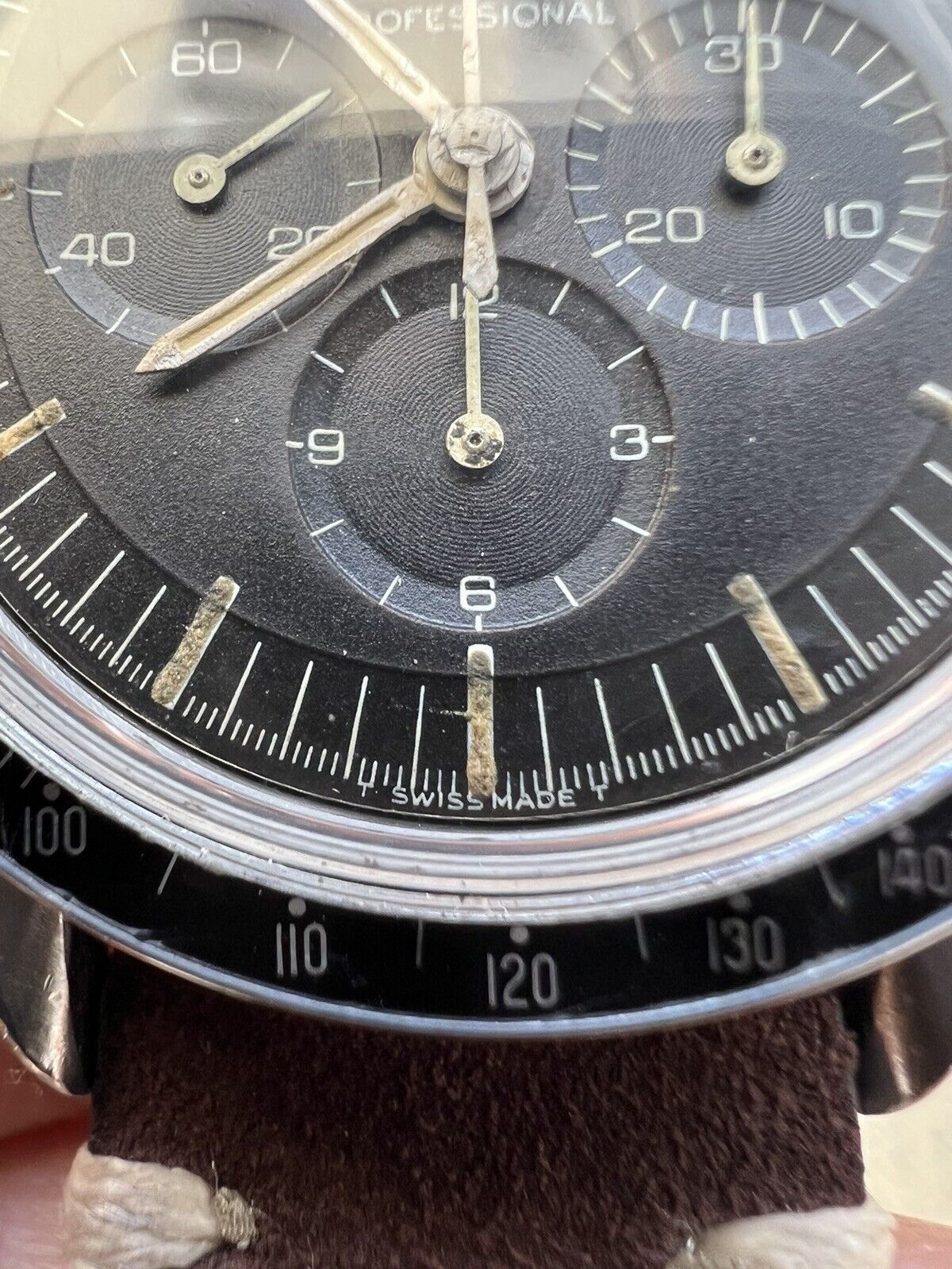

I looked at the pictures and thought that the watch had some strange issues?
The dial - closed spaced T´s, this reference should have wide spaced T´s.
I learn about this a few posts before…🤦
and I also had The Bible (Moonwatch Only) to do my research ….
So the dial didn't match the watch, not a biggie for some maybe, but that made me not want to join the bidding.
I did ask the seller a few questions about this, and his respons time was very fast,
but with very lame answers….
He wrote that he actually had no clue…!
So this was a No-Go!

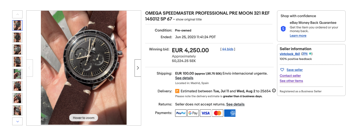

Link below to the ended sale.
With a very low price.
https://www.ebay.com/itm/2853413439...-53200-19255-0&campid=5338788128&toolid=10001

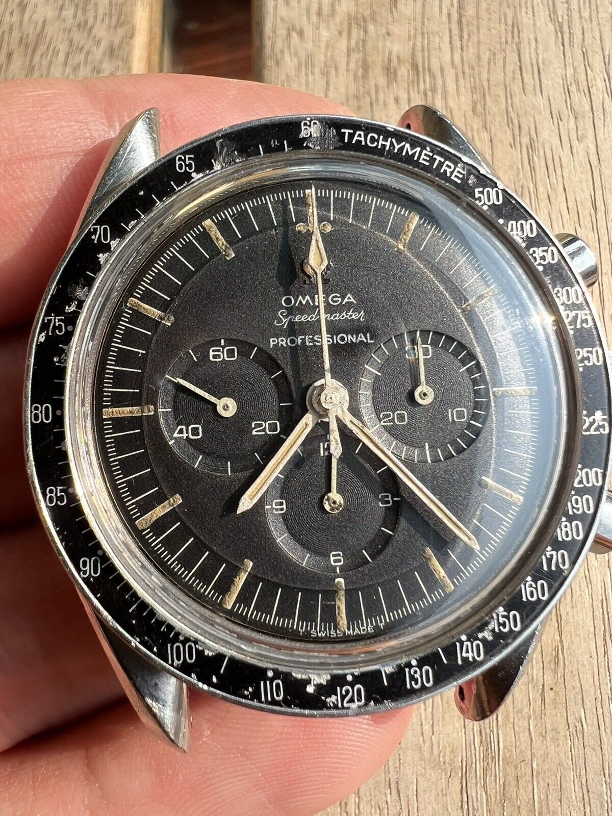

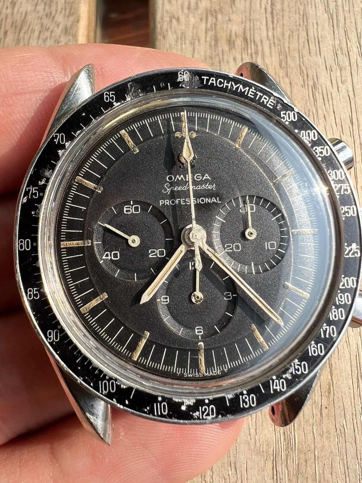

And now, the same seller has another 145.012-67 on Ebay for an auction!
So of course, I had to take a look.
At first, you might think it's another watch, the bezel and bracelet/strap are different,
but when you start to look at the details, it has to be the same watch!!

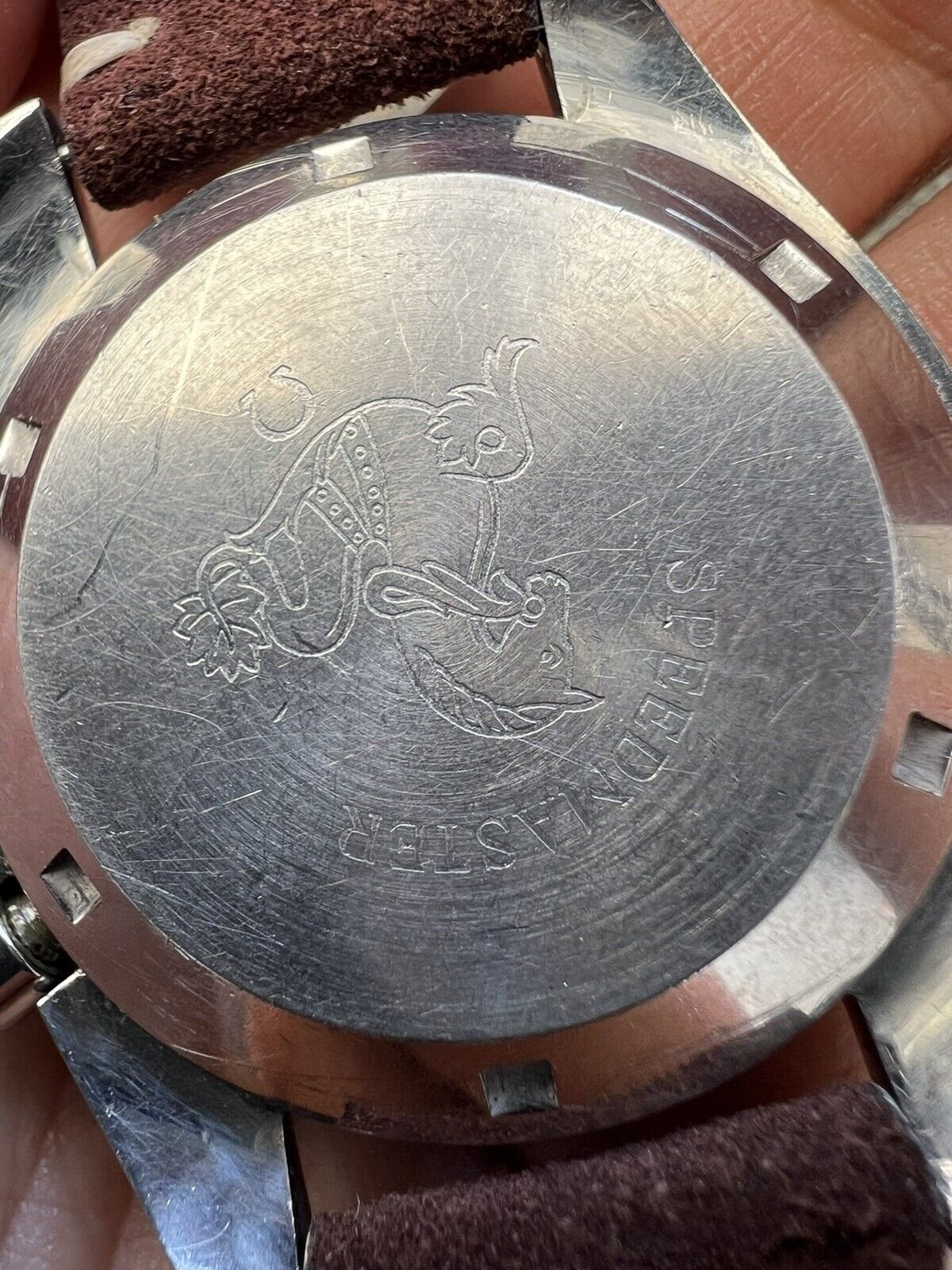

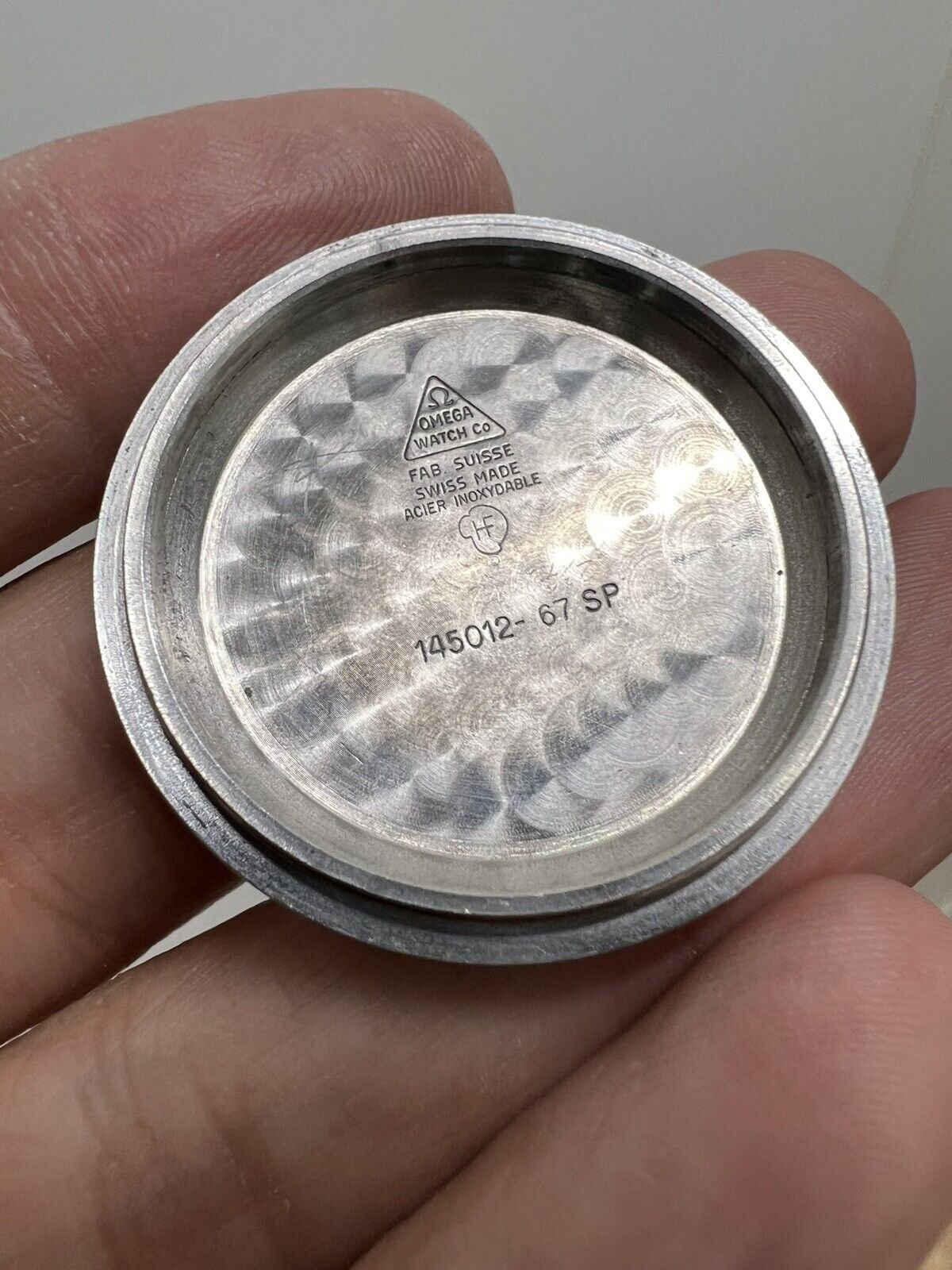

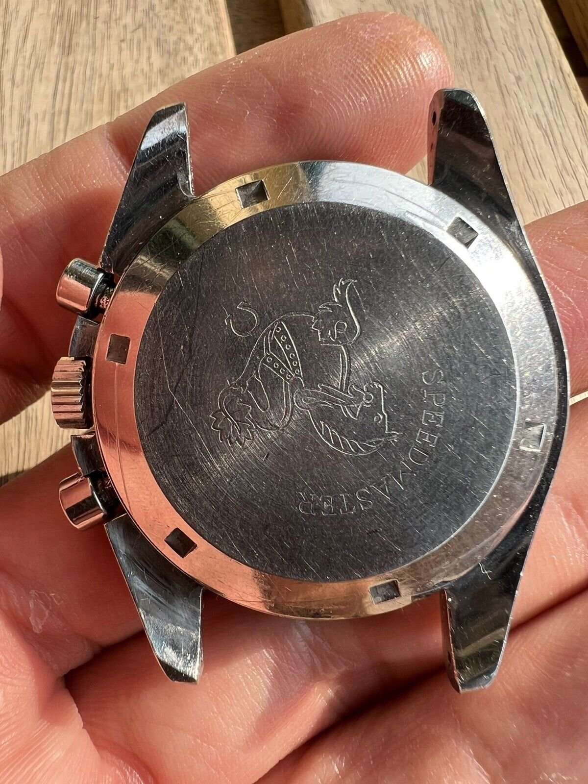

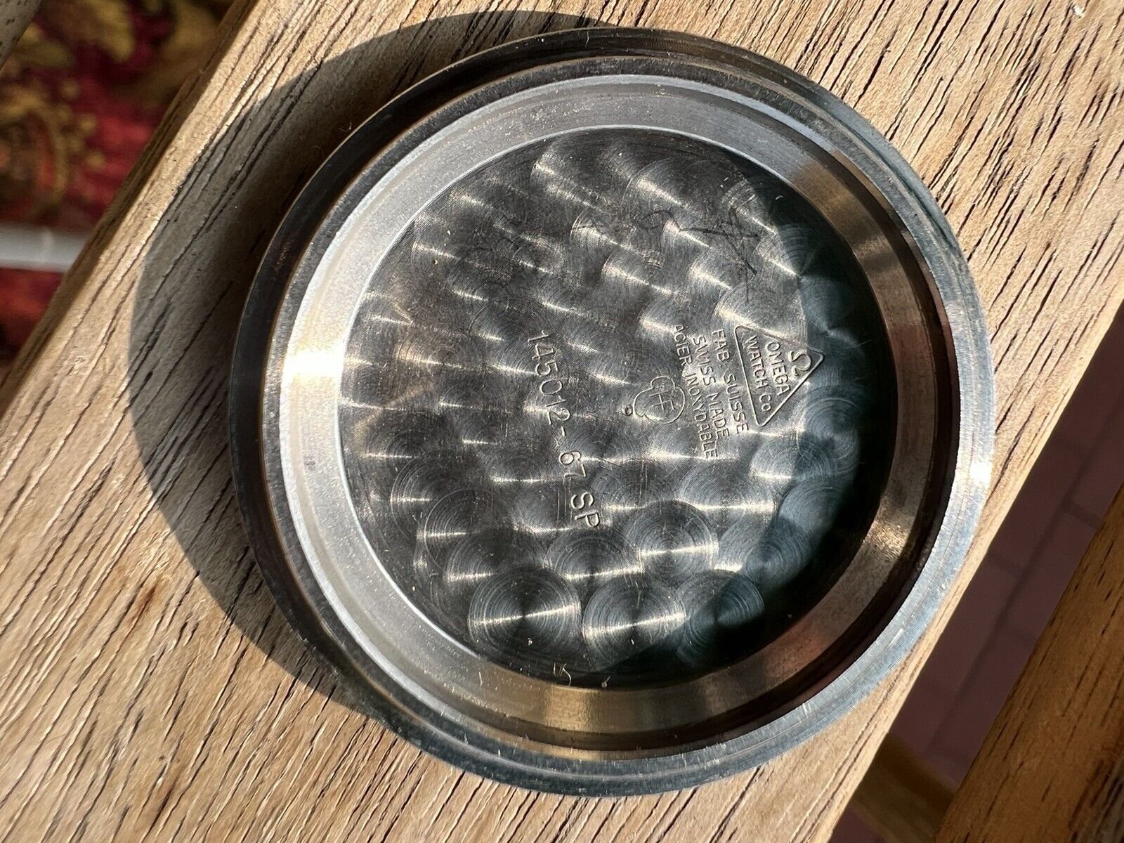

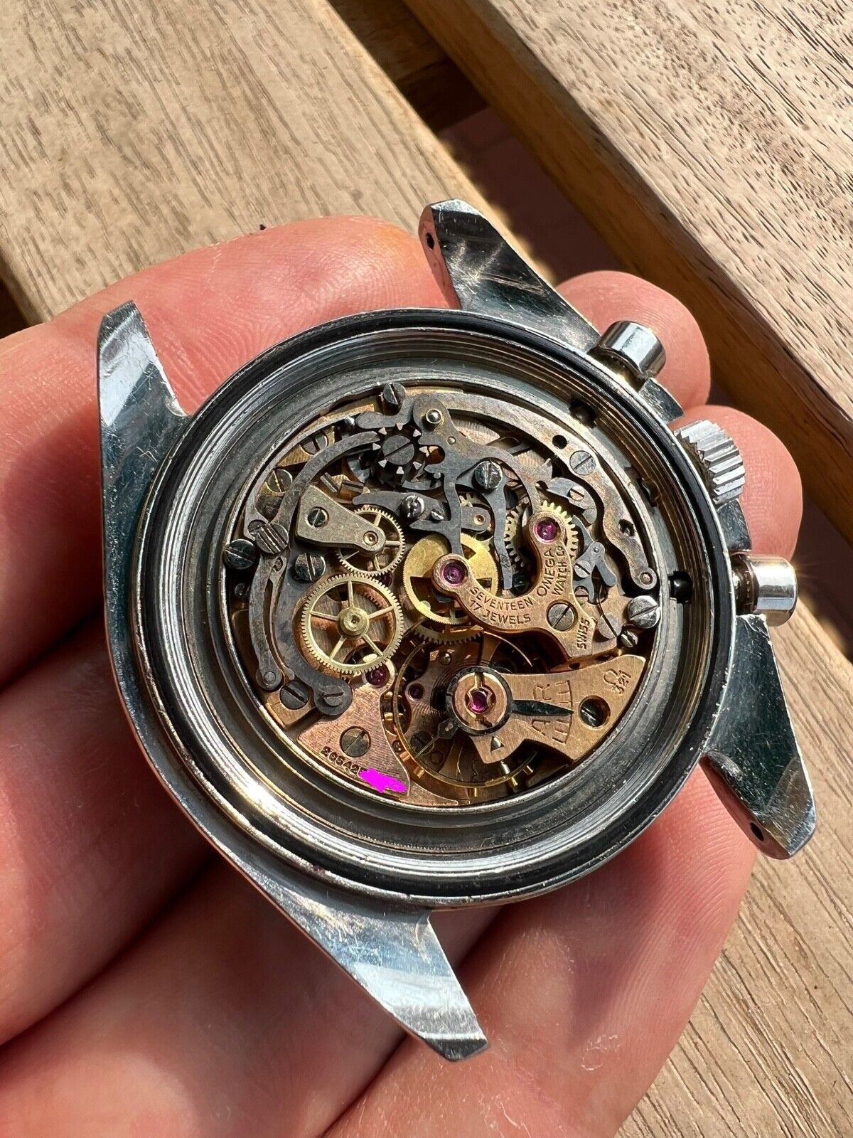

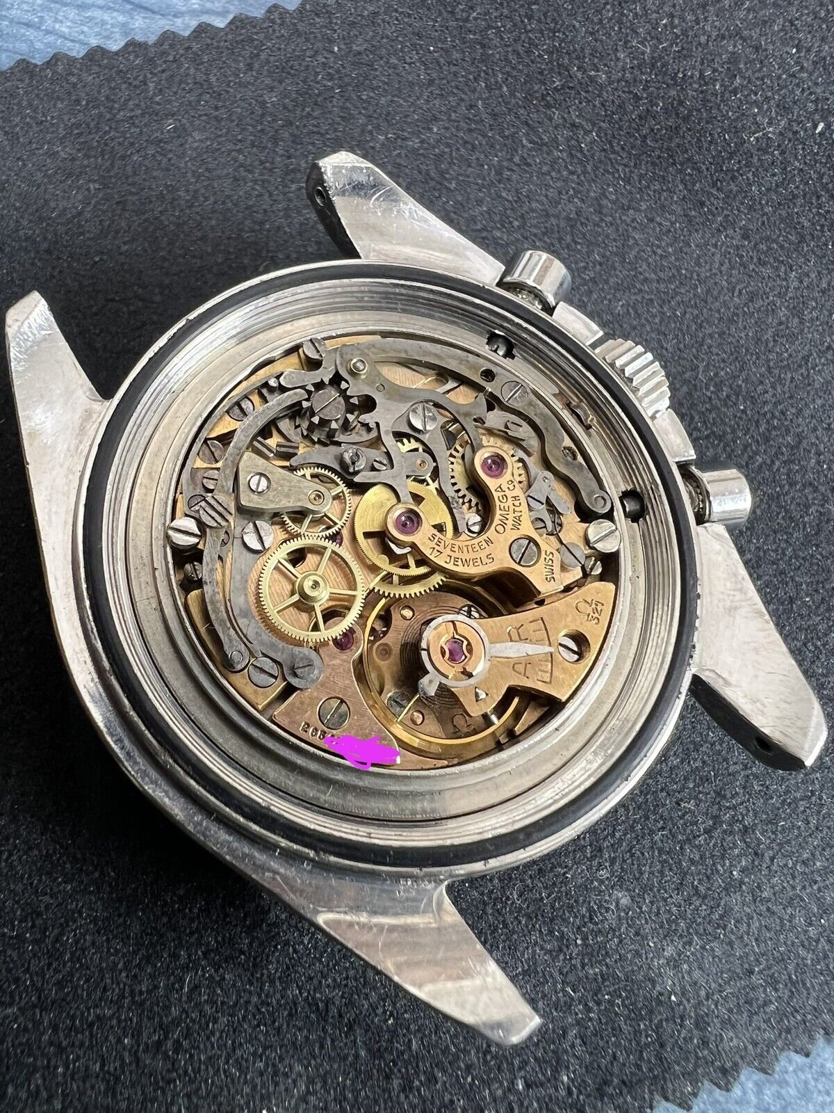

The dial has the close spaced T´s, the lume plots look the same, the weird hands are the same,

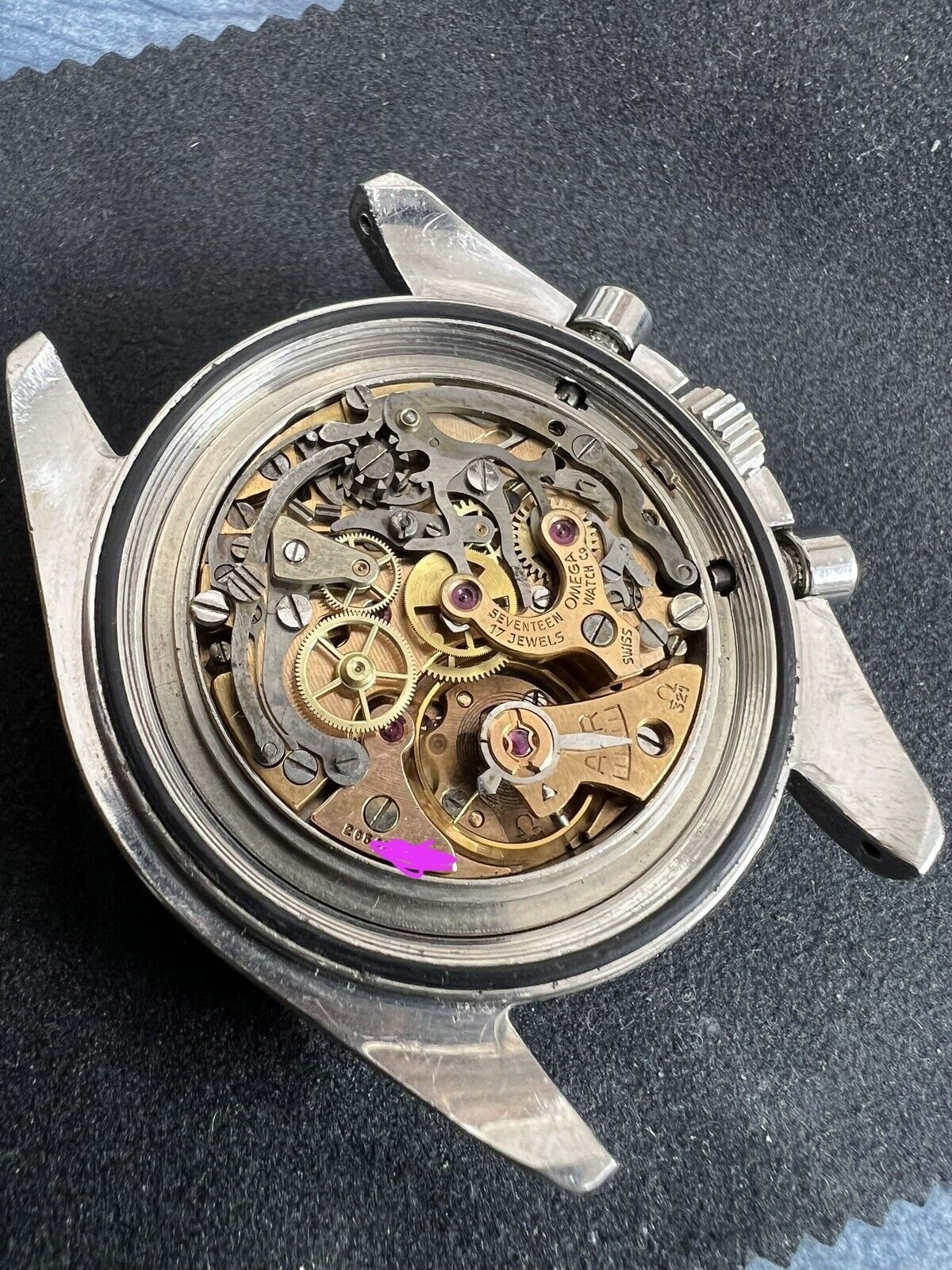

movement looks the same with the same serial nr,

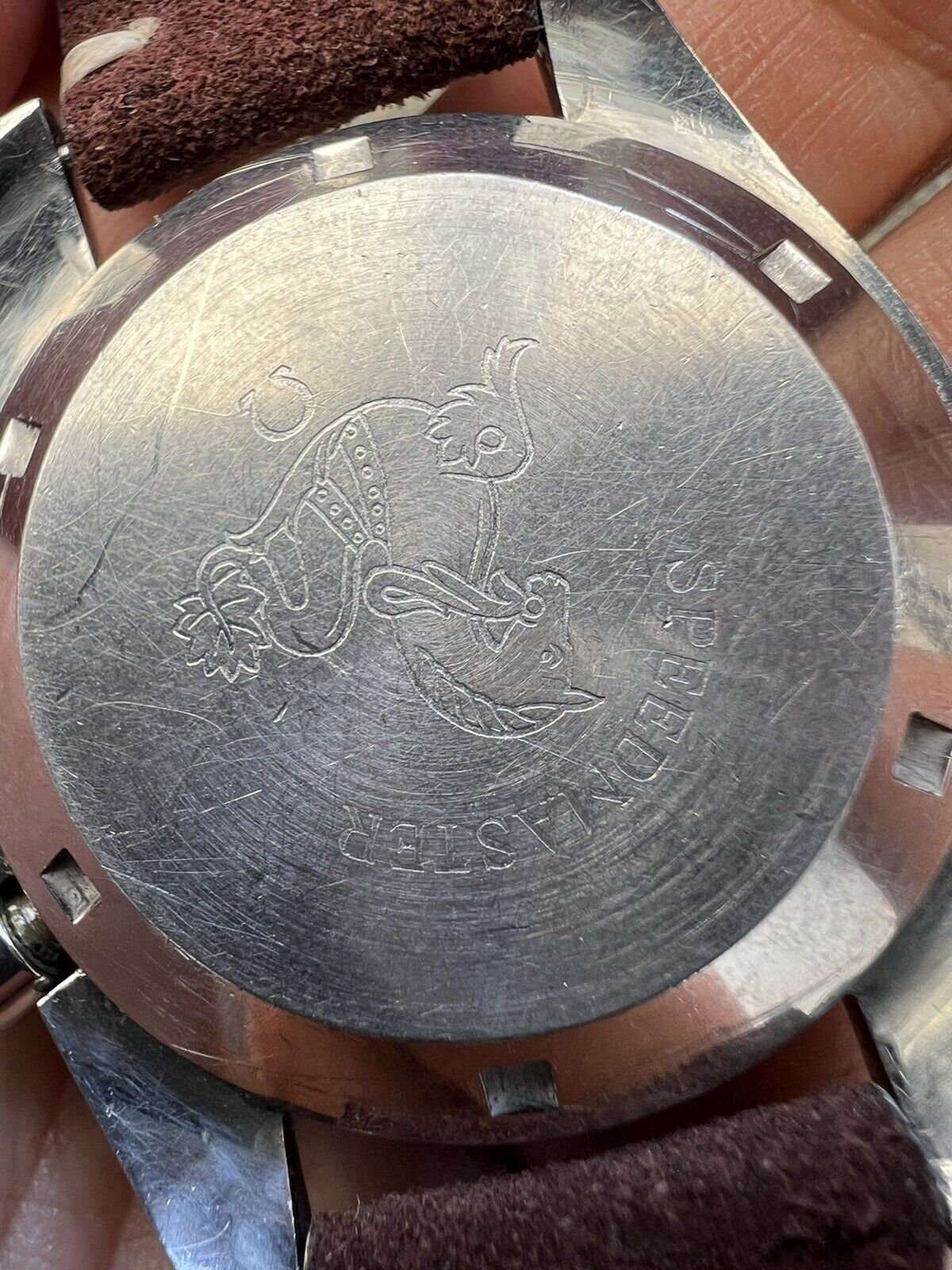

the caseback has the same scratches inside and outside etc etc!
Link below to the new auction.
https://www.ebay.com/itm/285351506442
My point here is, had I not seen the first auction, and had not learned (with all the help from this Forum)
all the details regarding references etc, I might have followed the auction and bought this watch.
And I do think that those who are new to the SpeedyWorld might buy this watch?
So always buy the Seller and not the Watch??
Please correct me if I am wrong here, and if so - I will try and delete this post!
Regarding the pictures, the first five are the watch that was sold.
And the following four (head only) are the ones for the watch on auction now.

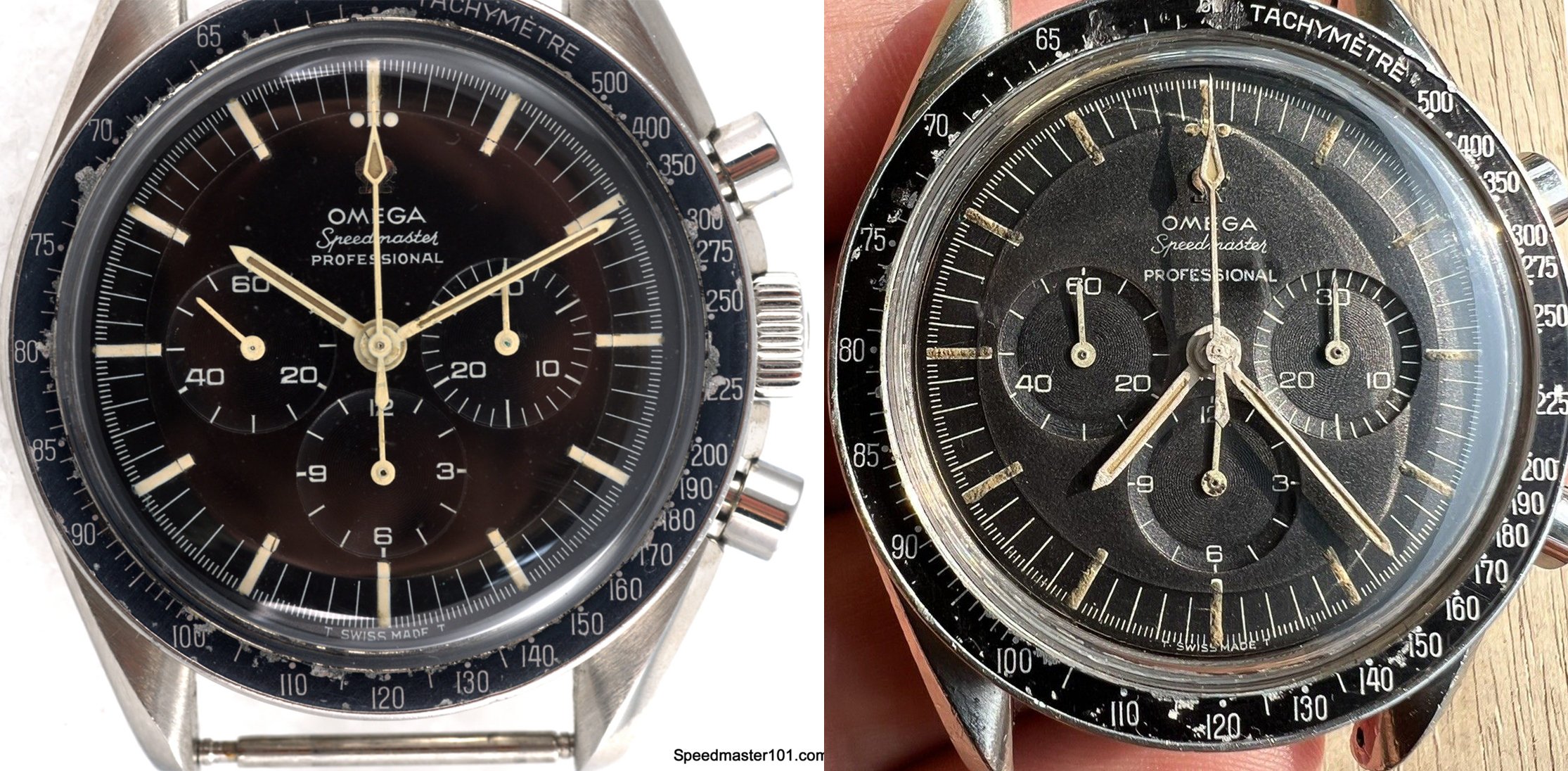

Good eye! Definitely the same watch. Not sure about that bezel. Could be Photoshop.
1,578
6,820

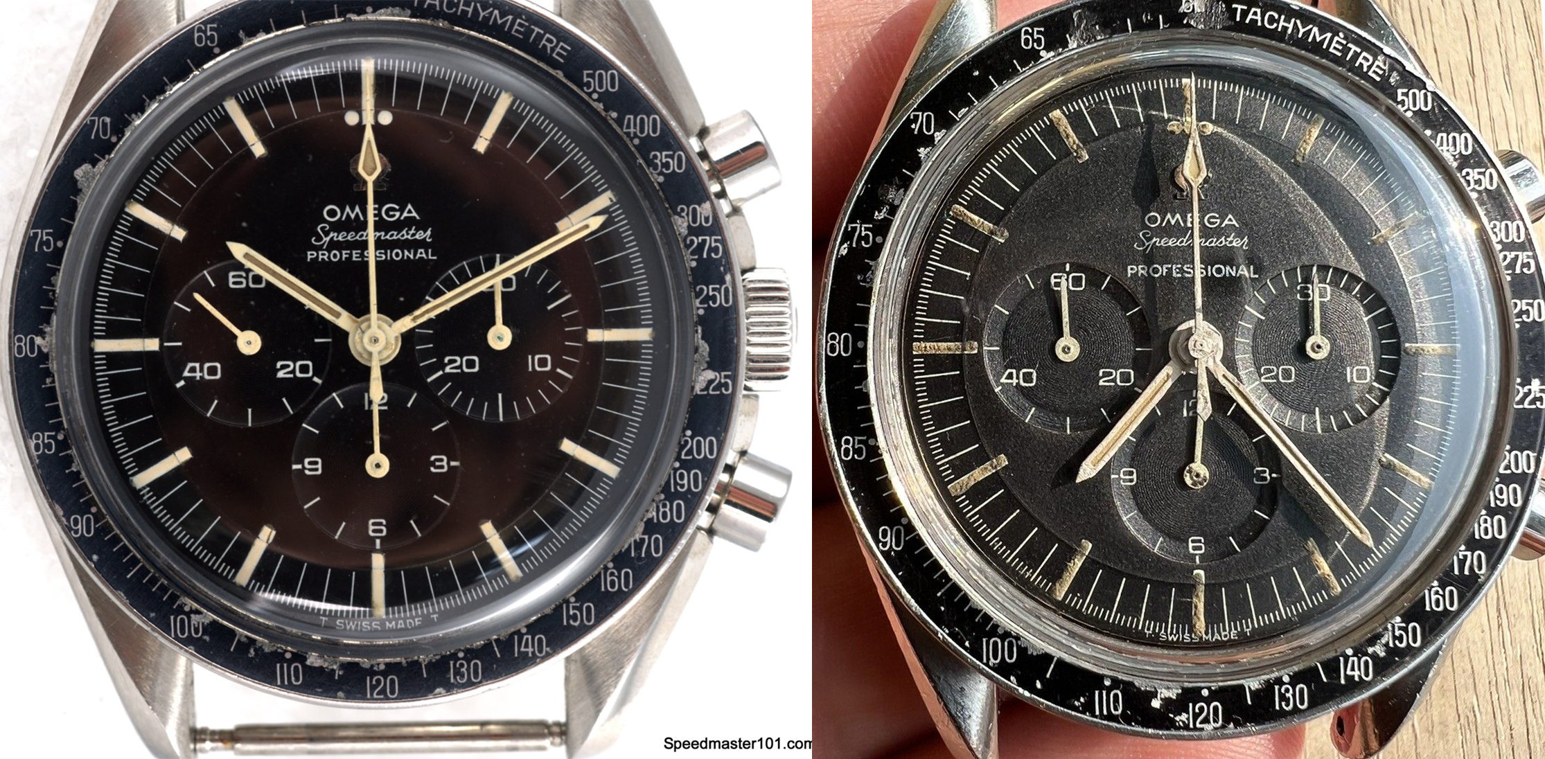

Have a close look at the spacing between Speedmaster and Professional. Something is very, very wrong about this dial.

That Professional ::facepalm1::
I know, I know...
I just stared at the T´s, and stopped there....

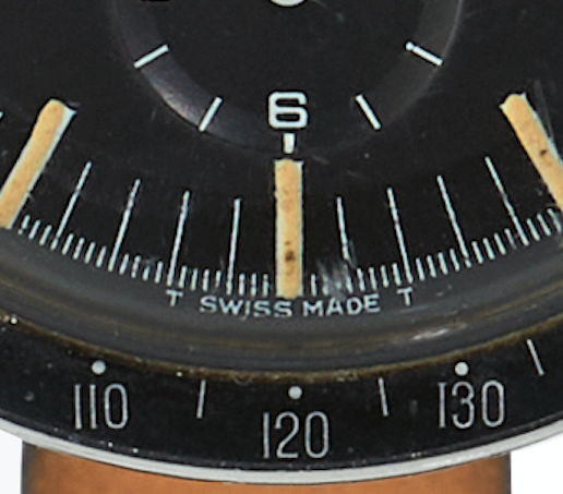

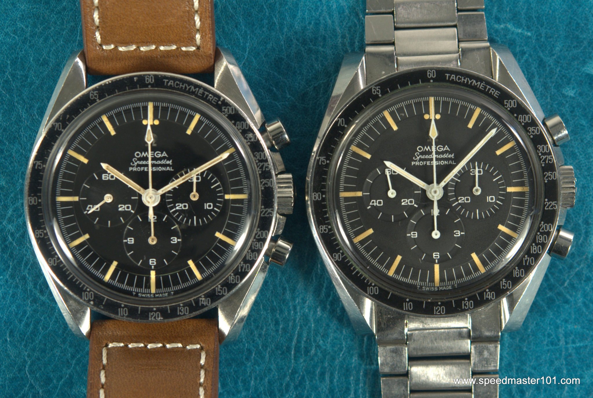

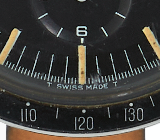

I am more into seamasters and may I ask: the T never reaches (speedmasters) to the 28-32-minute-markings?
2,628
5,895
I am more into seamasters and may I ask: the T never reaches (spedmasters) to the 28-32-minute-markings?
They do on later 105.012´s...and newer references, this is a 145.012-67.
2,628
5,895
And to sum it all up...
Here is a 105.012-66 with close spaced T´s.
And it´s mine!

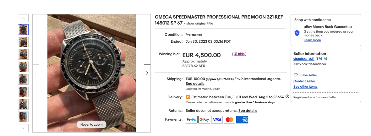

Less than 8 hours to go, and people are still placing bids....
5,724
9,508
And ? Everything is clearly to see. Will possibly go a lot higher anyway.
2,628
5,895
hopefully not more than the first time??
907
1,295
Auction ended at little more than 4K. Seems about right between aft bezel and l questionable dial ( to put it mildly...)
