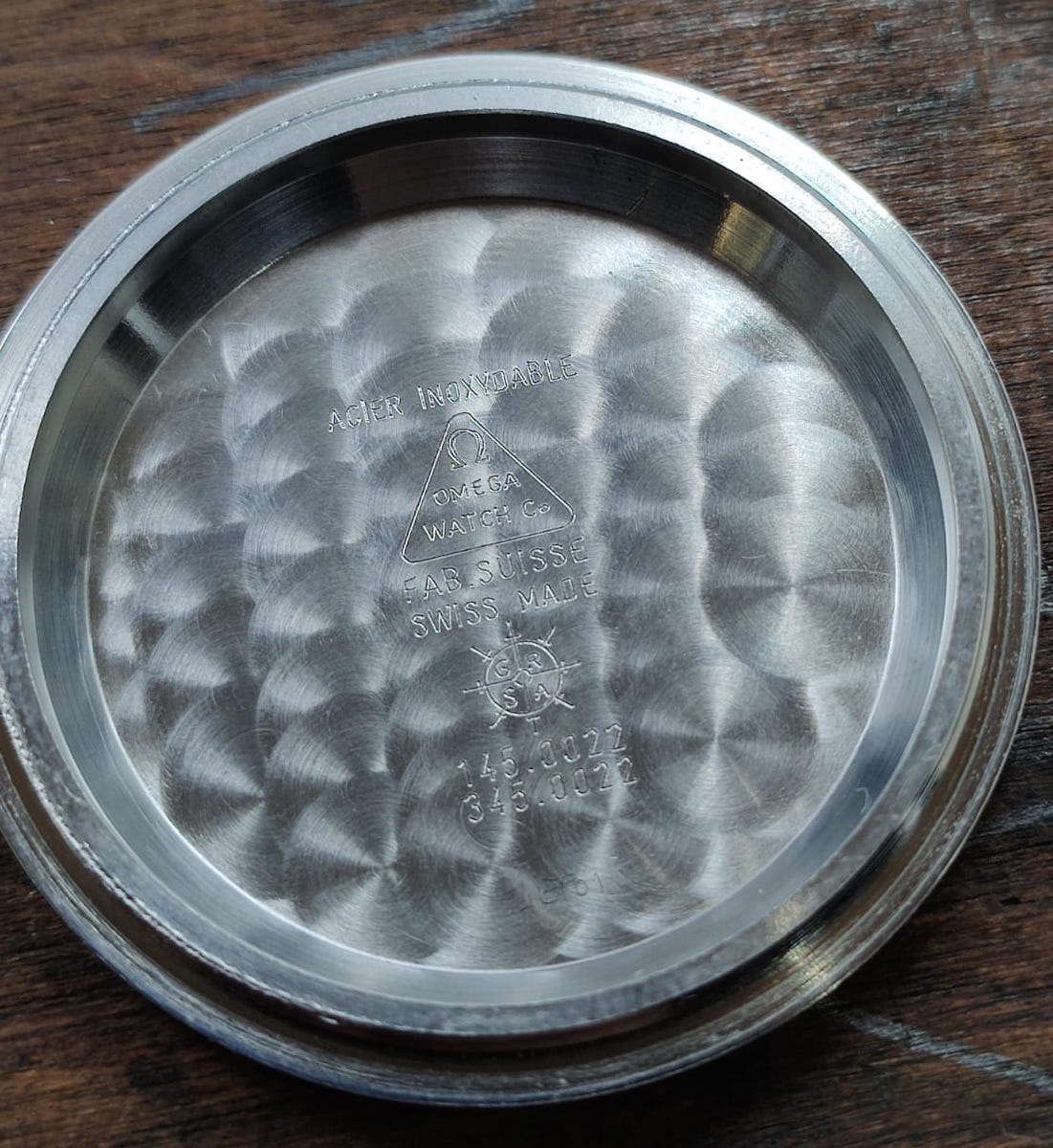

hi to all what do you think of the internal case back the writing seems done by hand is it right ???

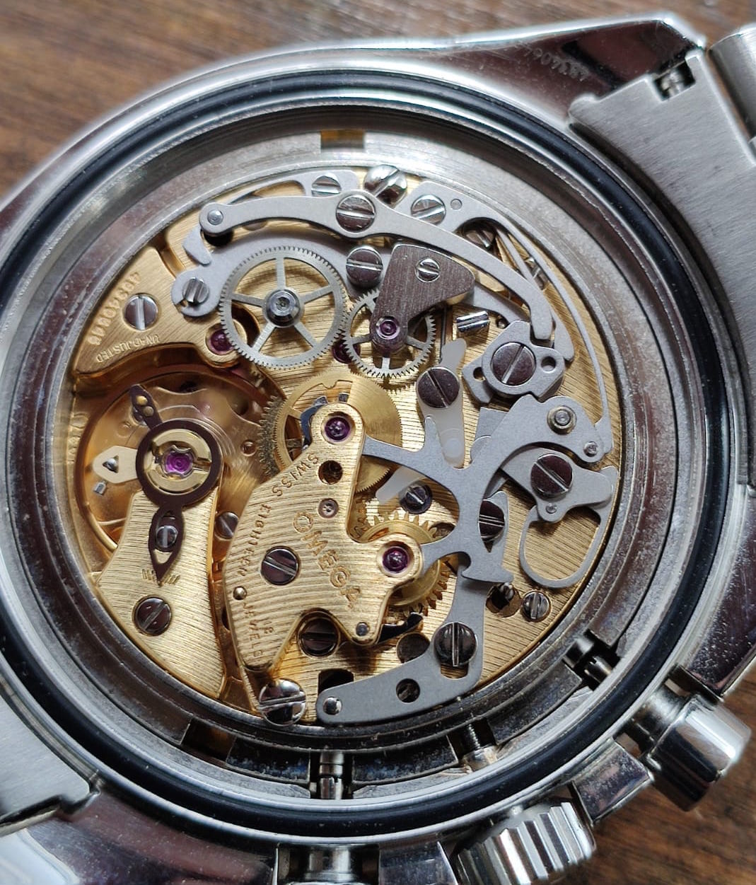

Avoid unless you don't care that it seems to be made of misc. parts. Possible replacement service back and mvt. I think I saw somewhere that movements that begin with 499 were service replacement parts. Also that does not match the case # visible on the underside of the lug in the picture.

Both serial numbers match to my eye. Also starts with 48 not 49.
One of us needs glasses 😁 hope it’s not me.

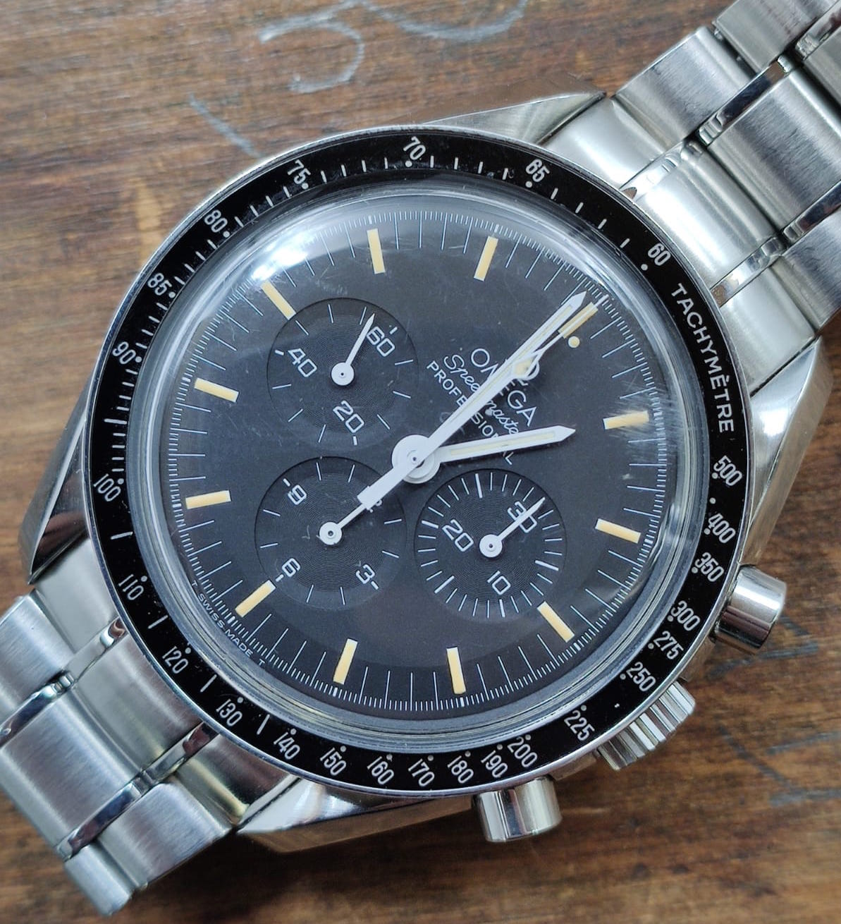

Nothing wrong with the case back or anything else for that matter. Only issue is the bracelet that is not correct for that watch.

On closer inspection it might be me ::facepalm1:: or I need a better computer

Movement number start 483 and is same on lugs thanks

Right 483 lugs too

Your eyes are fine...
