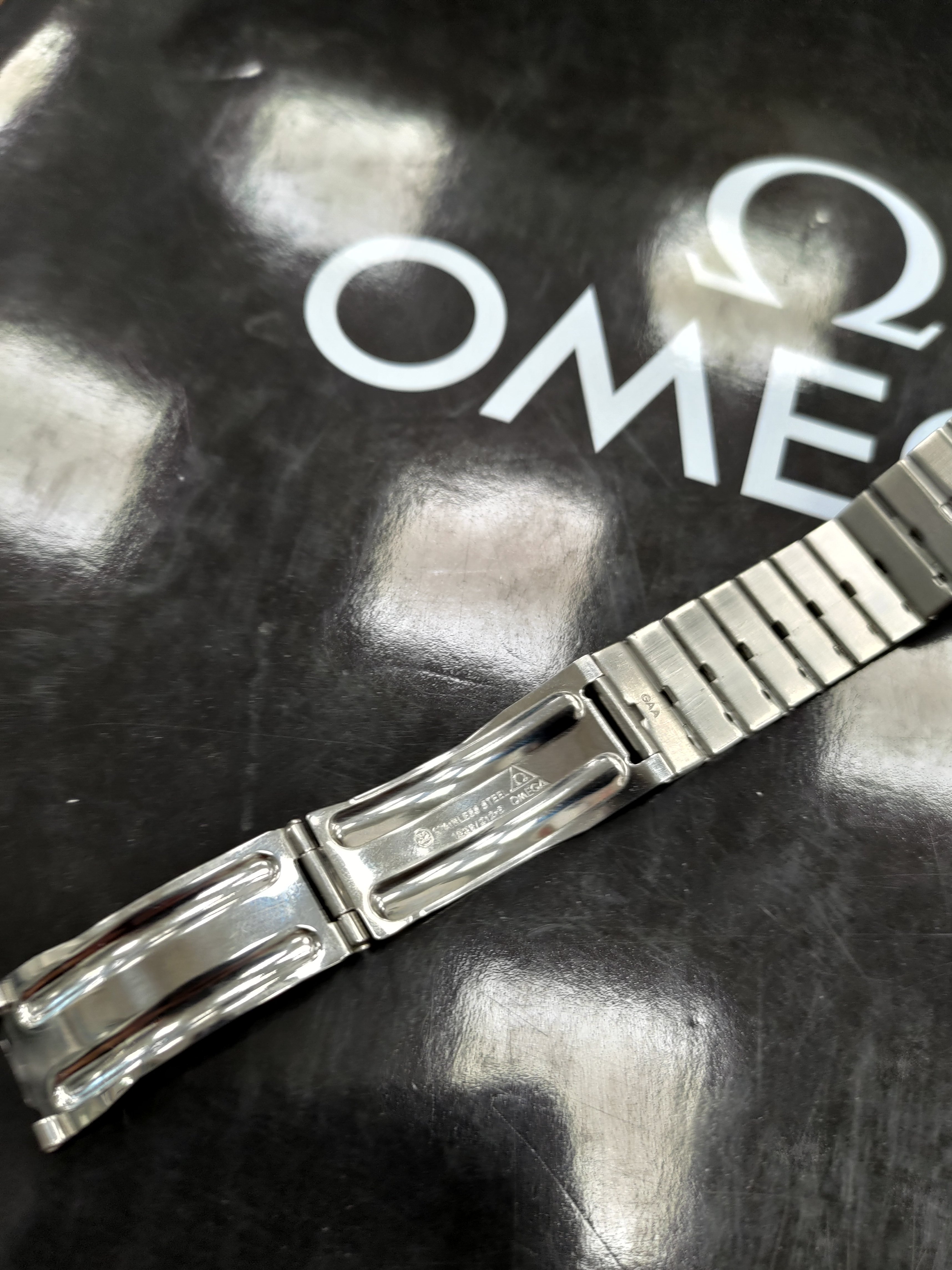

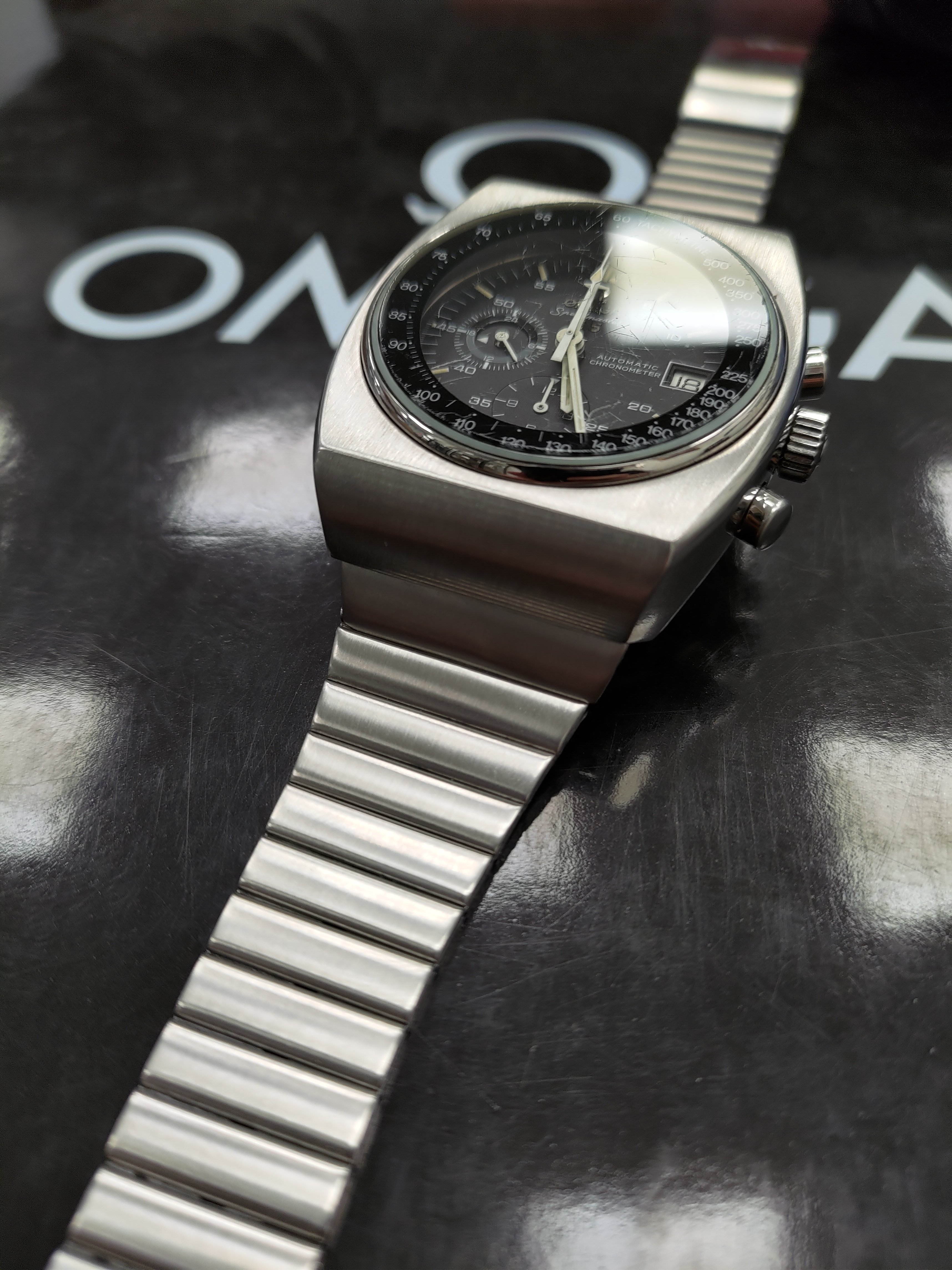

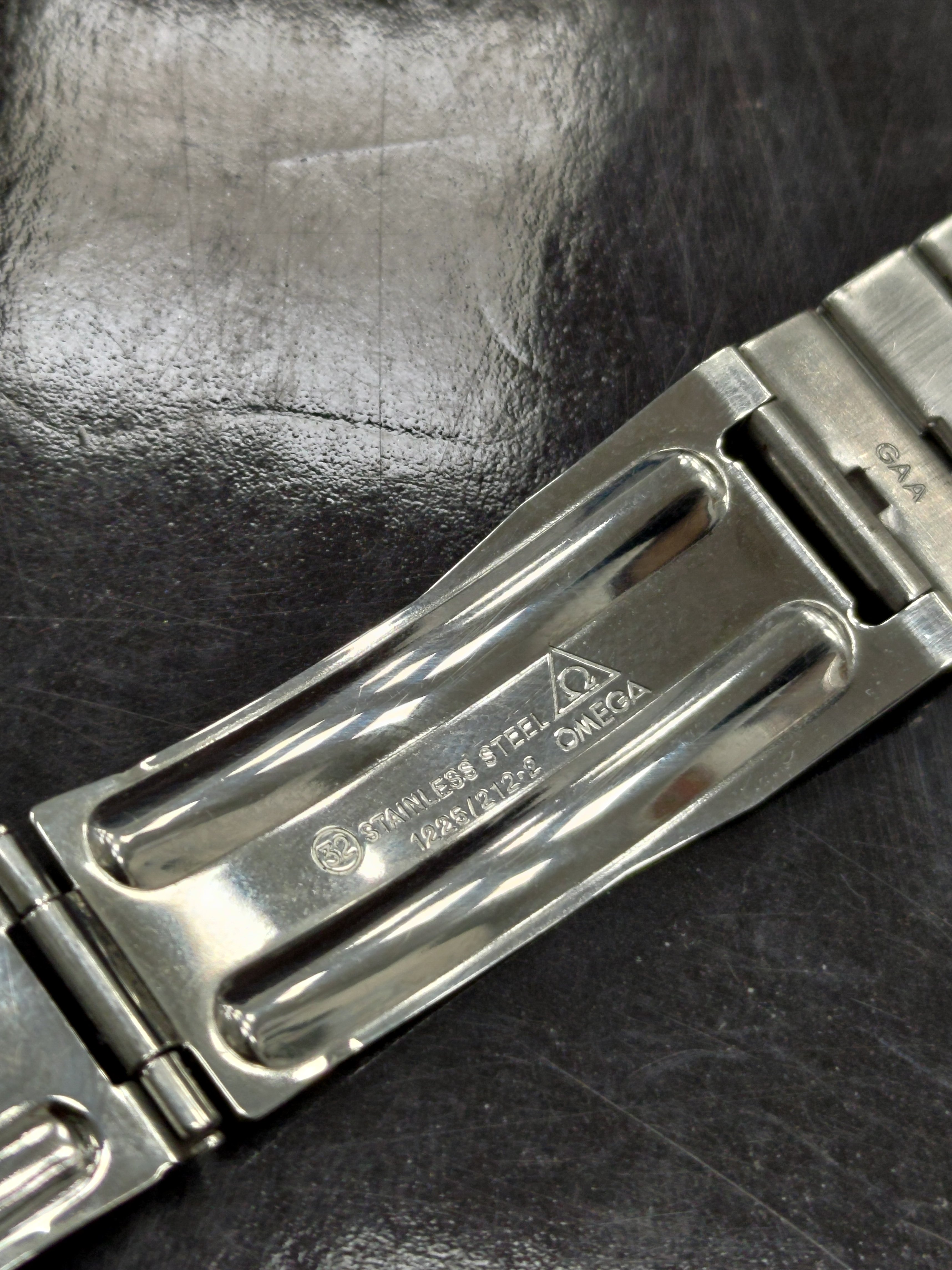

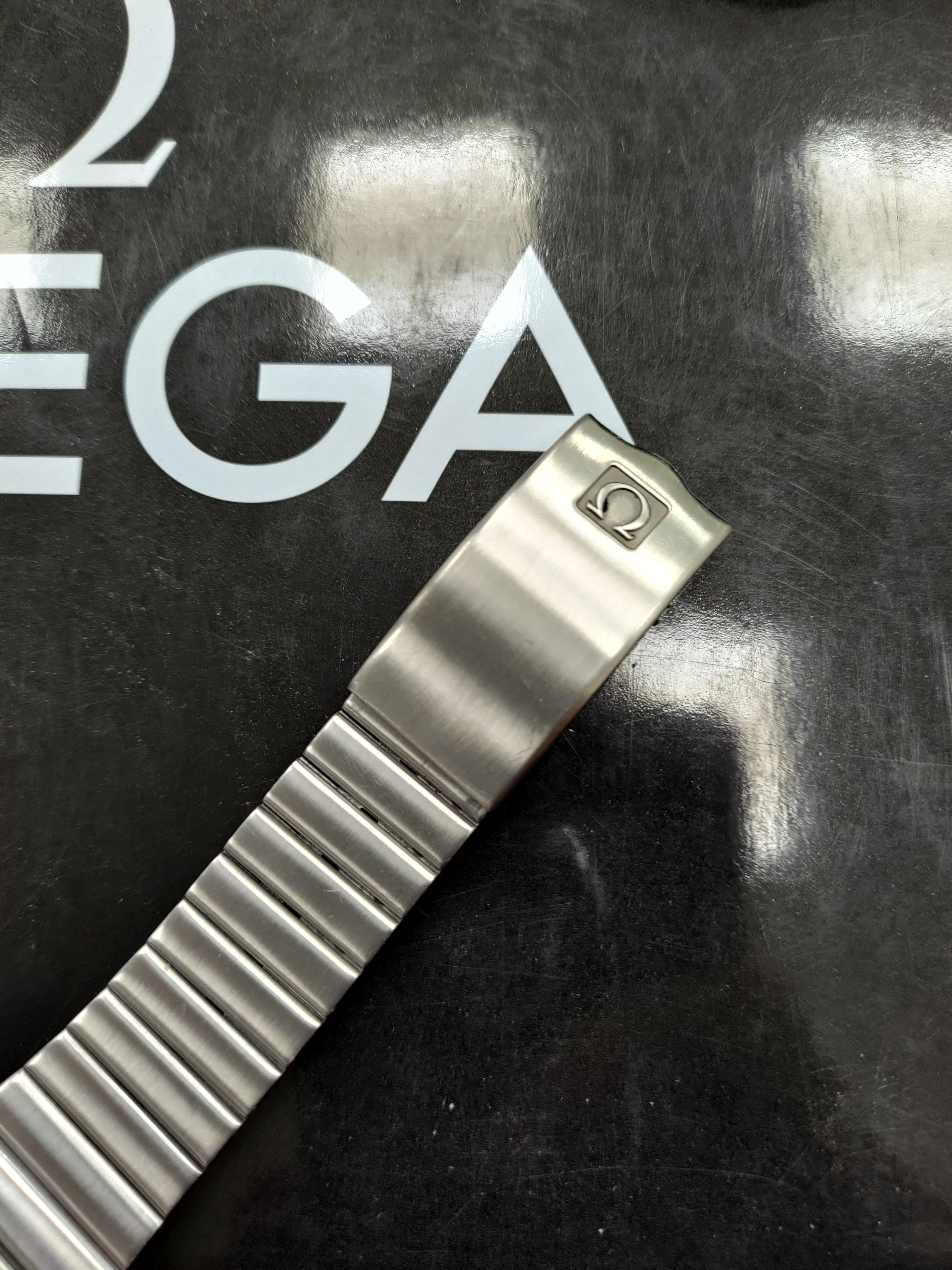

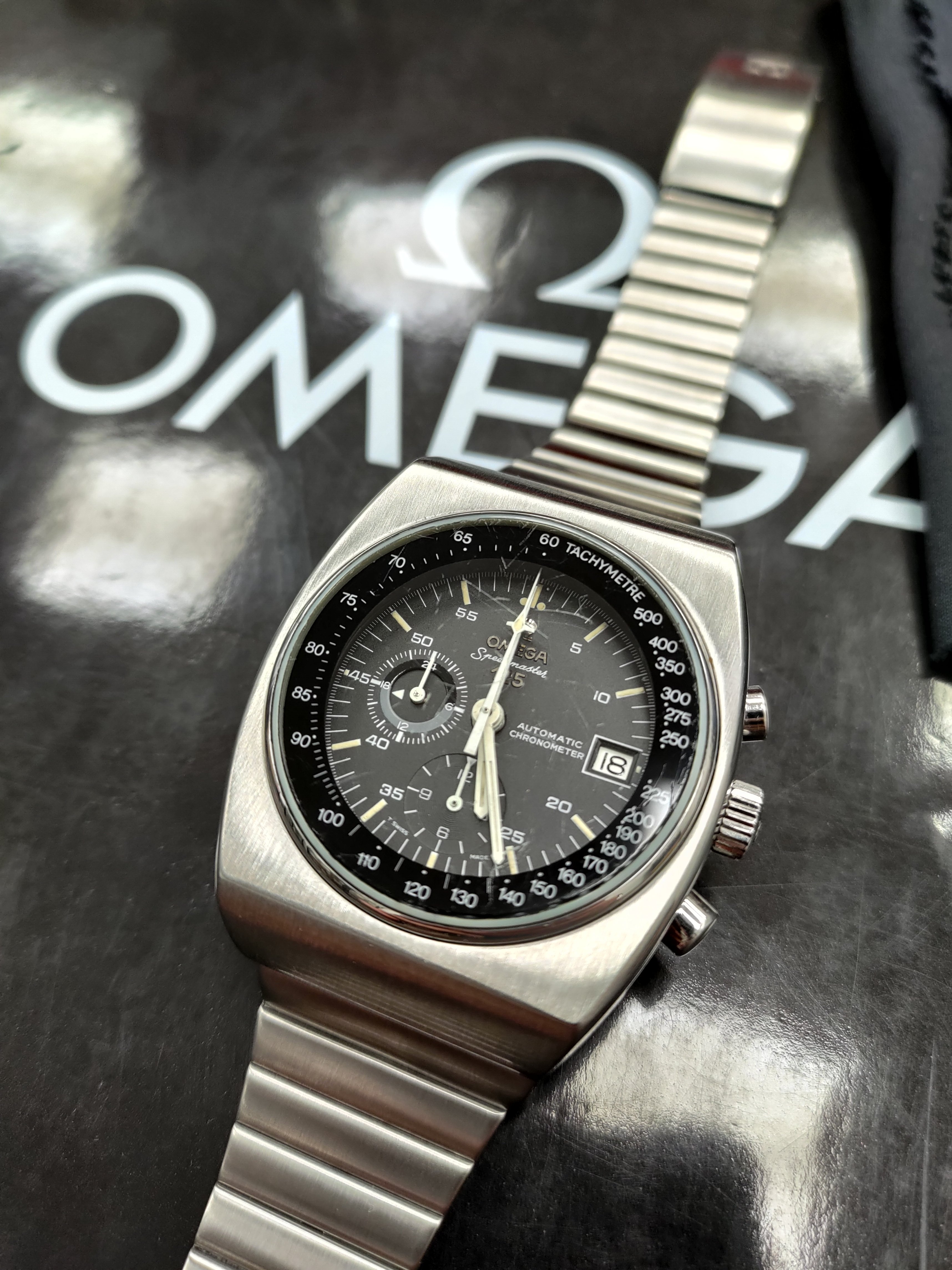

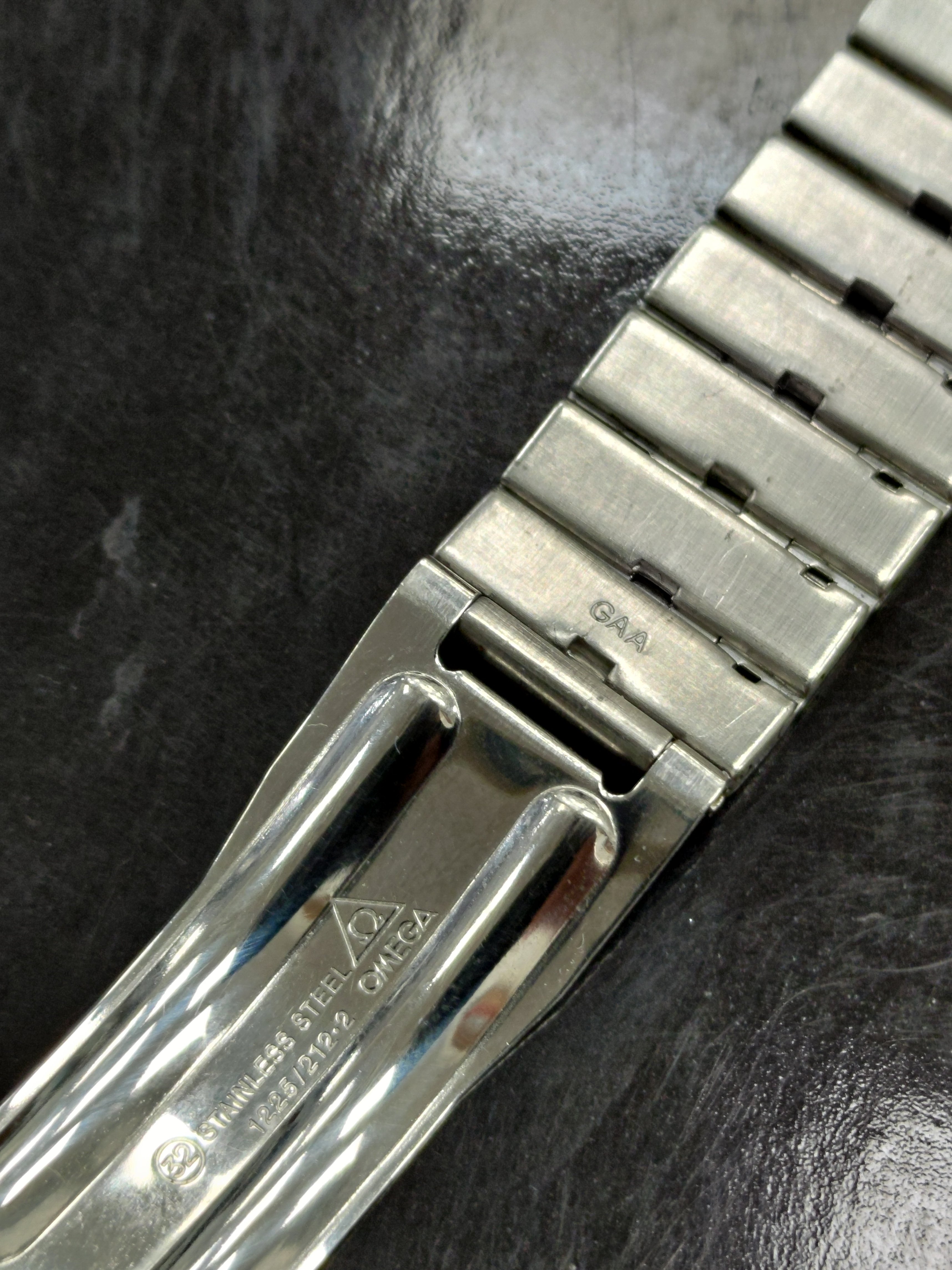

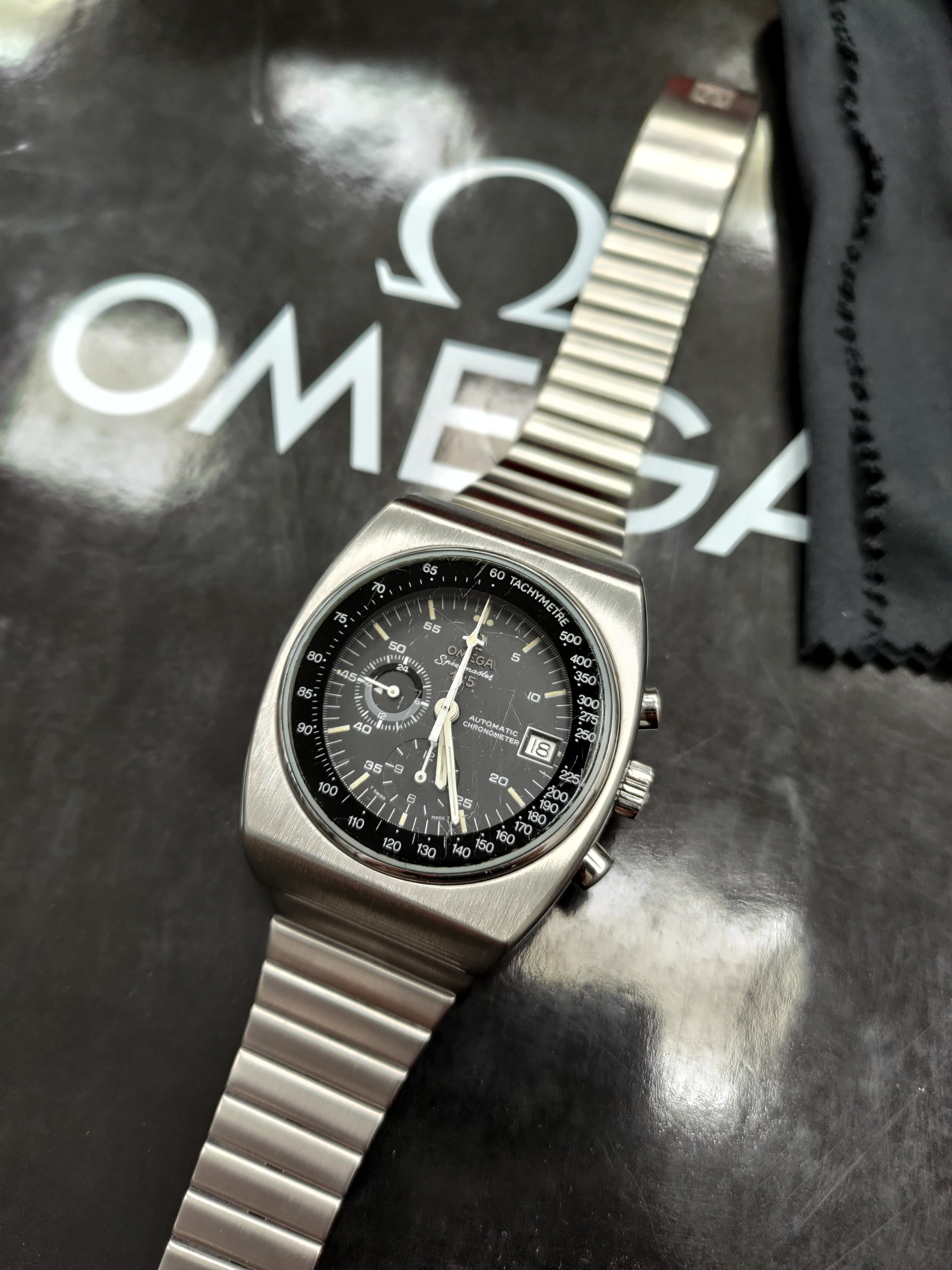

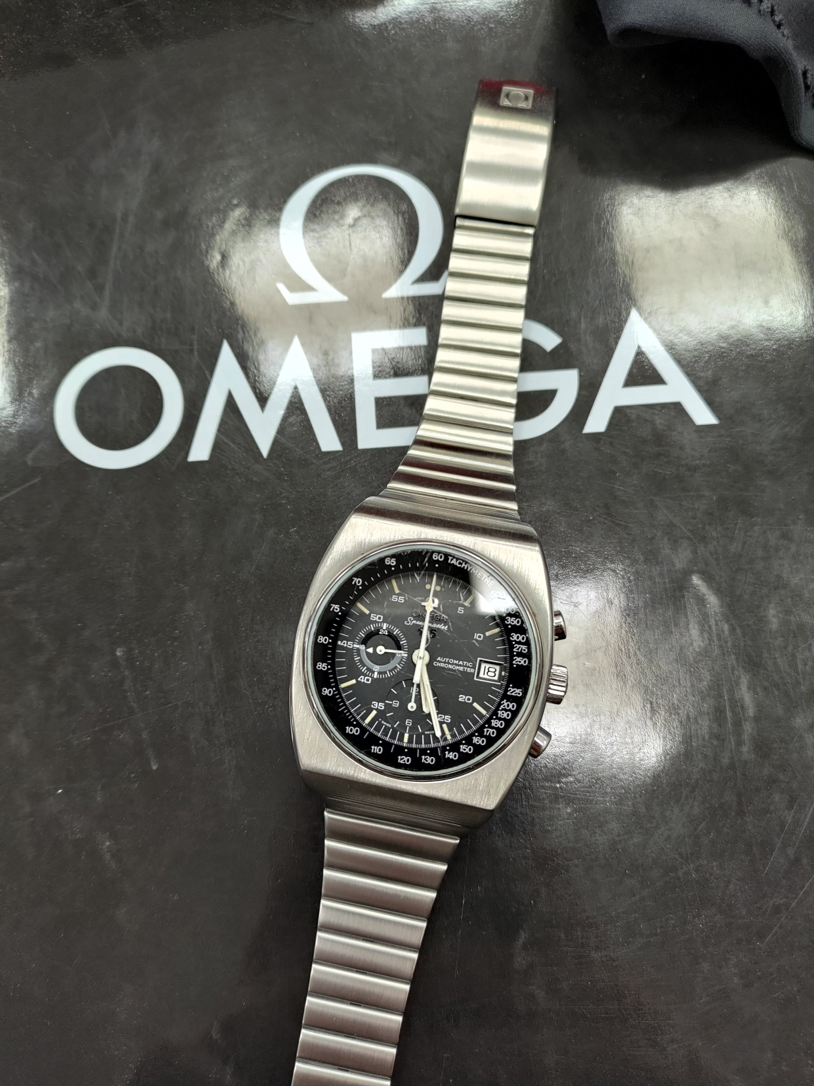

I wanted to ask you what do you think of this Omega Speedmaster 125, especially its bracelet? Usually they have more masive links, but I have found that it could be from the late production of this watch. I hope that photos are good enough, but in case it is hard to read, the bracelet number is 1225/212-2. Also do you think it is possible that this watch came with polished sides? I assume that they probably have been polished out at some point, but maybe it is somehow connected with different bracelet.

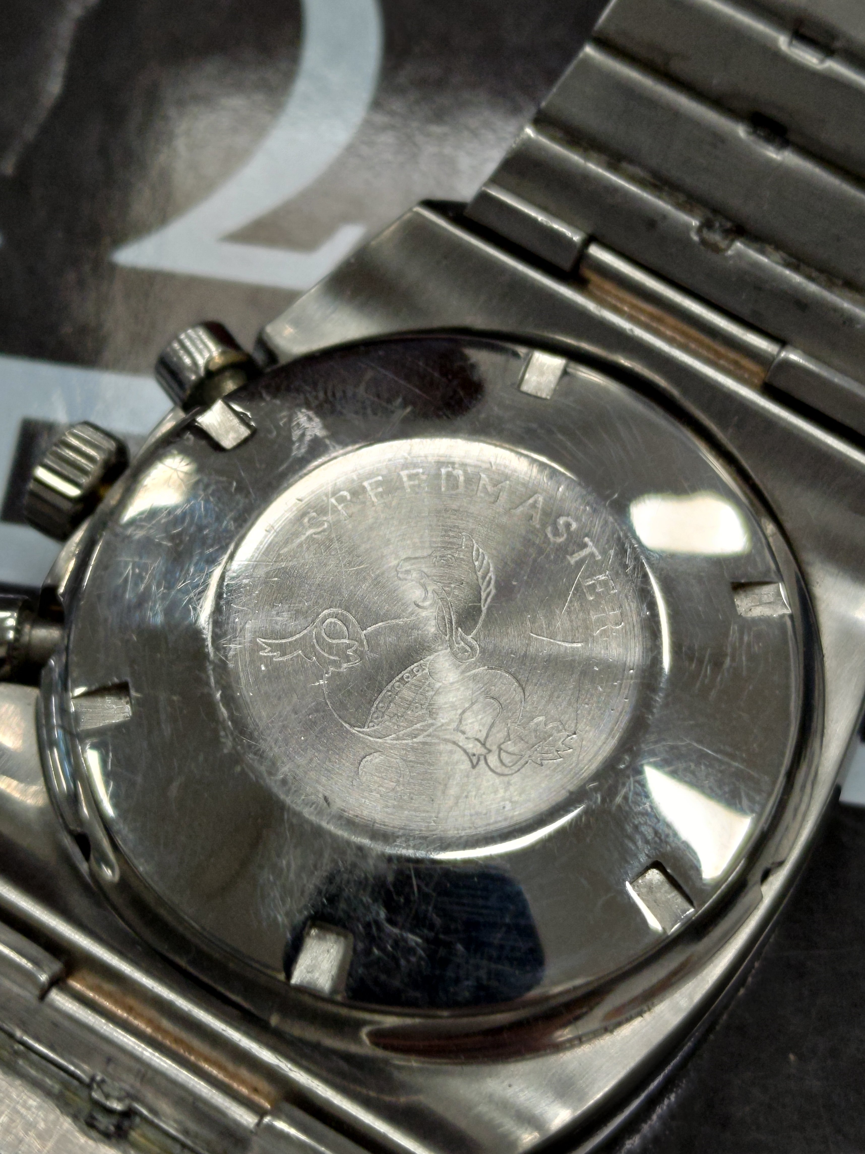

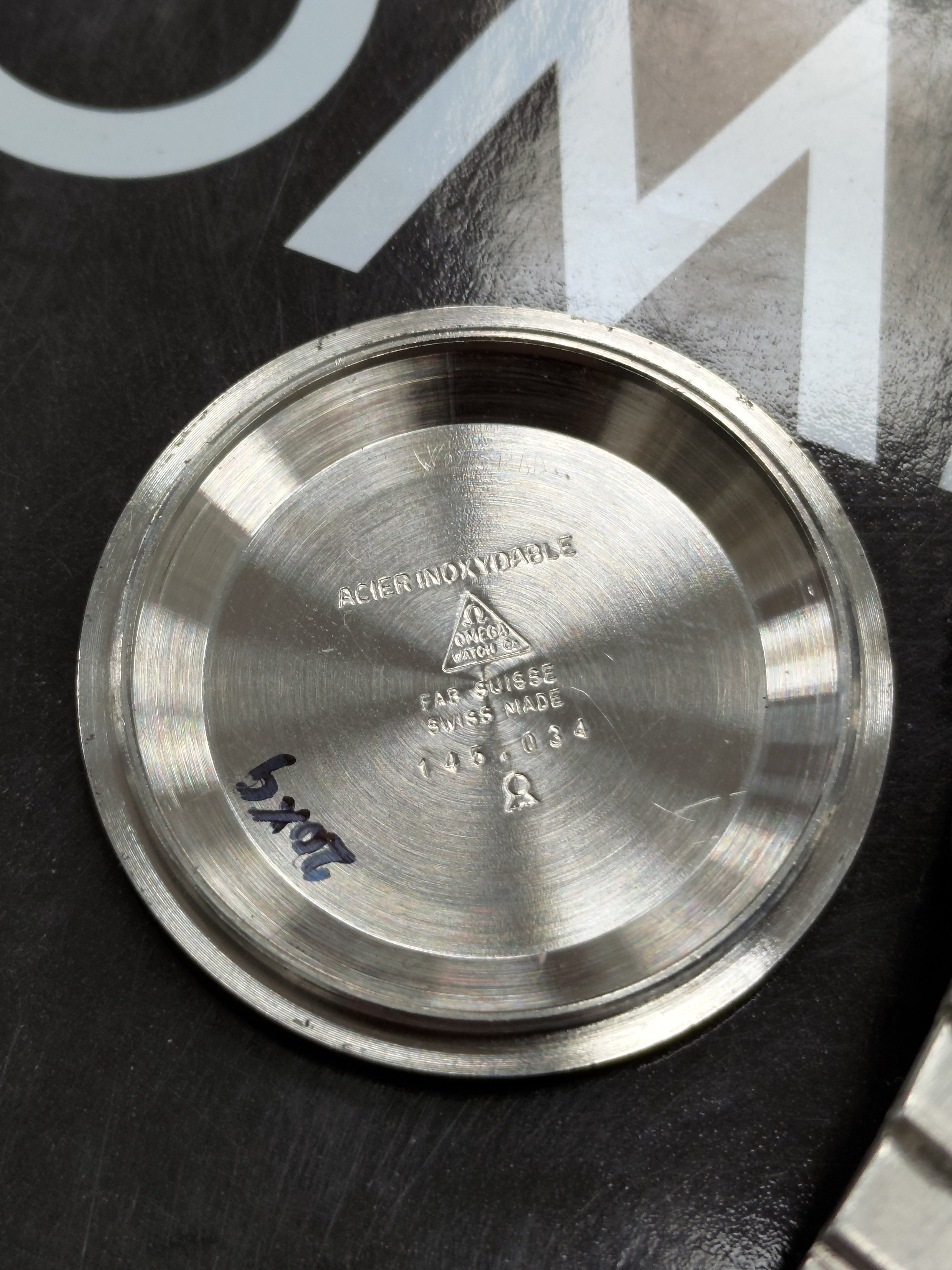

Wrong caseback. Wrong bracelet. Bit of a franken watch I think. Have you bought it?
I was not sure about this caseback too. But are you sure about this bracelet though? I have found someone saying this in the Internet:
"We have observed some models with another bracelet: the 1225/212. It came out very near the end of the Speedmaster 125’s production run and was used until relatively recently."
It is my friends watch, he wanted me to find some info.
2,059
22,210

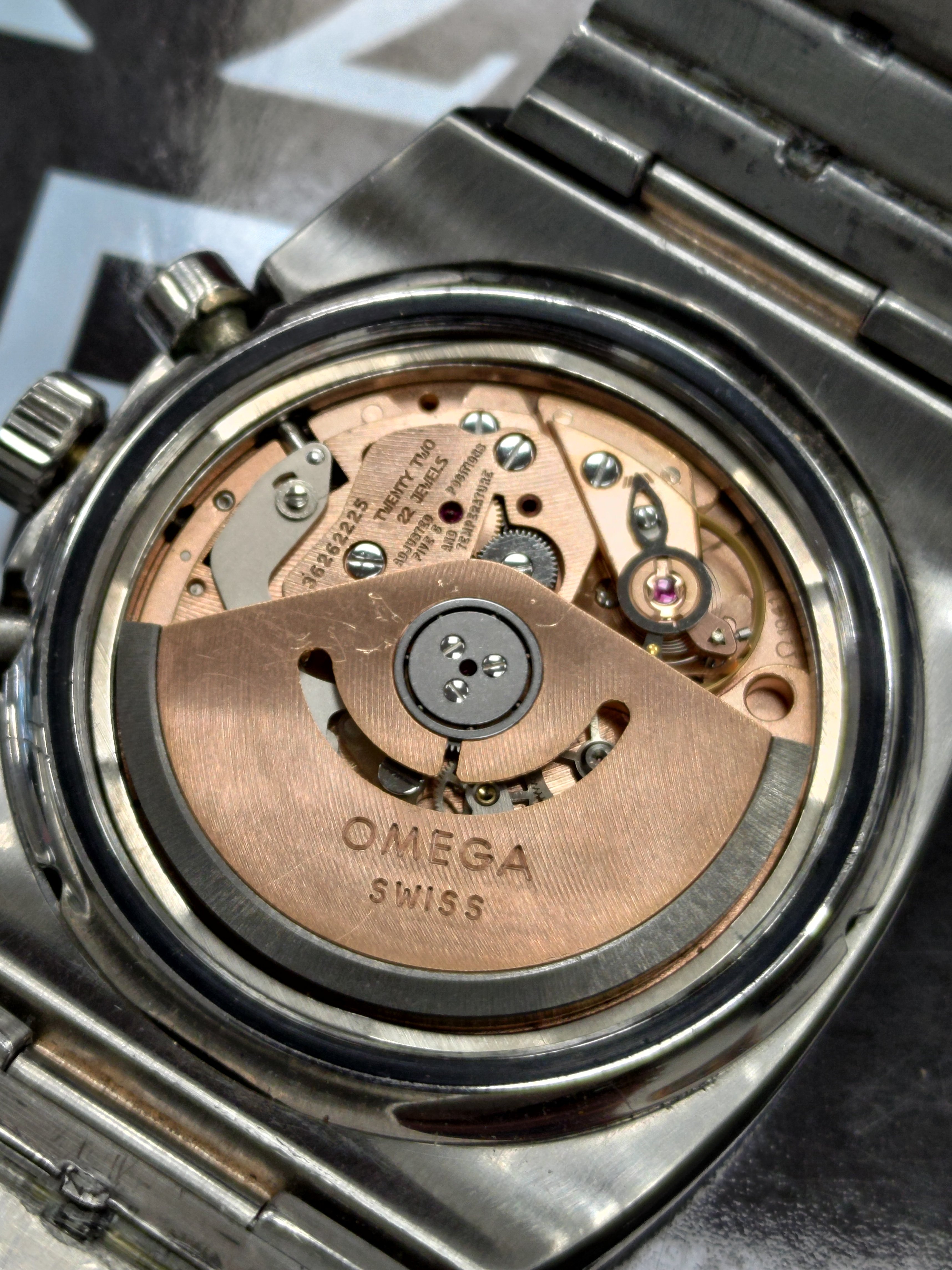

I know enough to know I don’t know enough….but wrong caseback sets lots of alarm bells ringing. On the plus side it is a 1041 movement - a lot of Frankenstein use the 1040. The crystal looks like it needs replacing. Case overpolished.
