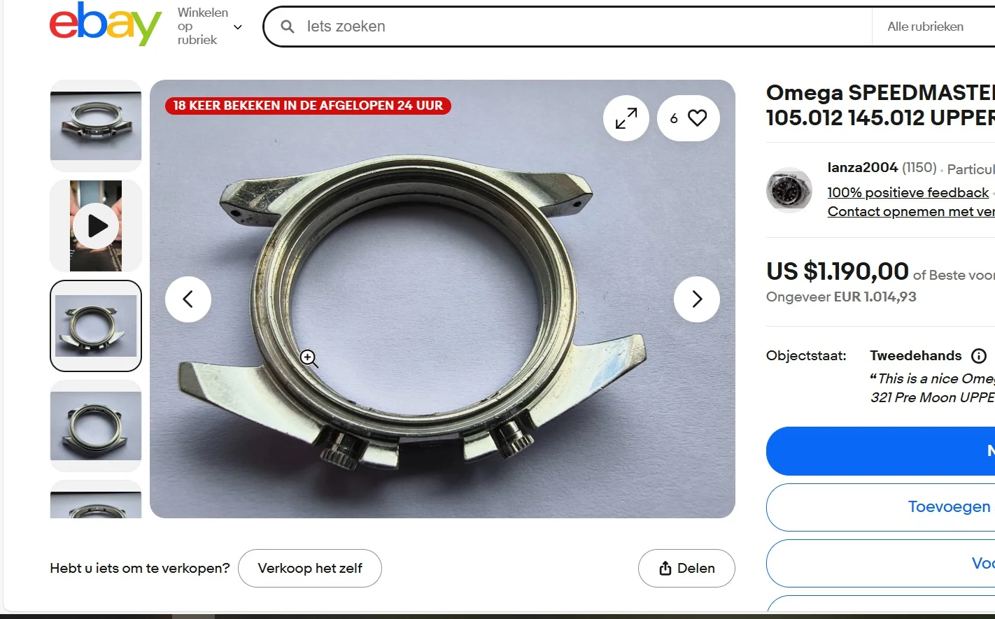

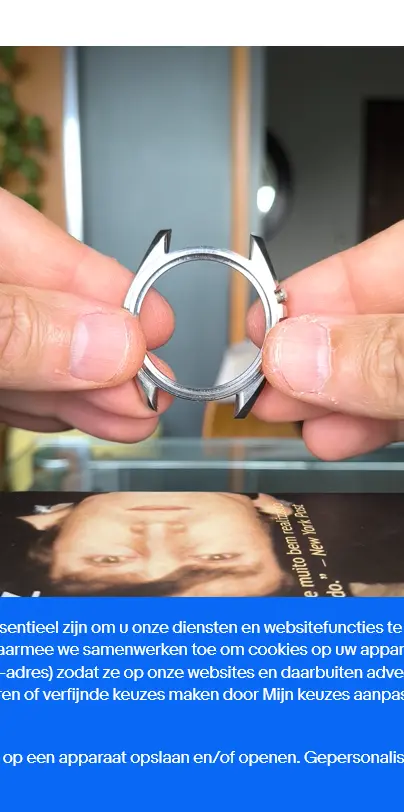

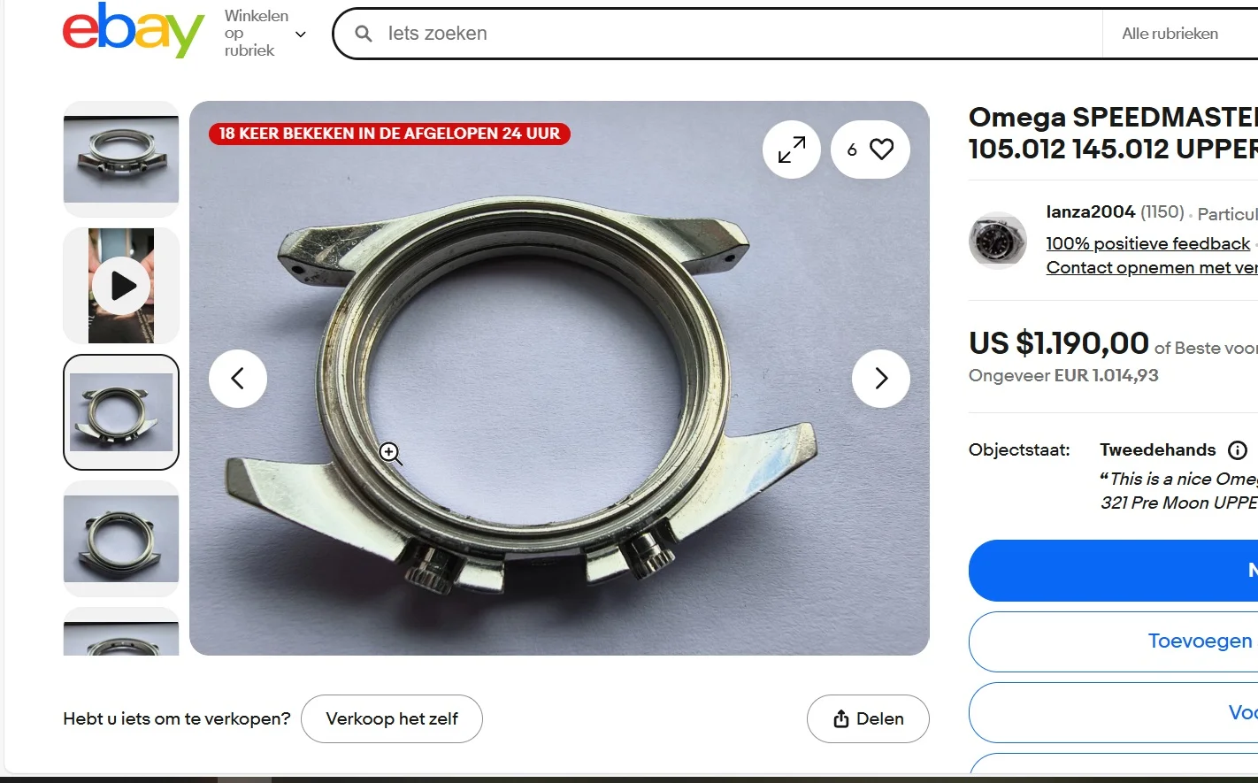

Omega Speedmaster 105.012 CB Case: Camera Angle or Damage?

That's really strange, got to be poor camera angle right??

Be careful if you鈥檙e considering buying a case like this. I bought a CB mid case last year from a South American seller and the threads were damaged (so no caseback would screw on) and the pusher tubes were glued in.
I don鈥檛 have very good photos, so I can鈥檛 confirm if it鈥檚 the same case

If we assume that it is just the camera angle, and as long as the threads are sound, does the case generally look ok otherwise?
792
845
Well, it鈥檚 a CB case with what appear to be screw in pushers (rather than press in). The case appears to have been converted at some point. Other than that, probably fine.
585
748

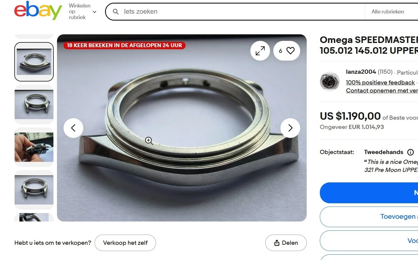

Right. I didn't even realize it was a CB! Is this one also a CB? https://ebay.us/m/FGAEsj
