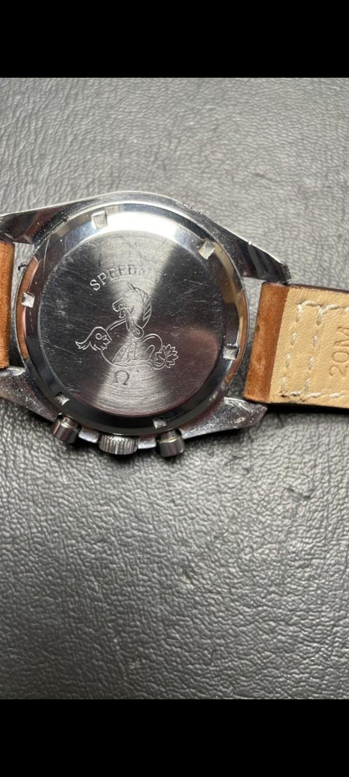

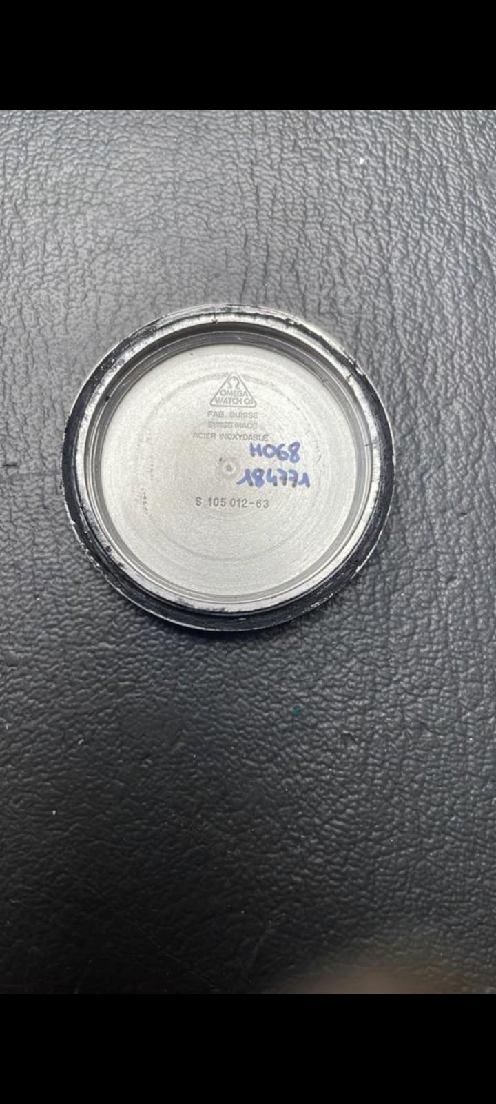

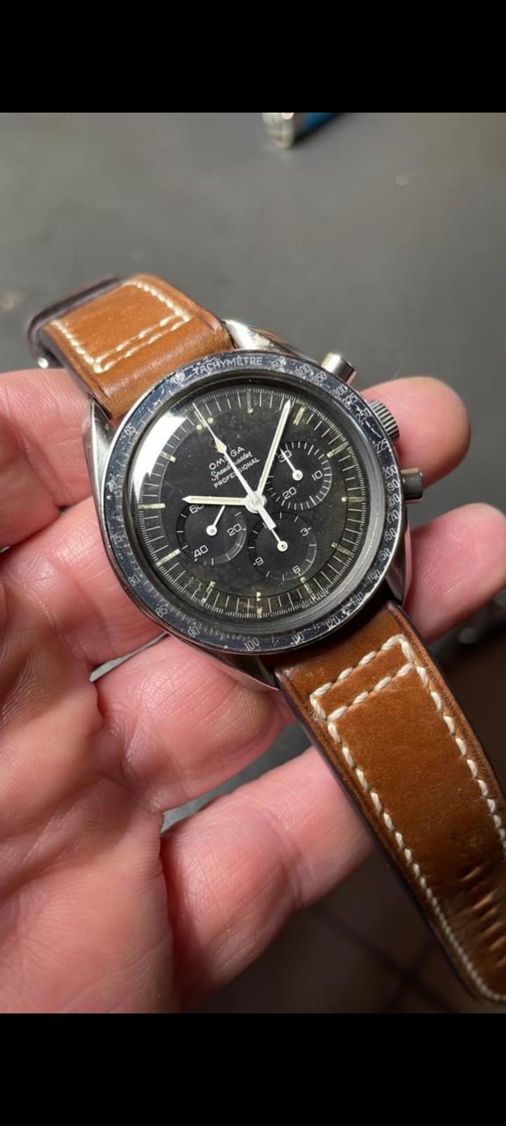

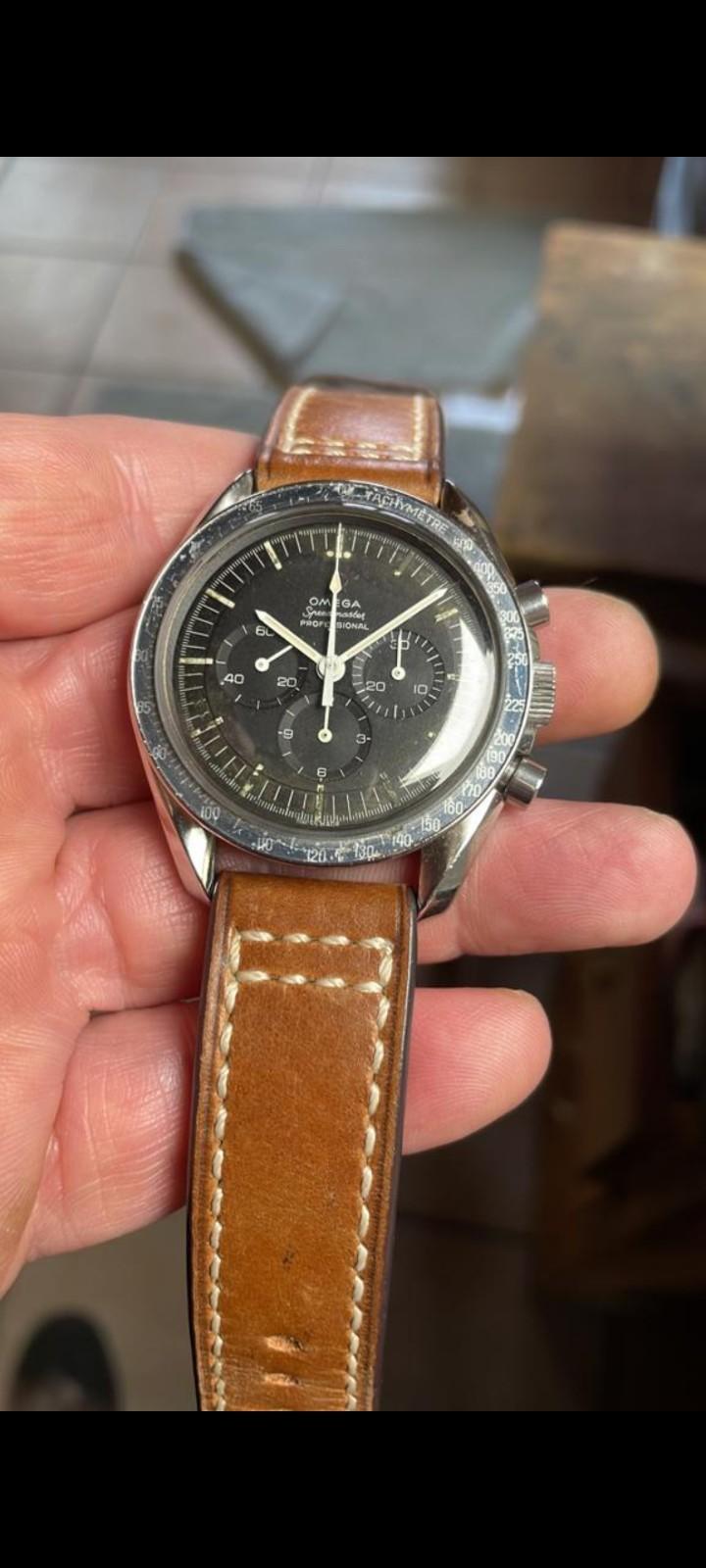

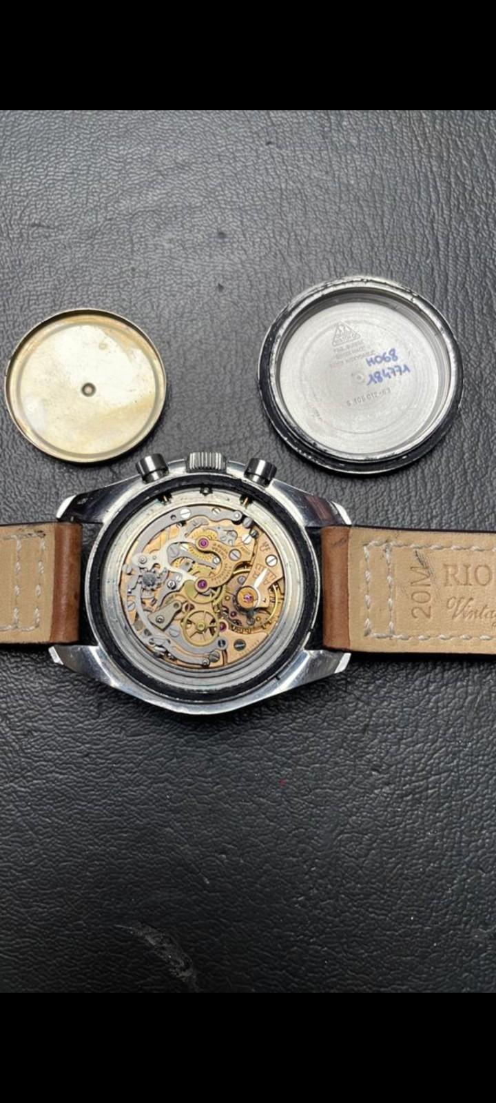

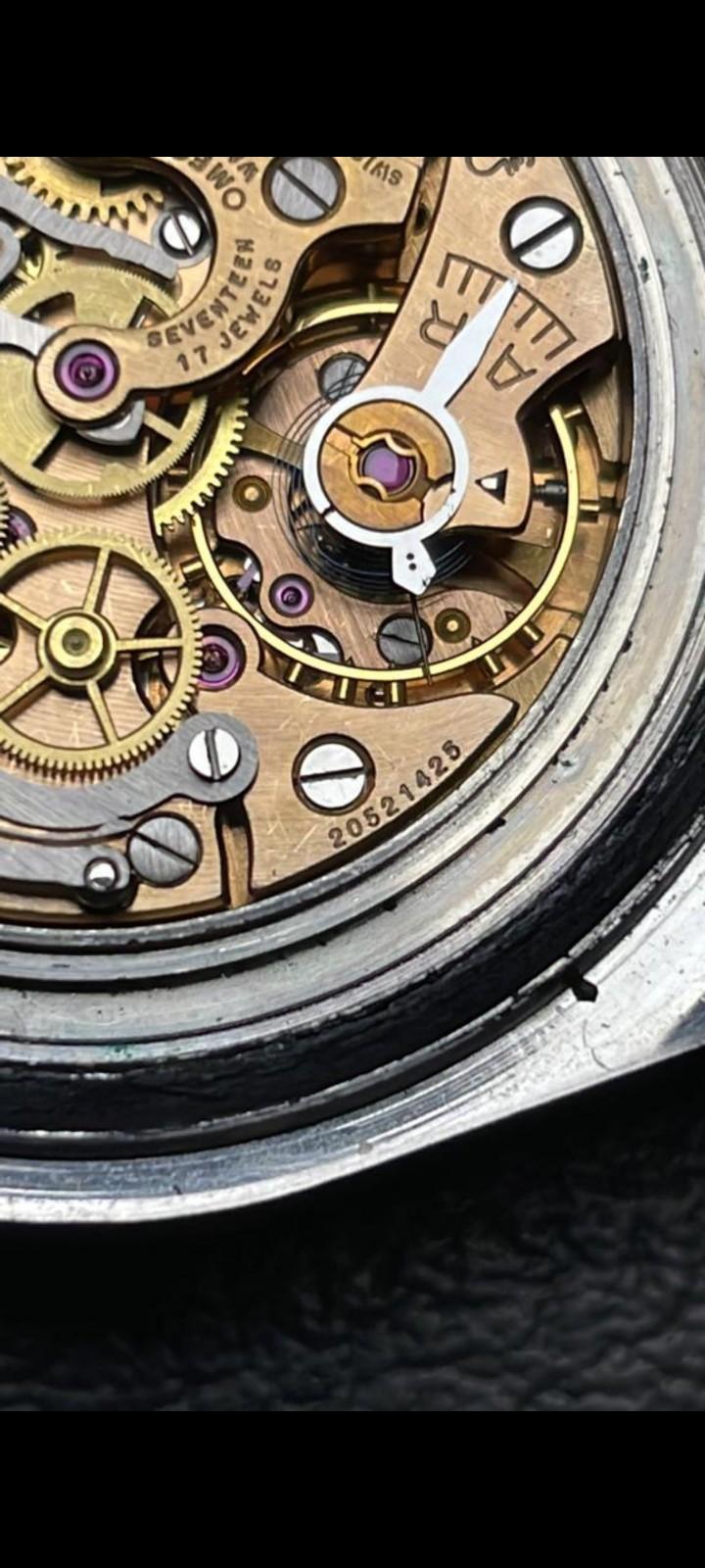

Hello,
I have this Omega Speedmaster 105.012-63 cal 321
Can you tell what parts might not be original?
Can you advice me on a realistic selling price?
Thanks

Looks largely correct with the exception of the hands.
Although it appears an early version without T’s the condition is poor so say $5-6k

No and No. Not with these pictures. And, just to let you know: This is a Collectors site. You do your research and come back with your findings. And : This here is not a free valuation site. Check the usual selling platforms . In the end , the Market decides. Or you could reset your post and start again: " My name is : .... I'm in ..... ( insert country here ). I have this watch and I have researched high and low and here are my findings about the Speedy, I want to sell : .... I'd like your help and your valuable time to get the maximum Sale Price. " Resume with some pleasantries.....

The chrono hand is definitively wrong, probably the crown is also a later version.
Pusher seem to be ok.
Better picture certainly would help!
To be 100% sure I would request an abstract from the archive...
