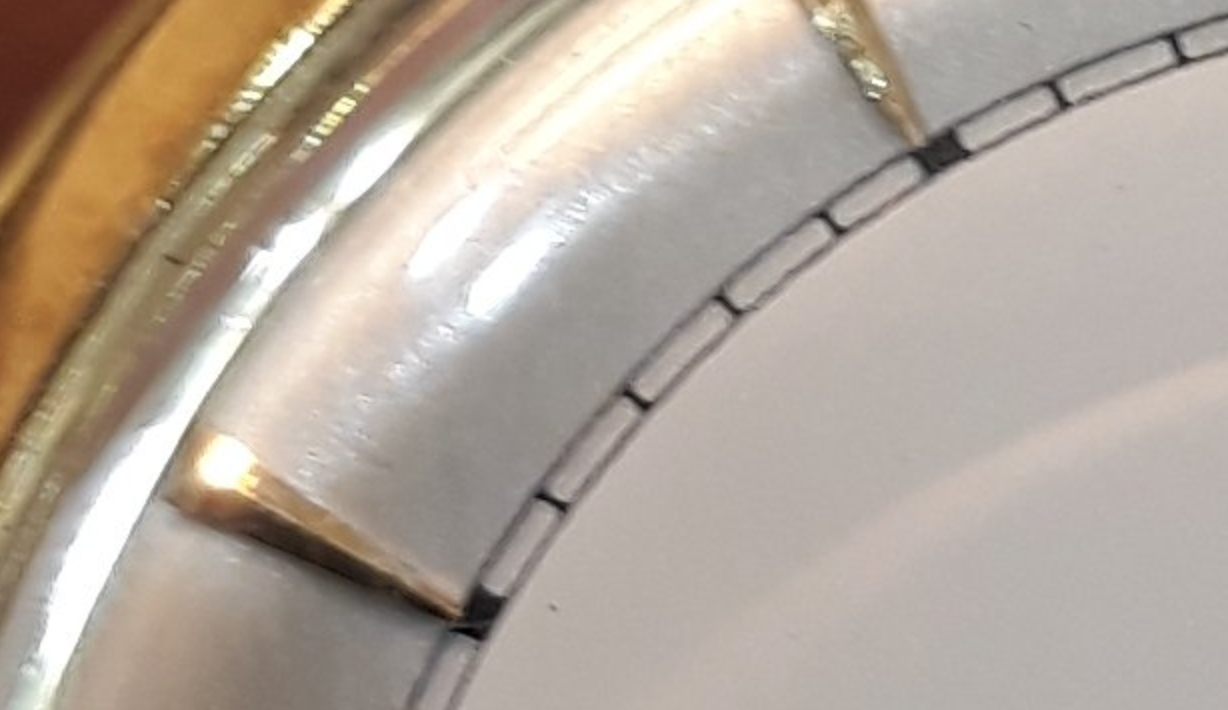

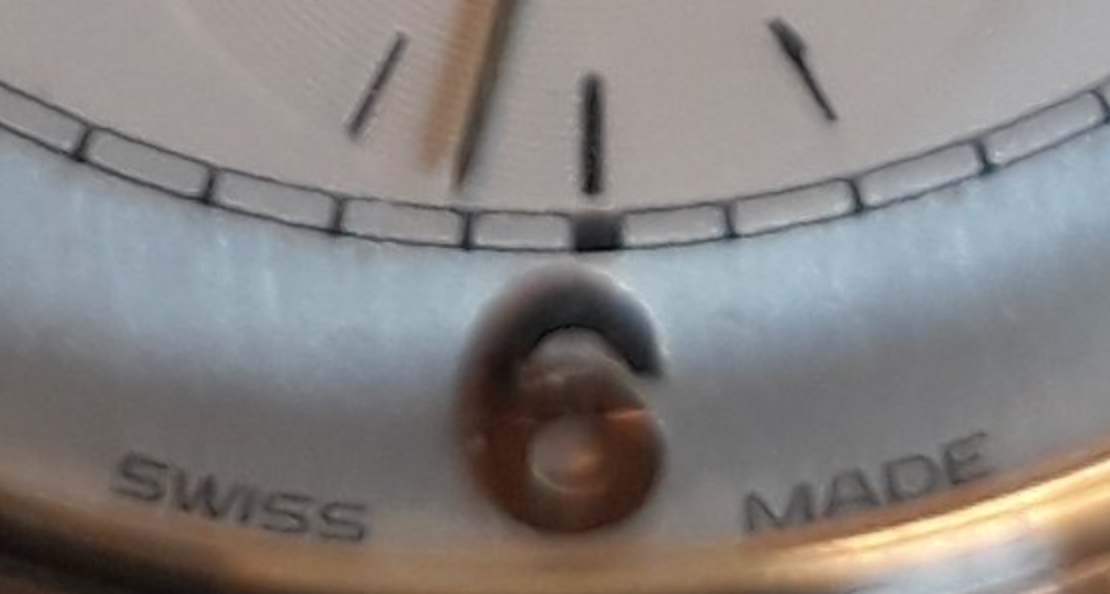

I need help about this small second 18kt gold watch is the dail original or reprinted?

I would say redial.
Look at how the track doesn't quite line up with the indices and how the number six sits to the left of the black marker. Also, the sub second hand seems too long, going out of the seconds dial.

You are right and you mentioned good points at it thanks for info 👍 do you know how much is it cost if i buy it or I have to ignore it?

These models aren't really my strong side so I can't say what a reasonable price would be. Whether you can live with it or not comes down to your taste. Personally I think it is quite a bad redial and would notice it every time I look at the watch. Especially at six o'clock it is very obvious. Therefore I would personally keep looking. How much is the seller asking?

You deleted your comment and then made a new, hence my reply is higher in the thread. I wrote that I would most definitely pass at that price. I think that you can find a much better example in 18k for that kind of money.

Ok I ignored this watch and thanks for information otherwise my €1200 would gone for a re-dial wacht 👍
