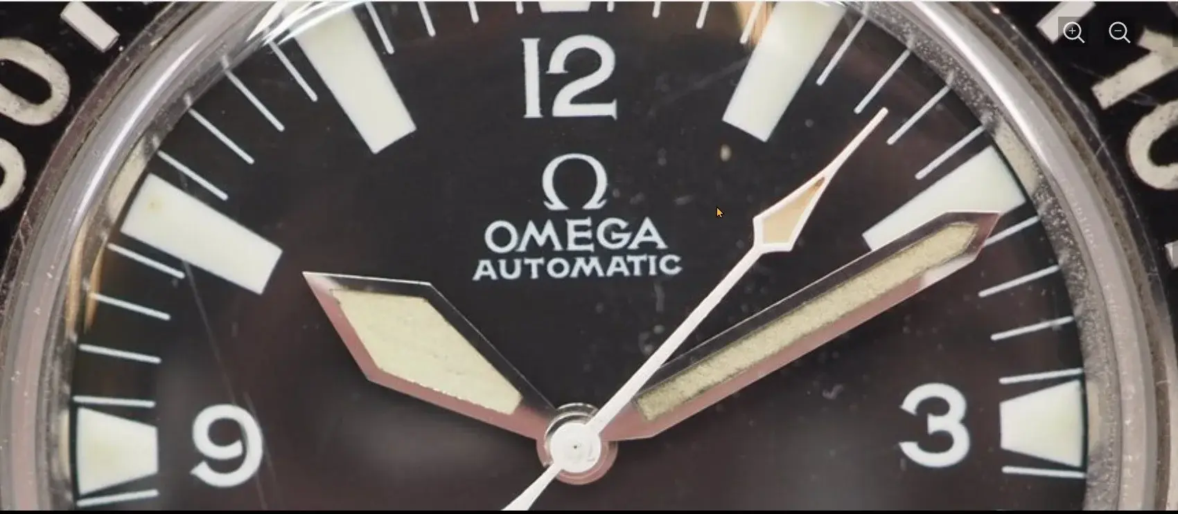

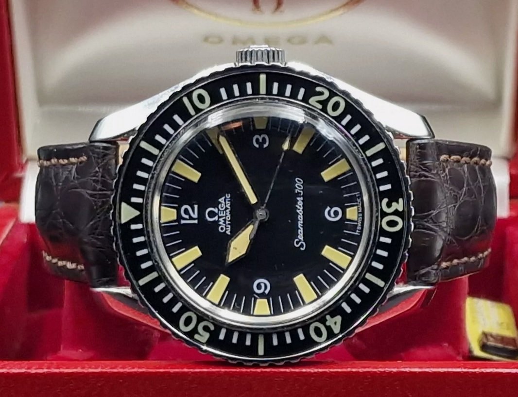

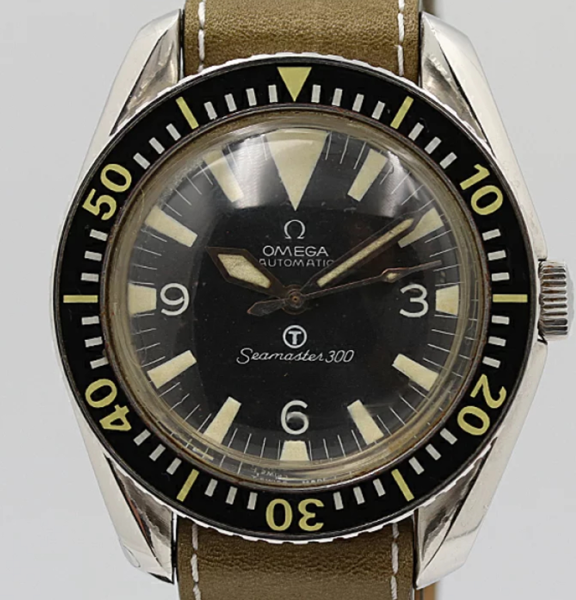

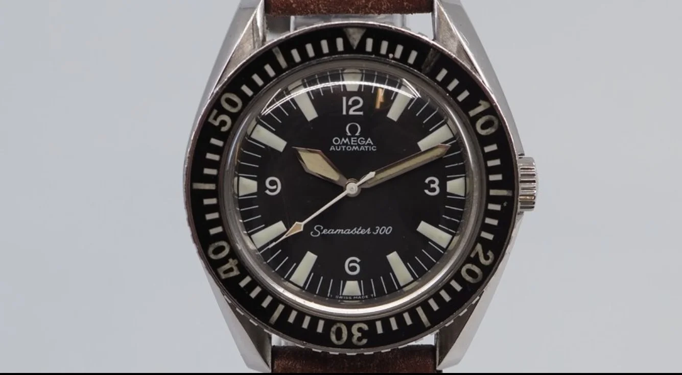

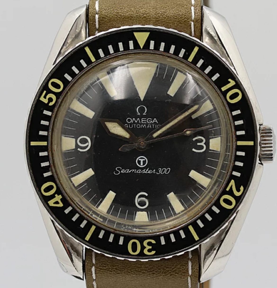

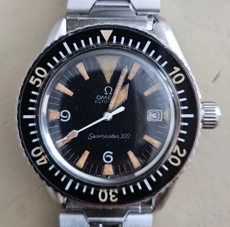

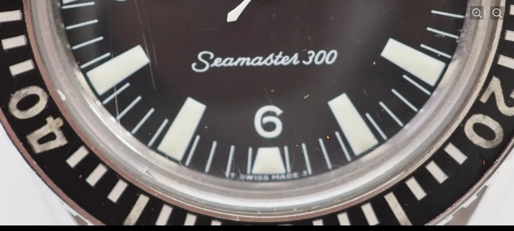

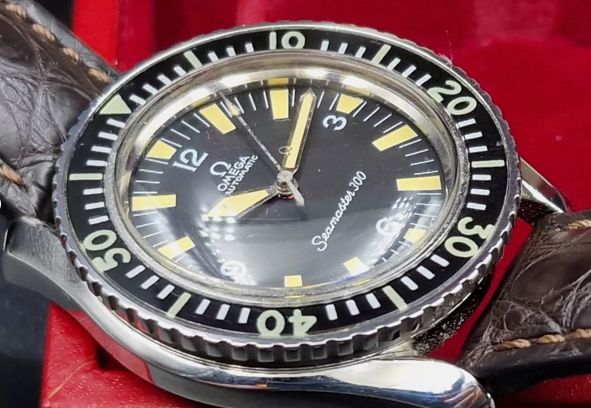

I’ve been eyeing a SM300 for some time but need some help to verify if it’s fake or not.
Thank you for your help.

That said, yes, the watch is fake.
1,835
3,583

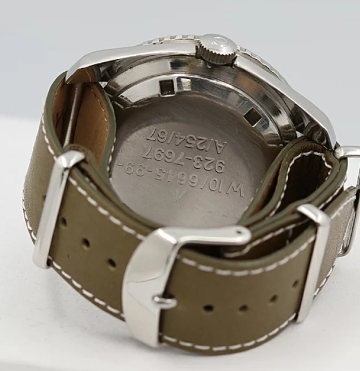

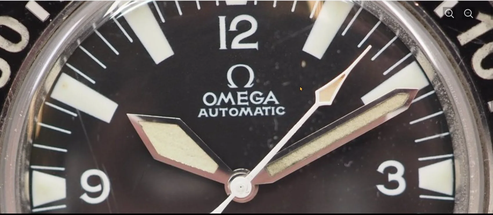

I'm curious as to what the tells are that this watch is a fake. The crown definitely looks like a more recent replacement. Apart from that, I can't tell. Can someone school me please? Thanks in advance for your responses.

I would try a PM to the 300 experts, otherwise the fake makers gain knowledge.

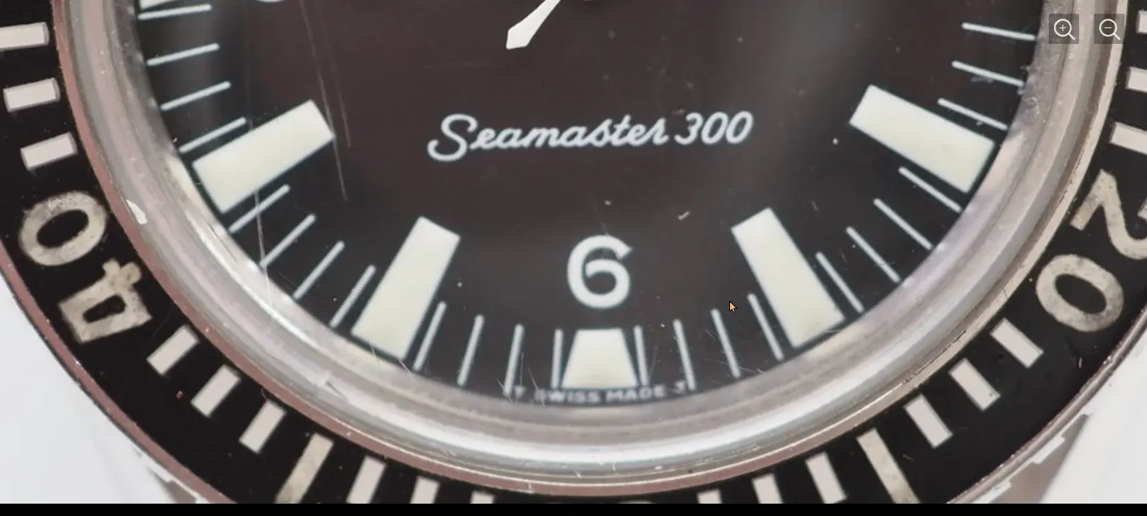

This is an older fake with one of the easiest tells. The more recent ones have already moved beyond this so I don’t see any great threat in discussing it. As noted above by calalum (but mangled by spellcheck) the tell is called stubbies. Take a close look at the lume block. Note how the white minute index is just visible outside the block. That’s a stubby and is only seen on fakes. There are several other tells here too. It’s not one that will fool many after a bit of study. Extra care should be taken with examples like this that purport to be military issue.
18,847
39,197
Thank you for sharing this information. I have googled some SM300s and was able to spot the ones with stubbies. So at least I have learnt one 'tell', albeit one that is out of date with new fakes.
I do get why the experienced members get irritated by so many 'Seamaster 300 - Is it fake?' threads. They turn up so often it must be infuriating. I also get that the SM300 is a reference newbies should stay well clear of.

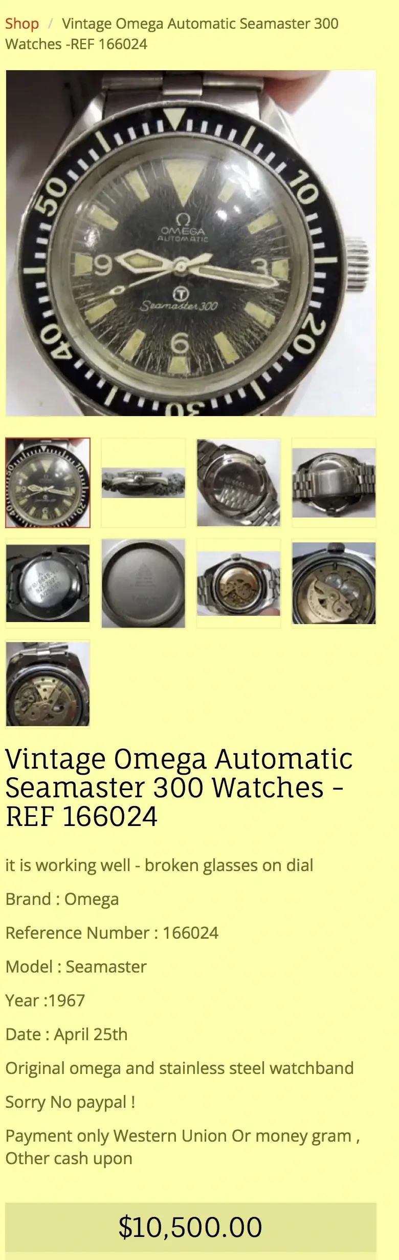

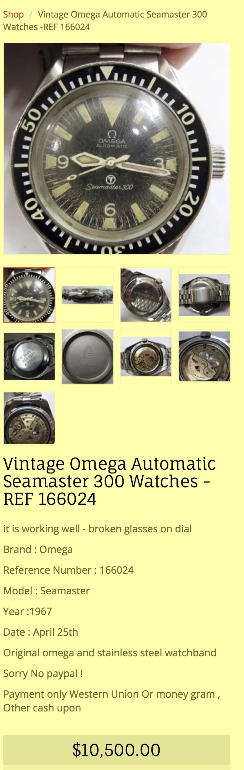

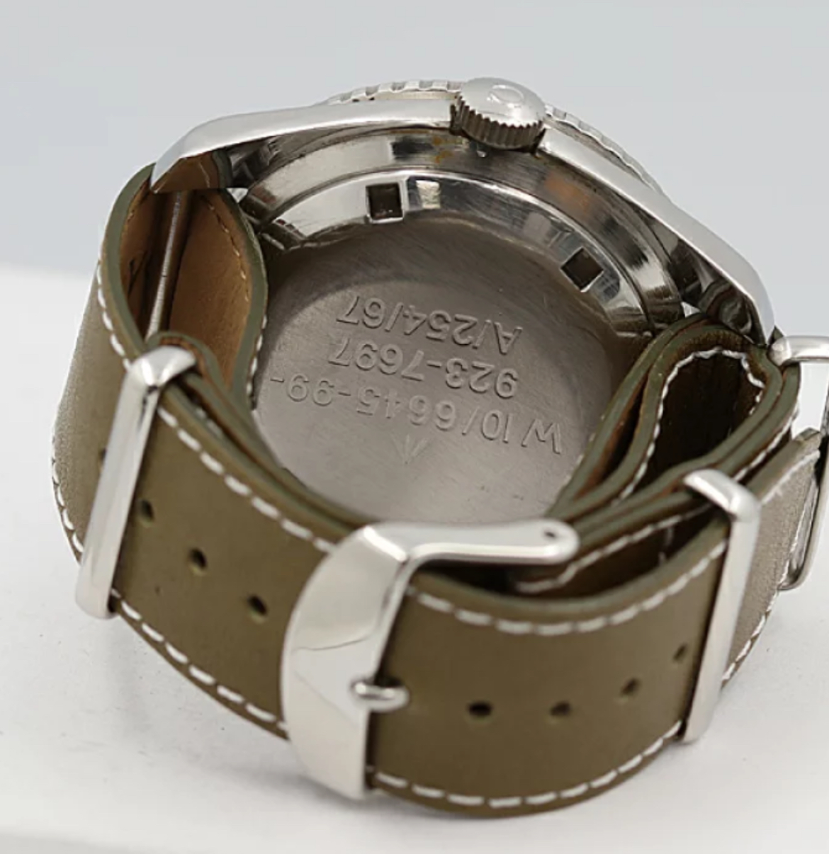

These look like dealer photos, who's the seller?
Fake milspec SM300 is punchy, are they pricing it as such? 10k plus? Or is it at a price too good to be true? What made you pick this one?
712
2,600
Too good to be true. Think we can all agree there are no good cheap SM300s. I've been looking for a few years. Don't bother any more. Too many dodgy ones, and good ones are too much for what I think they offer.

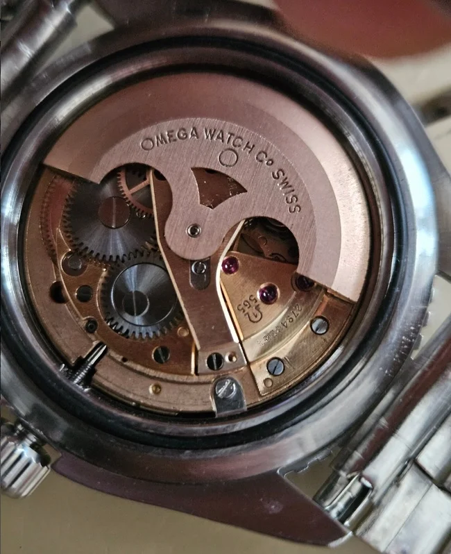

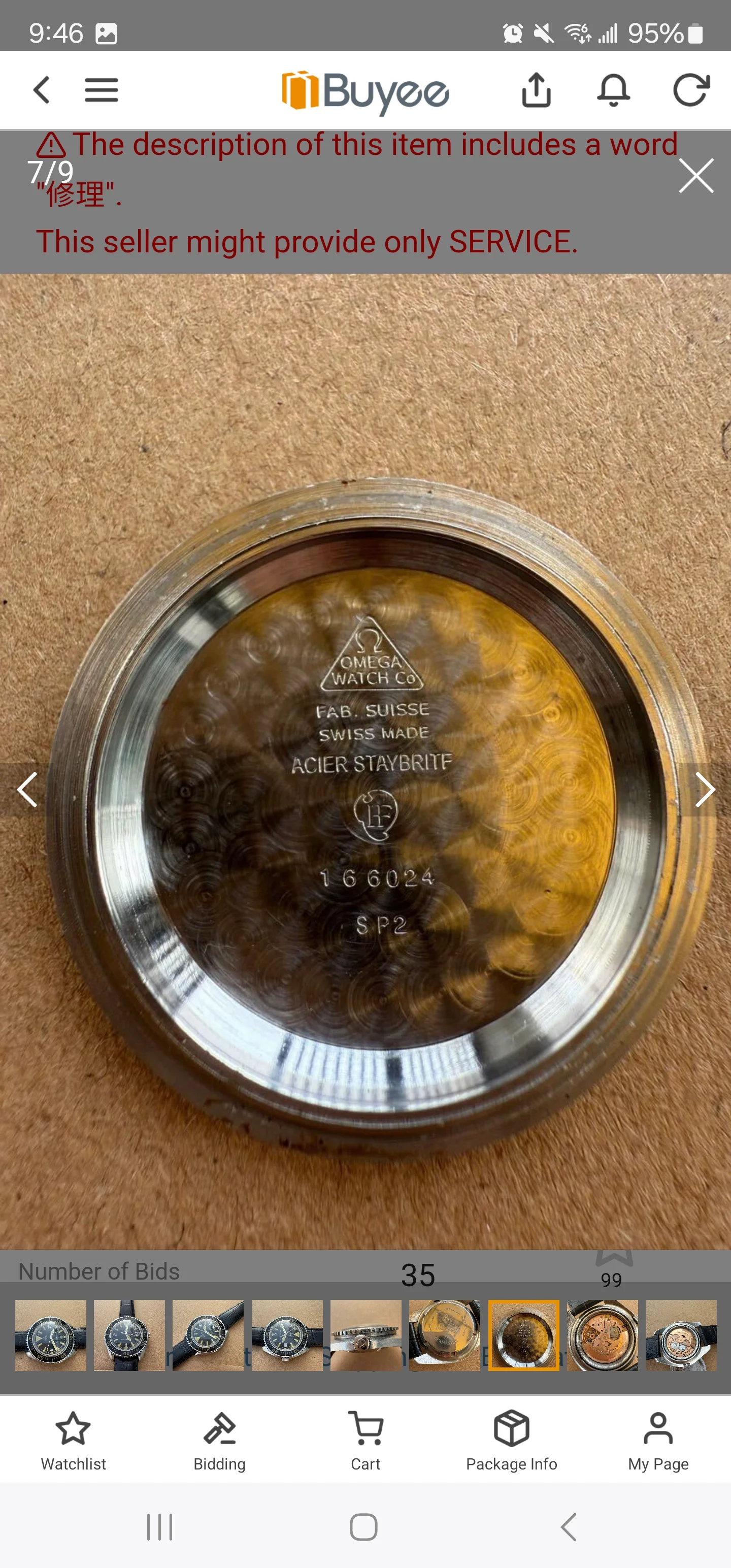

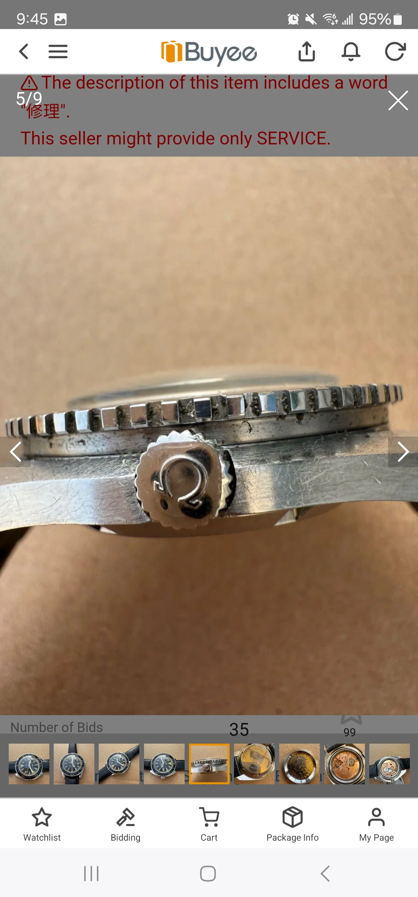

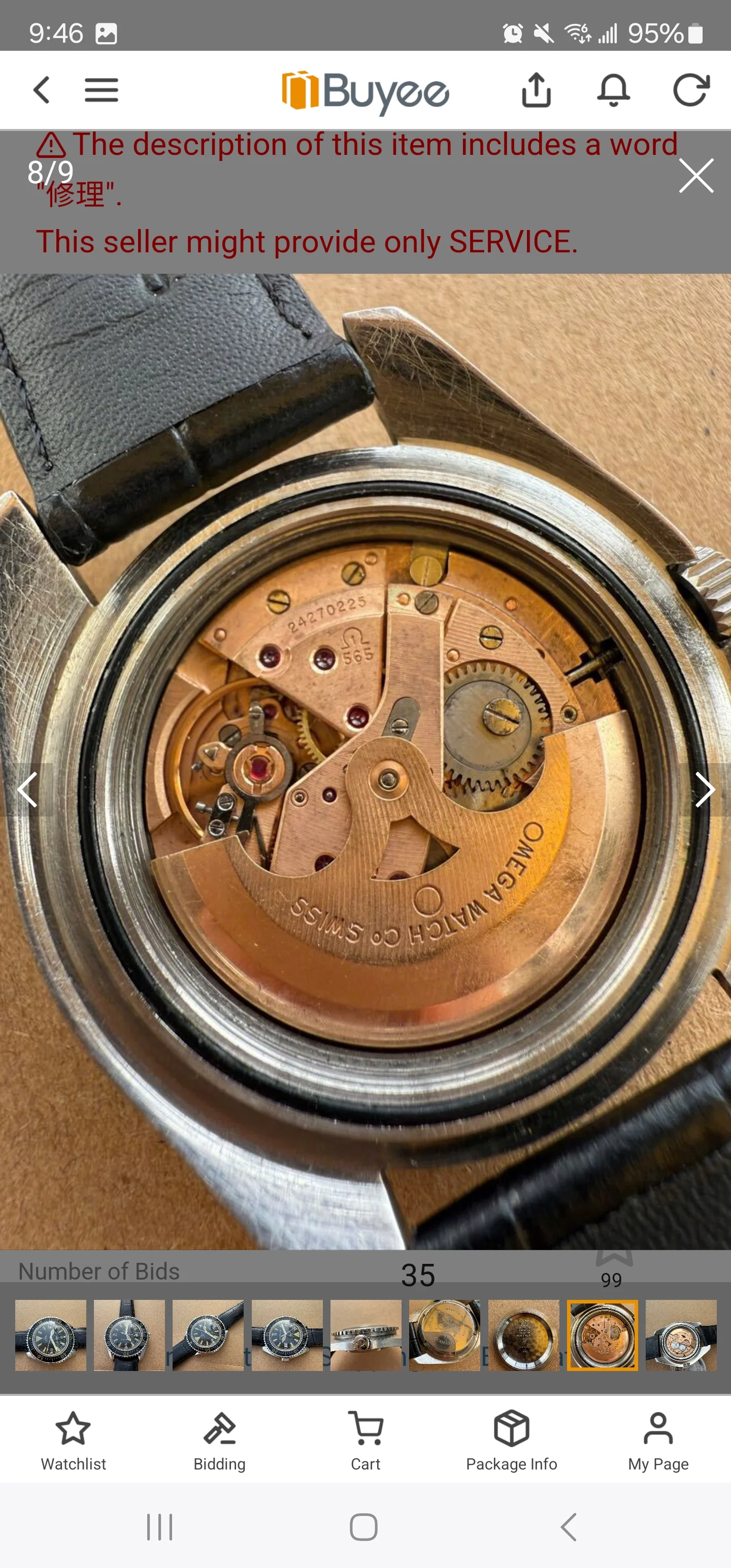

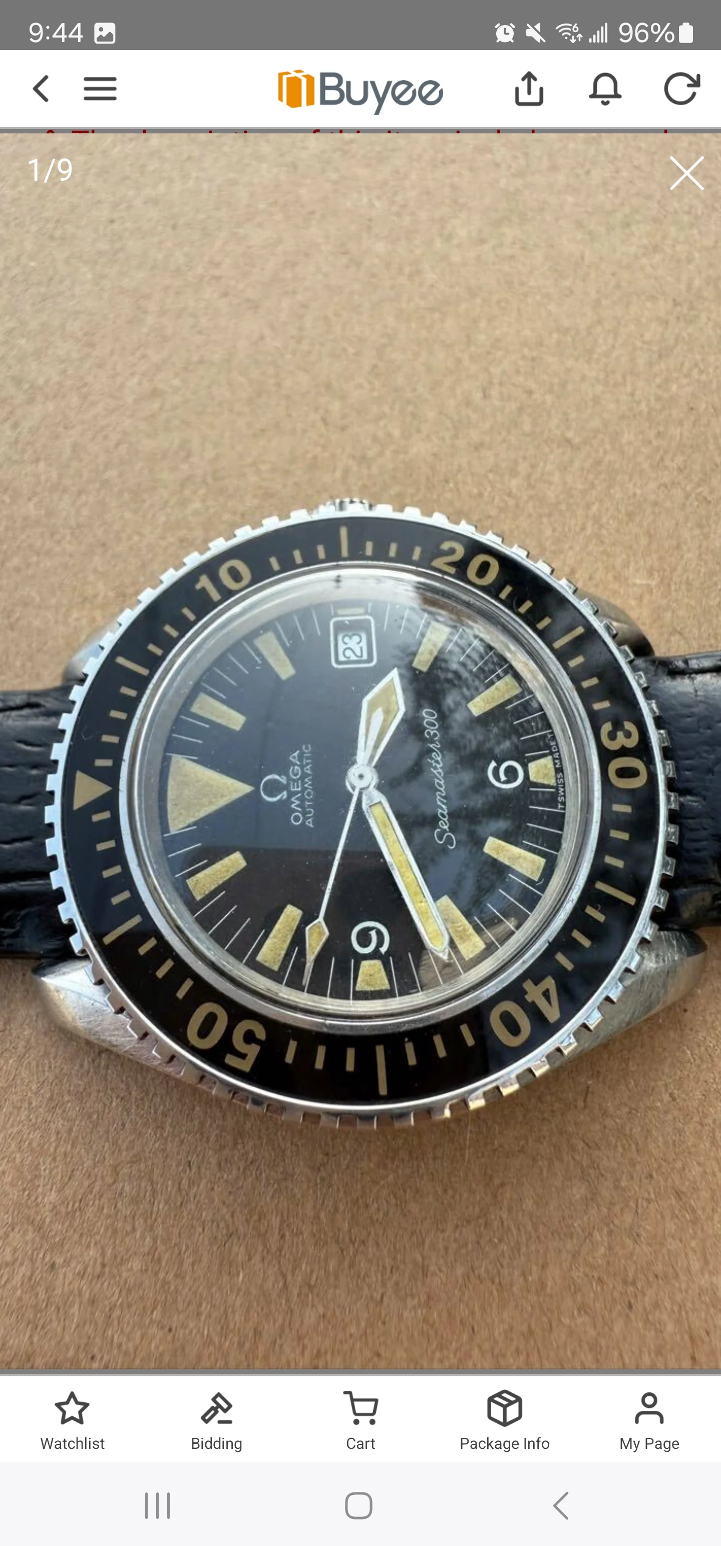

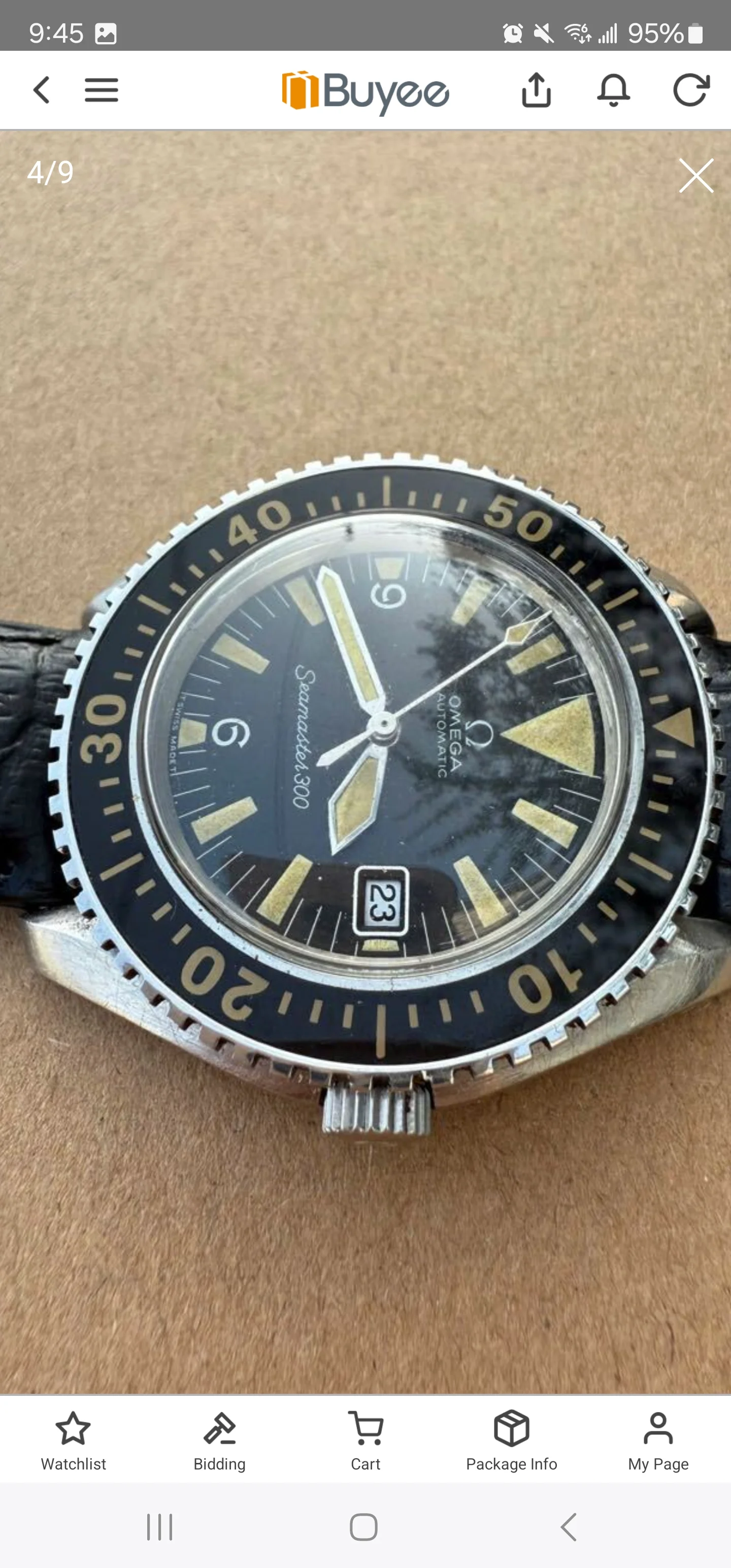

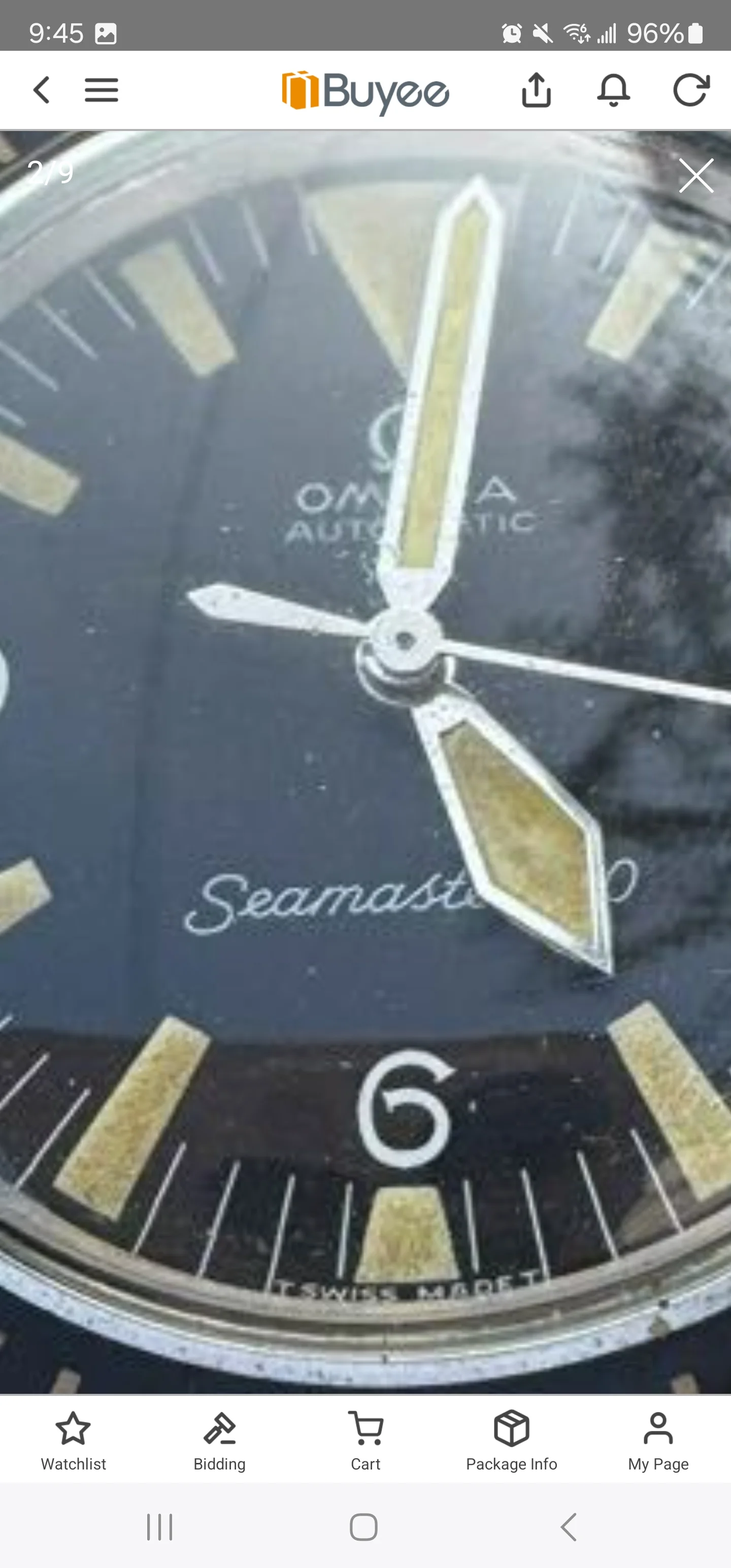

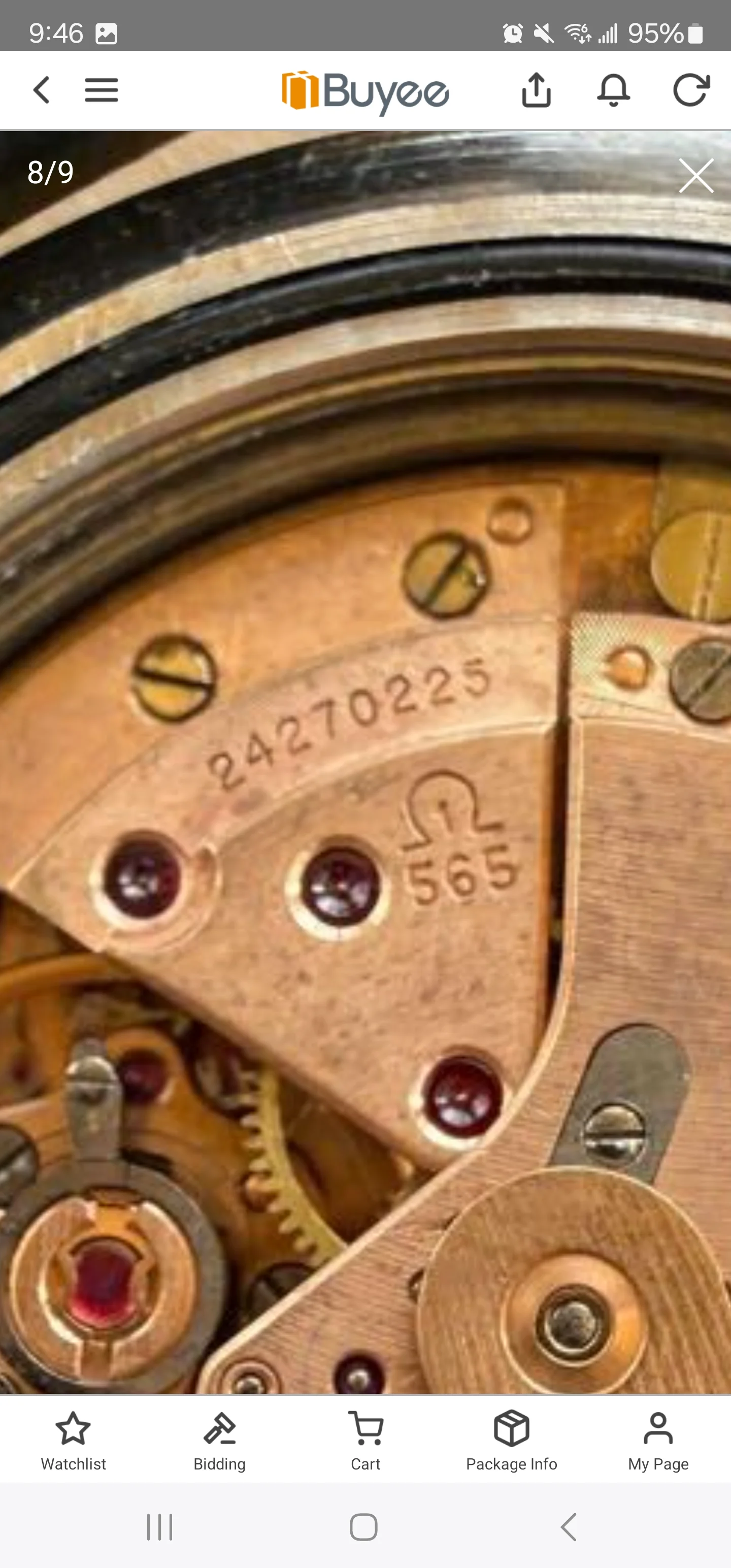

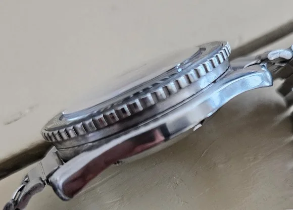

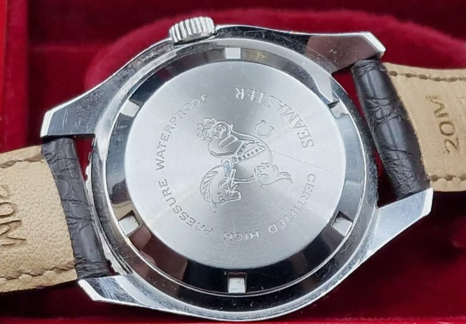

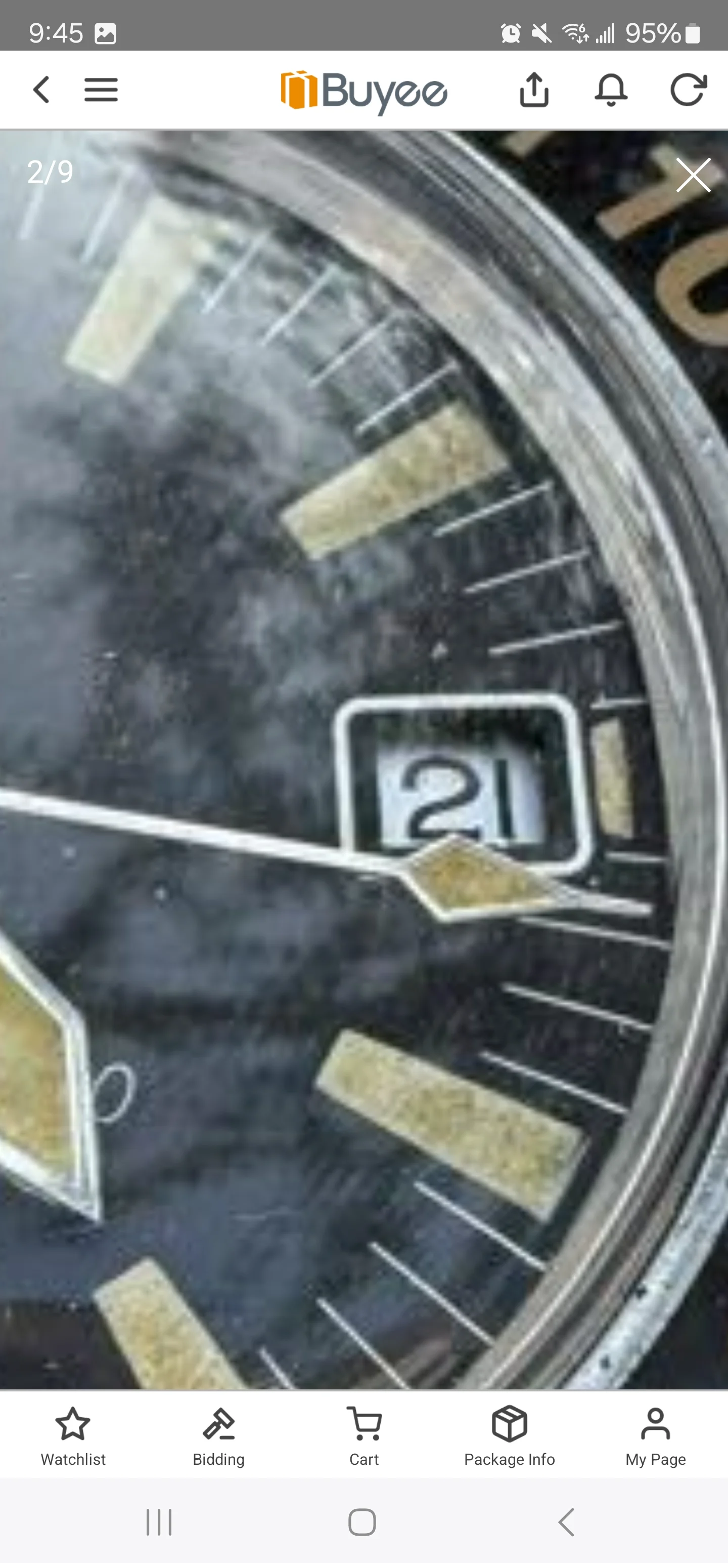

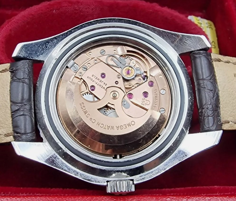

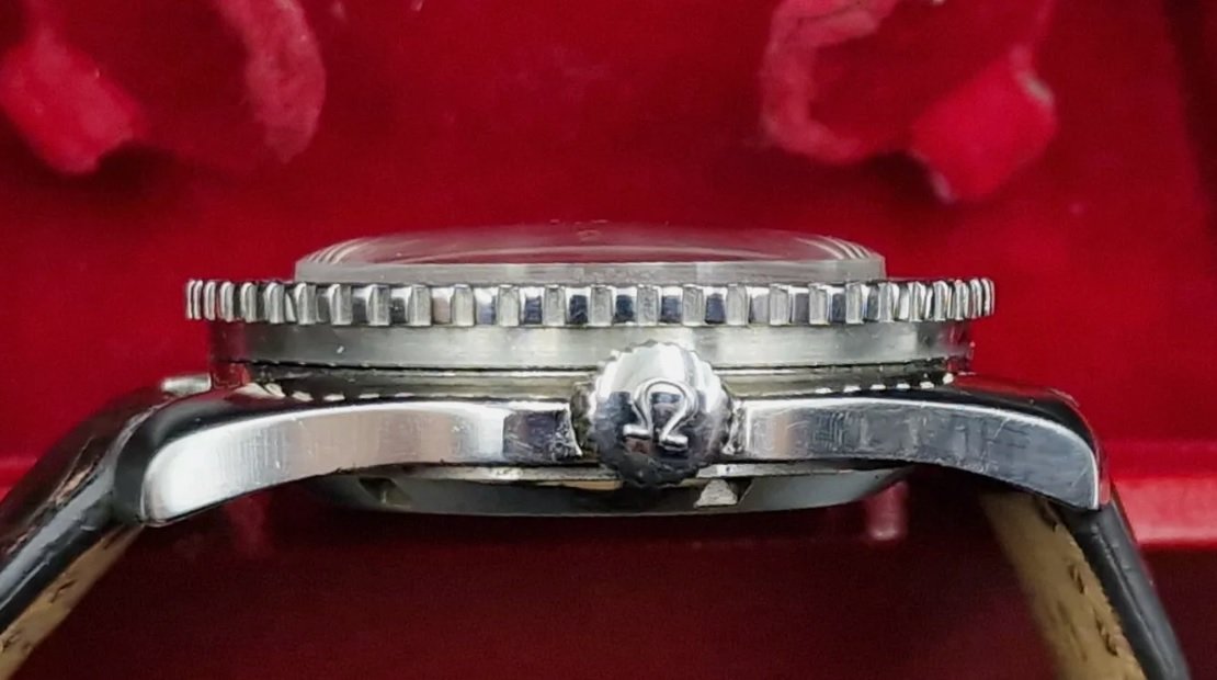

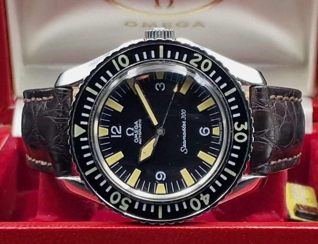

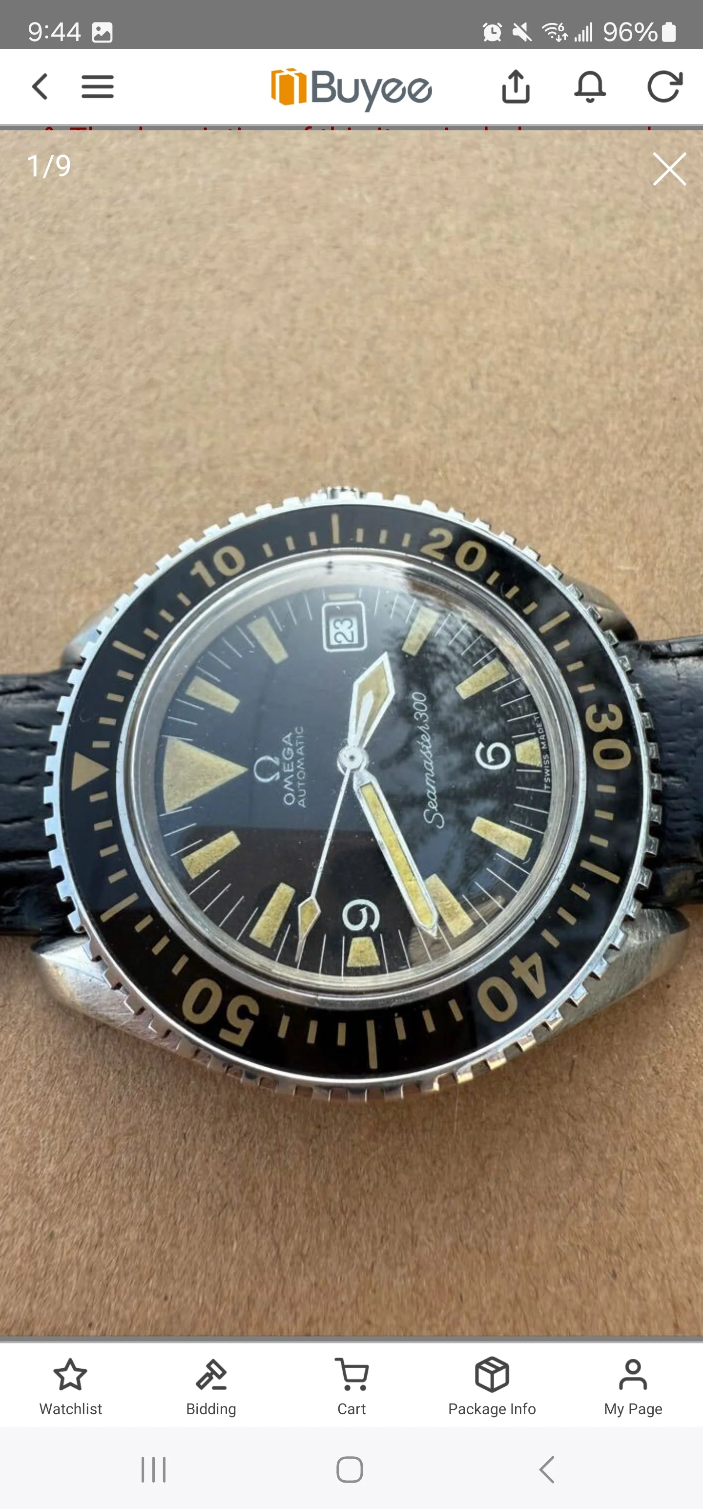

Thought i would catch up on my reading on SM300, to activate my knowledge and join as it such a popular topic lately 😀 .
So here is my try to judge this 165.024 of which i cant figure out the Seamaster 300 script type, it looks like it belongs more to a Big Triangle dial ?
It is a cal 552, nr 2628xxx, with i think a correct D bezel 1967/68 , and a good caseback.
The dial says T swiss T but has plain (white) colour on the lume sections. So cleaned or reprinted in soem way ? The Omega text and 3,6,9 also has very strong seriff l think ? Or a service dial or cleaned in some way ? Wrong seconds hand i think. Thanks for your help !
