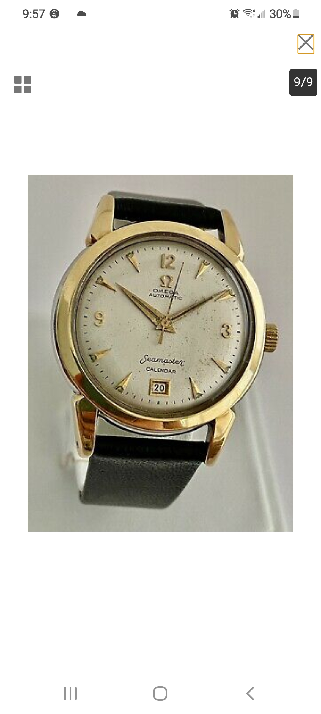

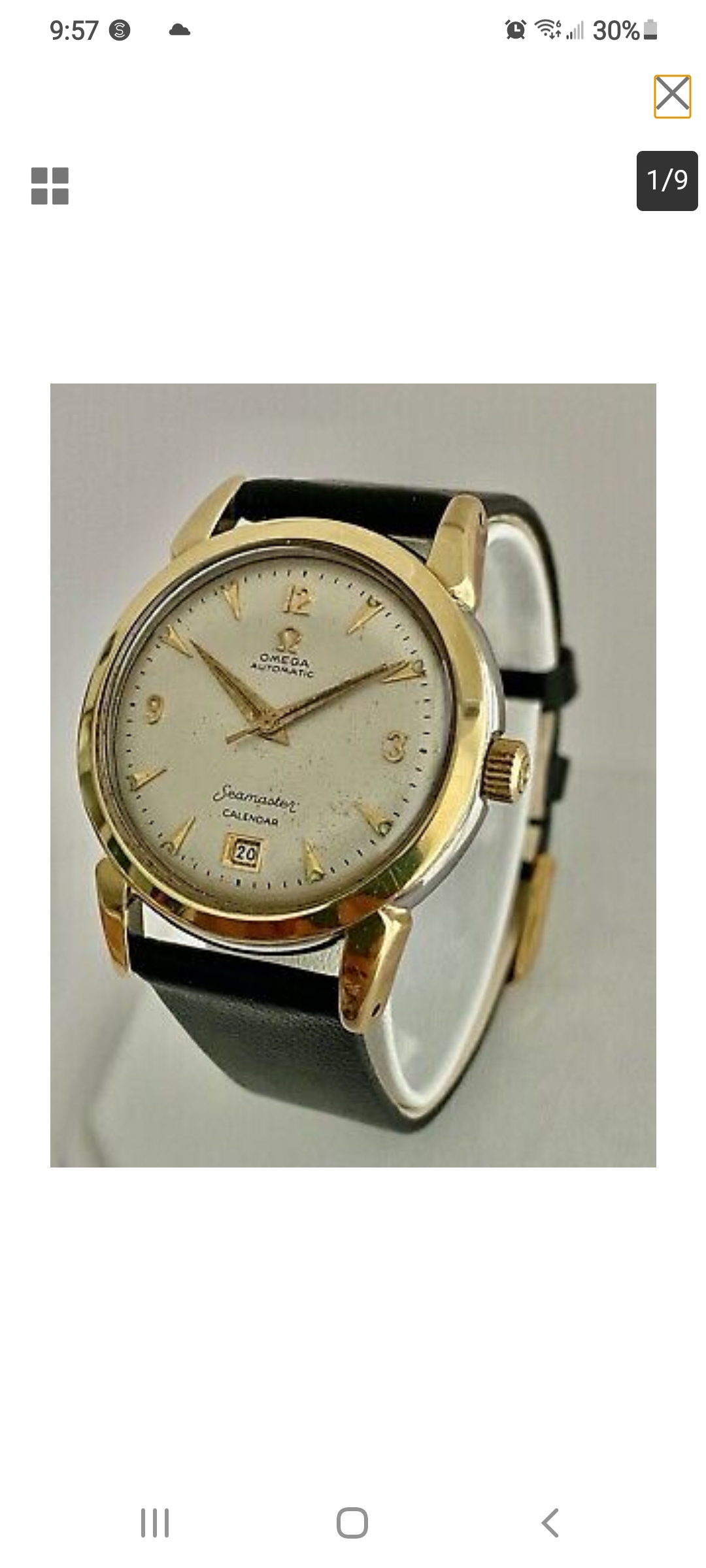

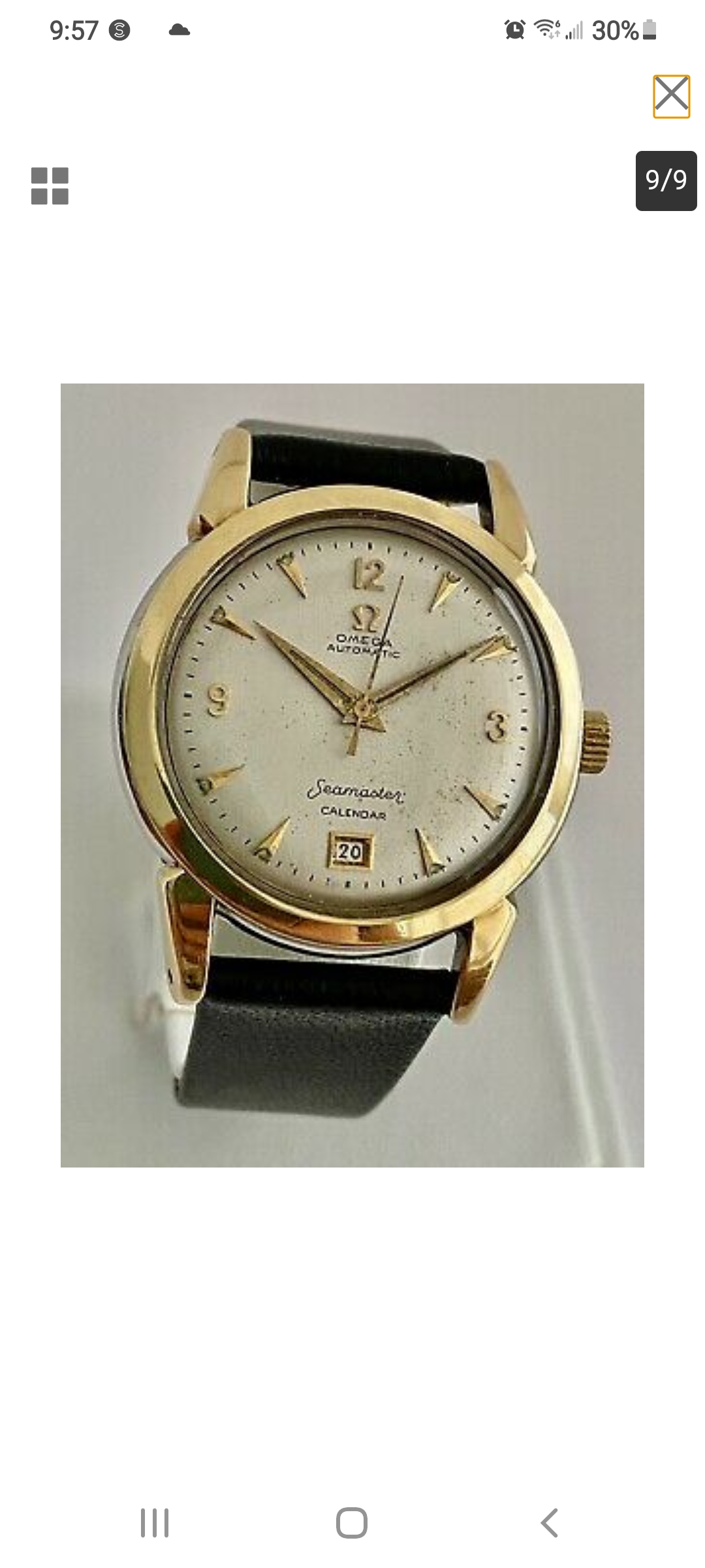

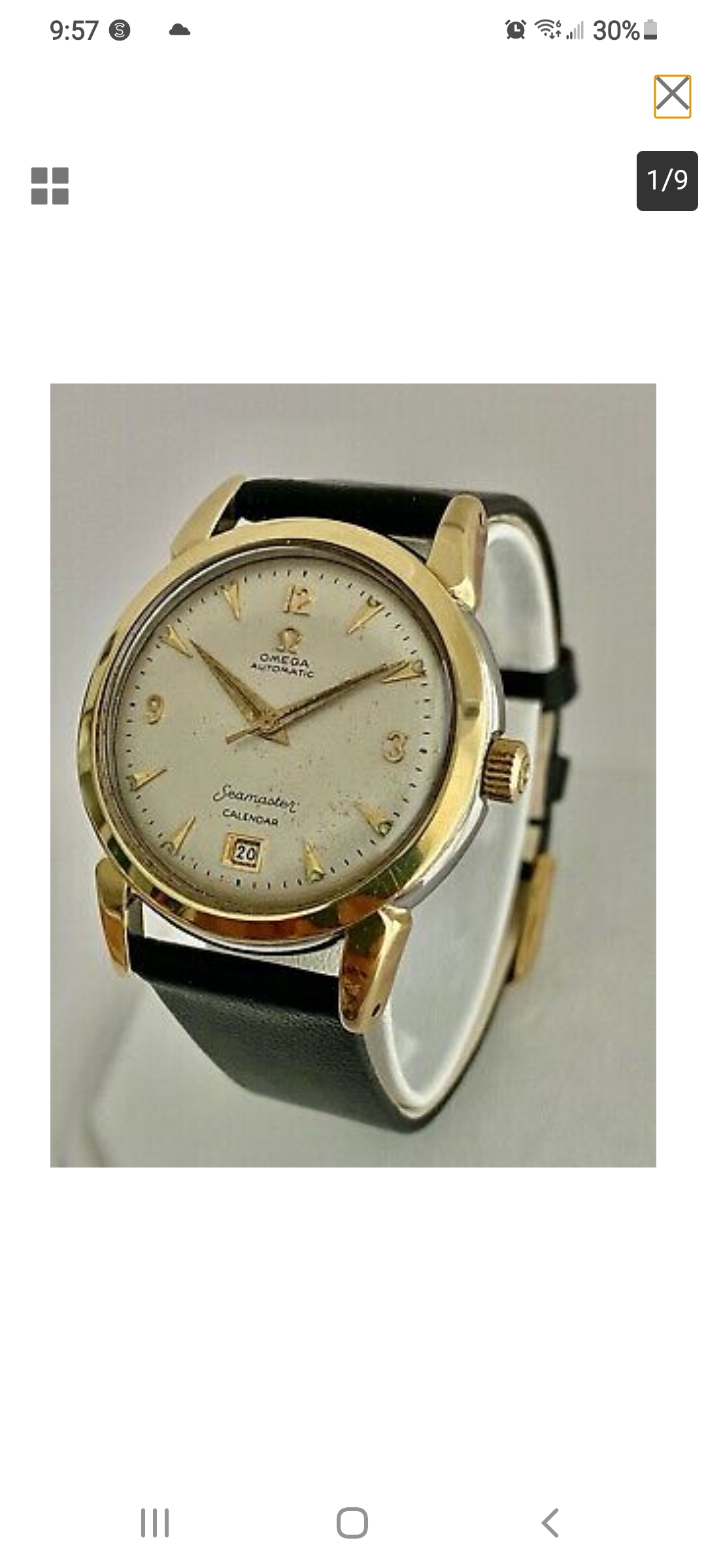

Sorry I had these 2 pictures only.

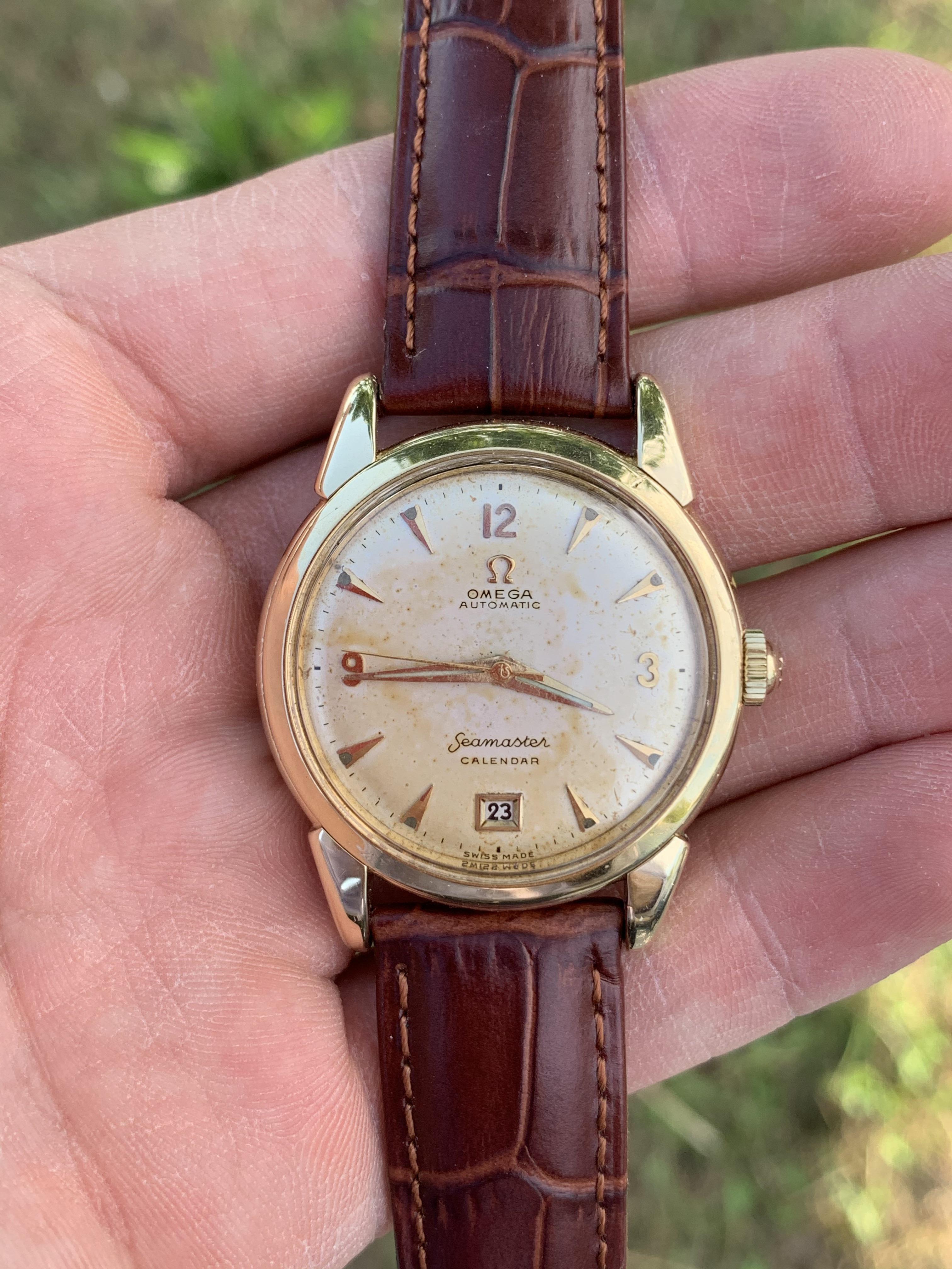

The watch condition is OK. The only issue is the letter "CALENDER". What do you think? Thanks for your help!

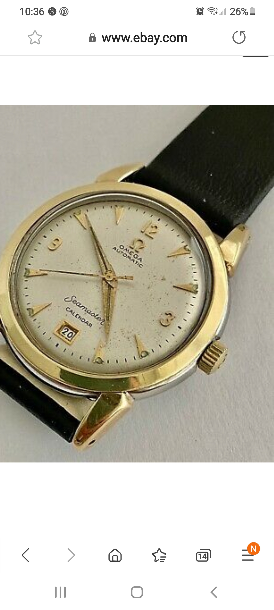

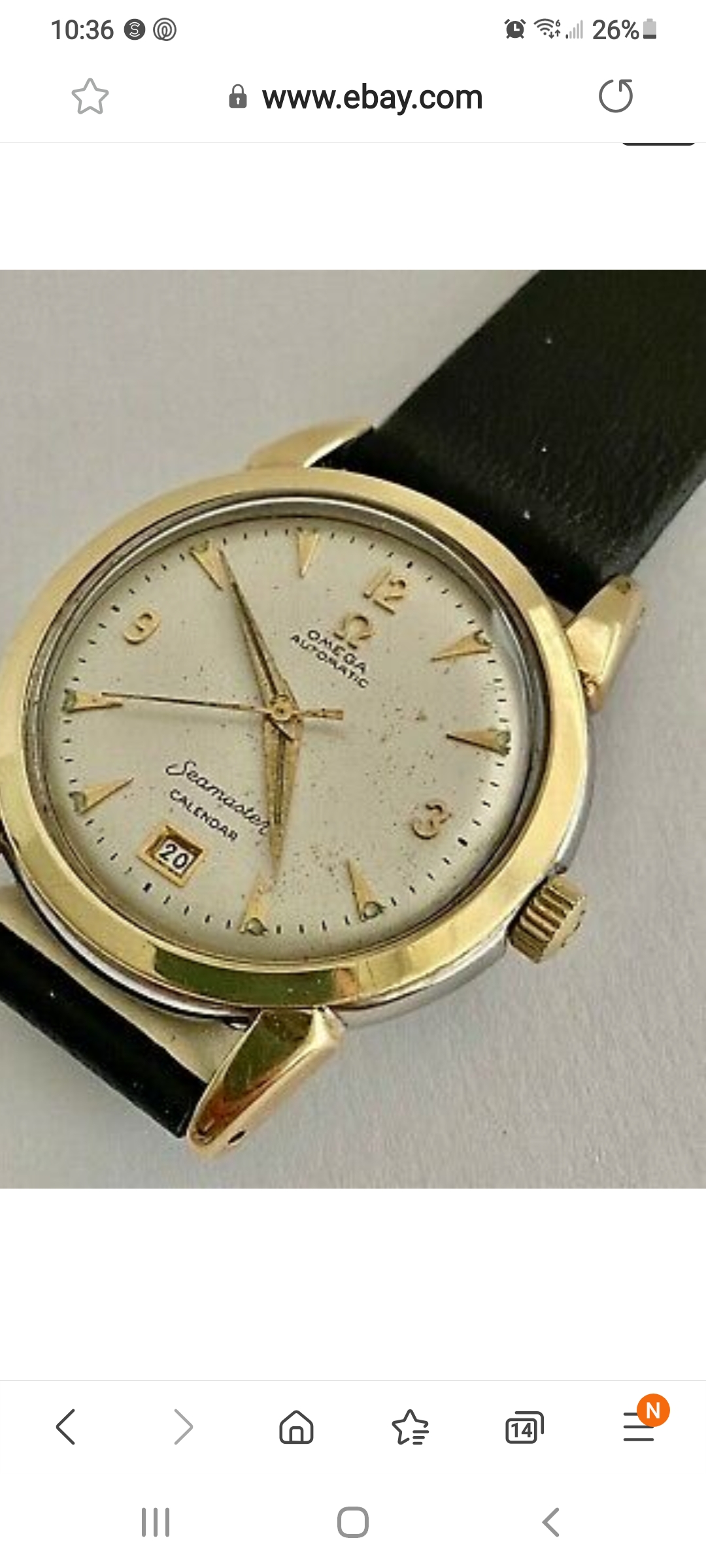

If it said "CALENDER", that would really be a problem. 😁
Sorry, I can't comment based on those photos. Between the pixelation and damaged crystal, I just don't want to opine.

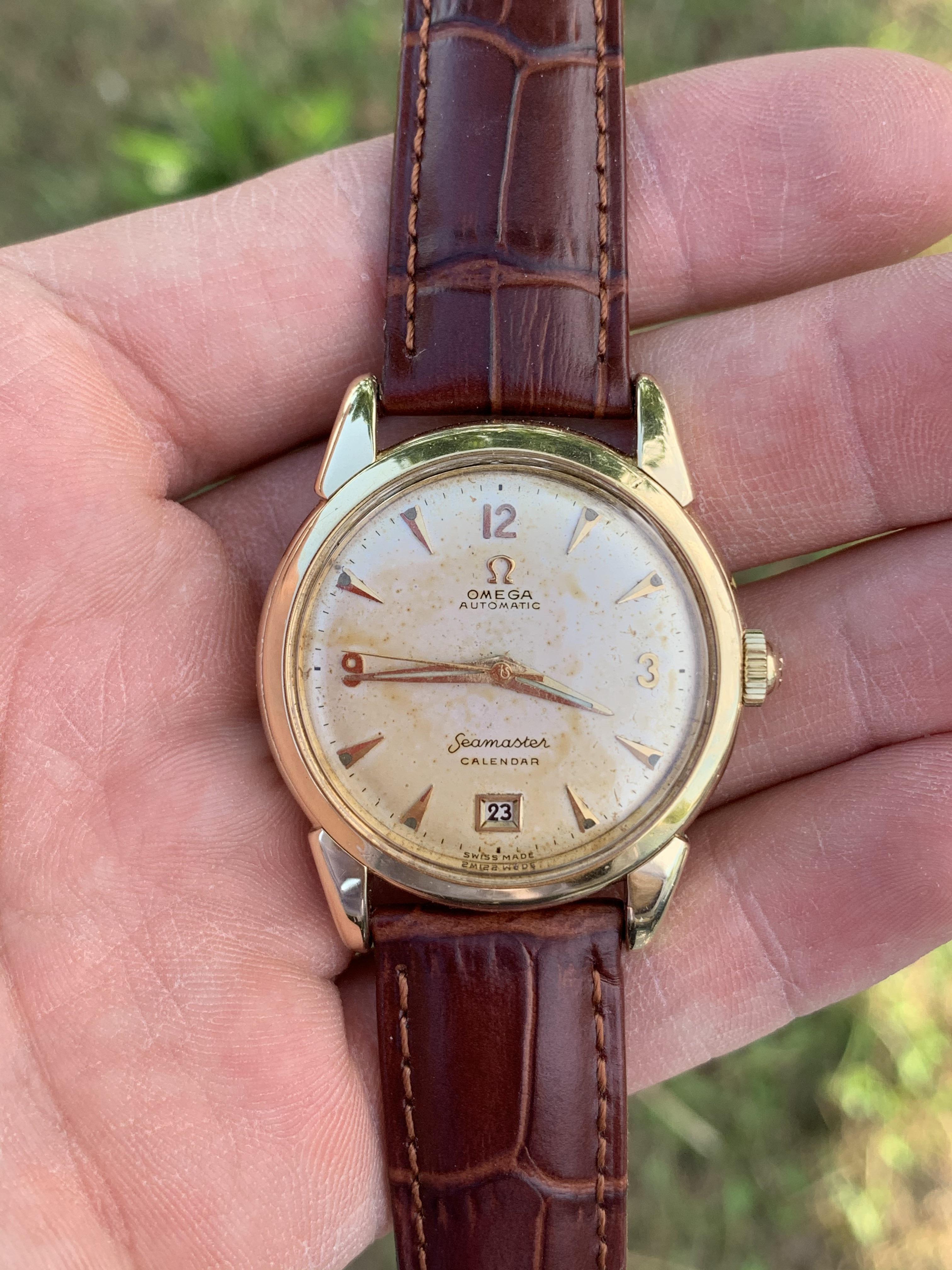

I can't confirm if the dial is refinished at the moment because of low quality pics. But here is mine with the authentic patina dial, so maybe it will help you. Also the crown is incorrect. It should be domed one (as mine), or clober shaped replacement one.

It it a redial - even with those photos you can see the missing "SWISS MADE" (or just "SWISS") which needs to be there on a watch of this age.
Thanks for advice.

I see that too. It'd very nice piece. Unfortunately .,it's out of my price range.

Jaegodylan is offering a very nice watch at a very fair price. I would own it right now were it not for my having recently purchased two other vintage Omegas.

I echo the plug for Jaegodylan's watch that is for sale. The dial and case are excellent. Unfortunately, the lugs on the one that is posted here are worn down to nubs from extreme polishing.
