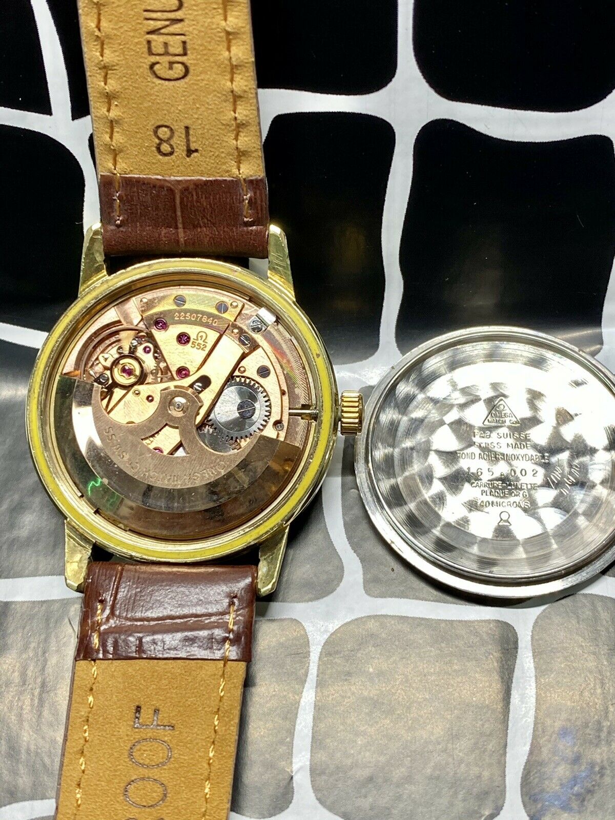

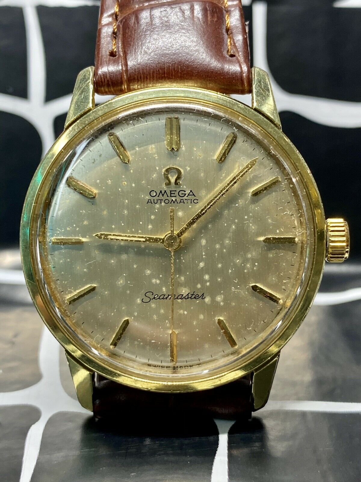

Hello everyone, well, the ones who'll read this anyway. New to the site as well as new to the world of Omega. Always been a fan of the watch but never got an opportunity to acquire one until now. As you can see, this is a 1965 Seamaster 165.002 case that has according to the info on the back 40 microns of gold on the bezel and the calibre is 552.
The obvious situation is the dial and hands which look to be compromised. The inner workings appear to be in excellent condition although a proper cleaning and checkup on mechanics is in order. My question to the masses, is there anyway possible to save the face and hands? I'd love to keep them but the corrosion has got to go. I've already had a quote that would require replacement of the dial and hands and although that would make the most impact it would compromise the historic integrity, although having the face reconditioned would do the same but at least it would be the original dial. The hands would most likely have to be replaced but I would prefer NOS if possible. Oh, and if anyone has knowledge of the correct band for this era, that would also be appreciated.

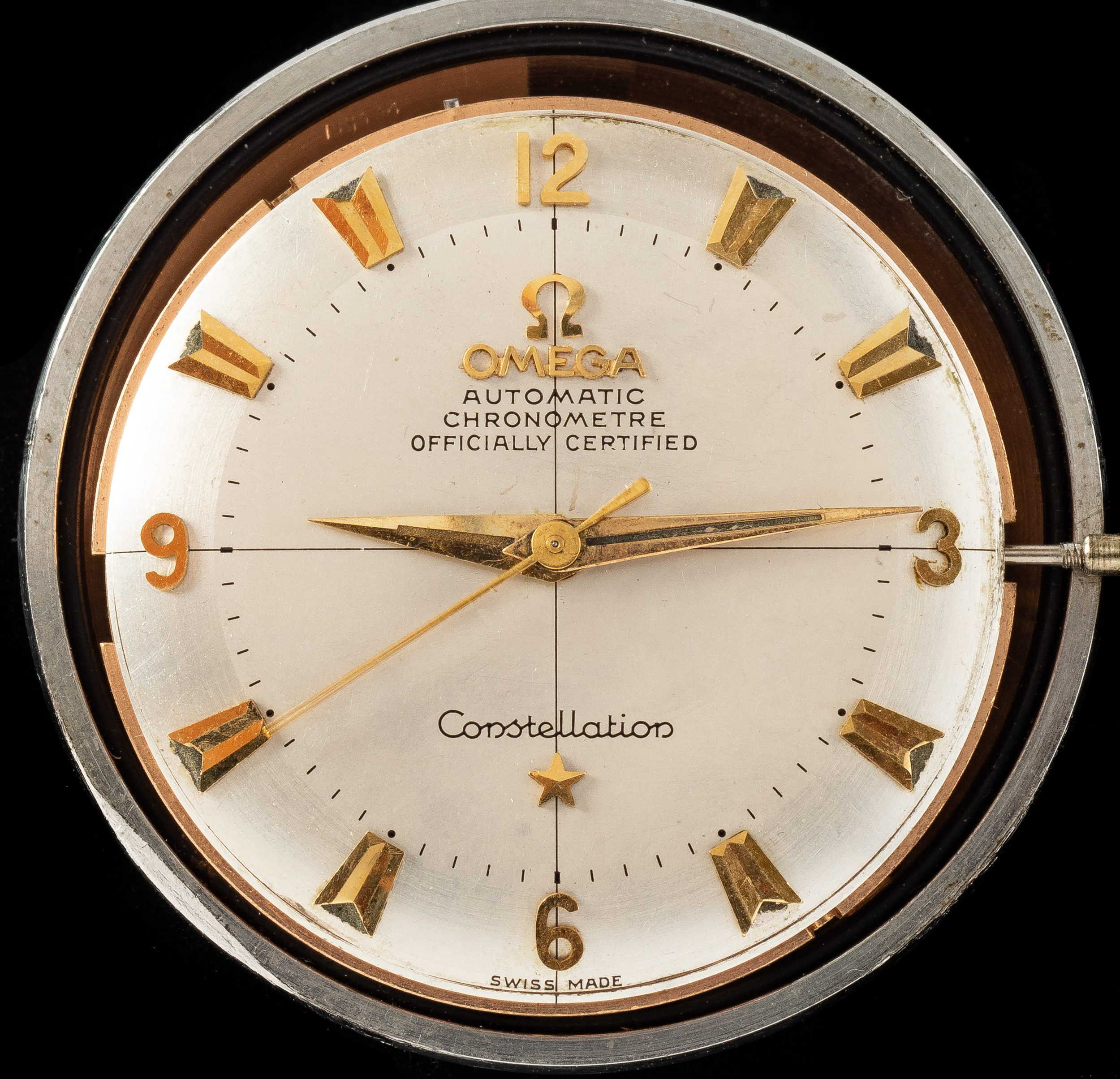

Hello and velcome to OF! To clean a vintage Omega dial is a delicate task, and mostly not worth the risk. Omega used different methods when manufacturing the dials. Some dials can be cleaned, if the printing is on the dial metal directly and not on the lacquer. If you tries to clean a dial with the print on the lacquer it will be ruined (printing will come off.)
But a dial with the print on the metal can sometimes be cleaned. I have used cotton tops an very small brushes, with some warm water. But, and I say but, you have to be very cautious and try on a very tiny area first with no printing.
You need to remove the dial from the case to perform the task. If this model can be cleaned? Well thats up to you to find out. And if you succeed cleaning the dial the laquer will come of and the dial will appear more matte. All according to my experiences.
Another "safe" method is to just sell the watch and look for a similar one in better condition. Personally I think if the crystal is polished and all the dust comes of, the watch is in quite nice vintage condition. 😀

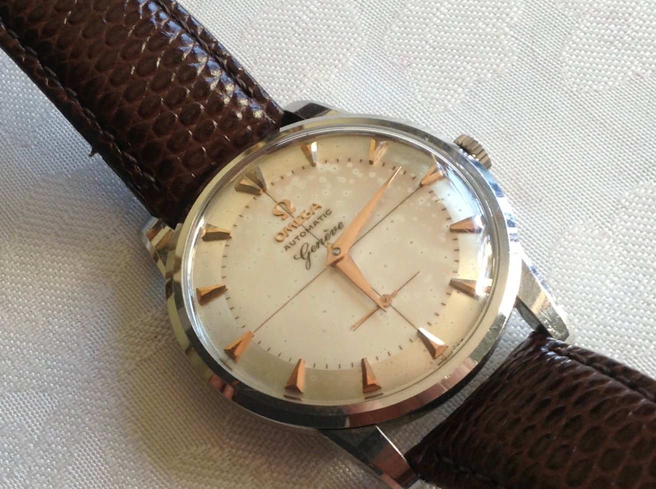

Example of a cleaned Constellation dial...

My personal opinion is that you have two options one sell it or two live with it as is , its not worth it to spend money restoring it if it doesnt have a sentimental value to you , you might spend half or more of the watch value just to fix it and it might not work .

Personally I really like your watch. If it was my watch I would service it and keep it as is.

I’d vote for service, and keep the dial as is. I could even live with the hands as they are too

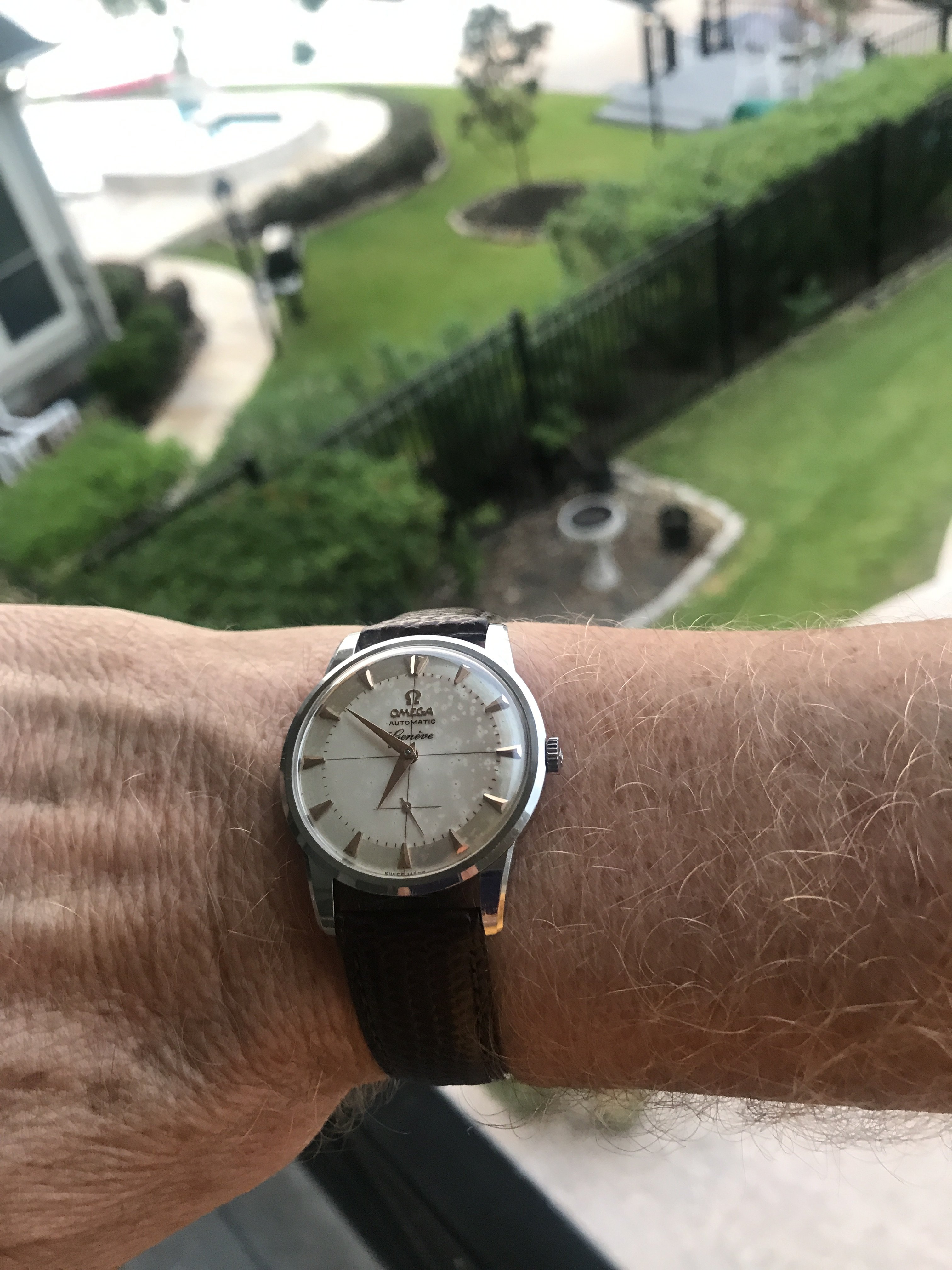

Watches with “patina” have a story to tell - here is one of mine

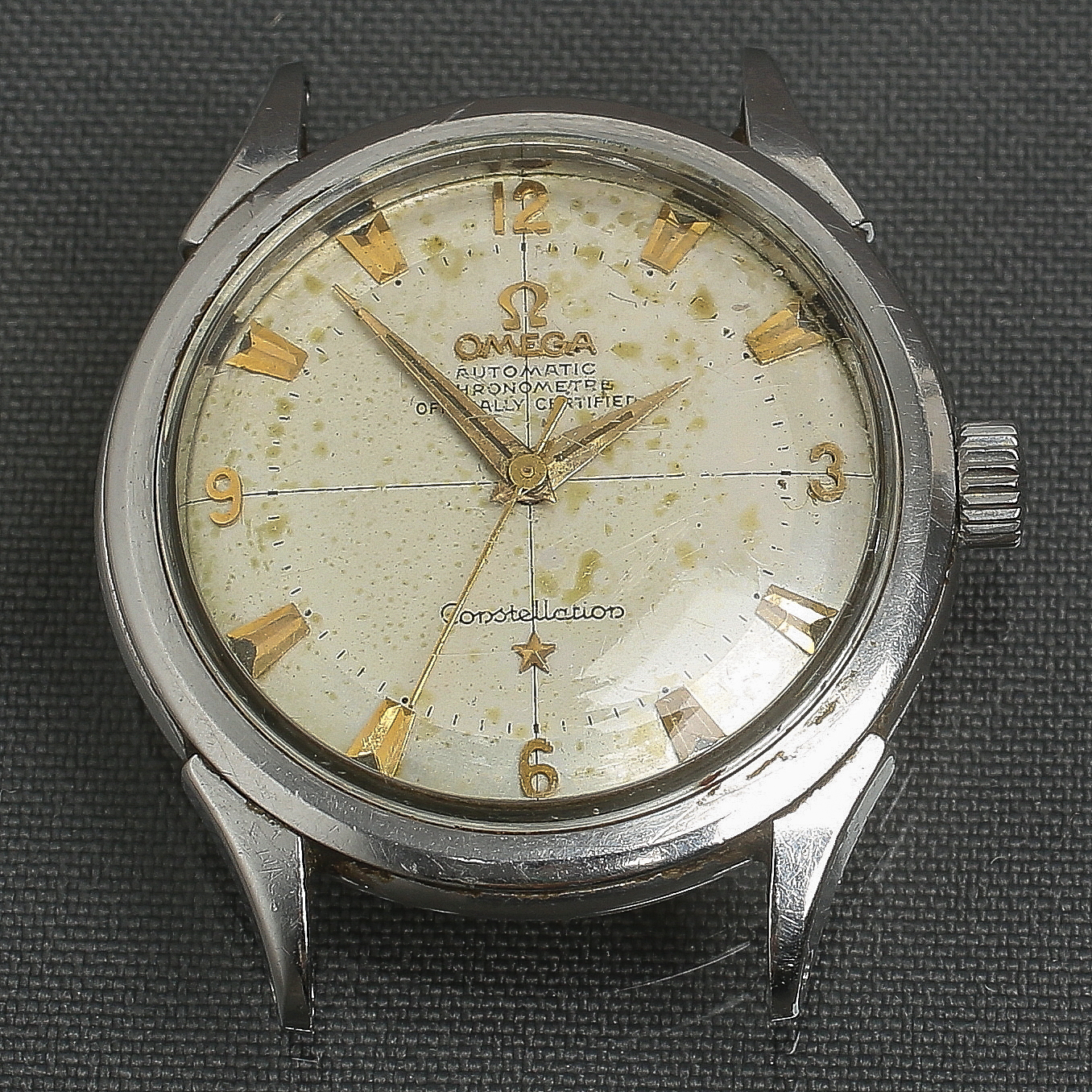

I don't think you'll be able to ever "clean" this dial like in @Maskelyne's post. It looks as though the dial has corrosion bubbles rather than just dirty or browned lacquer. If the lacquer is removed from the dial, the corrosion on the substrate will still be present.
13,555
23,503
Cleaning the dial is going to be very risky and isn’t worth it here unless you’re prepared for the dial to be ruined.
A redial is a massive no-no to me.
if it were mine my only options would be keep as is or sell and look for a better one. Any middle ground will likely be expensive, hugely time consuming and ruin the originality of the watch.
I agrees. You have to consider if it´s only on the lacquer or if the metal has been damaged/corroded.

Firstly, good idea about waiting until after the holidays. In general, it's best to go slow with this type of decision anyway.
When it comes to restoration, you need to get very detailed explanations of EXACTLY what will be done. What dial and hands will be used for replacement? Get photos. If you get vague answers, don't send them the watch. Be patient.
With respect to OmegaAddict's dial restoration, you can look on his website to see examples, since he indicates which of his watches for sale have been repainted. I've linked one example below. When I look at them, they appear quite accurate, but at the same time quite obviously repainted to an experienced collector.
