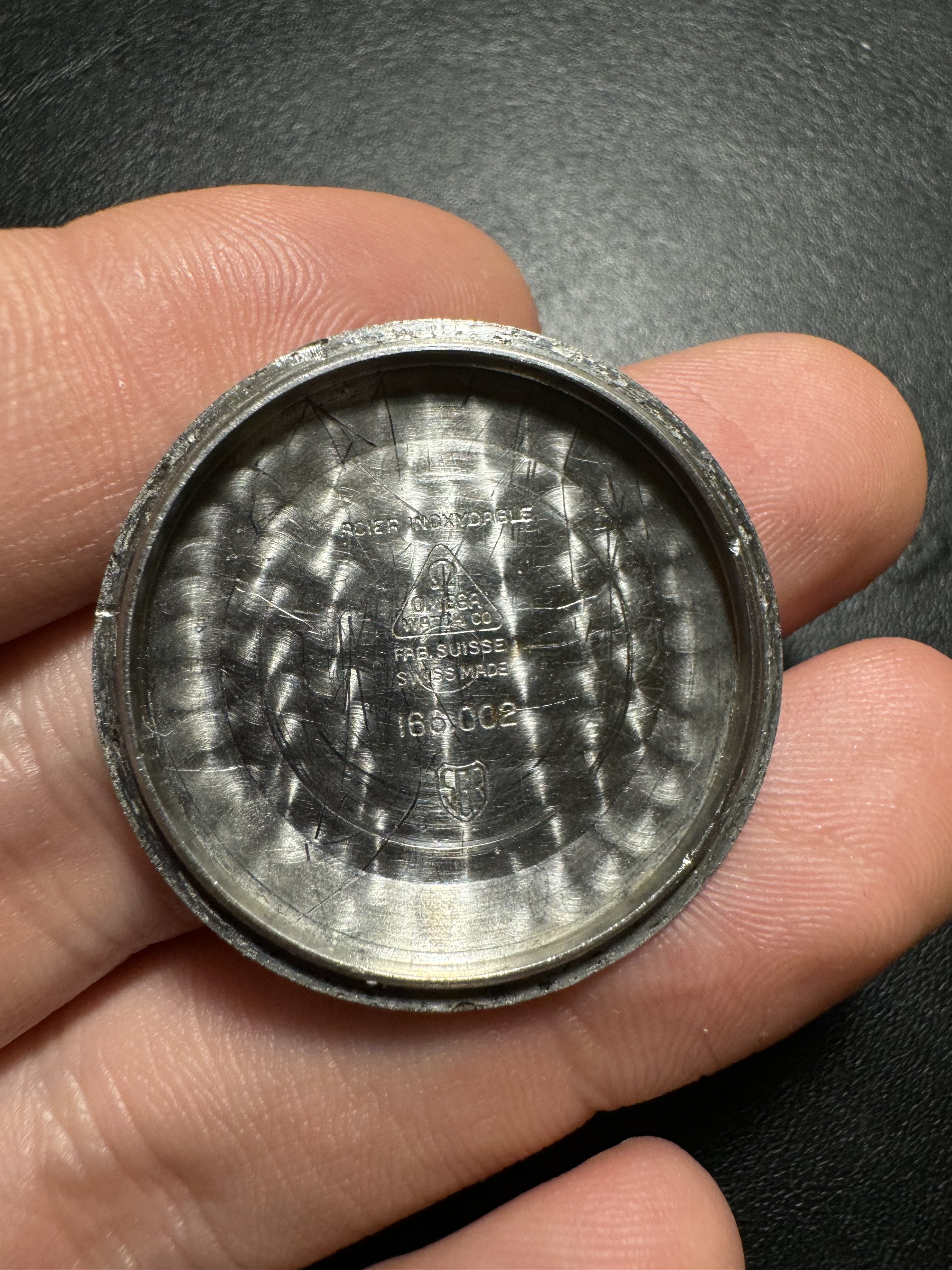

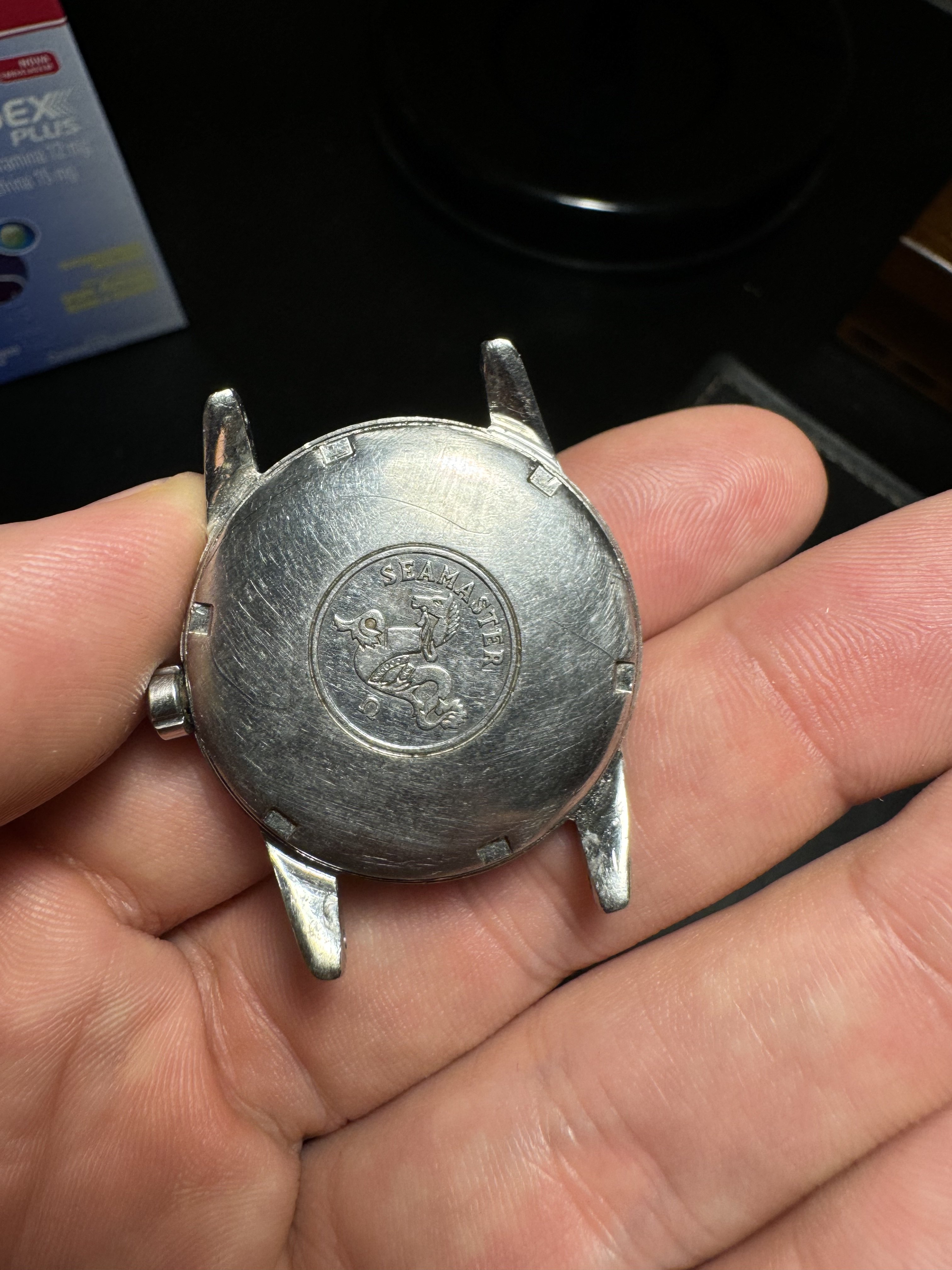

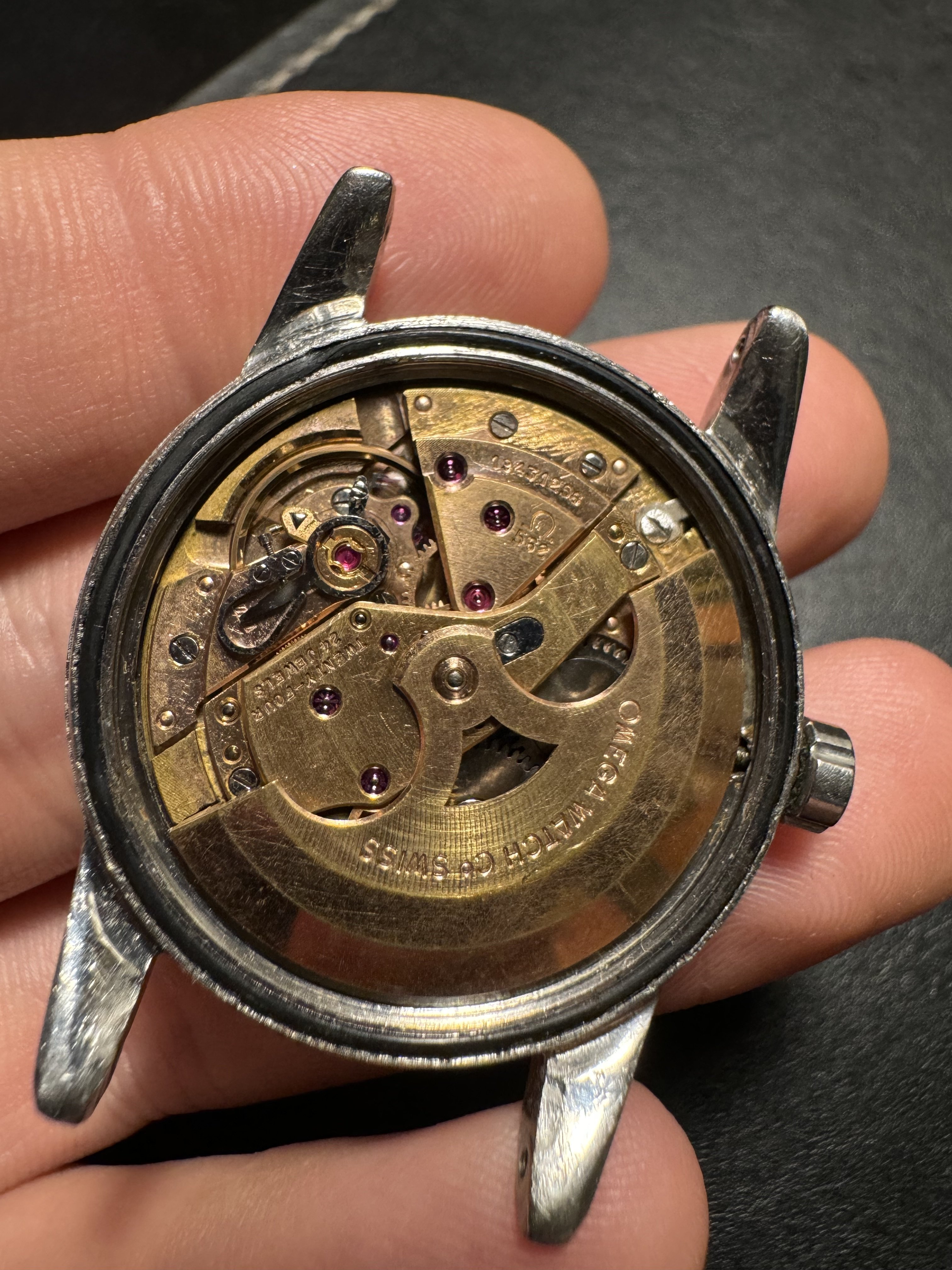

I bought this 1962 semaster, supposedly for my naked eye it would be an ref 166.009 with the 562 caliber.
This one came with the caseback ref 166.002.
My question is the caseback was swapped or not? The fact is from SGR change the ref number?
13,556
23,504
Yes that’s categorically not a 166.002 case. It has the incorrect caseback
10,806
16,814

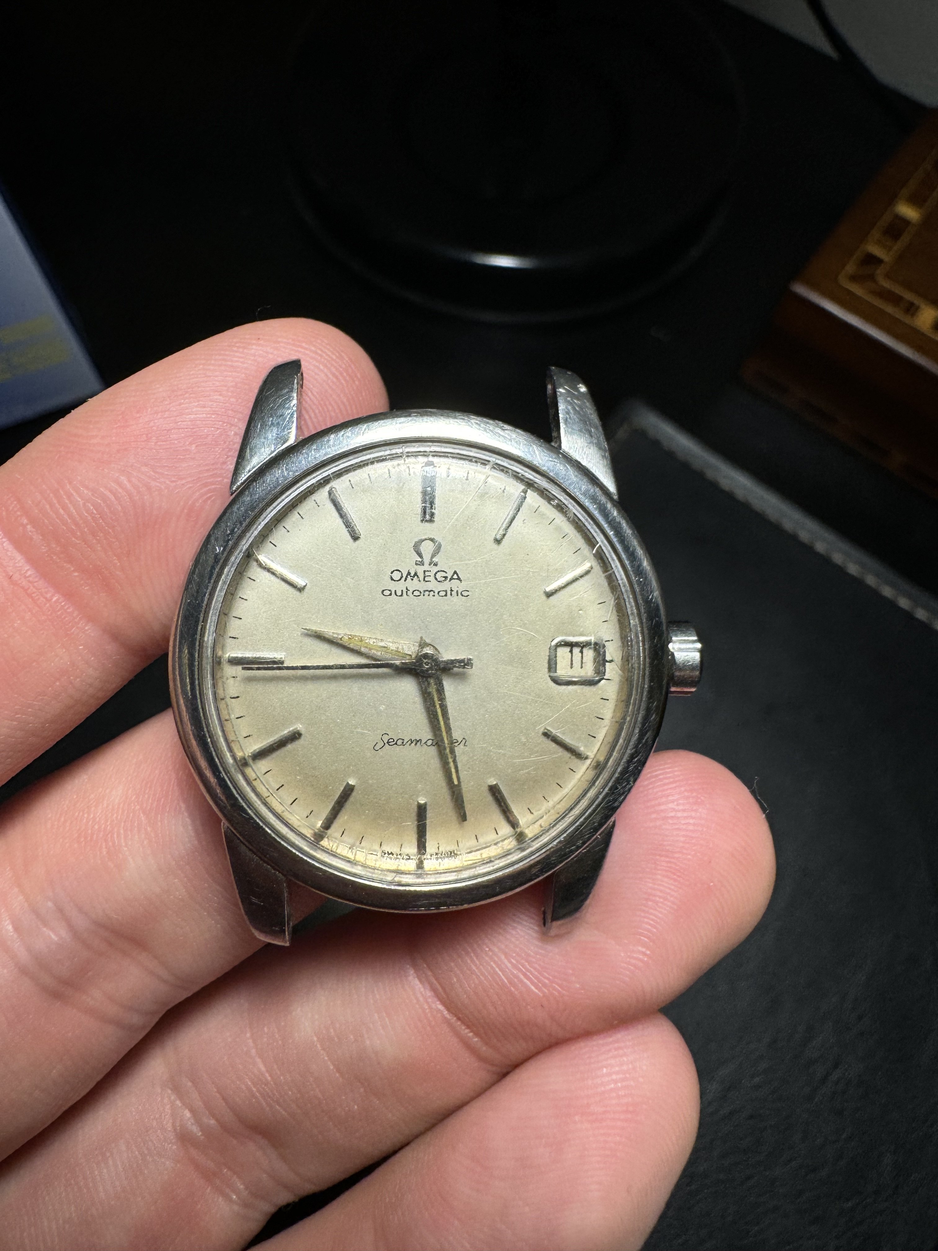

Been redialled or dial replaced. The font of OMEGA is wrong for the era, the automatic font is right but not with the movement or model. The lugs are very worn. It's a mess.
13,493
31,814
Hands are incorrect too.
Can you return it?
