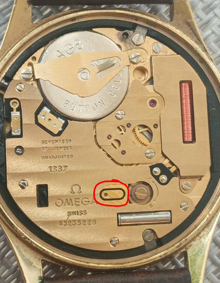

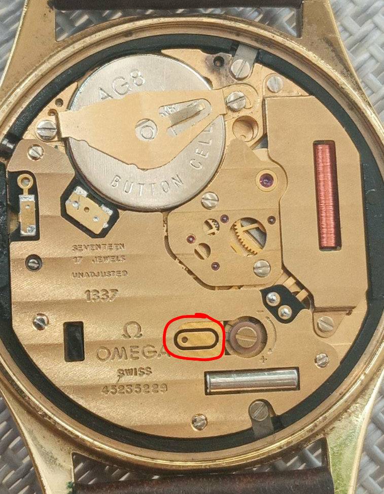

I thought it might just be a contact where the button touches. Someone has advised that on the back of the movement near the regulator adjustment is an oval strip. This does the same thing. Will give it a go and see if that moves the seconds. If so it’s not the board that’s faulty just the contact which can be fixed.

Update: Short circuiting across the oval strip causes the seconds to stop. So you can wait until real time and let go.
Still does not resolve the issue of knowing wether the circuit board is faulty or the contact the button touches.

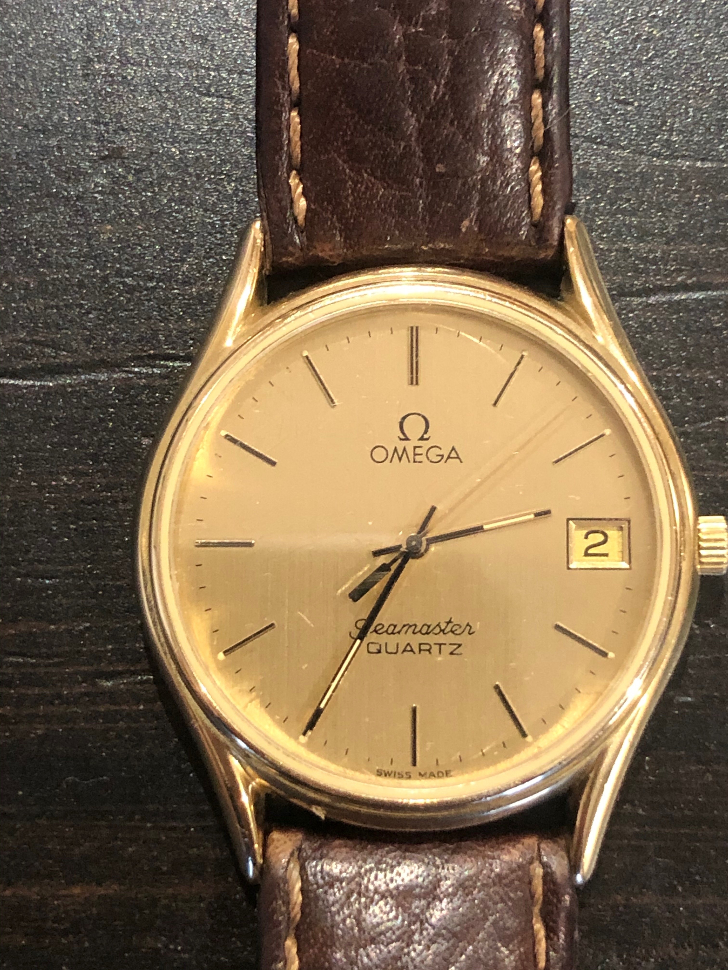

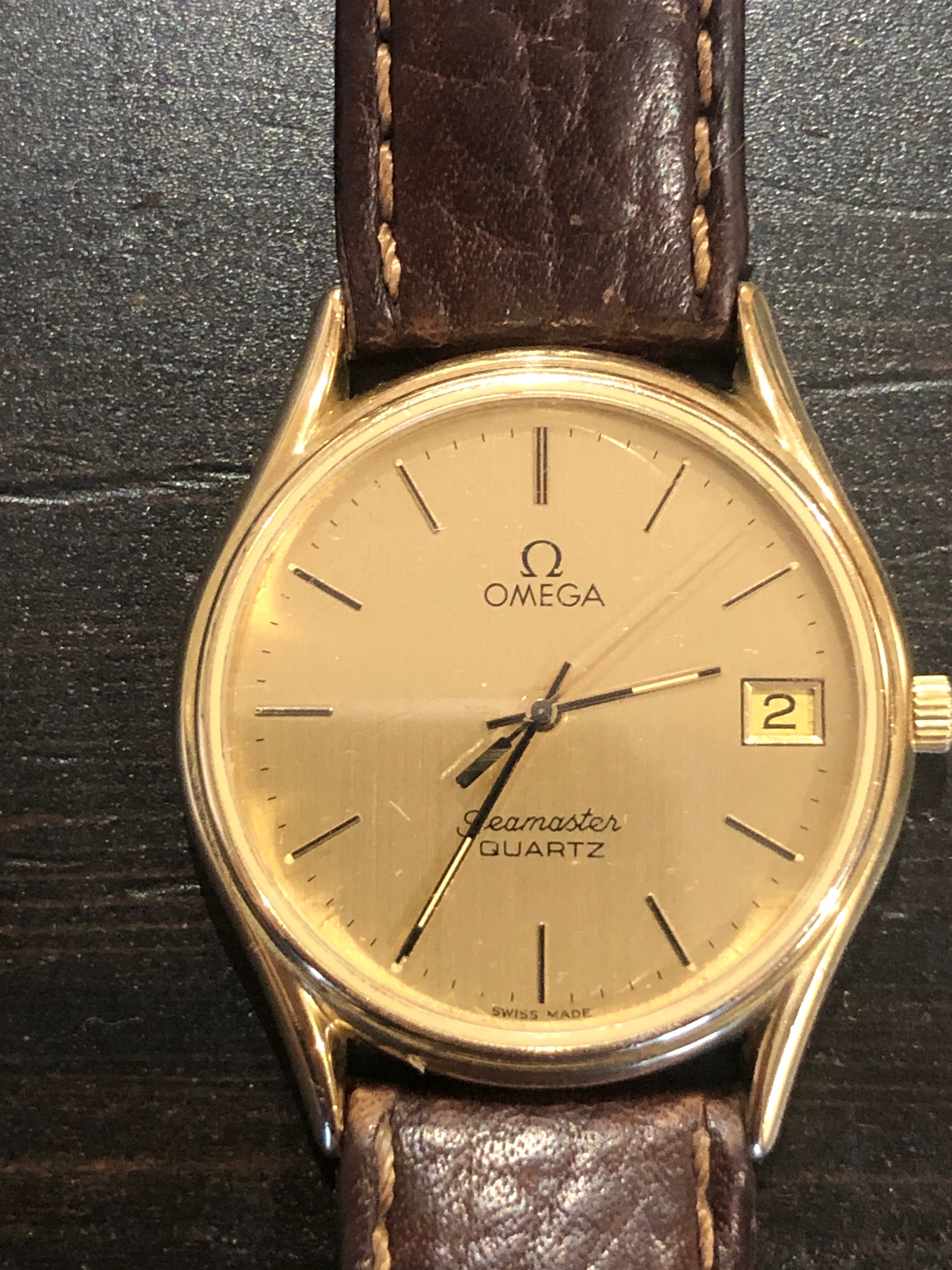

BTW which watch is that ? A pic of the face would be nice ;-)
